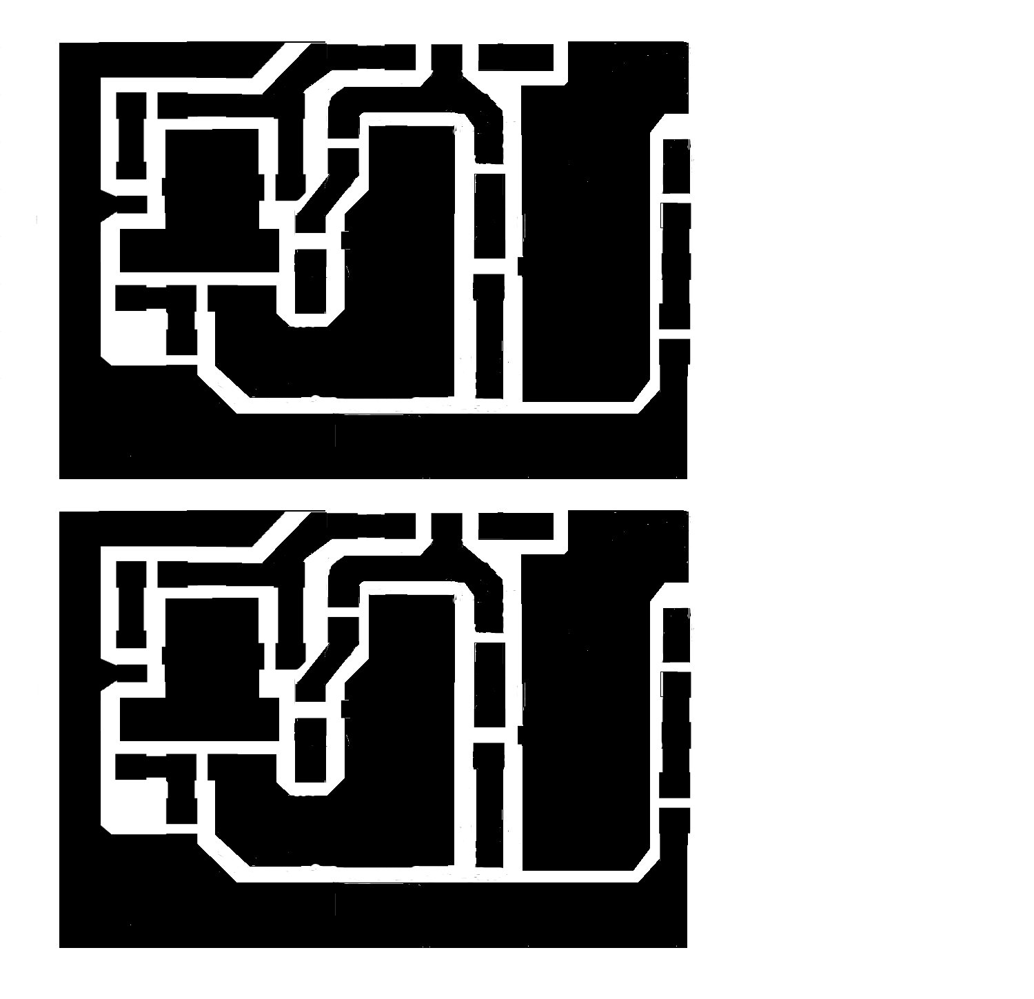

Oh cr*p!! My new layout has the jfets the same way up, but both have the 10R resistors to the drains (as per the incorrect schematic above) and not to the sources, as per post #53...

Meanwhile, I have new board designs, this time with R10 and R11 on the sources of the jfets... Posted below, if anyone is interested. (Copy for printing is a little cleaner than the upload...) I decided if it's worth doing everything from scratch then I might as well get the details right too...

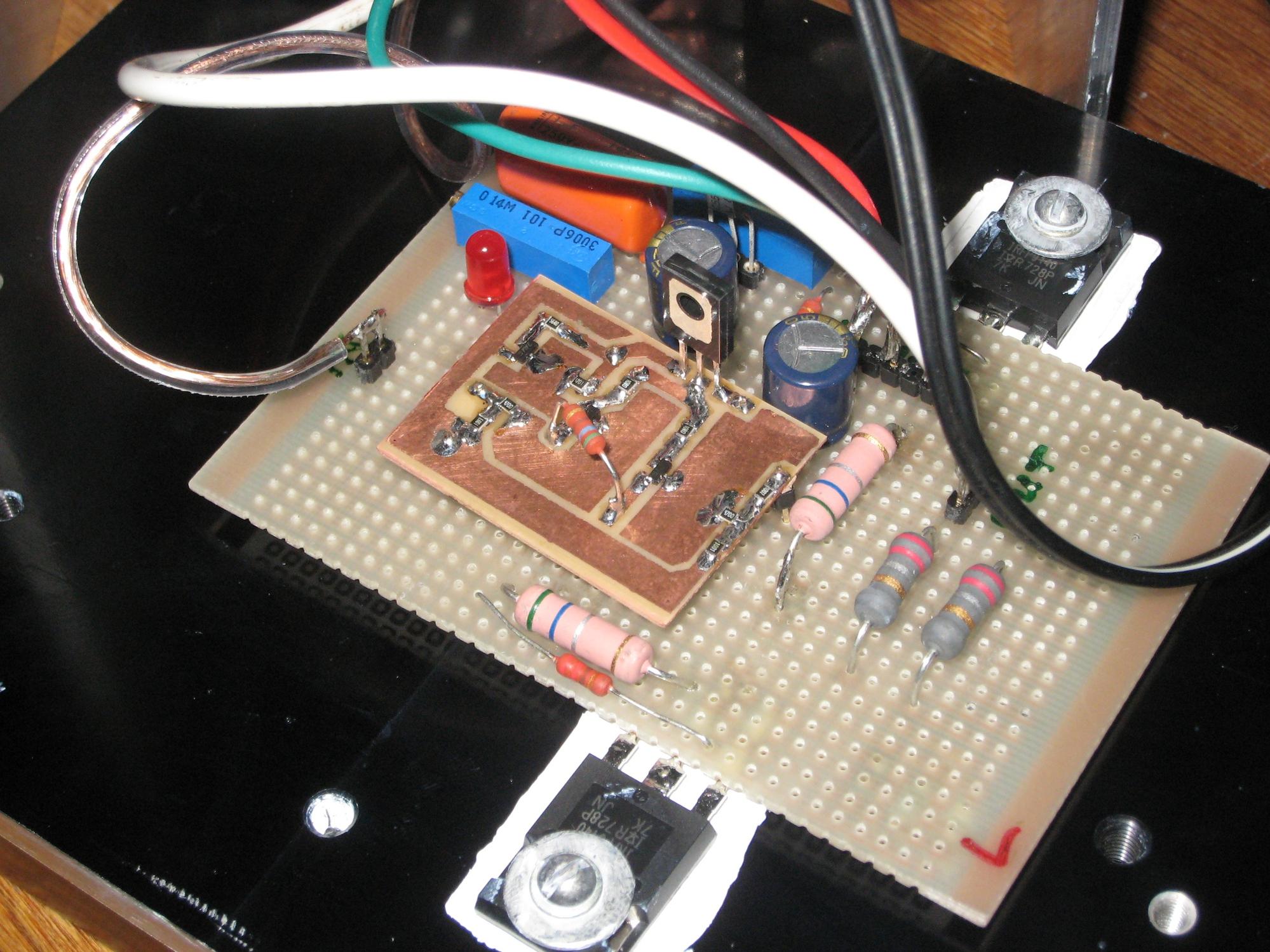

Hi everyone,
I have the amp rebuilt, and working again. Hooray!🙂 It sounds great.
I have attached a photo showing one of the new(est) boards installed - you can see the new board layout quite clearly - larger copper areas, and R1 is not SMD (although it *is* surface-mounted, in a sense) for easy change of value should it be needed. You can also just see the second trimpot I put in for R15.
As far as values go, I used the schematic from post #53, with the only differences being R1 at 560R and R7/R16 at 0R56, and only 1uF across the LED. I set the trimpot for R15 to 68k before installing it, and have moved it little; the trimpot R12 was set to 56R, but adjusting for DC offset has put it around 85R.
Other values: voltages across R10 and R11 are both 80mV, so 8mA going through each side of the LTP - right about where we want it. Confirmed by 4.53V on R1. (560R x 0.008A = 4.48V...) R13 shows 371mV, which is 6.6mA - a little higher than the 4-5mA that juma recommended, but it has about a square centimetre of "heatsink" area on the gate pin, so probably OK. I can probably switch R13 for 100R as juma suggested to reduce this, if necessary, but nothing appears to be getting too outrageously hot at present.
R7 and R16 show 531mV and 545mV, so bias current is just under 1A. Stable heatsink temp is 50 deg C.
Only things that aren't fine are the DC offset at turn-on and the thump on turn-off. The DC offset is initially quite high (momentarily about 1/2 V, falling in 2 secs to about 150-200mV, and falling in the next 20-30 secs to reasonable. At stable temp the offset is negligible- around 10mV or less... I haven't fiddled with this too much yet, so I can probably improve it a little, but I have a question here. When juma suggested putting in a trimpot for R15, it was to "fine-tune" the offset. Am I right in thinking I should alter R12 principally, and only do the last bit with R15? Does anyone think 85R on R12 is too high? (I don't see any reason to think so - just a notable difference from the original specs.)
The thump is a little more worrying. It is not loud enough to be a problem for the present speakers, but might be if I get something better... (Maybe
will bring me a pair of Sonidos?) On a multimeter this can be seenas a surge of well over 1V as the PSU is switched off. Anyone have any suggestions? Are the two problems maybe linked?

1V over 8 ohm speaker is 125mW - get over it 😉...On a multimeter this can be seen as a surge of well over 1V as the PSU is switched off.
I would imagine that the actual peak is a bit larger than the value indicated by a DMM. It may be prudent to look at that on a scope, if you can.
Well, I don't have access to a scope, unfortunately. I am fiddling with using a computer sound card and a software oscope program, but so far I can't get it to work. And in any event, it may not be the best idea to try to measure a dc thump with a sound card.... To say the least...
Unless anyone has any suggestions I'm just going to live with the thump, for the time being, and look into dc protection circuits for if/when I get better speakers to use with it.

Hi Nigel,
please remove any cap from CCS (I think you got just one 1uF parallel to LED) and see what does it do for turn-on/off thump.
Hi Nigel,
juma: Following your suggestion I've pulled out the 1uF caps (C2 - in your schematic from post #53 they are 22uF). No appreciable audible difference in the thump. I also tried it with no speakers and just the a DMM on each channel. On the 20V scale there isn't enough time for the meters to react properly; on the 2V scale they flash above 2V momentarily. I don't think the thump is loud enough to damage the cheapo speakers I'm using at present, it would mostly be a problem if I build something better for my office.

believe me - even if it sounds scary - even delicate Lowthers can't be harmed with Aleph J's thump .
not that I'll tell you that decent DC protection & anticlick will harm anything .
if you have any decent speakers - that is must .

Hi ZM. I'm looking at some info on DC protection I got from another forum member to try and figure out what to do about DC protection. Do you have any links or schematics you could suggest?

generic ones with uPC1237 are good enough
there are plenty schematics on net , and in chip datasheet
