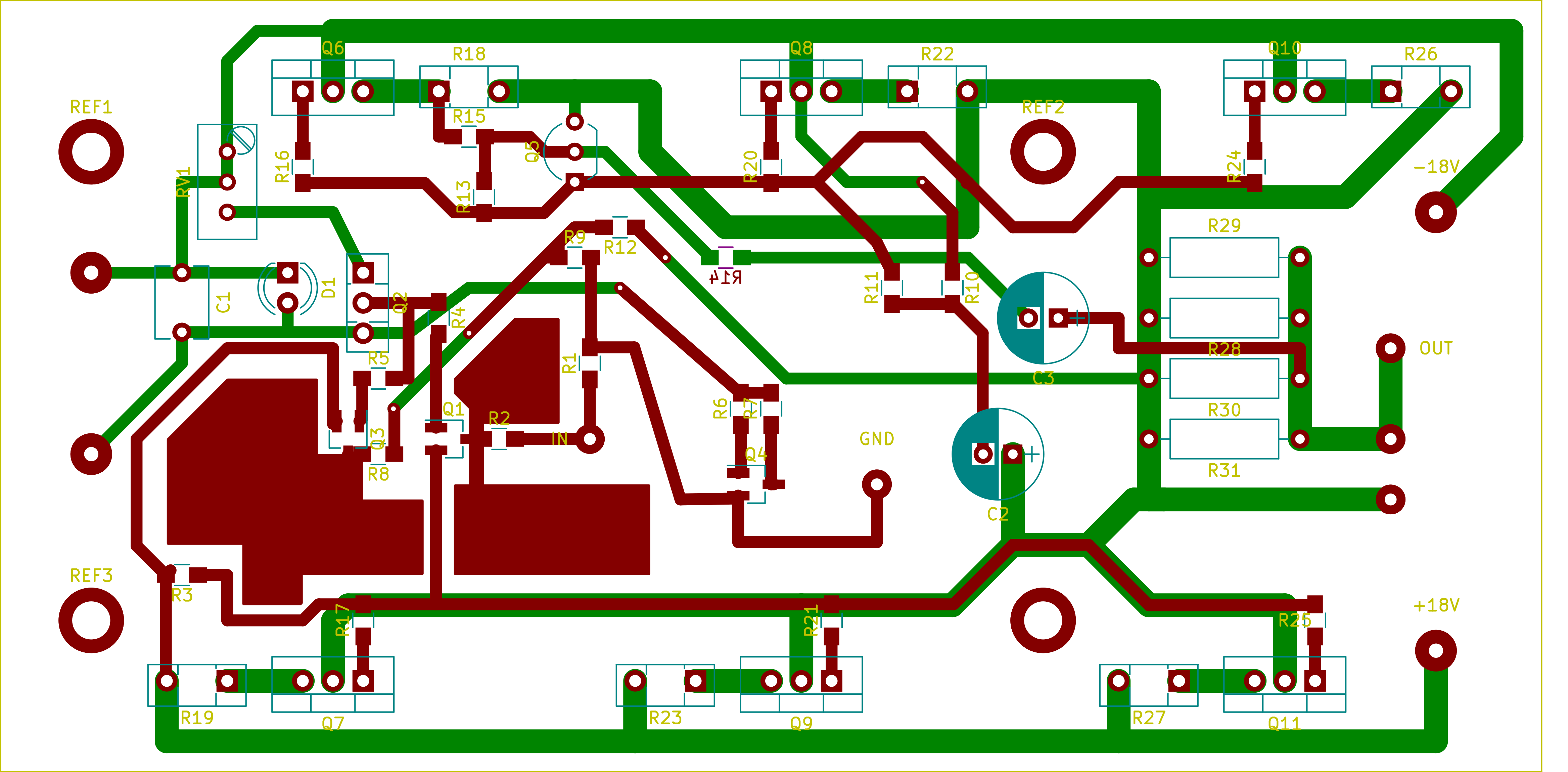

So I'm revisiting this project, after five years of periodically remembering I bought most of the parts - and then doing nothing about it. I doubt anyone remembers this thread after so long, so let me briefly review the story. Juma kindly posted a schematic (in response to my query) for a voltage-reversed Aleph using BF 862 on the inputs, and P-channel mosfets on the output. After a lot of help from generous people here I got the amp working, liked it, and at some point decided to rebuild it with better hardware, more attention to details, and so on. I also decided (again, with input and help from folks here) to use paralleled 2SJ313 on the outputs, with three pairs per channel.
I've spent a couple of evenings trying kicad fo the first time, and designing a pcb for the project. I hope I've incorporated everything I learned last time around with the point-to-point build. Although it seems unlikely anyone else will want to use the design, I tried to make it fit the universal mounting specs from this site, just in case.
I'd be grateful for any input on the design, or any other comments.
Best
Nigel

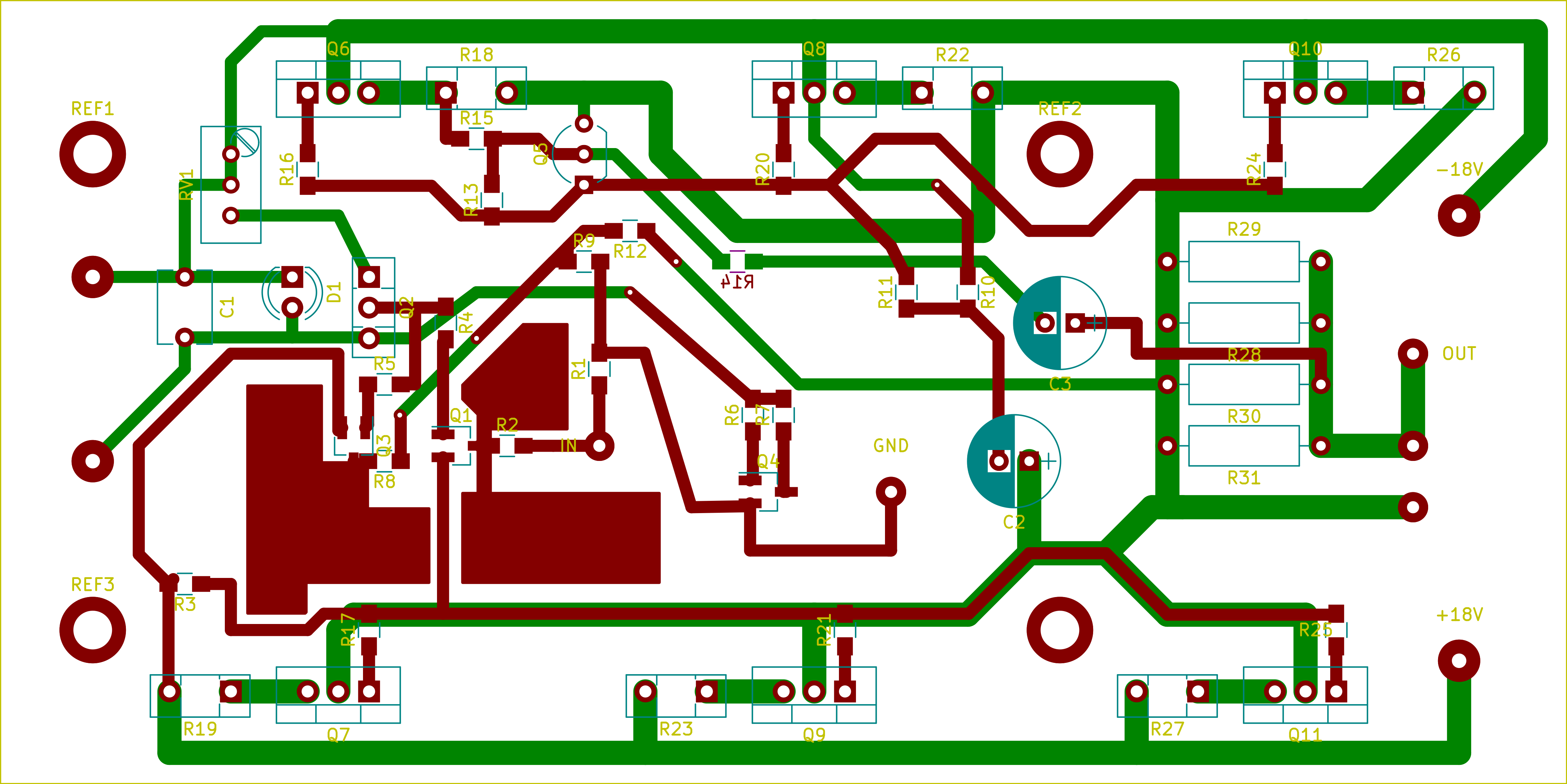

Hi Everyone,
I thought I'd post a slightly altered board design. Reading over the thread again I thought I should make the heatsink pad on the gate of Q3 the same size (or close to it) as the one on Q1. This should help to keep them at close to the same temperature. It may not make much difference, but it just seems to be a little more careful, and costs nothing...
No-one had any comments on the last post - so perhaps no-one is reading this - but I'll keep posting as I continue with the build. (Probably slowly...) Next step is to send the boards off for fabrication - something I've never done before, but there's a first time for everything,as they say...
Nigel
A small problem. The large-ish copper pads on Q1 and Q3 are meant to act as small heatsinks. Previously I etched the one-sided boards at home these were just bare copper, but I'm planning on sending this board in to be fabricated, and I presume they'll be covered in soldermask... I've never sent in boards to be fabricated before, and I can't find answers on their website, so...
1. Is soldermask thermally insulating? That is, if they *are* covered in green (or purple) lacquer, will they still radiate heat OK? (My uninformed guess is no...)
2. Is there some standard way to ask for these *not* to have soldermask on them? I'm using kicad, and having some trouble figuring it out, but maybe I missed something...
3. If the boards have soldermask on these pads and I need to get it off, is there some sensible way to do it without otherwise damaging the boards?
Thanks for any input here...
