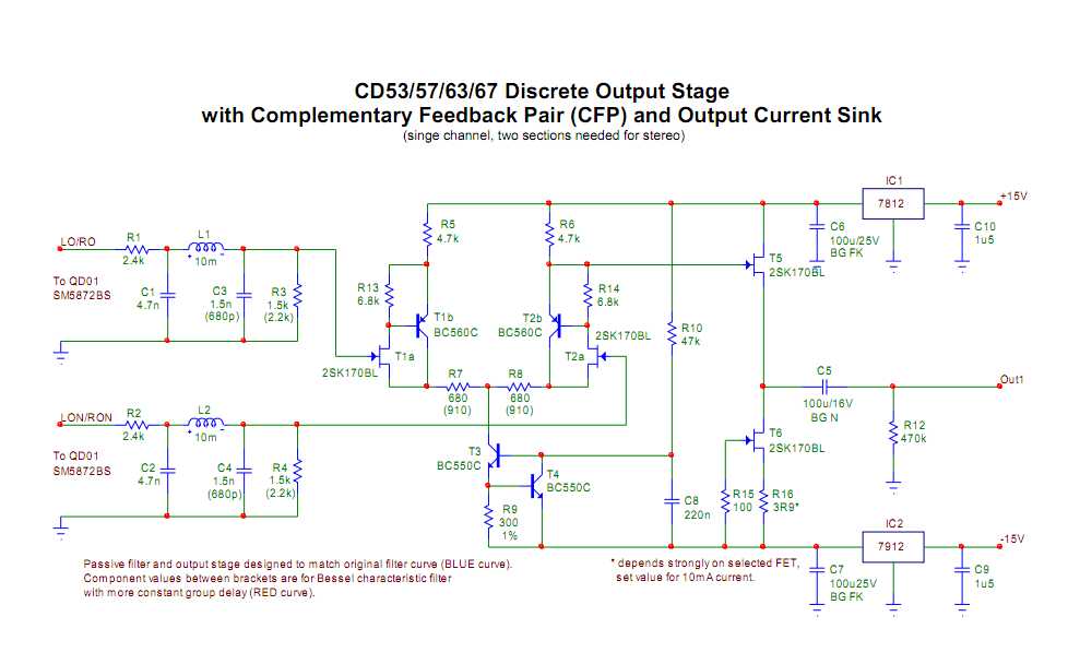

hi there,
i built one channel of the amp and i think one bf862 in the diff pair blew up. now i m kind of tired of handling those little jfets. i guess i can use some 2sk170 instead? what bias should they be ran at? 2ma?
hi there,
You can use k170 in diff. pair and they run at about 9mA each. So you should use JFETs with Idss in range of 12-15mA.

why exactly does the jfets prefer 9ma in this topology? i m currently in the process of learning more how what i build works.
also would the output stage of the mini-a be fitted in this schematic to power speakers directly? i guess without feedback...?

pidesd,
JFETs don't prefer Id of 9mA - we do. For BF862 or k170BL (with Idss in range of 12-15mA) that's the region where transfer characteristic is linear. That's the way to use them in order to make them sound nice. For some other JFETs it will be some other value...
Find Erno Borbely's articles (JFET Frontiers 1 and 2) and study them.
The schematic you attached is not what I consider good circuit. JFET's Id is way too small and CFP (T1a/b and T2a/b) is not what sounds good to my ears. Also, it can't be easily used as power amp without feedback loop. With some effort it can be done but it will sound inferior to what you have now.
''JFETs don't prefer Id of 9mA - we do''
i think we understand each other, but you are right 🙂
about that linear thing, i began looking at this and graphs but they hardly look ''linear'' to me. i guess i ll have to read the articles, thank you for pointing me to them.
''sound inferior to what you have now''
i guess you mean a normal output stage with amp VS what i m suggesting.
why do you think that the input stage shown (with or without CFP) when not starved coupled to the aleph output stage with feedback would not be very good?
i believe i may not understand right now, but i kind of like the idea and sound of simple circuitry.
anyway...i ll look more into this...
by the way i ll try to upload pics of what i have done, it sounds really good, thanks for sharing, Juma
