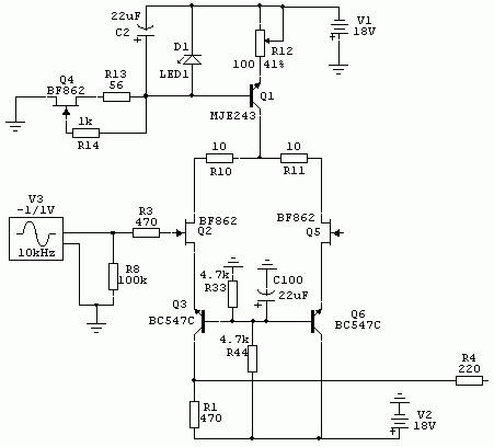

...my concern over the jfet temperature (60 deg. C at the gate sodlering point - probably 100 deg C at the junction) but you apparently do not. Why ?...
I use them that way for a few months already without apparent problems. It doesn't bother me. Since it's an issue for you, go for lower Pd. 6-7mA through each JFET in LTP means considerably less dissipation and they'll still be in linear region of operation.
Cascoding of LTP is another obvious way to lower the JFET's Pd.
This is one way to do it (JFET's Vds will be about 8.3V only) :

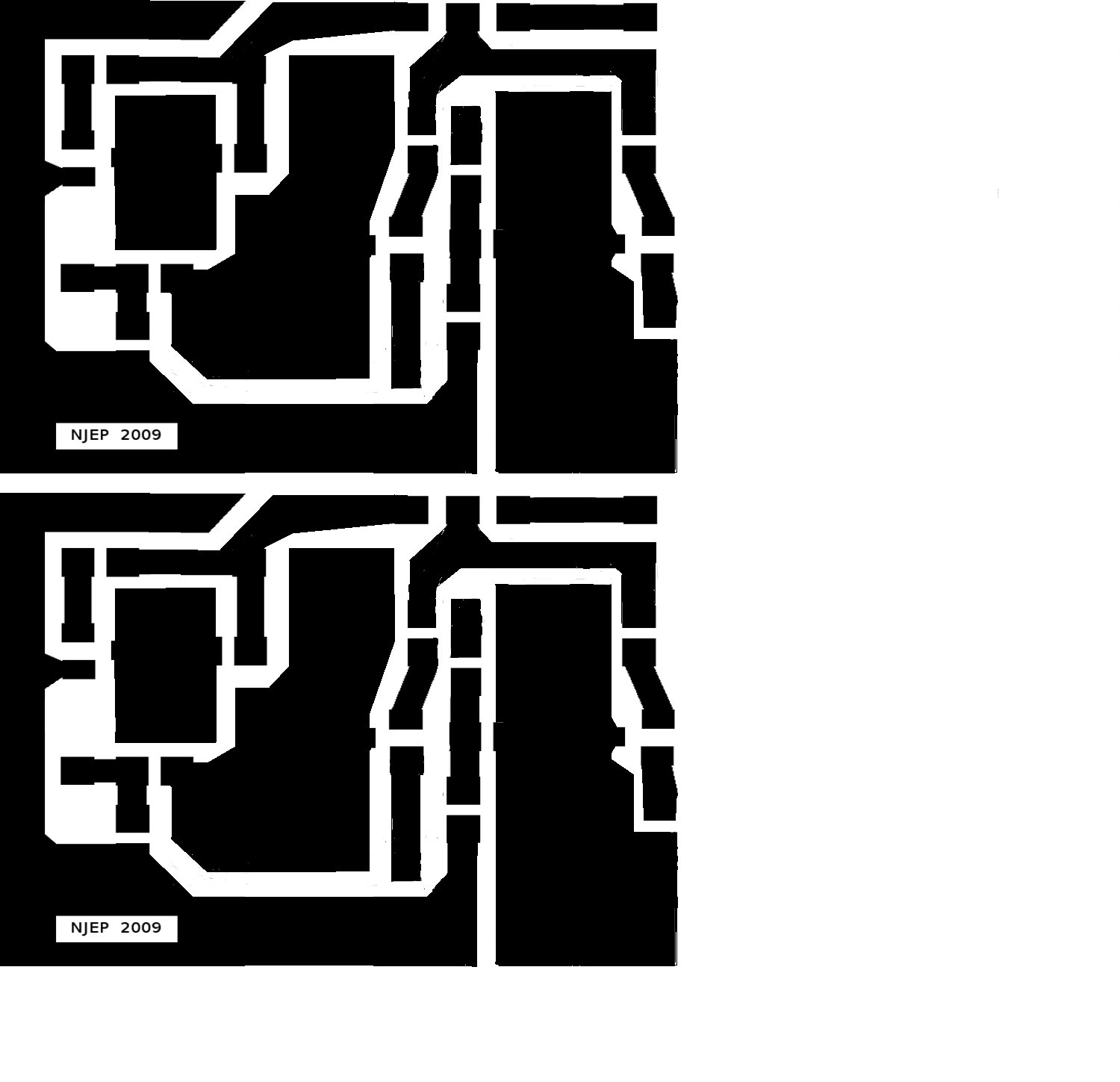

OK, so here's a PCB design adapted from the last one. The jfets now face the same way, so nouse of the symmetry of the devices. I've also decided to use a normal resistor for R1 instead of SMD, which means I can try 680R for R1 as juma suggested above. Since this gives me a jump on the board it also allows for slightly larger "heatsink" areas on all three of the jfets.
As always, all comments welcome.
juma: Why did you choose 680R as the new value for R1? It seems a rather large jump from 470R. If we have slightly larger heatsink areas on this new PCB would 560R (or something like it) be reasonable? Or still do ZMs Cu thingies instead?

P. S. I realise the picture has two copies of the board - sorry, it's too late to fix it now...
We want lower Id through JFET and we want to keep the same Vgs on amplifying MOSFET. The obvious way to do it is to increase R1.
Are your jfets running as hot as 60 deg also?
Yes - a few degrees more or less (they are hot but I have no way to measure exactly)
