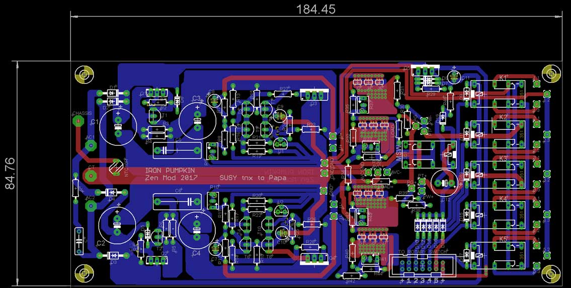

You can spend time working on chassis , taking in account dimensions form above posted screenshots.
DB pcbs you can use wherever you want , or you can cut them adequately, and have Good Gemini boards for something else

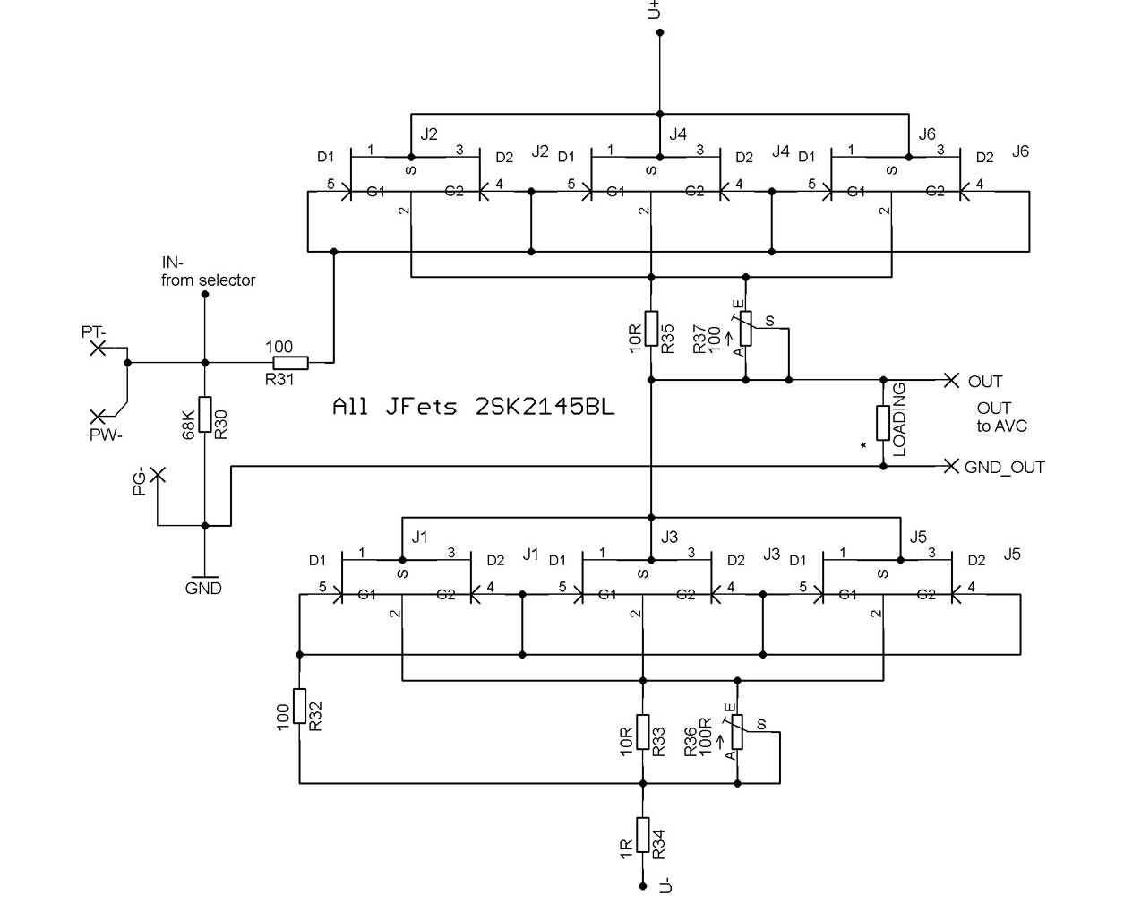

and what's of 2SK170 ?
-they're available
-they're small
-they're cheap
-I intend to use 3 small critters in parallel , effectively 6 JFets in parallel , in each position (3 up, 3 down)
when you use 3+3 in same sex buffer , they're having same THD spectra as Toshiba complementary buffer , with even better loading capability , while having superior tempco behavior
Great idea! Can I do it with 6x bf862 or J309?
as I wrote in several places , regarding J309 , and that pretty much includes BF862 - those are parts having higher Idss , so when you want to use them in buffer in Toshiba style , source resistor needs to be of highish value , comparing to Toshiba parts ;
highish value of source resistor is directly increasing Rout of stage , so no go
enclosed schm of buffer stage ..... just as reminder that there is no free lunch here ..... if you want both simplicity and performance , no way around ......
I'm satisfied with DB buffer , but this one is simpler to make , with few benefits more
