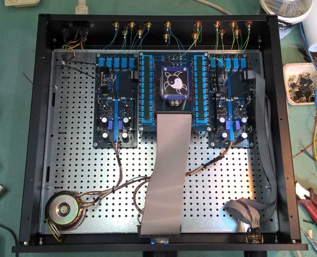

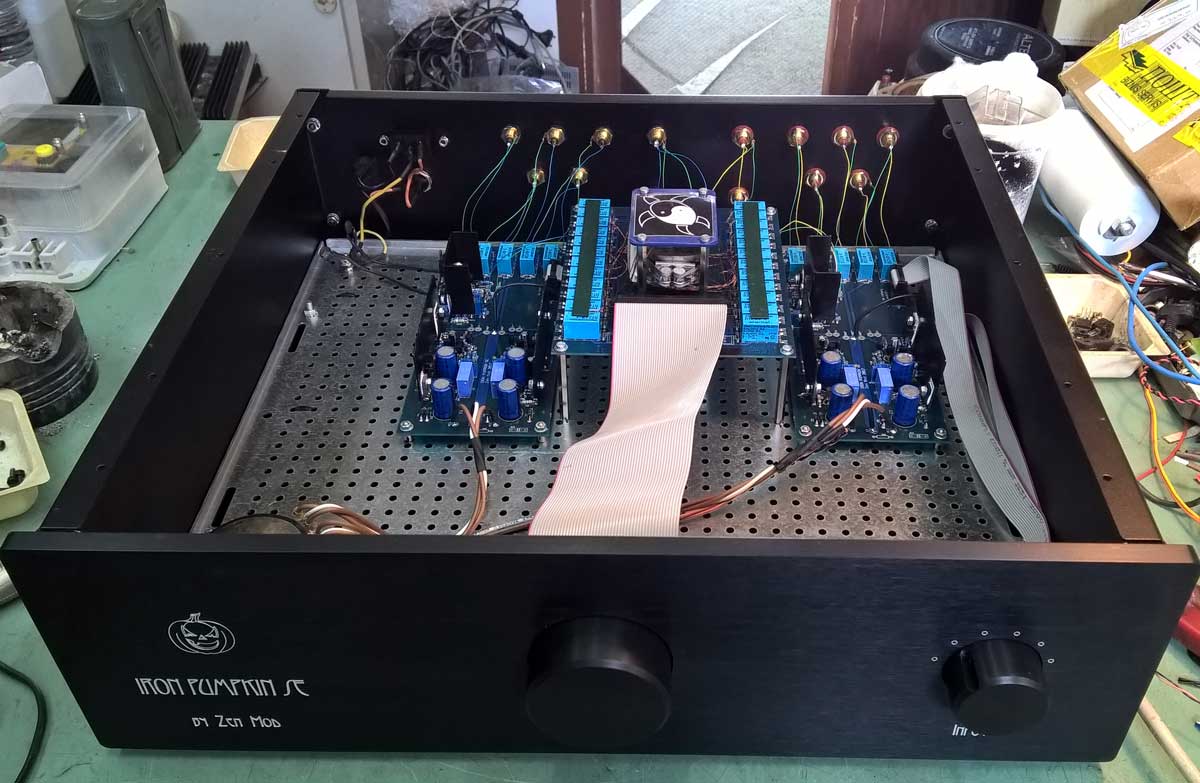

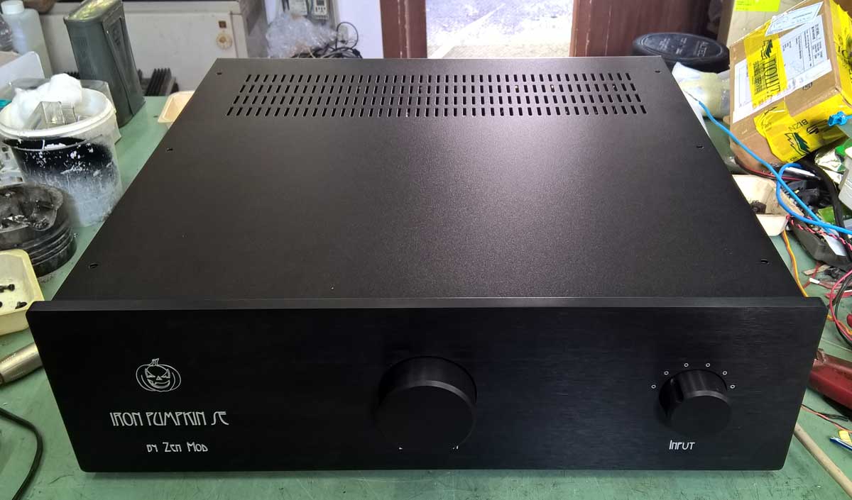

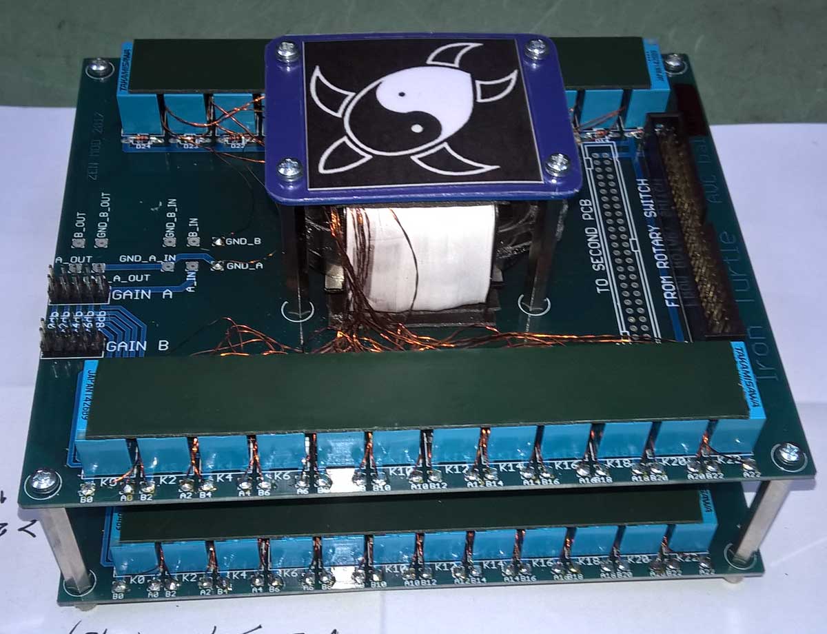

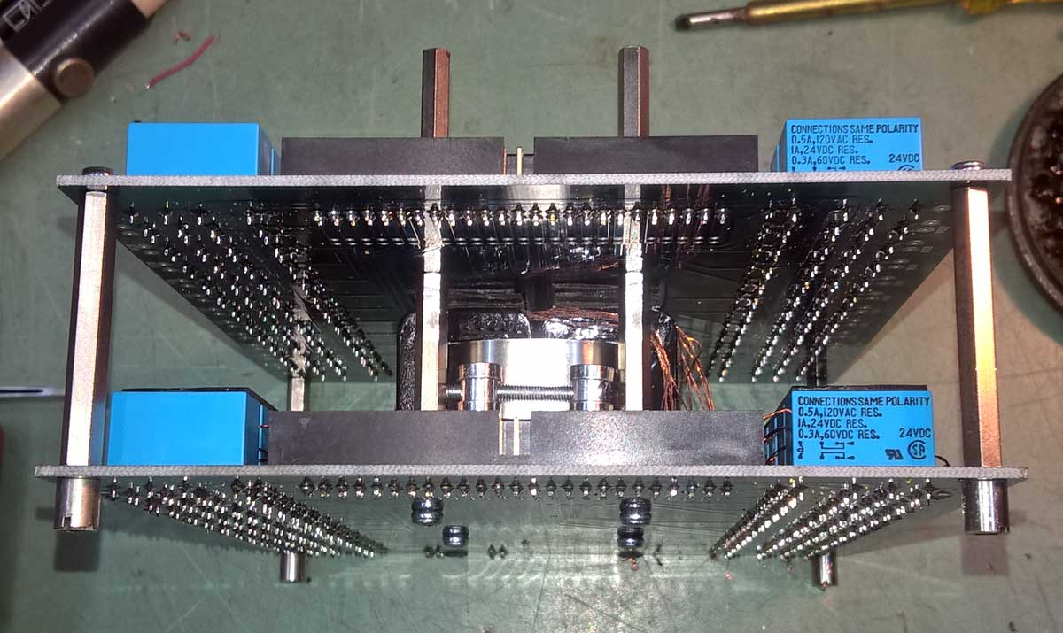

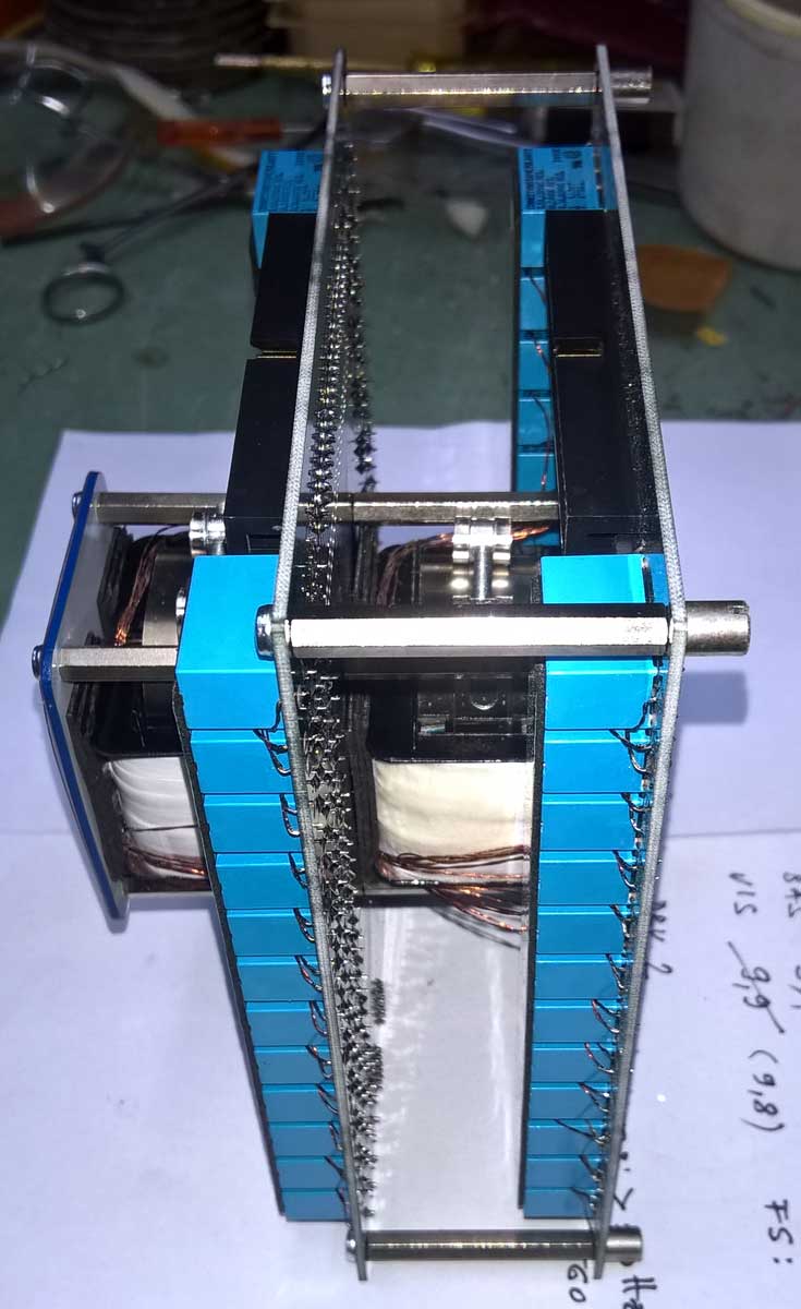

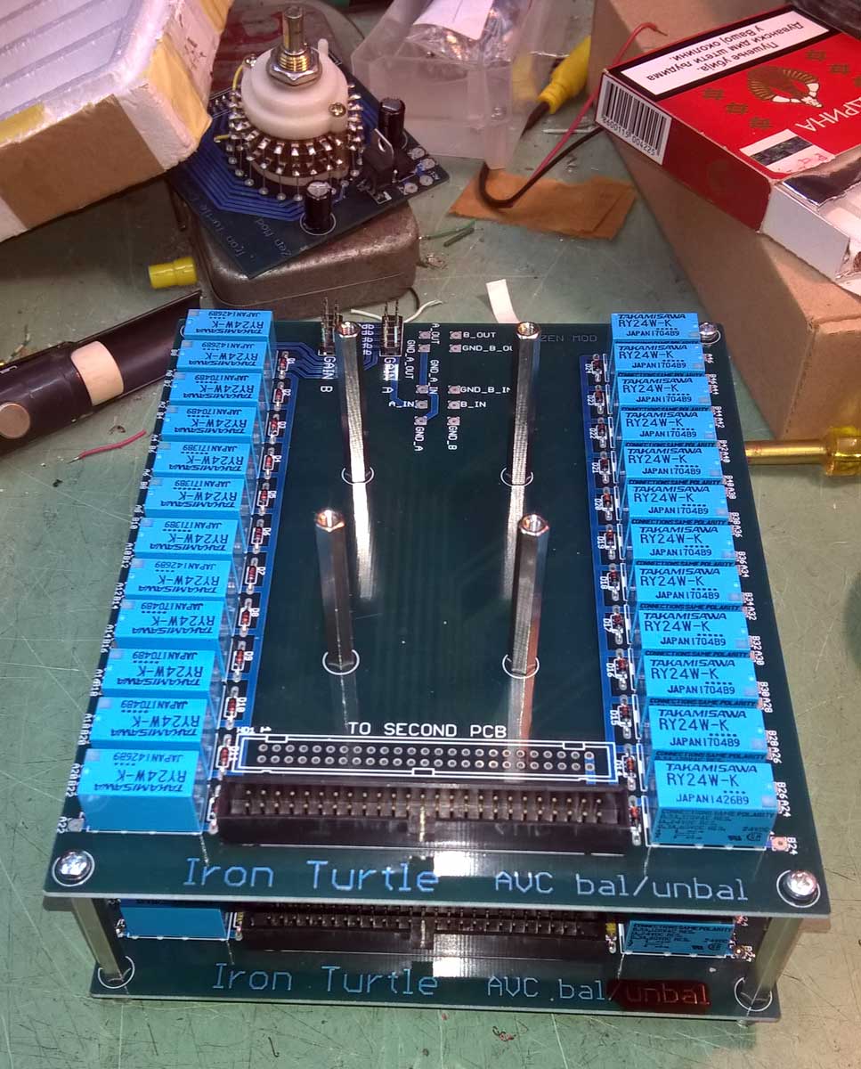

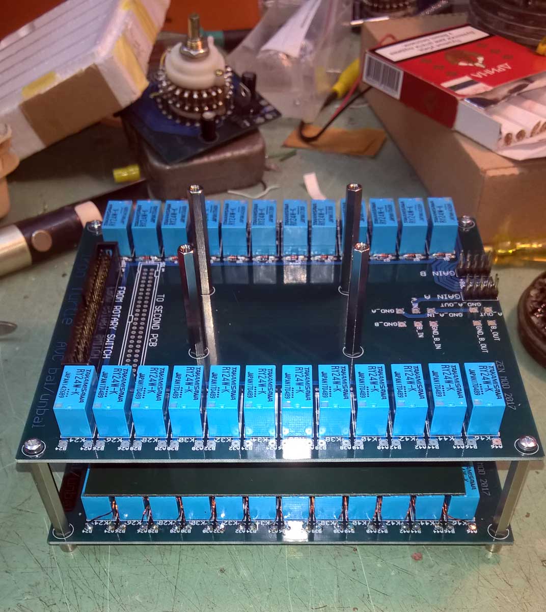

got buttons too

Dear ZM,
I was referring to (you know my level of competence) the diamond buffer and the resistor between input and ground. Looks to be 23k (or so).
Does this set the input impedance?
Could it be made higher?
Thanks,
Thanks,

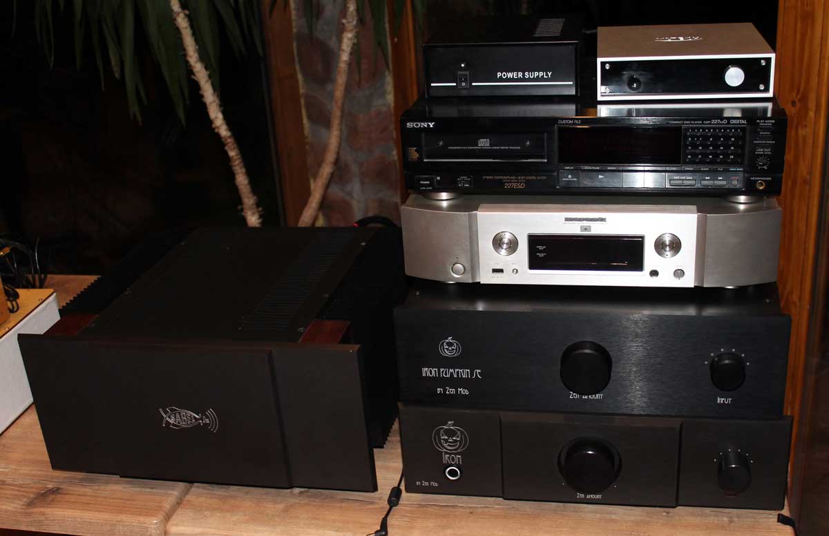

Frugly, hahahah
A nice family it is Zen....😀

Dear ZM,
Thanks,
Rick , sorry for not seeing your post sooner
considering that this diamond buffer is made with BJTs , going to higher value of input gnd reference will result in more slide (lesser stability) of output offset
base current , that's it
however , I'm making some steps in direction of mosfet based Diamond buffer , which will address exactly that issue ; will not work nor sound better than this one , but will have greater input impedance

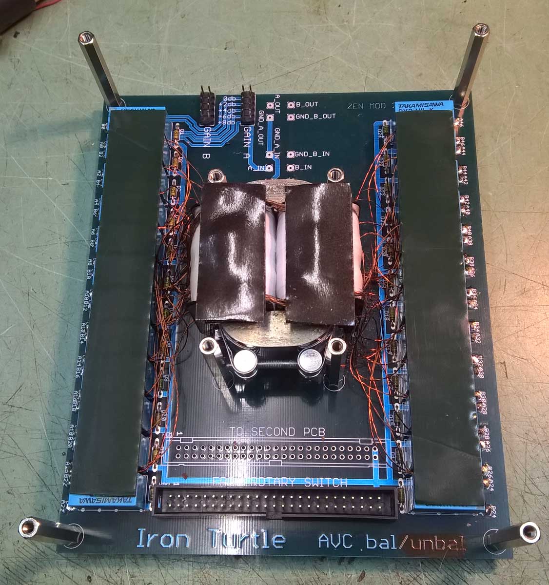

Several ordered SE Iron Turtle/Pumpkin finished and waiting just few eenytiny bitsies to arrive ( flat cable connectors and such) , impatient to be sent abroad
while waiting , I'm working on Papaturtle , one channel already wired

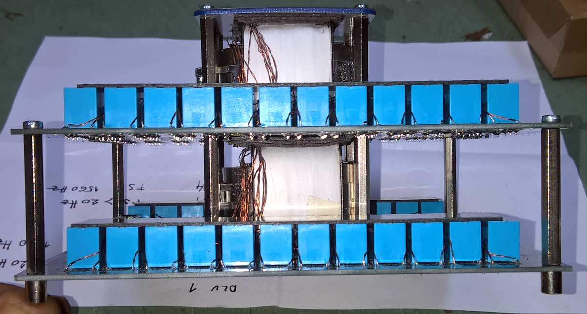

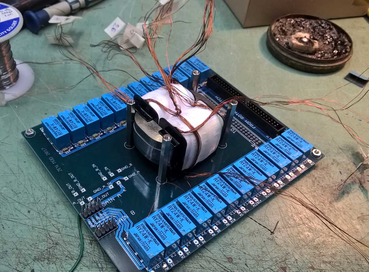

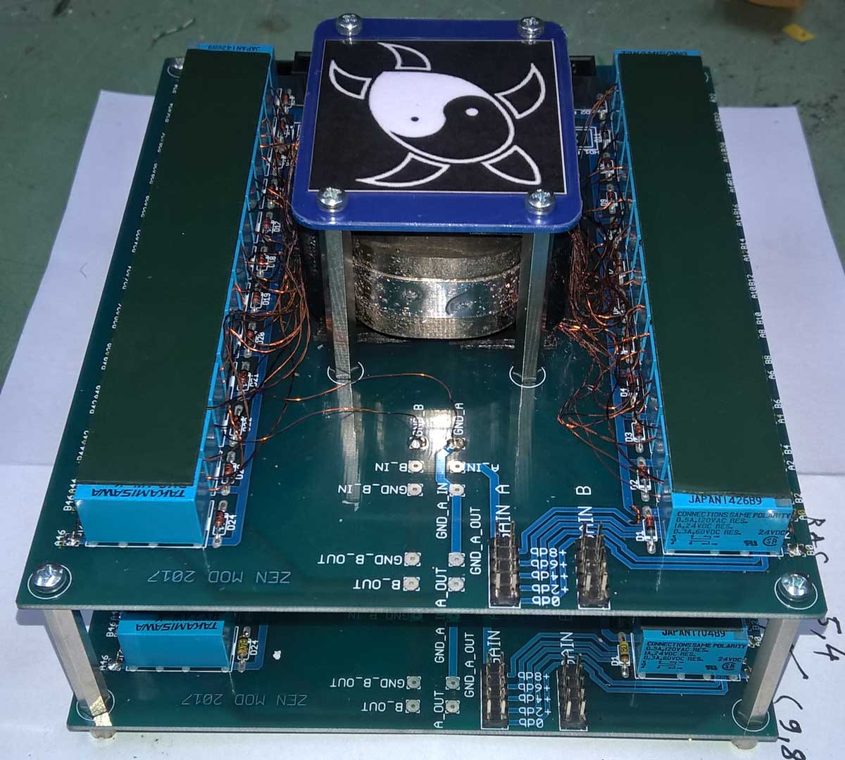

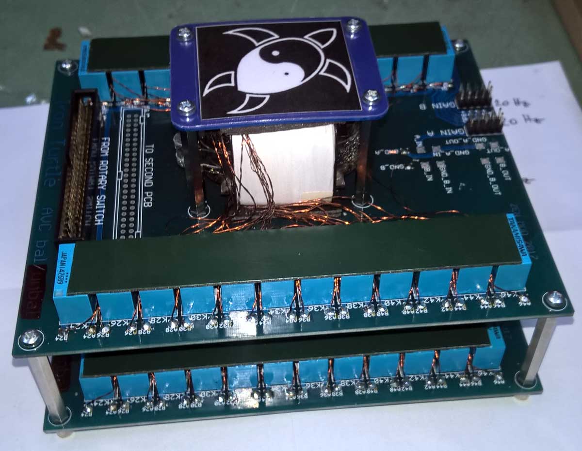

it is PITA ..... zillion of tiny wires , needing cleaning of enamel and tinning , taking care of numbers and position
but .... it's not just relaxing , it's deeply enjoyable
How do you clean the enamel?
I take an aspirine (acetylsalicylic acid) and push the enamel wire and the soldering iron together on the aspirine and the enamel comes of.
Old trick🙂
The fumes coming of, hurts your eyes, so not a healthy way. 😀

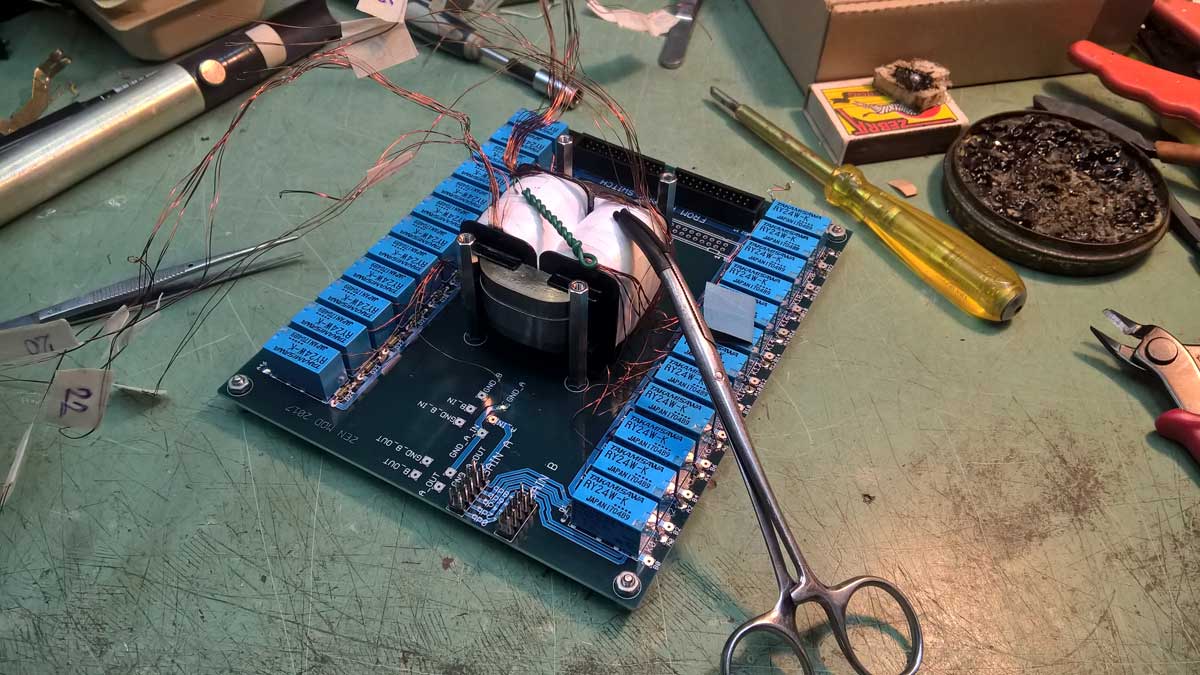

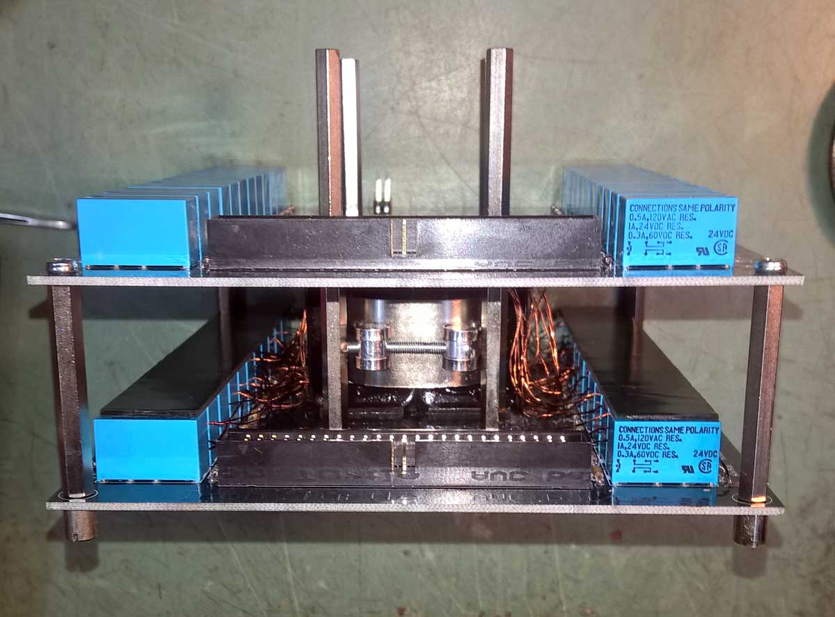

define length, fold/make loop , cut rest ,hook ,twist, unhook , grip wire with forceps (thermo-tube on jaws , so easy on wire) , brush end with sandpaper
then calophone and solder bath ( small well in piece of teflon)
tried eons ago with aspirine , hate fumes and lack of consistence ; it works with some enamels, not with others
calophone , teflon solder bath (on box of matches),hook , forceps and sandpaper visible on second pic
my constant green is on this side of (phone) camera

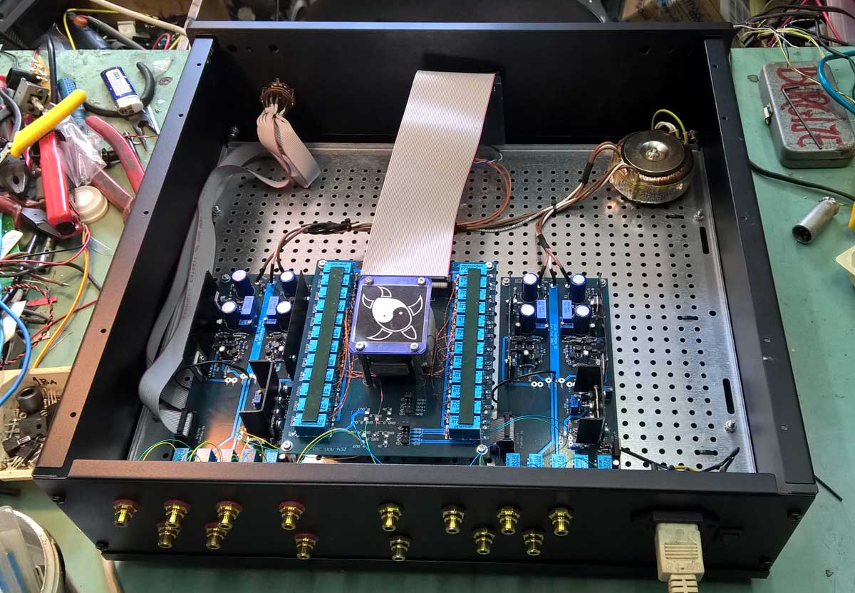

finished Papaturtle 😛
