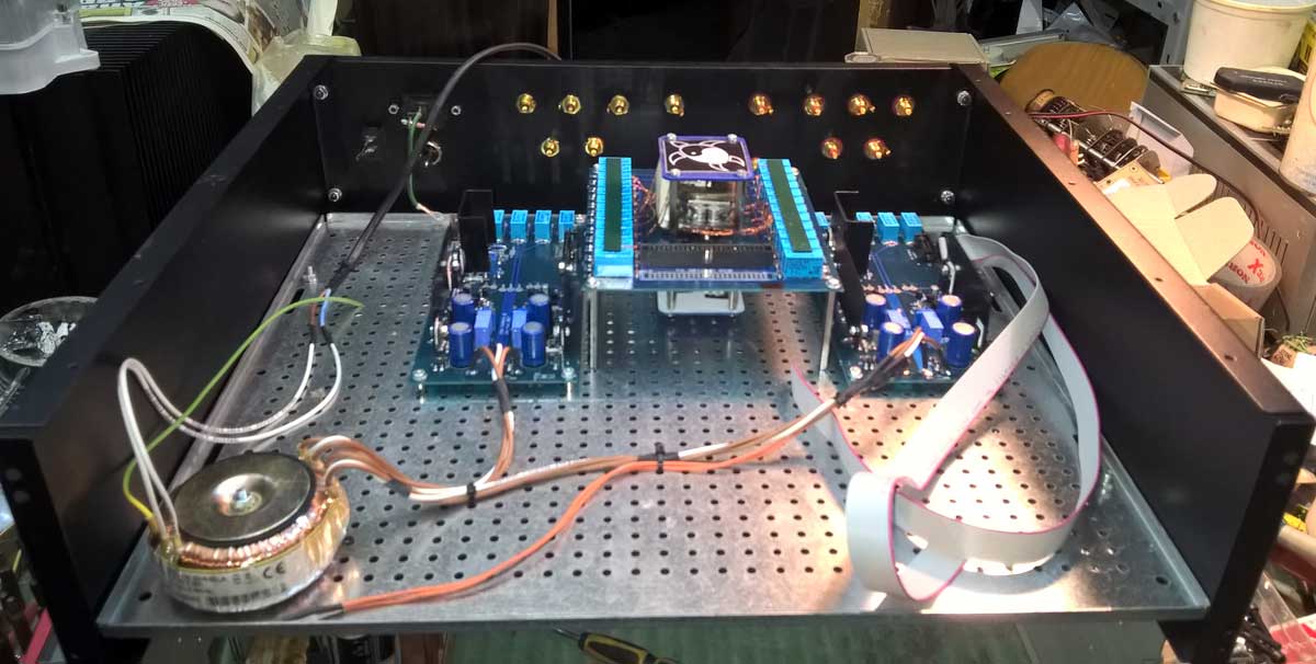

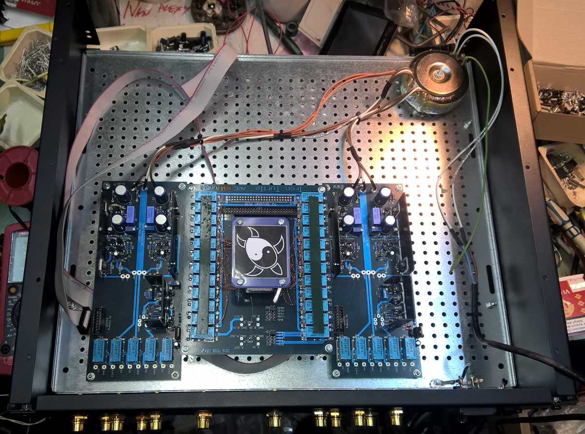

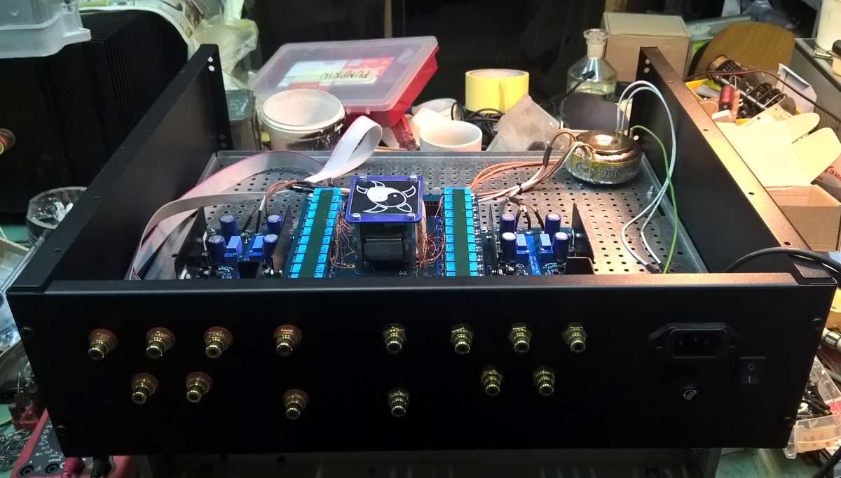

working on Iron Pumpkin SE demo specimen
HiFi2000 case , 3HE/400 , bought few years ago
slowly getting missing bits 'n' pieces for case
now , just to send front for beautification
