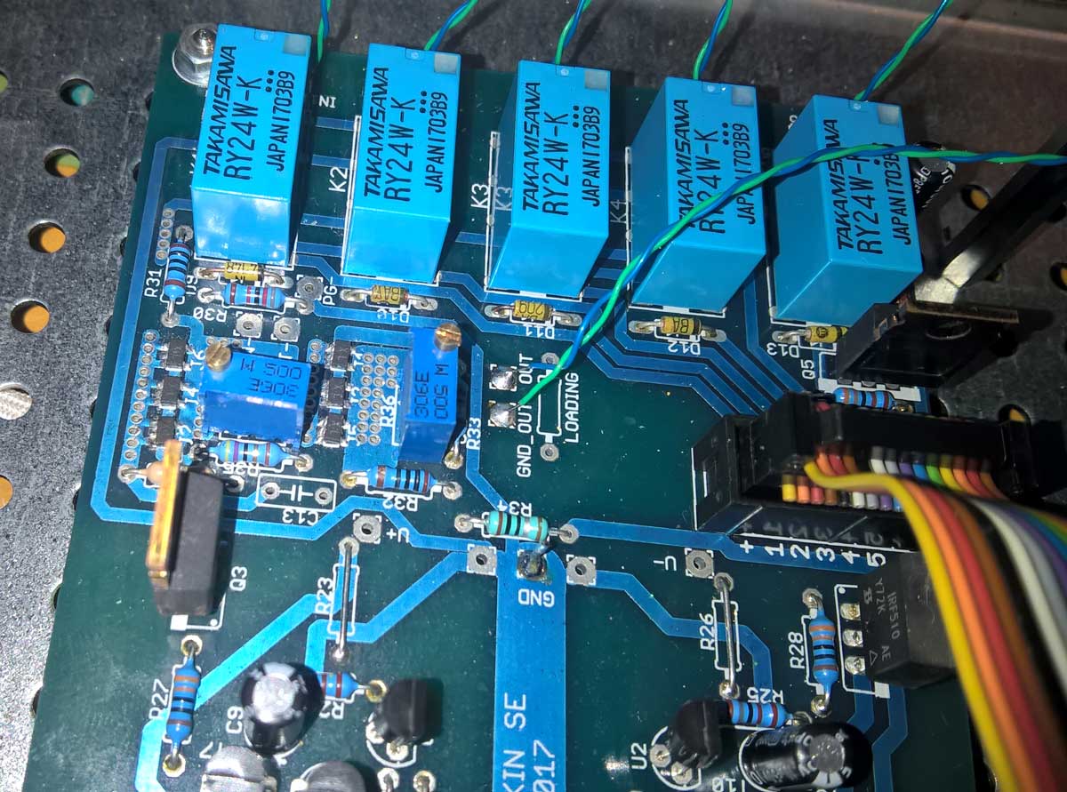

xformer prescribed - 30Vct to 36Vct , minimum 150mA , one per channel , to preserve dual mono arrangement
or - if you're able to get custom one , use one with two sets of 30Vct (to 36Vct) secondaries , 300mA minimum

@ZM, do you have a dealer for the 2x30Vct Trafo? Space is little in my case, but i didn´t found dealer for 2x30vct. Two of the donuts woud be too big, and i´d go for one 30Vct otherwise and leave the separation to the shunts : )

what you mean by - do you have a dealer ?
you mean , my local one ?
I have , several ,pretty much always ordering custom (regular production being in industrial range of values) ...... though , I can't tell are they willing to send out of country
send me an email in few days , I'll check in a meantime what can be done
in any case , shunts will do what's expected with rails , but once you connect GNDs of two channels , there is a headache on the horizon
so , leave them separated , on any price ....
