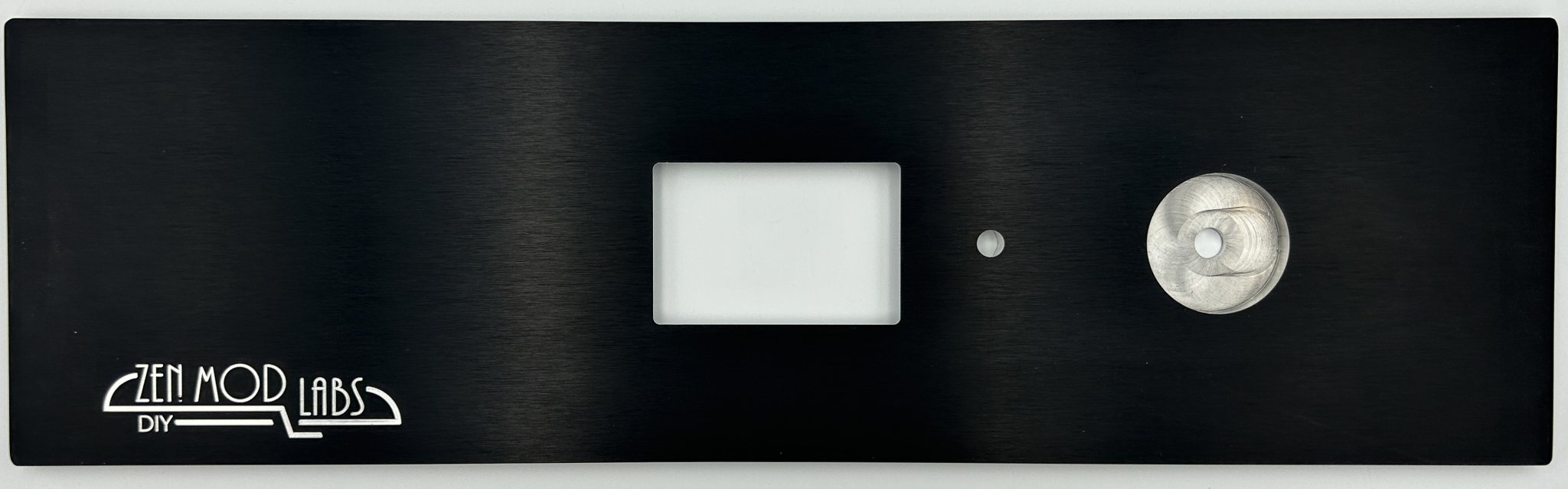

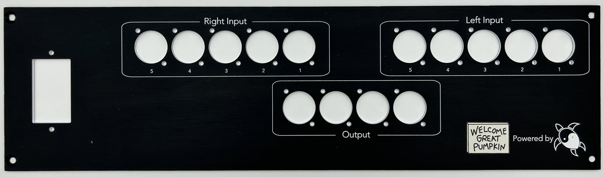

After long and careful deliberation, I have a product improvement suggestion that is in keeping with my adherence to the KISS philosophy in all things.
It has nothing to do with sound quality but is purely esthetic as that is the only arena I feel qualified to hold forth in regarding the Iron Pumpkin.
Enlarge the fierce pumpkin logo 2.5x, then place small, dim, blue LED's in his eyes replacing the bright ones under the Zen Amount knob.
May also serve as an effective gremlin deterrent, not to mention being beyond cowabunga cool.

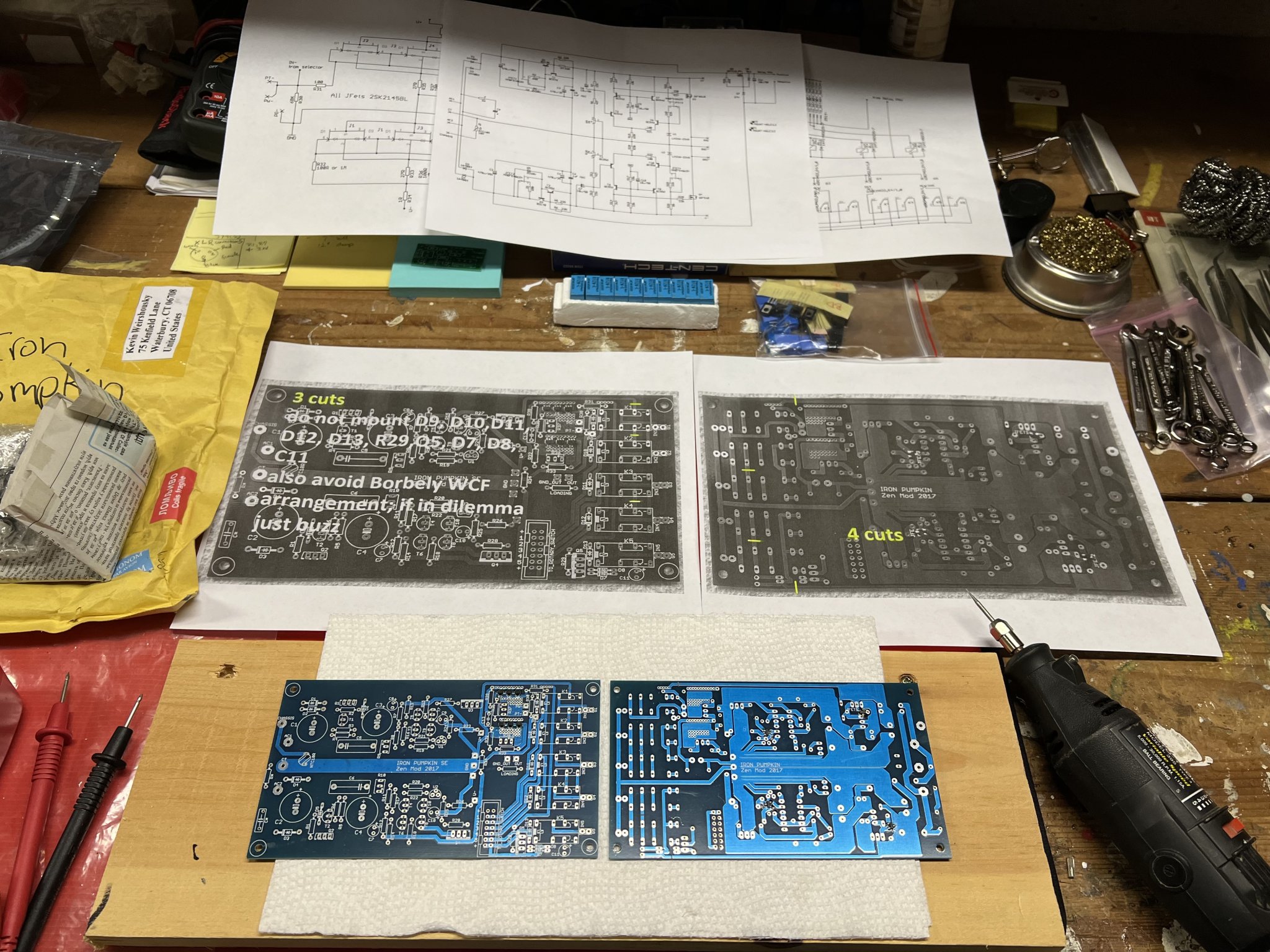

Well it seems to have taken me about 5 years…but I finally started “working” on my Iron Pumpkin!
Lots of of projects and distractions during that time. I won a set of Babelfish J2 PCBs at the BAF 2019 raffle which led to building a pair of stereo BJ2.
Believe it or not, I think ZMs guidance in the KISS thread was a pretty big contributing factor in my procrastination on this preamp. Once I was able to shoe-horn some Jensen iron in the back of my DCB1 I fell in love with it.
This will probably take me forever to finish, but now I have some motivation in the form of fancy casework on it’s way from Italy.

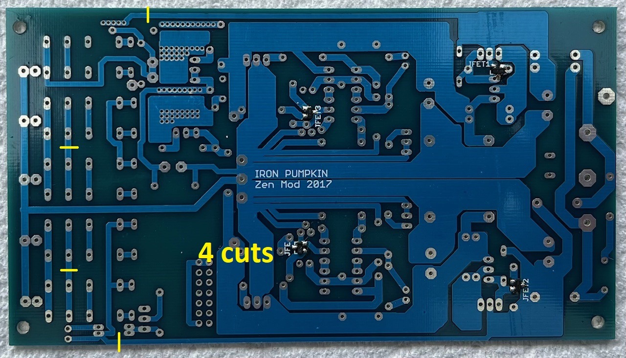

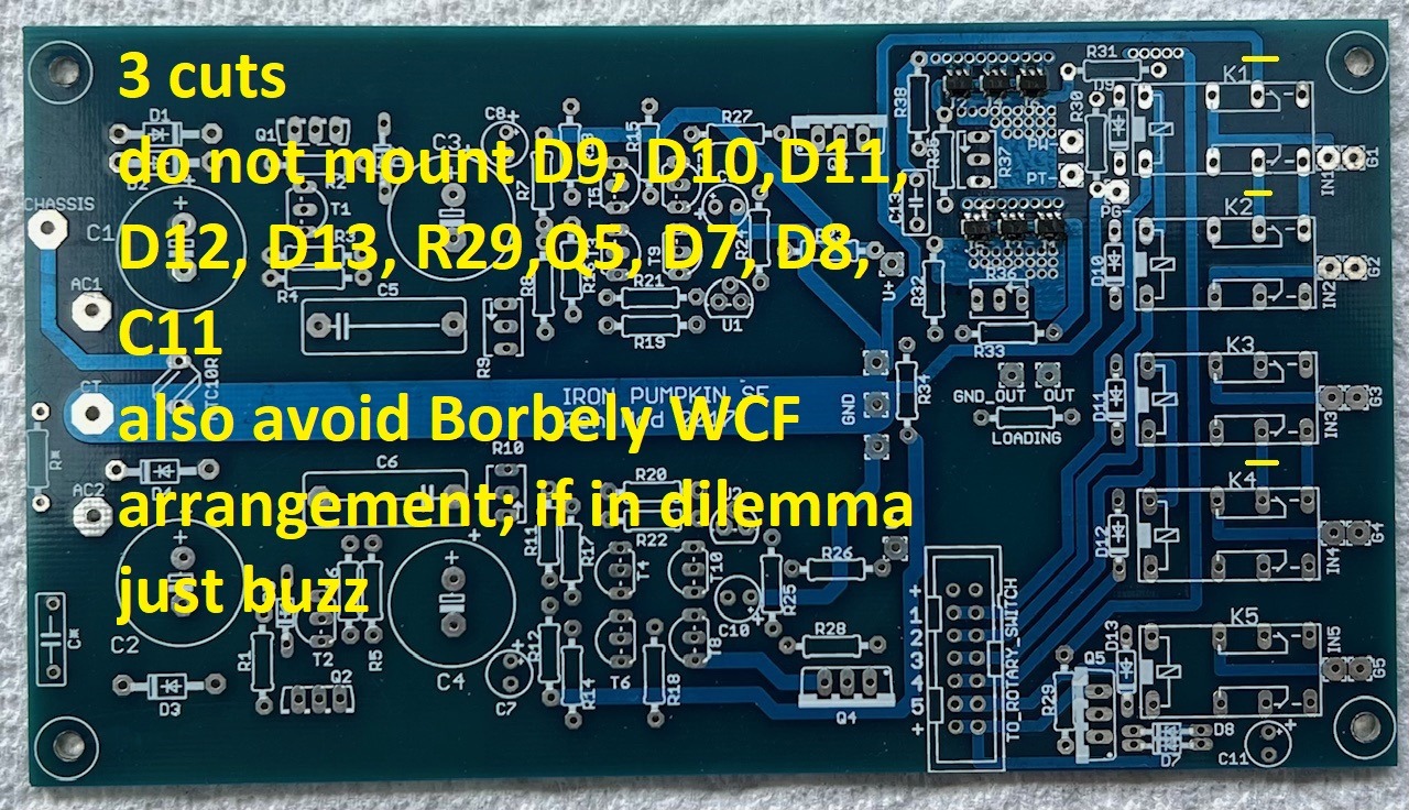

Our fearless (Greedy Boy) leader currently has my request for a Logic kit in his que.
Since my boards are older and were intended for use with rotary switches I’ll have to start by making some alterations to them so the Logic kit will work properly.
Rather than nag ZM via email I figured I’ll post here in case others might have older boards like me and want to do the same thing.
Also, it always helps to have more than one set of eyes to point out stupid mistakes 😉
I printed out what I believe is the appropriate version circuit diagrams from post #136.
So for now all I had to do is follow the bouncing ball…ZM sent me
some pics of where to start cutting traces.
Buzz buzz buzz went the Dremel…

I don’t think we need to go over the benefits of a nice long screw here😉
Looking at those itty bitty NTC on your board…and thinking I don’t gots them😒

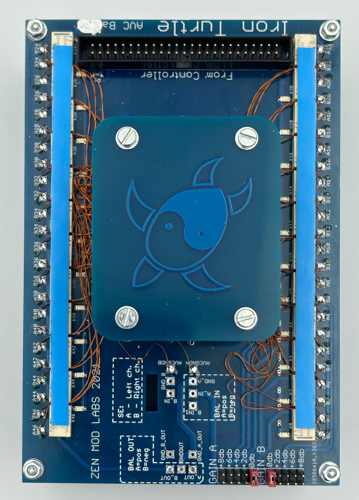

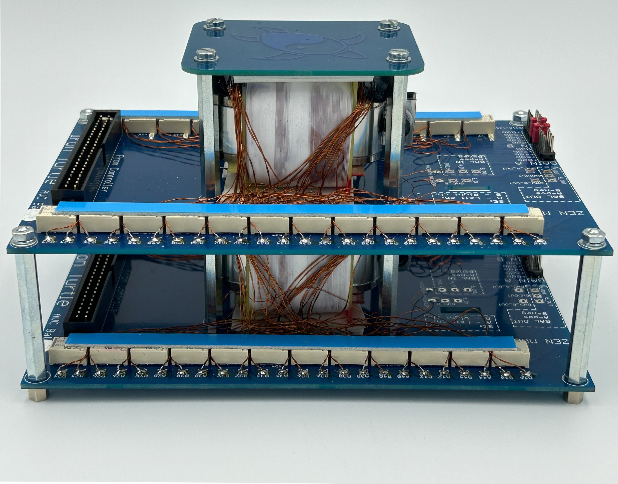

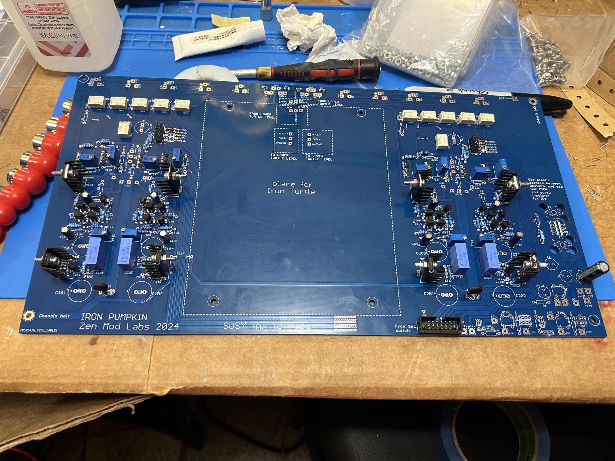

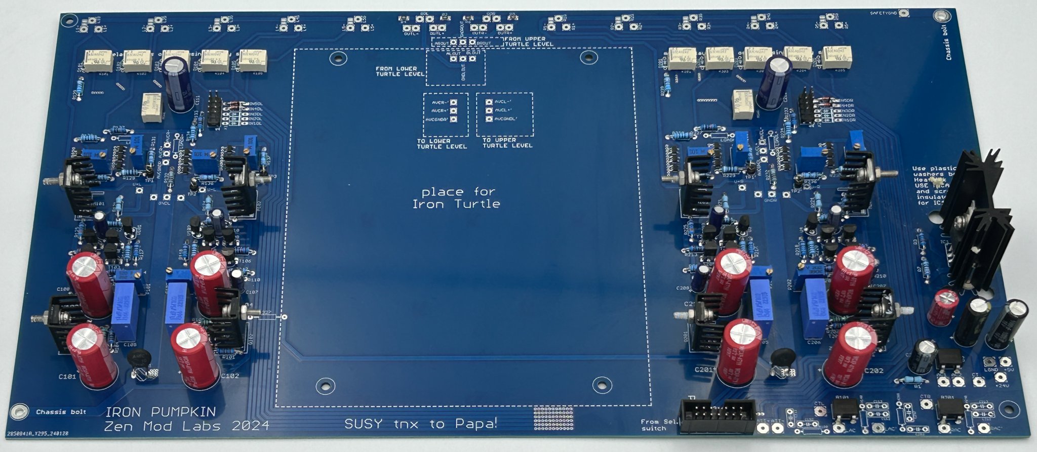

@MZM…I was thinking about your decision to turn both channel boards into one big one. I know you commented somewhere on the decision, but can’t remember main reason. Was part of it to have a large ground plane under turtle to help with shielding?
I have some raw copper PCB board I could mount under my turtle. Not sure if it’s worth the effort or if it should be tied to the ground plane of the boards.
