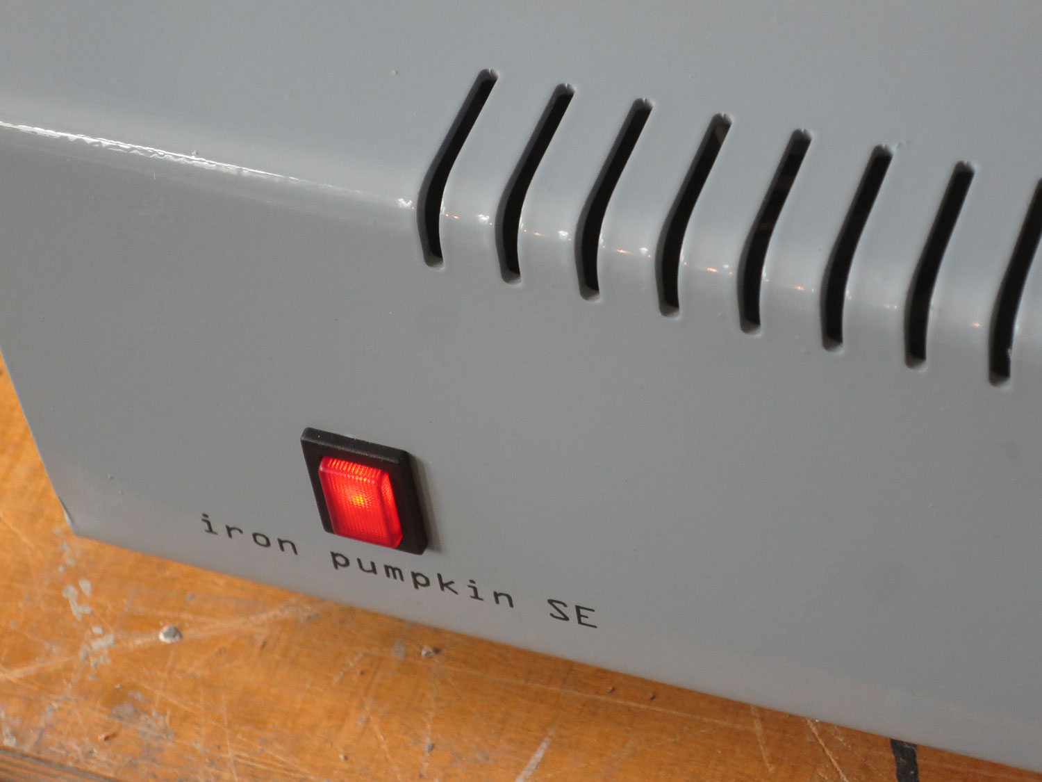

i really owe you a listening report. It won´t be a well done reflected Mikorist „Musterschüler“ review of „Spitzenklasse“ equipment. It is still eating fuses and i really have to check what it is. It just eats them when powering on the preamp. Every fifth time or so.

if you put some biggie caps right after Graetz bridges , it'll eat fuses naturally
I'm using 470uF there ( no need for more due to superduperity of reg itself) and T160mA fuses , without problem
go to T250mA or put 10R NTC in mains , as with power amp

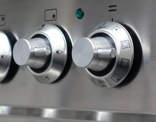

ZM, say, you already opened the 24 steps switch. Is there a chance to reduce needed force to turn da knob (klick)? Guess there is little iron ball with spring...
I opened it , as I wrote , and greased everything with that teuer graphiteblahblah grease
small ball and spring are contained in cavity of front white part of switch , and you can't reach it , because indexed circle plate is sort of riveted
don't use force - use bigger button
edit: what size of fuse you ended with ?
Donut is 30VA, if I didn't wrote that earlier ......
thanks for knob info, i just didn´t want to open switch with shooting spring loaded parts flying around my head and vanish in the holes of old wooden floor : )
about fuse: it is not that annoying and end of week i´ll have time to care about more properly cabeling, recheck again, and than i´ll might go to a higher value.
got 20 fuses more to spend , or i just don´t turn it off : )
[/QUOTE
the knobs of my oven...hmm, not so bad..
