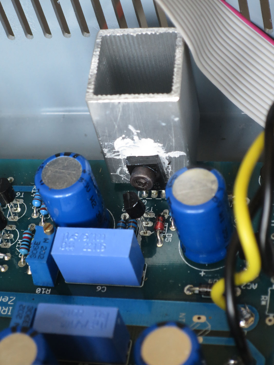

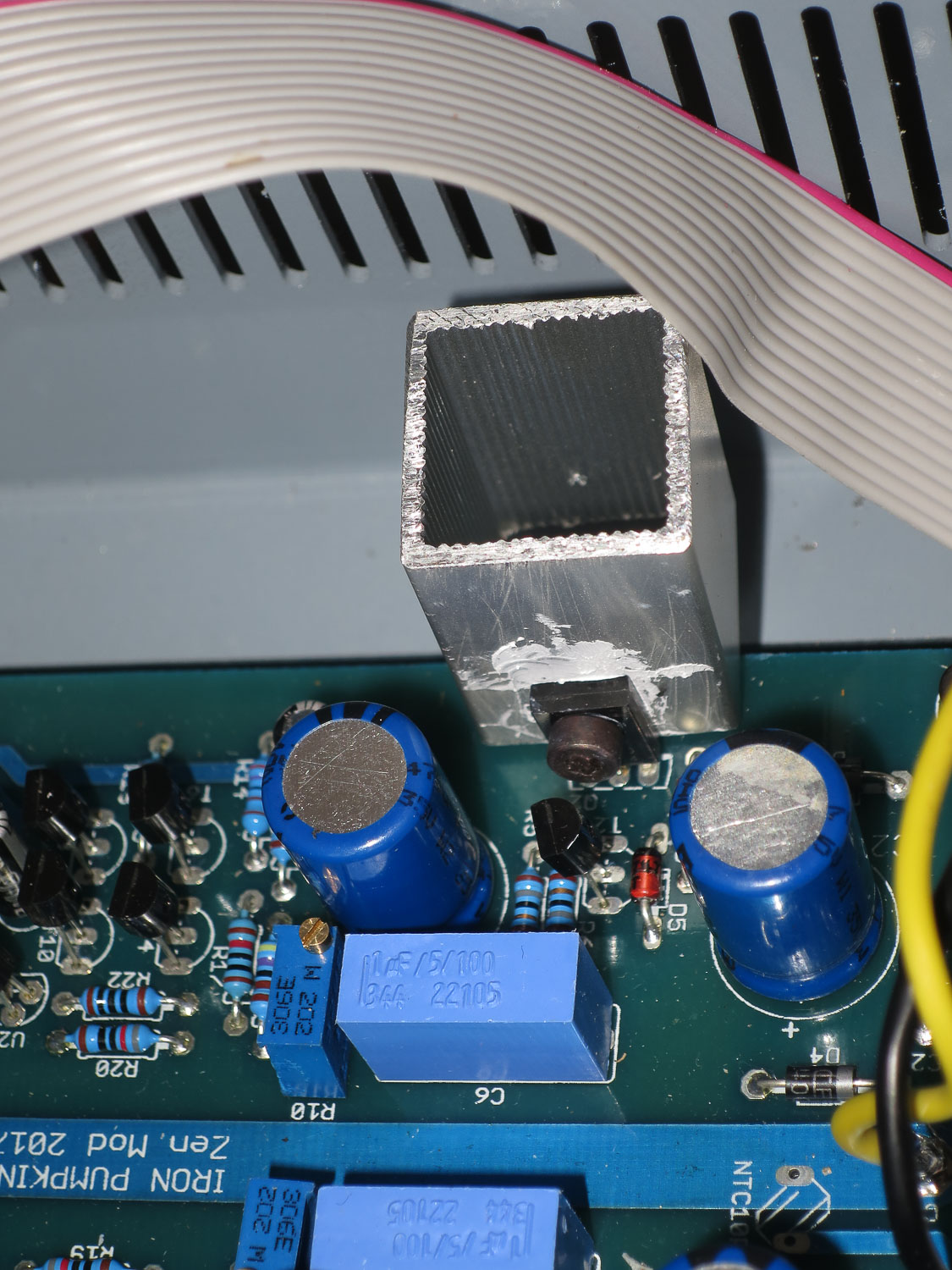

R9 R10 shunt reg
before biasing buffer, guess the shunt reg has to be set.
-Can we measure it (12V) on the V+,V- pads on PCB?
-Is poti (R9/10)preset critical?

yup , I've put these pads there exactly for measurements purpose......
if you're sure in your work (parts placement etc.) and properly set trimpots in buffer (lower one-CCS- set to max ) just bang it ....... set Good Gemini voltages (+/-12Vdc) , and then proceed to setting output buffers
of course - connect Turtle to channel pcbs only when you already set buffer DC output offset

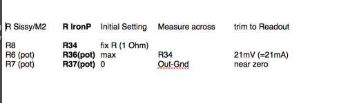

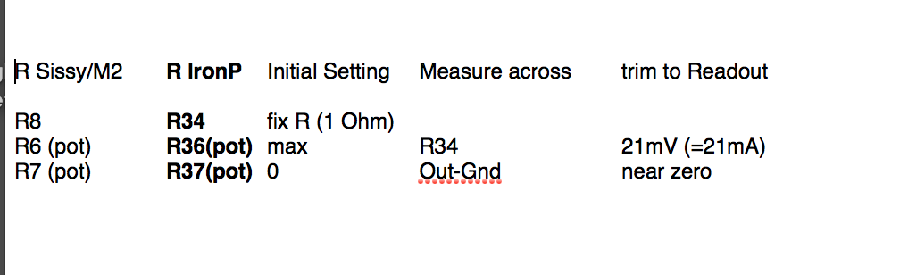

shunt regs were about 12,5 initially, easy to trim.
initial bias was about 17 mA, easy to trim to 21mV across R34 also. I was at least clever enough to leave some hight on R34 for easy measuring.
Offset also easy to trim!

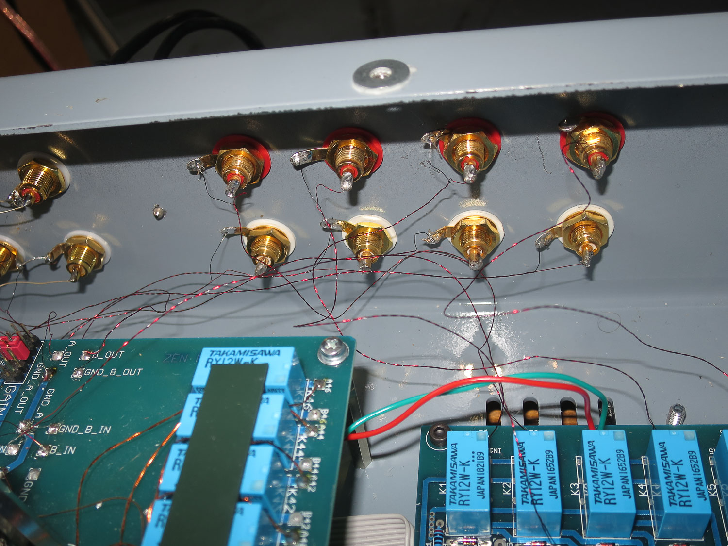

i have just one set RCA cables (from COmputer) pluged in. When i dial another source (so empty RCA on Preamp) i have a quite a loud distorted signal (on all other souces/emty RCAs). turning the pot does not change Level of distorted signal. When i pull out one RCA plug there is just undistorted signal on the chosen source...and complete silence on the other sources..

post some pics and I'll help ; you certainly swapped gnd and hot somewhere
as I made it - all unused inputs are hard grounded , only used input is open and connected to buffer input

dear ZM, had some time to comb the signal hairlike cables and crosstalk is gone : )
Also fuse is staying. Maybe it was the caps conditioning or so.
Crazynice preamp. A real joy to make. Not just convenientwise (flatcables), also conceptwise, with good buffer, thank god presoldered jfets : ), a more or less custom made autoformer, the whole relaythingie and last not least, thank god no remote conrol 🙂
you made some reallly big ookup with cables , if you had xtalk
as I said - inactive inputs are hard grounded ......

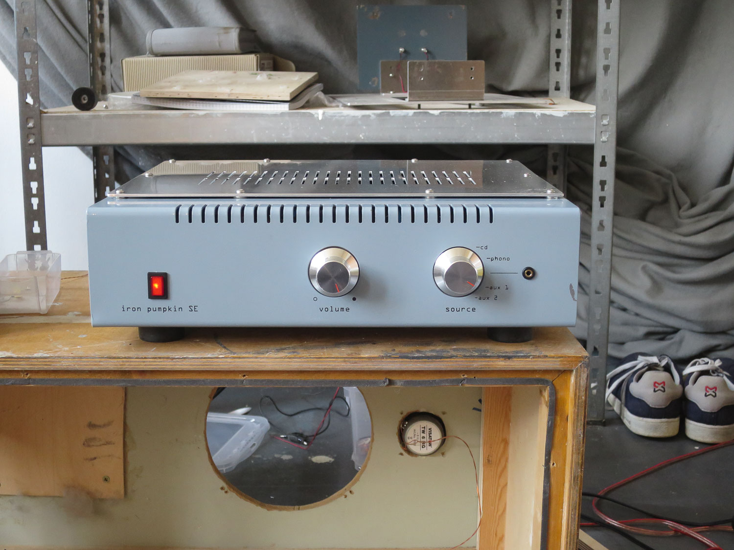

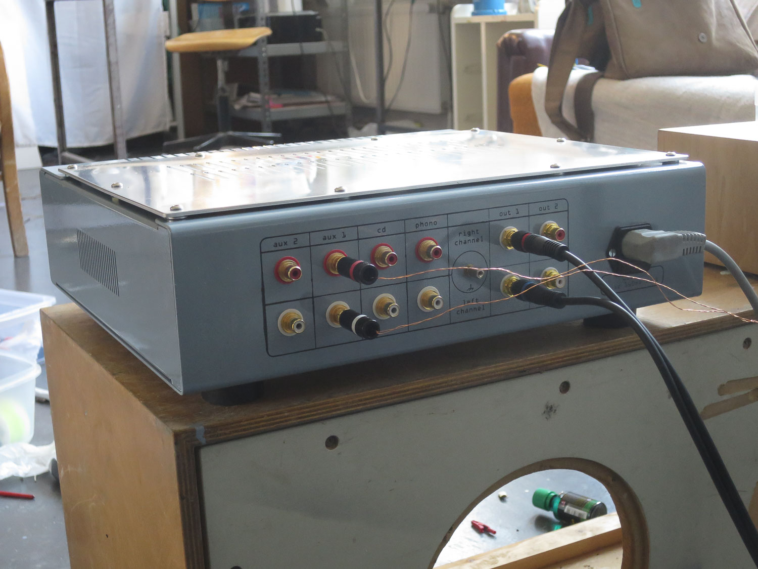

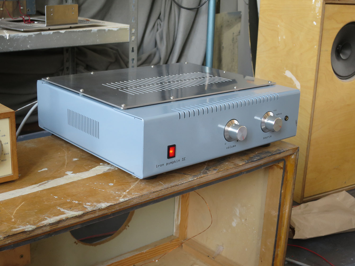

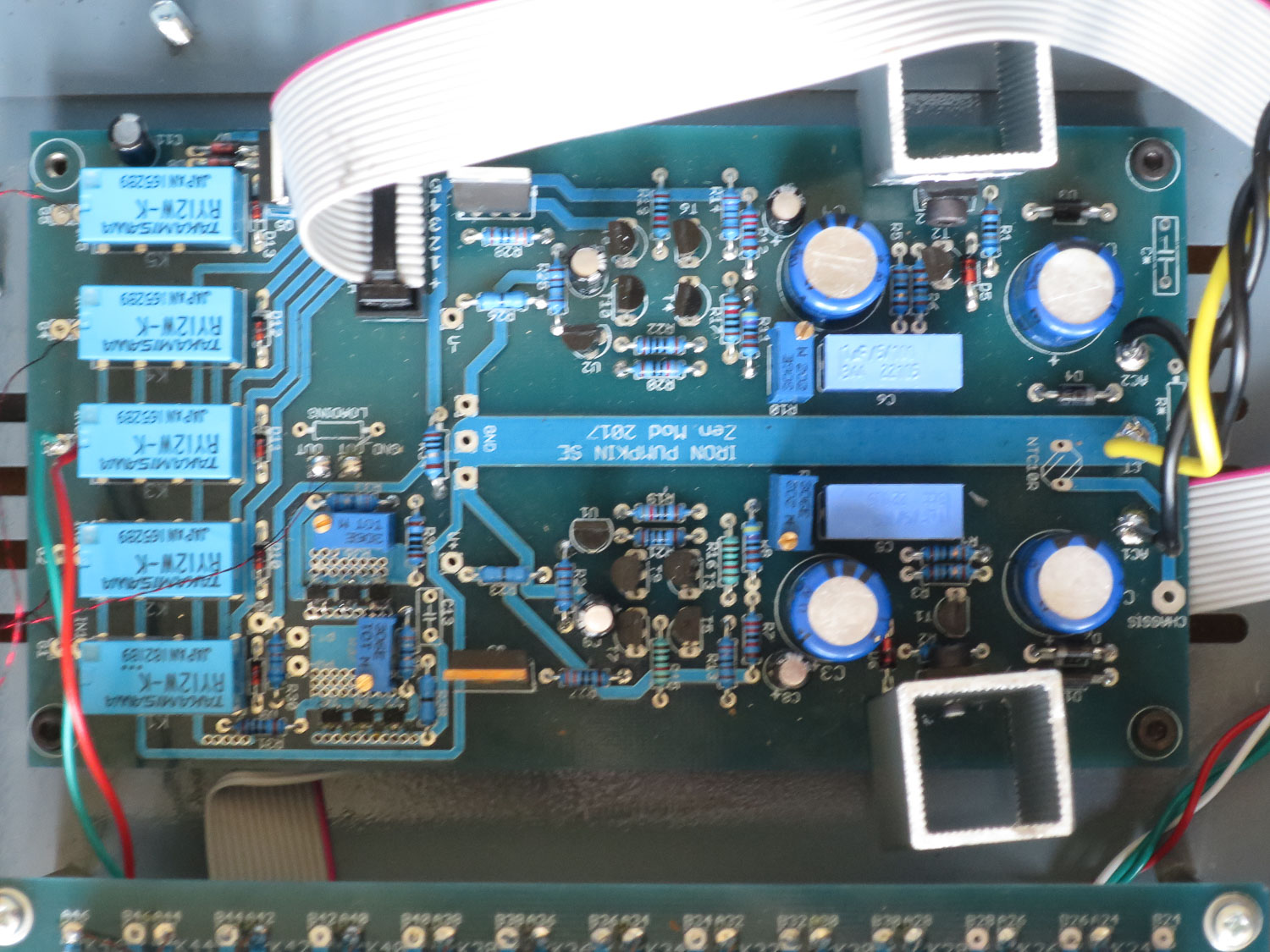

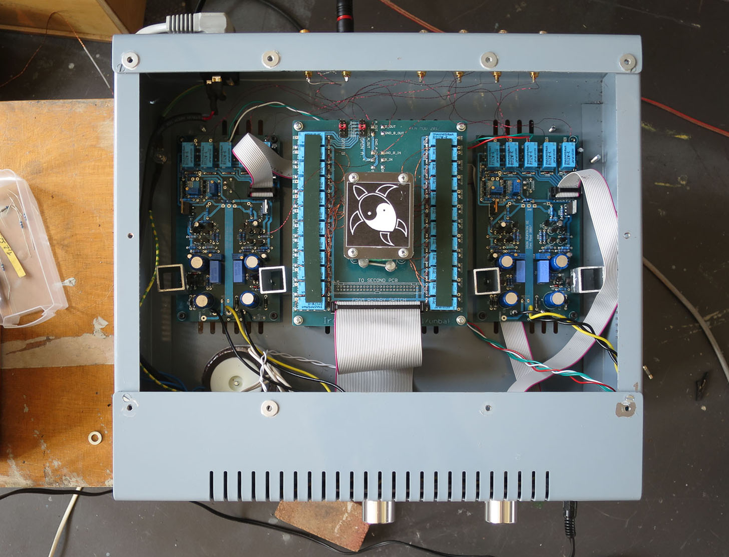

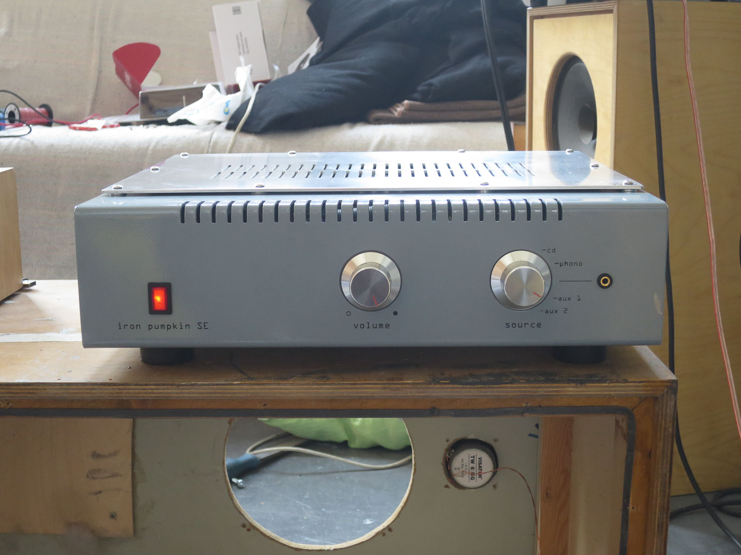

a piccie, but its also in the gallery
It´s singing just for few minutes, but soundwise great depth, dynamics, all there
nice ......... even if just one pic
Fugly!
i guess it´s funny having the pics here too,
you deserved it : )
