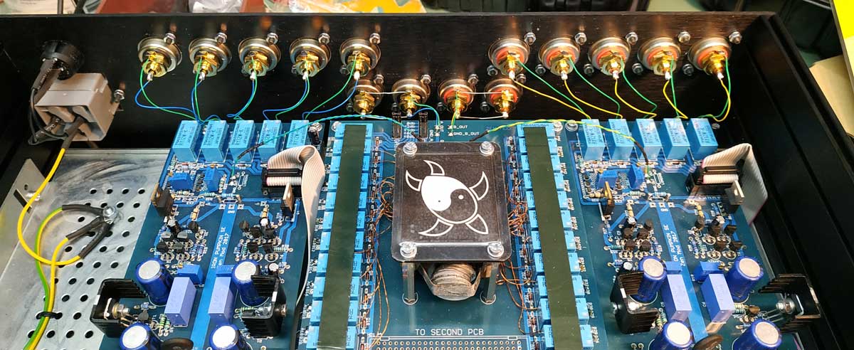

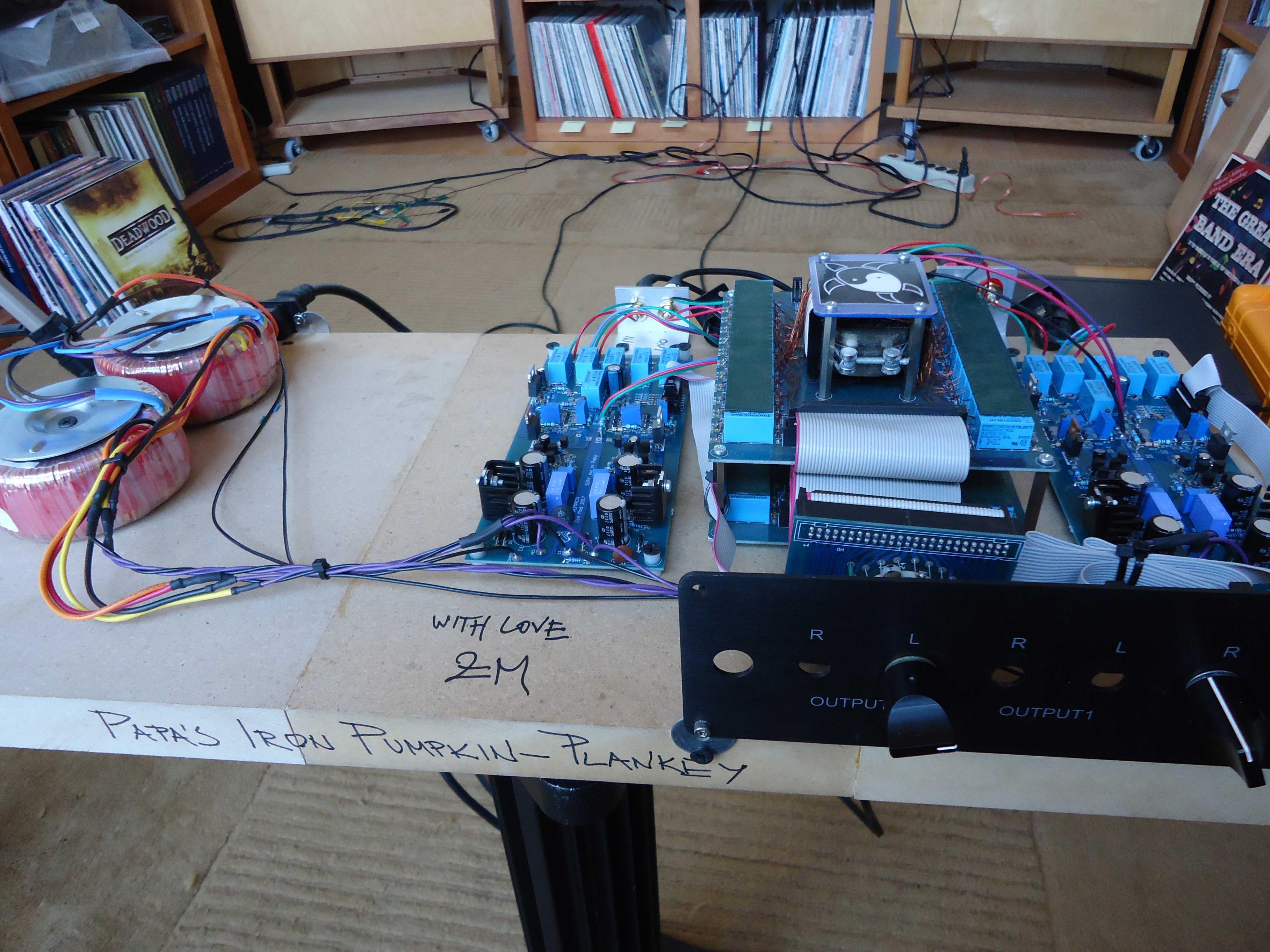

6. Iron Pumpkin (Bal) electronics ( so no AVC in package)(yup , that one being for XLR inputs/outputs , possible combination with RCAs, read thread for that) ; that one consisting of :
-two pcs of Iron Pumpkin (Bal) mono pcbs (selector, shunt regs , buffer -all that on one pcb) , with small SMD JFets presoldered , all BC bjt critters , voltage references , BD bjts for reg CCS ,all relays, Philips MKC 1uF caps , selector Lorlin switch with two finished flat cables, all multiturn trimpots , necessary 1-pin sockets for optional Borbely WCF buffer iteration, u22 cap for WCF
Turtle was sent eons ago
channel pcbs I got with me , then we had few days fun , how to box it or plank it , in fastest possible way

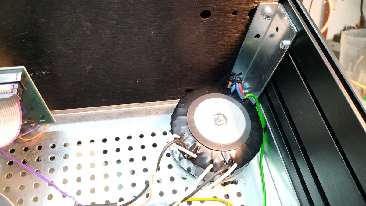

btw. these are smallest Donuts Pa had around ...... they're radiating stronger than Hafler DH200 xformer
...... "no , Pa - we can't use your favorite switchers with this preamp ............ no, Pa - I really insist on dual mono ......... "

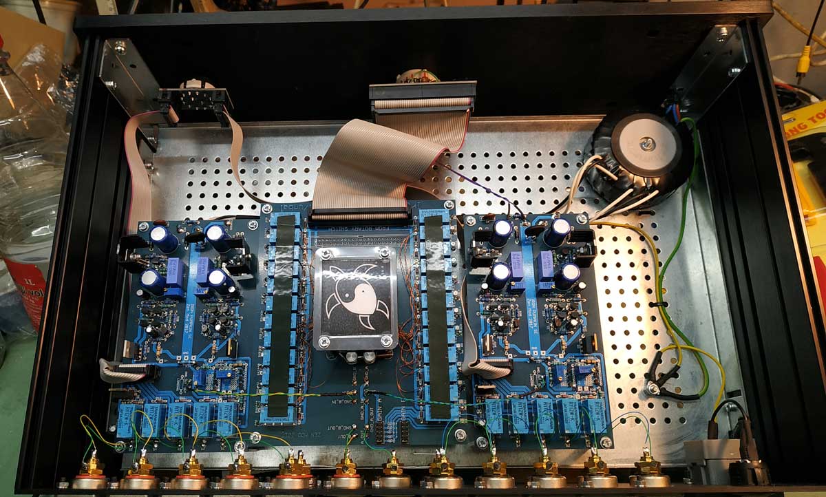

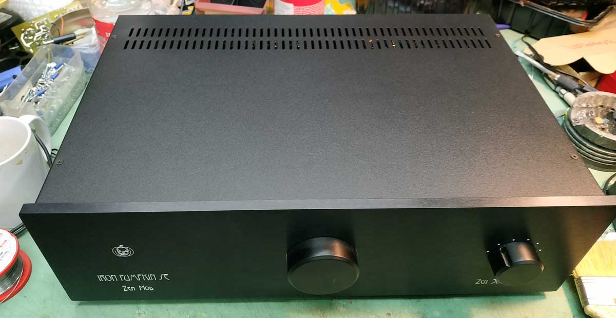

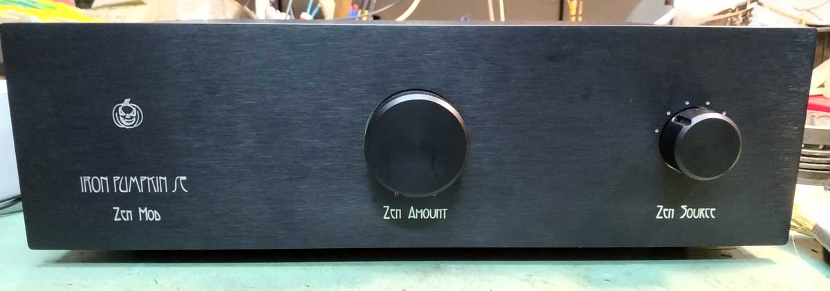

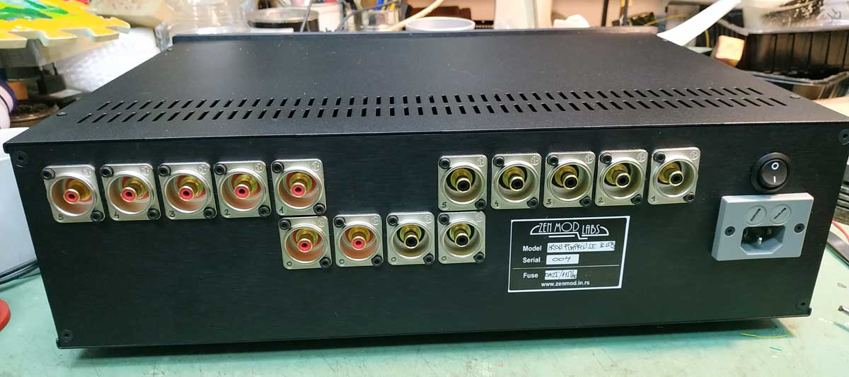

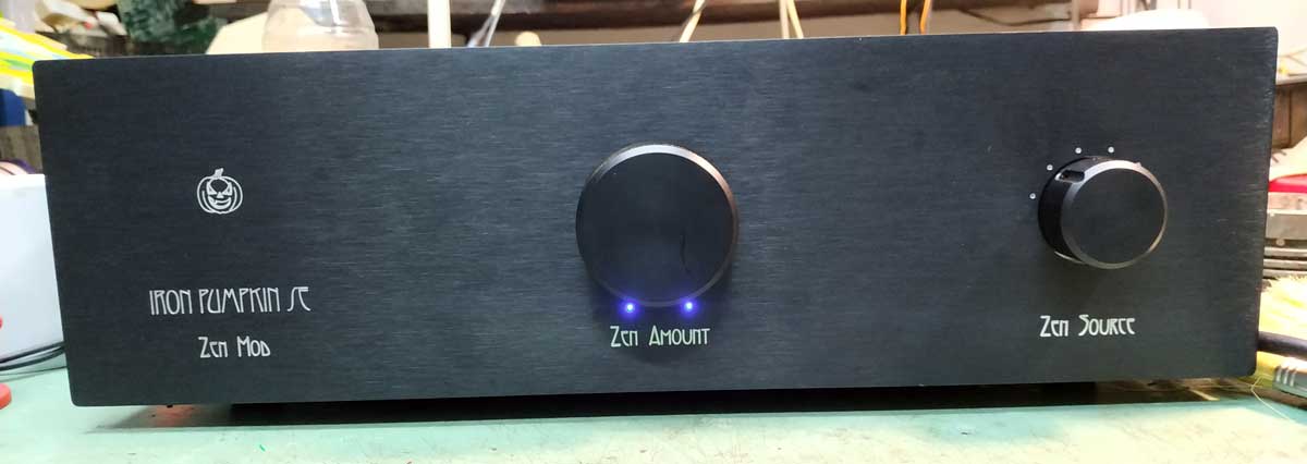

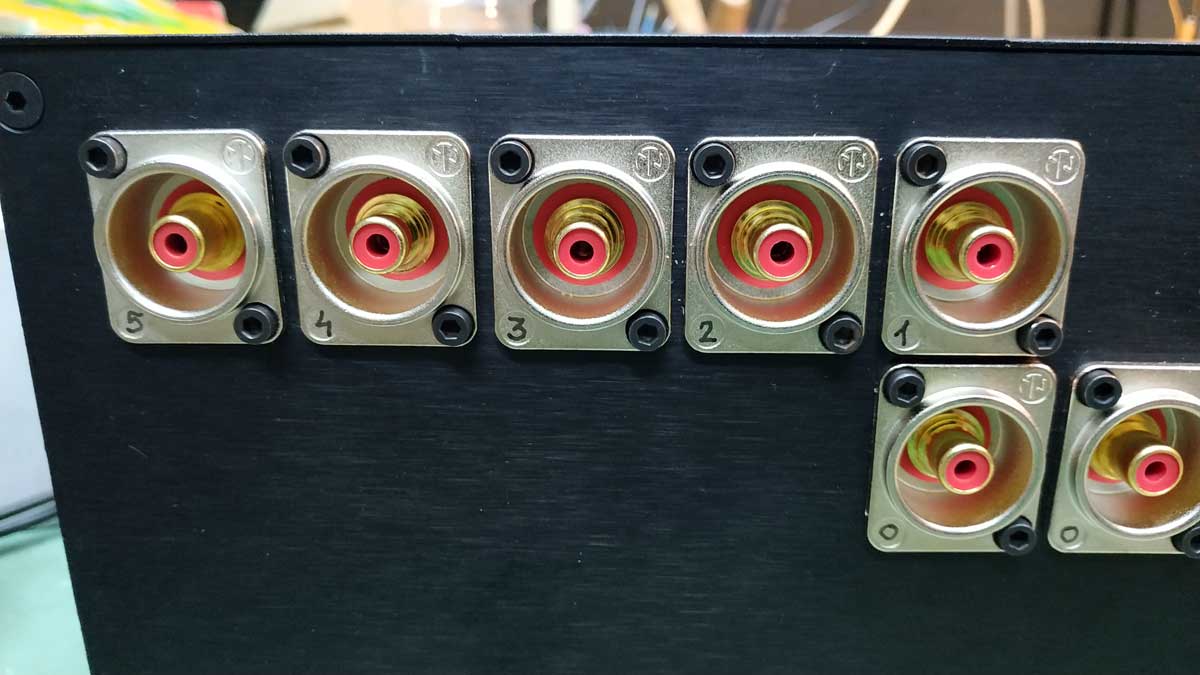

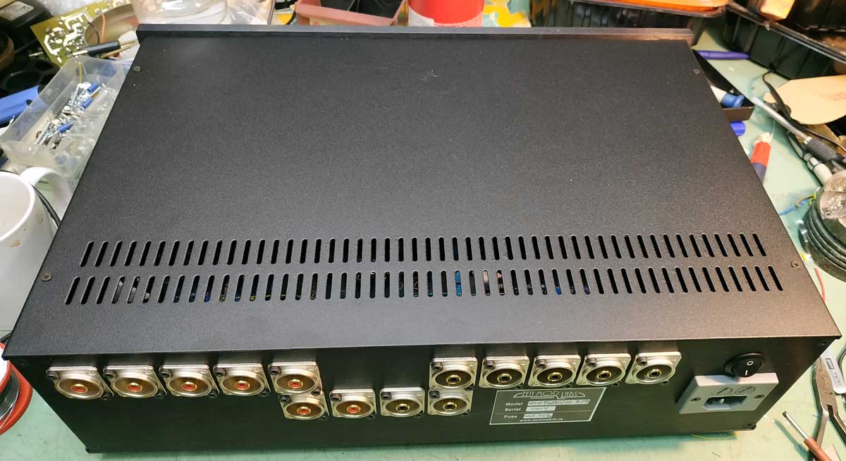

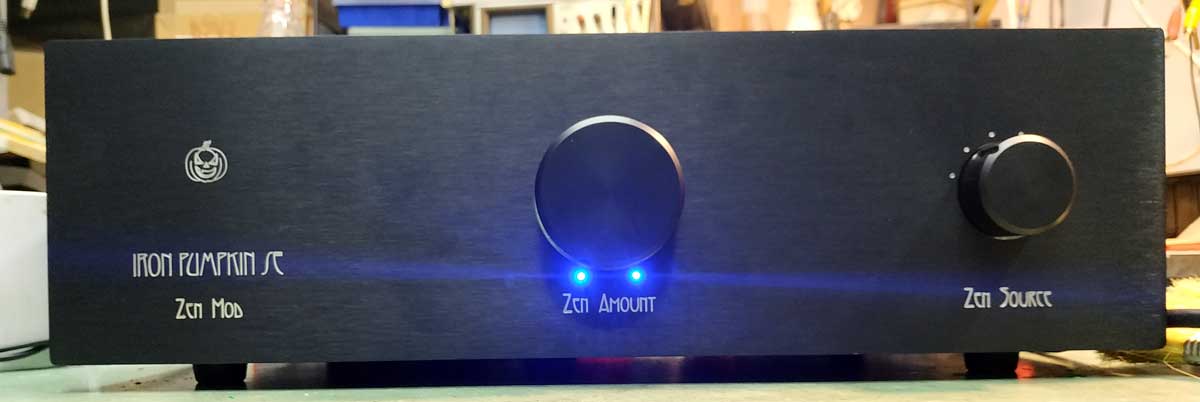

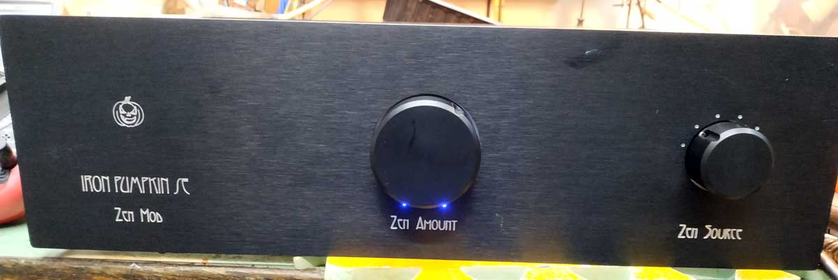

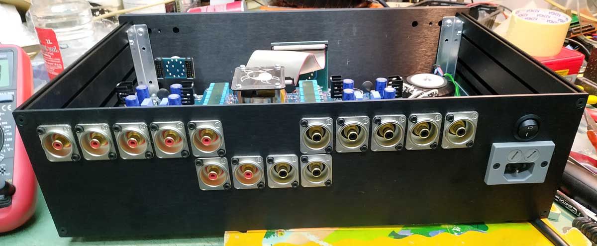

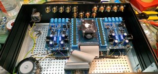

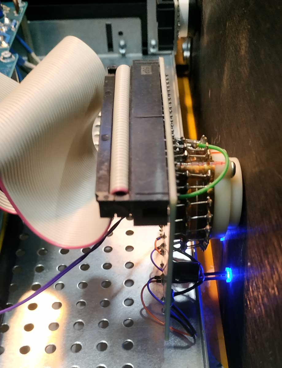

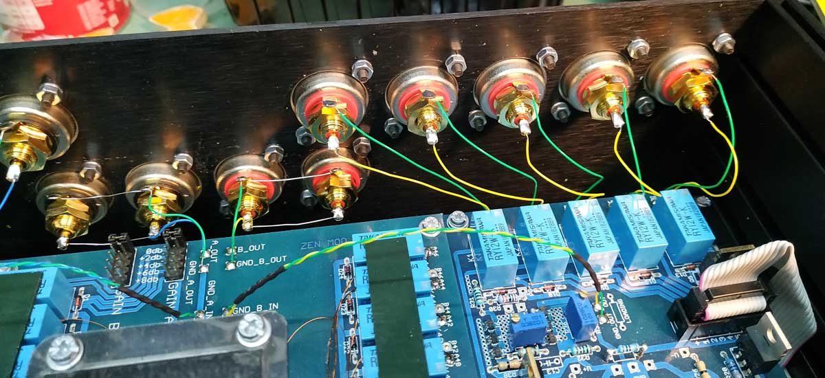

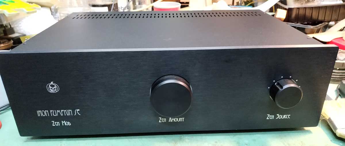

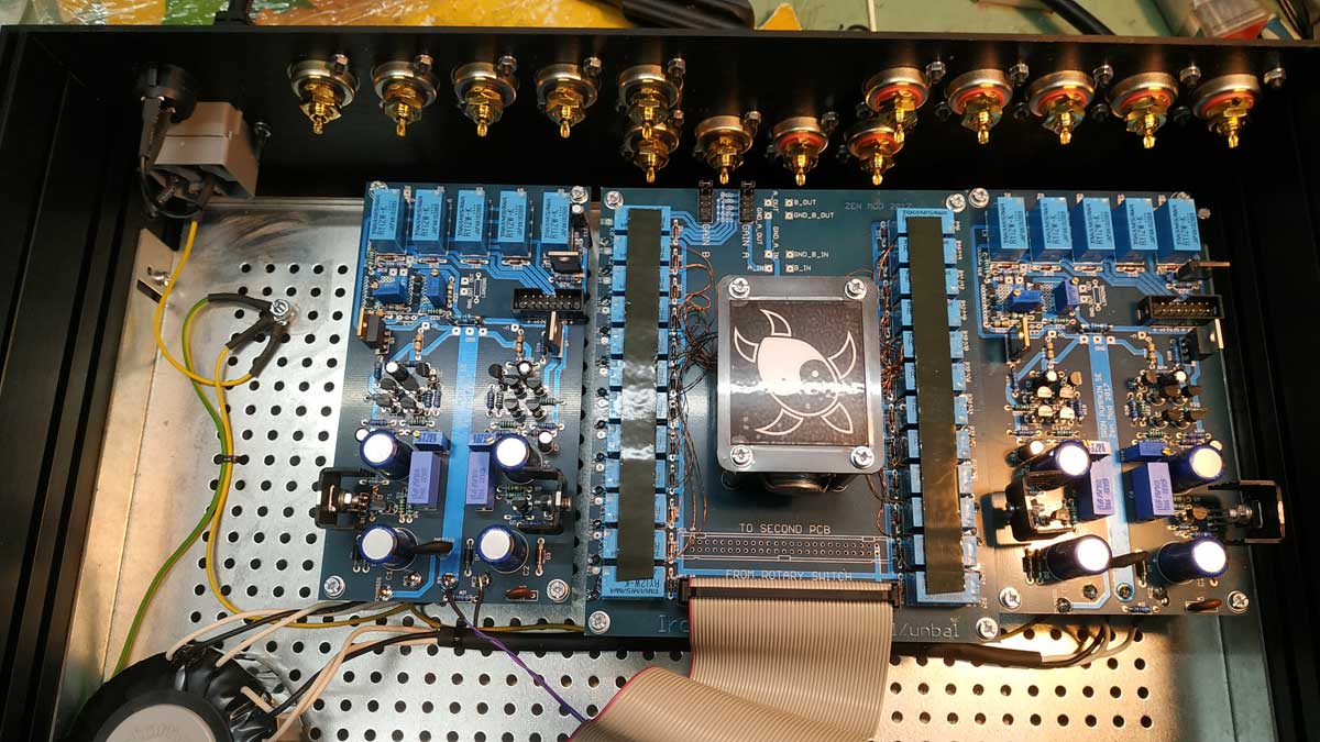

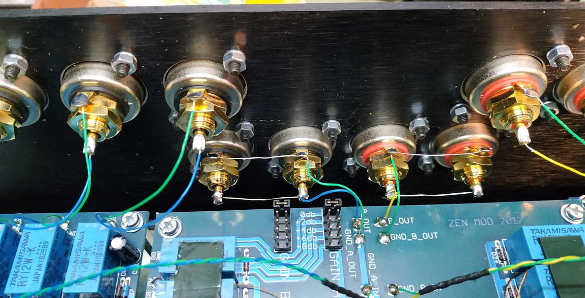

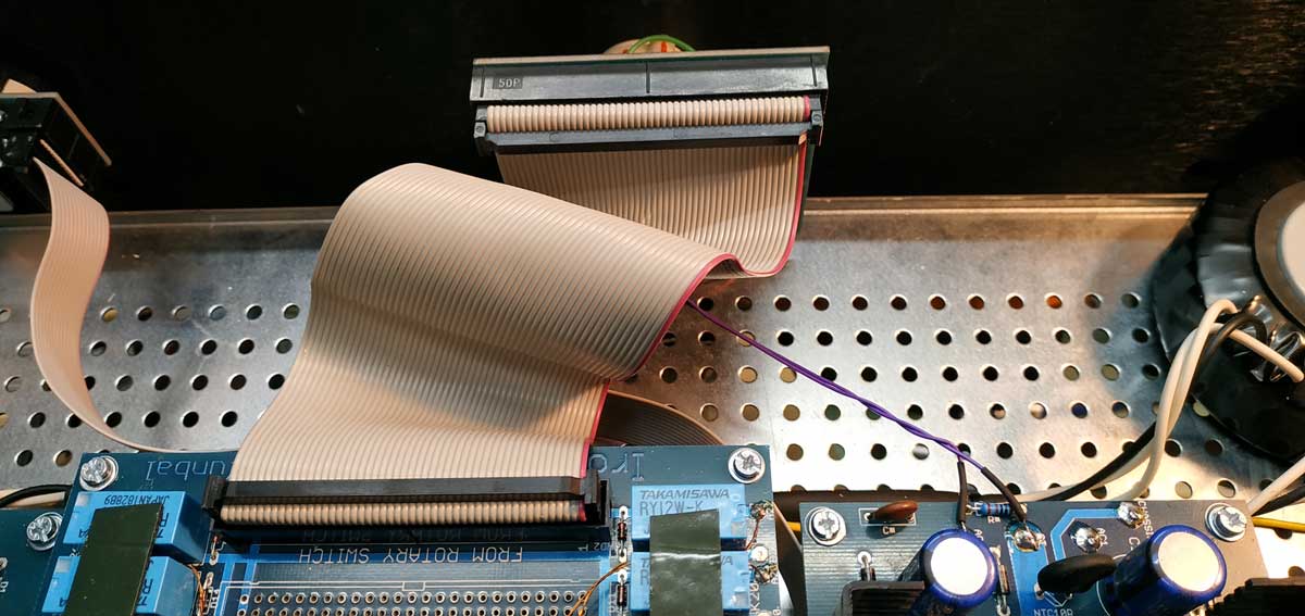

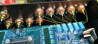

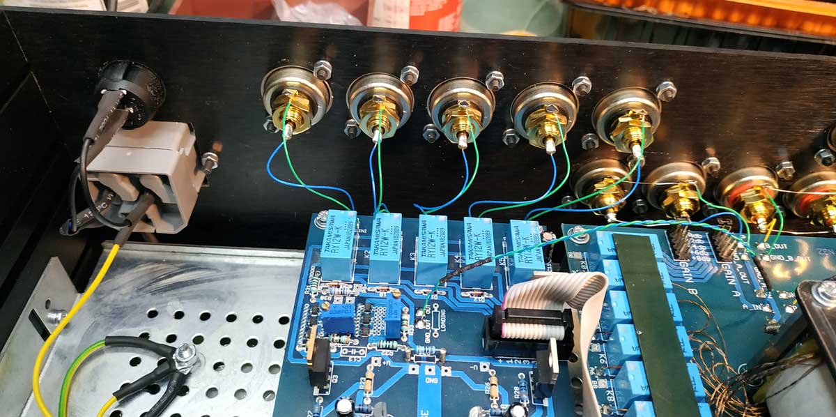

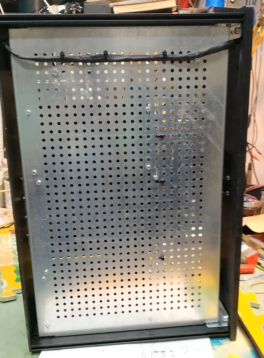

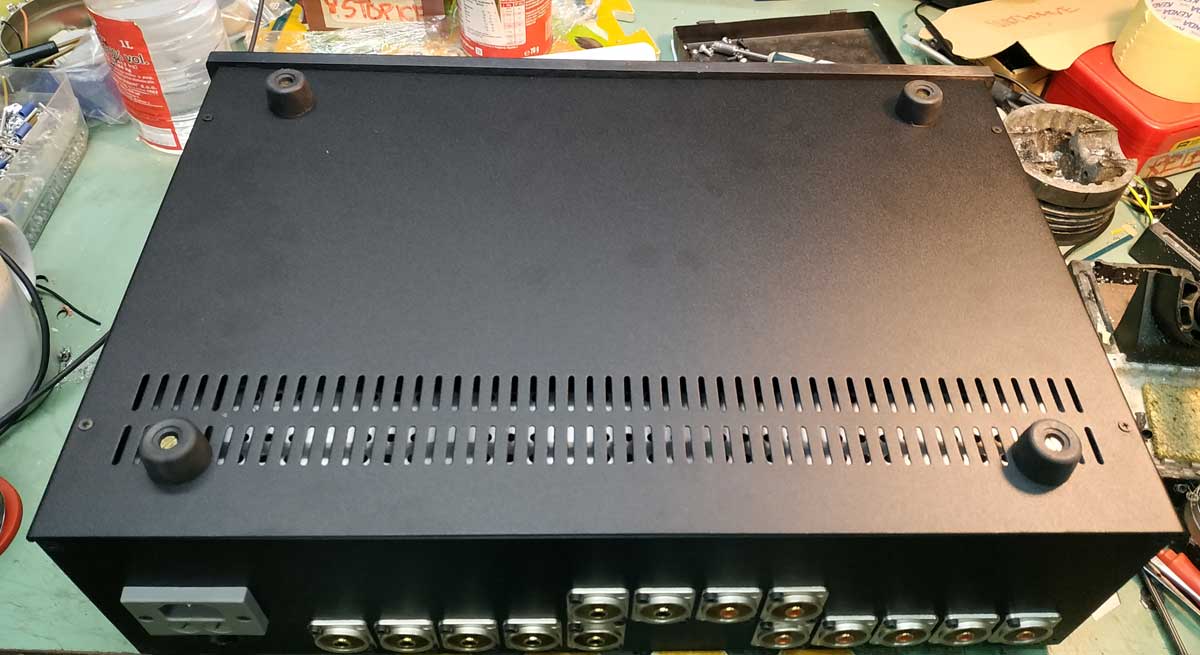

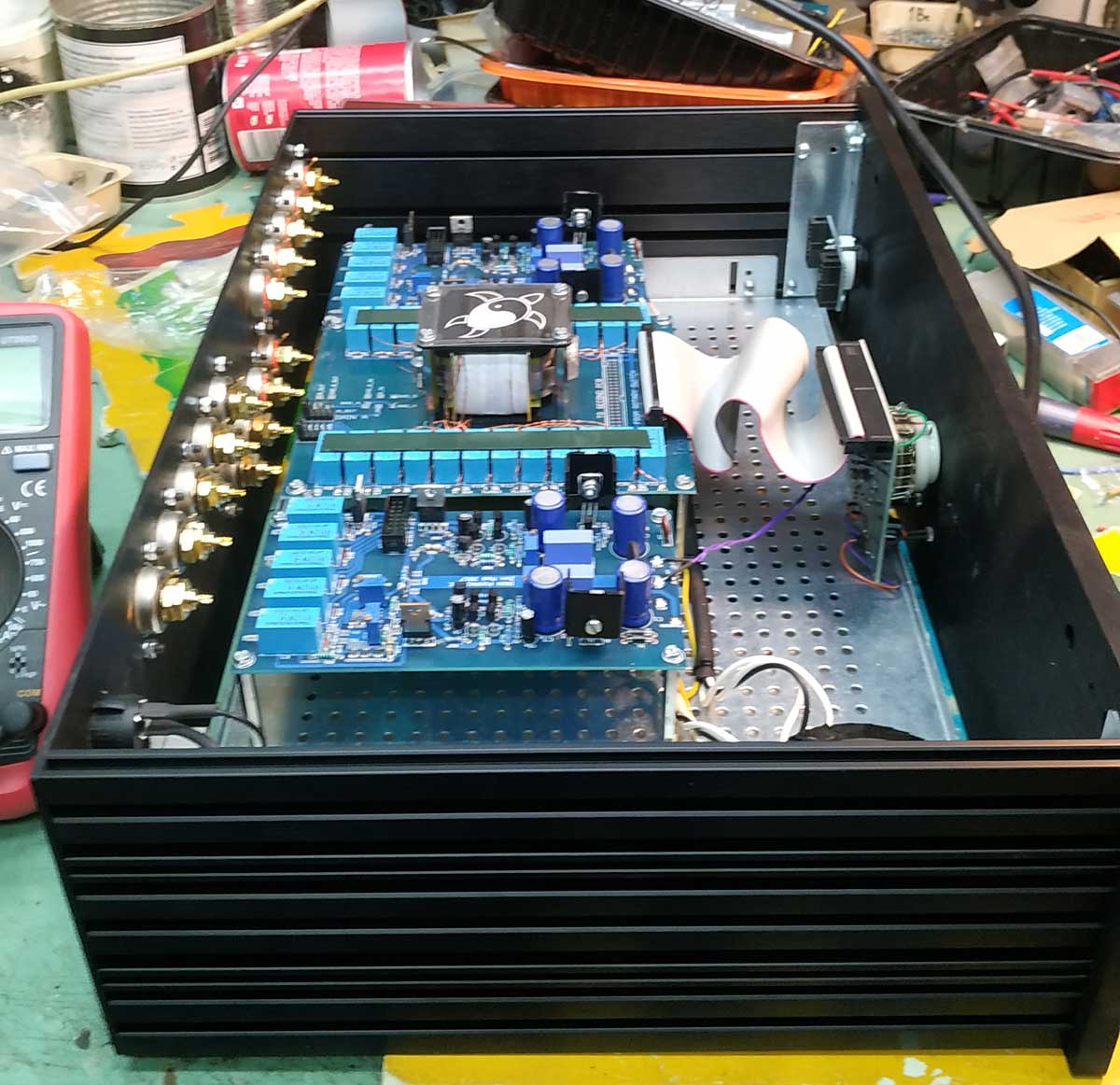

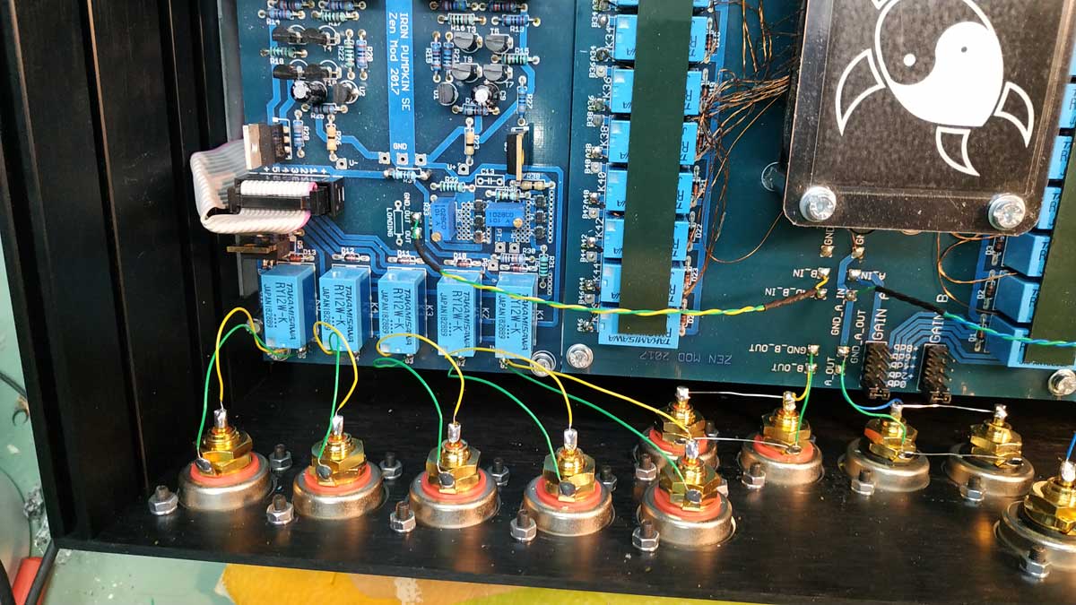

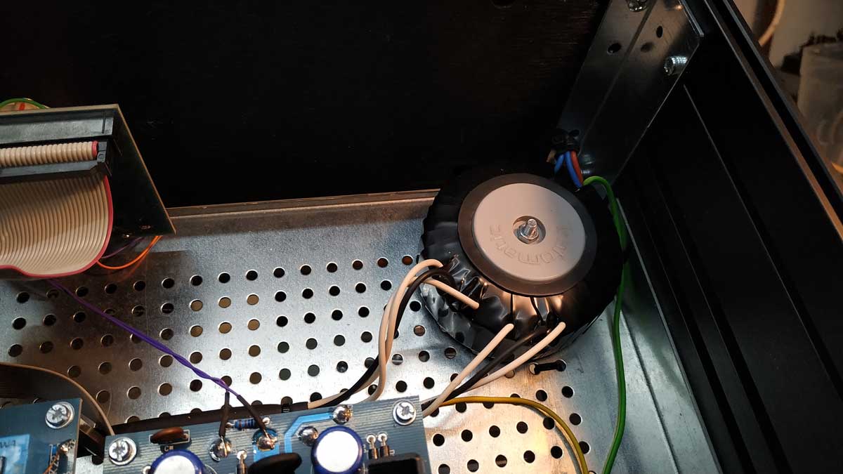

Here's Bubba Uncle Bob's
it's finished...... now we are waiting to hear that Flying Pony Express is working again
pics 1/3
pics 1/3
