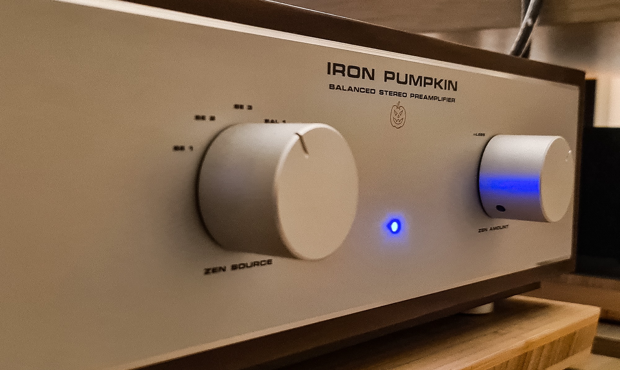

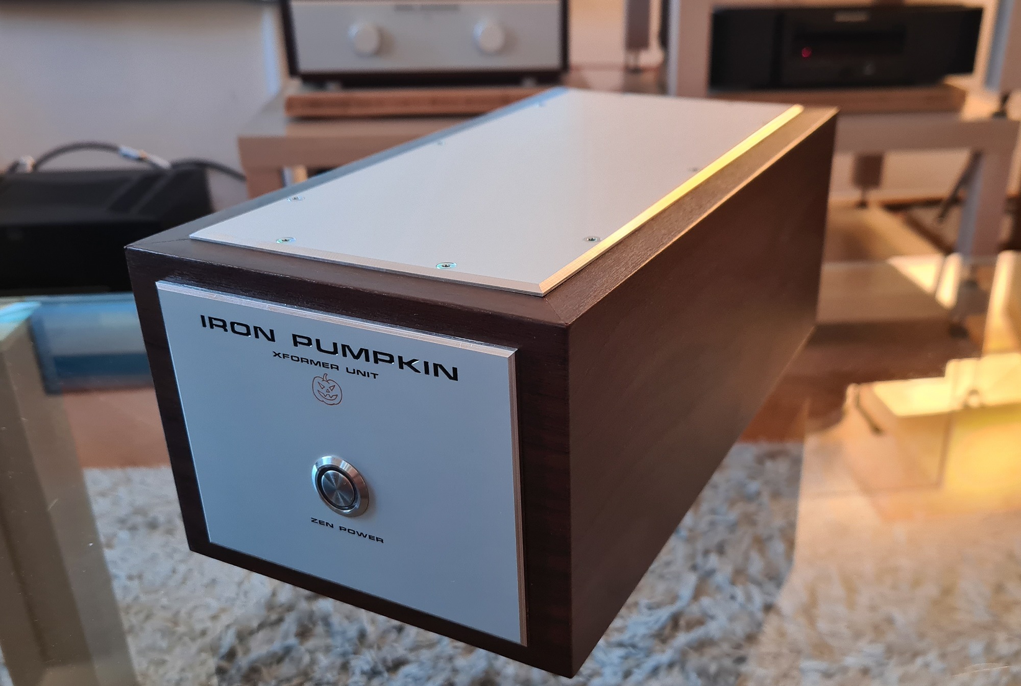

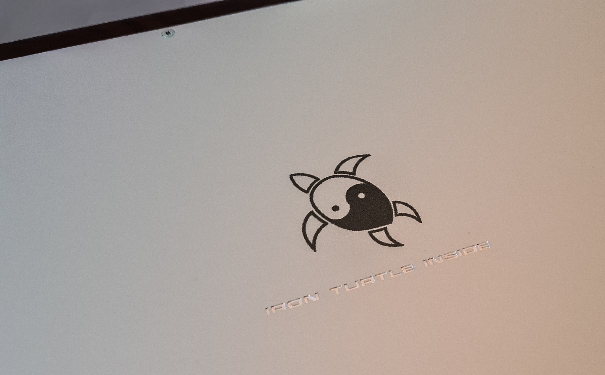

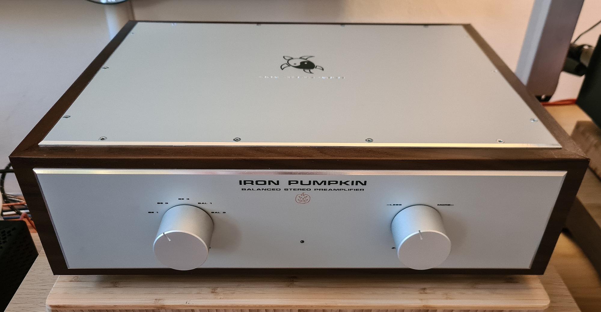

I received the top plates today, which officially means: Mission completed 😍
I am extremely satisfied with the result - with the sound and with the look too.
Many thanks again, your Mightiness
Yeah, the greatest appretiation, many thanksFugly!!
And yes, this amp deserves the maximum possible effort
4 months are gone and after this burn-in period, the amp has developed incredibly, it's phenomenal.
I've done various listening comparisons with friends recently and I've always gone home with a grin on my face
The opponents were between 2$$$-1$$$$, so...
