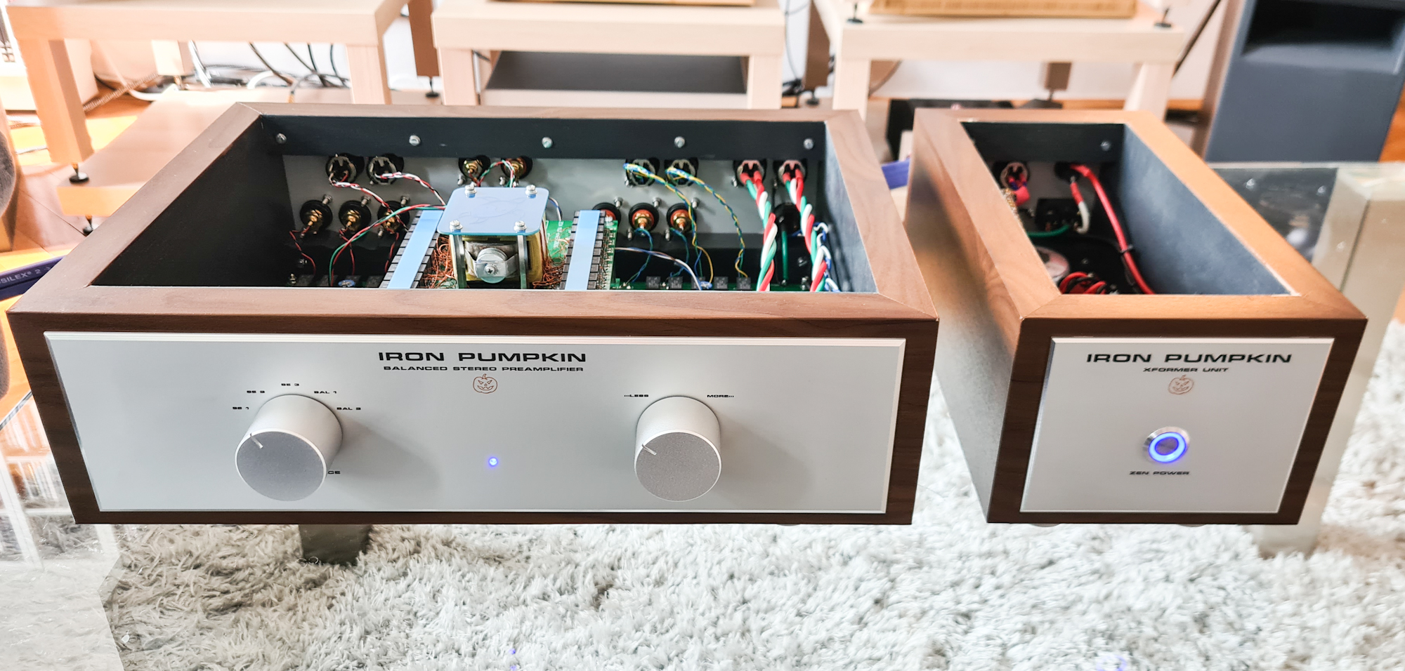

And the issues: the main issue is the hum 🤔 The transformers are about 70 cm away from the amp, but there is hum. Weird: the amp itself produces some mechanical hum/resonances - the noise comes from inside, it is like the "sound" of an old transformer with loose windings, or I don't know. In the next days I will try to find out where the source of the hum is.
But it sings beautiful 😍
"amp" - you're speaking of power amp, being close to Iron Pumpkin?
anyway, be sure that at least those panels you have in Iron Pumpkin are connected to Safety GND, giving some shielding
you did it simpy beautiful, but your case is far from (say) Modushop 3U/280(350) with Fe panels, which is my preferable solution , considering how sensitive AVCs are for external pumping magnetic fields
did I said Fugly! ?
anyhow, move that amp away .......
- if you're speaking of preamp itself (?!?!?!?!?!) ....... then you must give me more info to figure it out what's happening ........

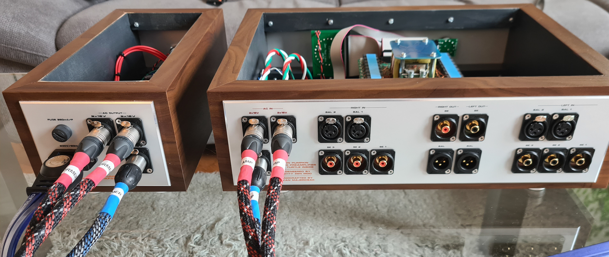

"Amp" is the preamp, but to begin at the end: the main hum is caused by - yes - the power amp right next to the Pumpkin.
So one issue solved.
The plates are of course connected to the safety gnd.
The "noise" in the preamp is a slight hum from - I think - some or one of the relais, in certain Zen amount positions, but this hum don't comes everytime even in the same position, switching further and back and the noise is gone. But it comes in another position. This noise comes not through the speakers, it comes even if the power amp is completely disconnected.
Input 1 (SE) and input 5 (bal) have higher hum (through the speakers).
So I have to re-install my racks so that the Pumpkin is far away from the power amp.
But I don't know how to solve the issue with the "relais noise" 🤔

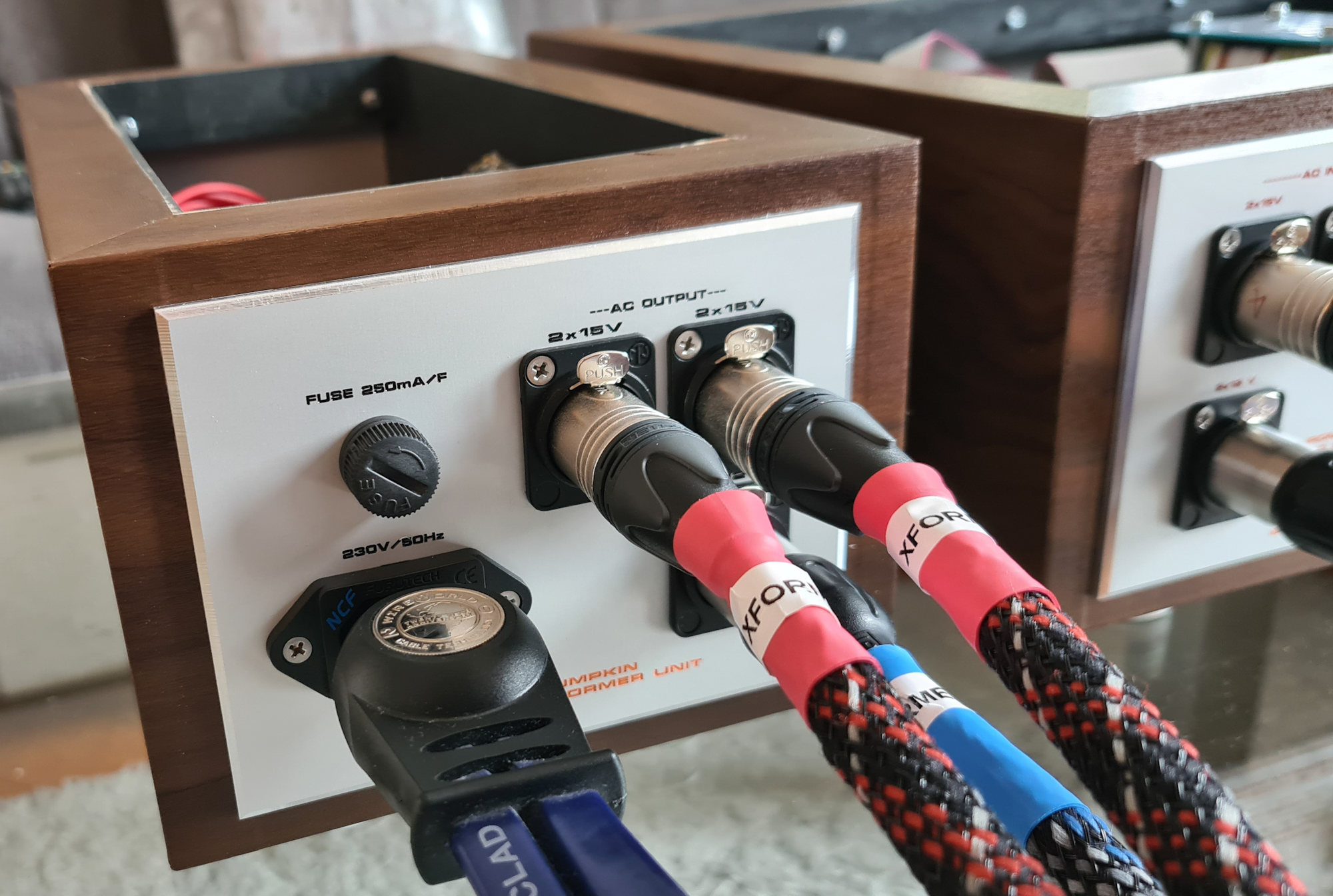

what is voltage you're having at relays?
also, measure voltage you're having at 6th relay (each channel) when SE input is selected
Thanks for the advice.
At the attenuator relais there is 24v (measured earlier because of the twisted switch).
I will do the other measurement tomorrow evening.

If the 6th relais is the MSW-relais, in SE mode there is 21,15 volts across D106 and 21,19 volts across D206.also, measure voltage you're having at 6th relay (each channel) when SE input is selected
Zero in bal-mode.
then everything is OK
you simply got nervous relay (meaning - it's zingy)
what's important is that it is functional, little noise can't kill anyone

dunno what voltage you have at drain of regulating IRF510, maybe it is borderline low (it depends of your xformer itself)
in that case it is possible that relay voltage is having excessive ripple, it is deliberately made without too much capacitance neither in front of IRF, nor after
measure what's voltage at IRF drain so we will see

edit: you can increase C2 cap
now it's 10uF, put there whatever you want
maybe easier way of doing that, without messing with Motherboard is to solder it at volume switch pcb, across + and - wirepads
it'll cover entire circuit that way
470uF to 1000uF/35V will do

I have 26,35v at drain (measured between + and - of the rectifier bridge).
I will increase C2, tomorrow, thanks for the advice.

Well, this voltage seems to be quite low. With 24vac input there should be about 34vdc - or is this drop because of the load of circuit?
if there is confirmed 24Vac, you can increase C1 to, say, 100uF/35V
again, I intentionally didn't put higher capacitances there, majority of small xformers, Donut or other ones, are having poor regulation factor (that's normal) thus with so light load AC is higher than nominal 24Vac
After eliminating the problem with the nervous relais and with the nervous myself
I moved the power amp just 50 cm away from the Pumpkin - and there you have it, the Pumpkin is dead silent, absolutely no hum even at the highest volume position
