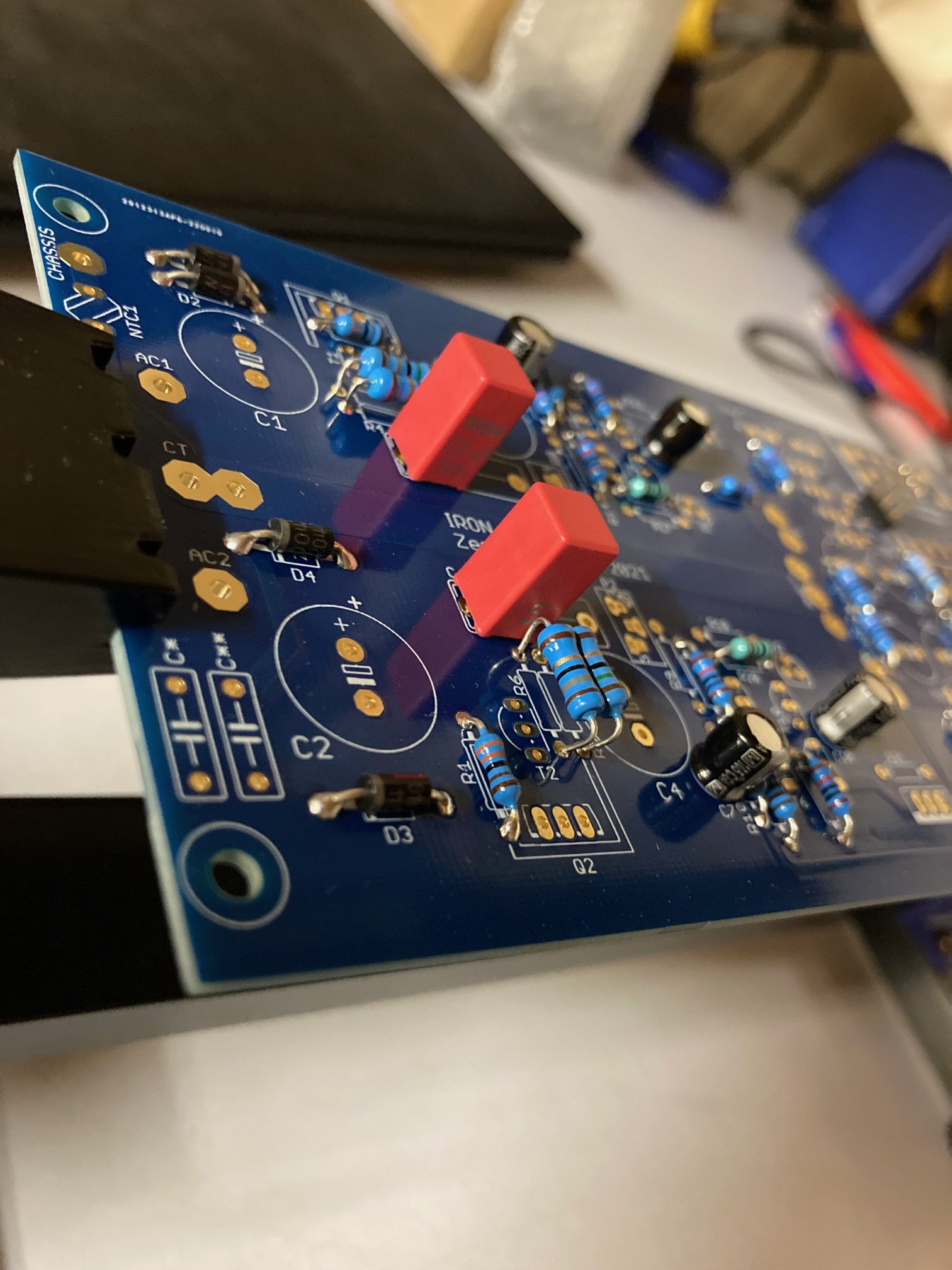

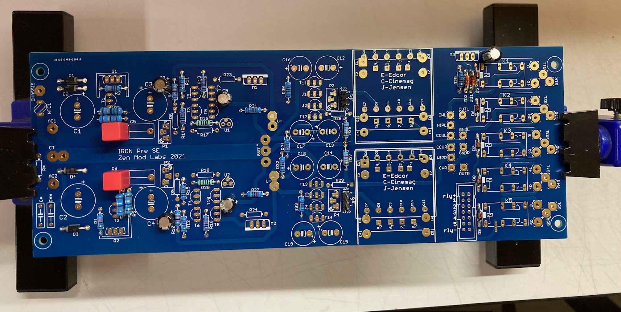

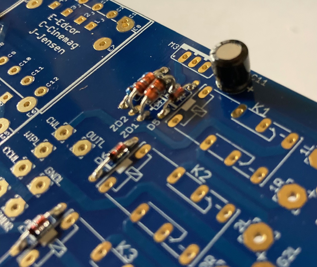

A little progress today. For all the old project scroungers, 500mW resistors and 1W Zeners are too big & you might get made fun of.
when ordering small MF resistors, always look at size, not power
0207 is magic number
zeners - 250mW or 500mW - pins will go through pads no matter; if fatter ones, just arrange their height
bummer is that some manufacturers are making skinnier 500mW (same a 250mW) while others are making fatter ones
anyhow, no biggie, as you did show on pics
worth mentioning again:
(ZM shouting) IGNORE snubber components R*, C*, C**; my mistake in arrangement, proper is double that ( one cell per secondary leg)
already taken care off for future batch pf pcbs
don't fret, in this case snubber is gilding the lily
I'll modify the BoM in post #1 to reflect Do Not Stuff for those components.
