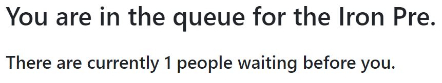

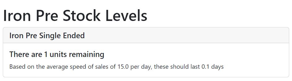

I got email and the key. but it was sold out.
It's because there was someone between you and myself. You missed it by one kit. Sorry, man.
Earlier when you posted that there were 7 people before you, I had 5 people before me.
