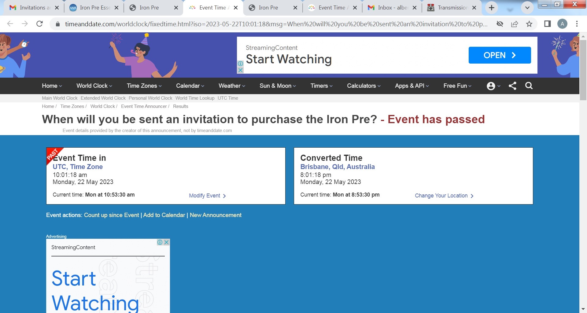

^ It's too late to get on the list we're working with now. Even if we added you, the chances are... you would not reach the front of the line in time to get one.
Two things though...
1) There is a chance (however limited) that all the initial kits won't sell by the time we reach the end of the list. If they don't ... the remaining quantity will be listed in the store normally.
2) There will be future kits in the store. No, we don't know the timing yet.
Hope your pops loves it!
Edited to add - need more coffee. Cost.... $125 for SE and $150 for balanced assuming costs don't take another massive jump.
