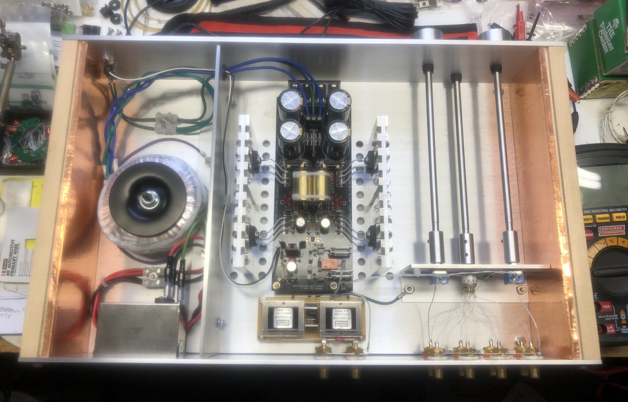

They are some mini NOS Clarostat pots I got from some guy who had a studio he was closing down.
Lucky fish. Btw, I'm intrigued by the thin wires, which I assume is silver.
Would anyone know if it's acceptable or even advisable to use thin copper (magnet wire)? I have plenty of that down to 0.2mm dia. which I use for motor winding.

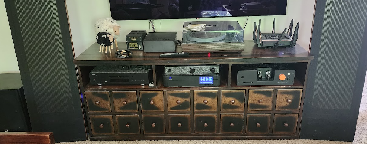

(1) If you like the B1, try the B1K.
(2) That's the "storage" position for the Maggies, right? I keep mine that way when not being used, but pull them out four feet out into the room when playing music.
(3) I've tried the tweeters in ( as you have ) and out. Eventually I found out that the imaging is more stable ( no "head in a vice" ) with the tweeters to the outside.
(4) You wireless access point... you might want to stash it like 20 feet away from your stereo... just saying.
(5) Nice cabinet... I like the sheep.
(6) I'm still by the caboose... the front of the train has long left the station but we still can't see the station ahead. No more balanced Iron... I guess I'll have to wait for the store to get more sets.

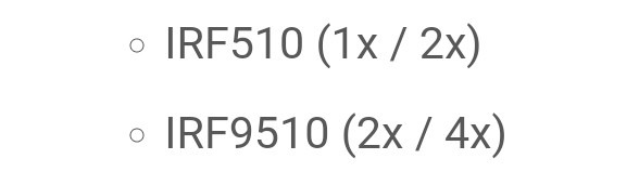

Hi guys, just for clarification, this is what's written on the purchase page of the Iron pre on the Diyaudiostore about these components
Is this right or am I not understanding?
Gaetano.
Great catch! Typo on my part.
It should be -
  • IRF9510 – (1X / 2X) .... This is for M1
  • IRF510 – (2X / 4X) ... These are for M2 and M3
What matters most is that each transistor bag should have 1x IRF9510 and 2x IRF510. That should also be reflected in the packing list you'll receive with your kit. I double checked that.
SE Kits will have one bag of transistors, and the Balanced kits will have 2 bags of transistors.
Thanks for posting that! I'll get it corrected on the web page to minimize small heart attacks (like the one I just had). 🙂
