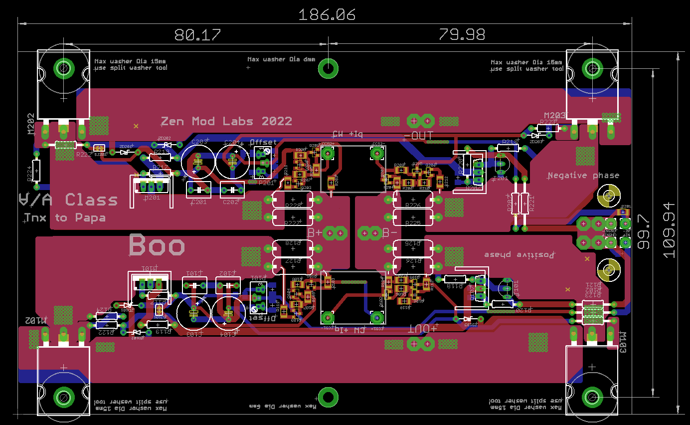

Iron Pre Turbo Balanced.
20db gain.
To drive bridged F4s.
Because sometimes the First Hundred Watts are important... not just the First Watt.
I know you keep saying stuff about the "right speakers", yadda, yadda... but sometime, SOMETIMES, the "right speakers" barely move with one watt.
I've tried, trust me... 35 watts... not enough. Sometimes. 10 watts? pfftt... good for medieval lute concerts, maybe.
Power corrupts, 200 watts of power really corrupts. ;-)
No, I can NOT afford a PL XS300.... I'm not a Rich Boy.
Oh, don't forget... RED LED.
Oh, why F4? Why not? Because they're there. A life without challenges is a boring life. I don't like Bose.
20db gain.

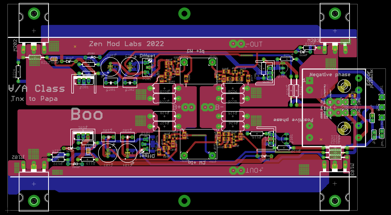

see here, post #98 https://www.diyaudio.com/community/threads/the-marriage.390965/post-7154543
build Boo, with Edcor PC600:15K at input; that will be 5V/V gain
connect Iron Pre Bal in front of it, having 2V/V
sum is 10V/V gain, 20db exactly
pure Square Law bridged OS will run your Maggies with no sweat
if I didn't post Gerbers for said combo, just say
while we are at it, considering that I already posted Gerbers for Boo and Pooh, if Boyz want them for Store (more, the merrier, bigger headache), I have no objection
nota bene - I'm lazy to check data for Edcor - how much of distortion they'll have swinging 80Vpp, I can't say
but, whatever they distort, maybe you'll like that
they're declared with 5Vrms max input
80Vpp at output .......... /2, /1.41 means 28.28Vrms
/5 means 5V65rms at input ....... which is just a smidge above declared
