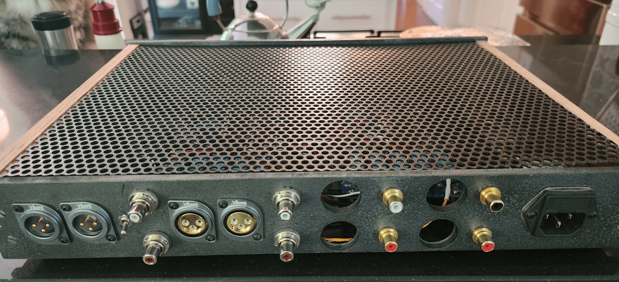

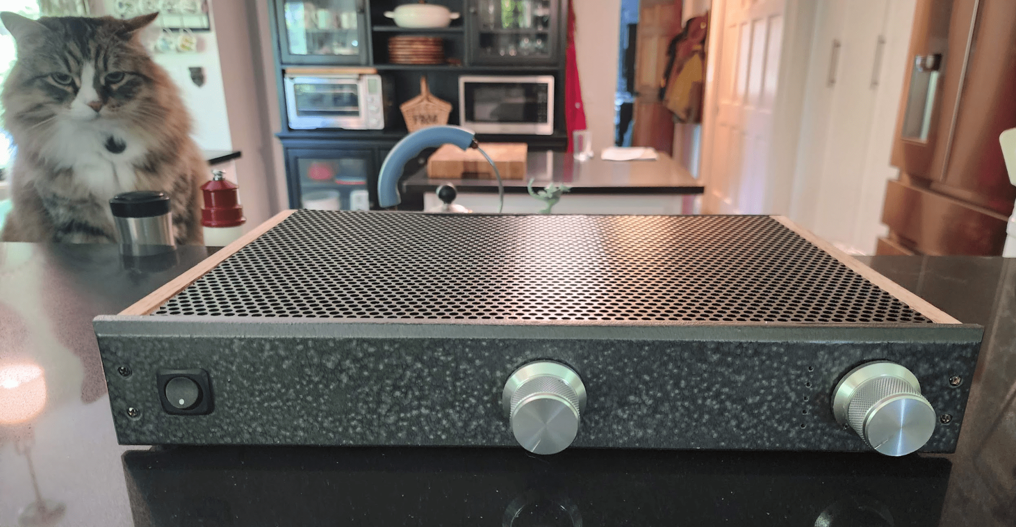

I had some "spare time" ( wife away ) so decided to case this up - original plan was to use the one from Gianluca but I realised it uses 2 stereo pots which is nice to set balance but a pia for the way it will be used. I recycled base plate, some spare bits of wood and a can of paint.
I thought i had panel mount XLRs but seems I have male panel connectors and not the needed female, so have 2 pairs on order - setting mine up for BAL/SE/BAL/SE/BAL with a sub output and option to switch between SE out and BAL out
and of course the cat had to come and see what I had put down on the counter
One question for SE / BAL - do I need to ground the unused negative input for SE input - I thought yes but wanted to make sure before I power it up and test again for voltages etc and then plug into my system.

yes, bridge of thin wire between GND and Neg pad of input in casedo I need to ground the unused negative input for SE input
though, no particular harm even if not, in which case neg buffer will have both input and output floating
I simply prefer having neg buffer input grounded to prevent Gremlins of making harm

Looks gorgeous! and it's cat-approved, so everything is fineI had some "spare time" ( wife away ) so decided to case this up - original plan was to use the one from Gianluca but I realised it uses 2 stereo pots which is nice to set balance but a pia for the way it will be used. I recycled base plate, some spare bits of wood and a can of paint.
