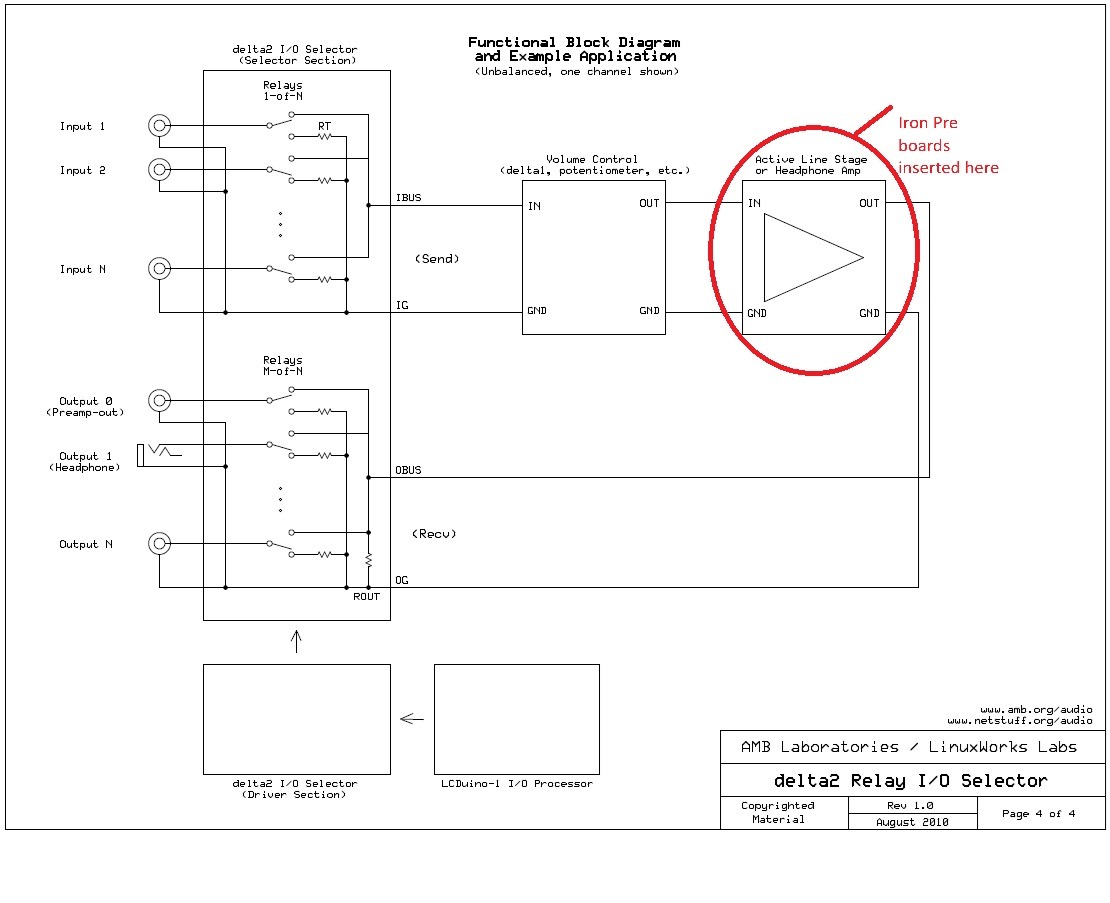

I was planning on using AMB labs LCDuino-1 system to build a preamp. It consists of a display and controller, input/output selector, and a volume attenuator. You can use your own pre amp circuit so I thought this might be worth a try since I already have the kit

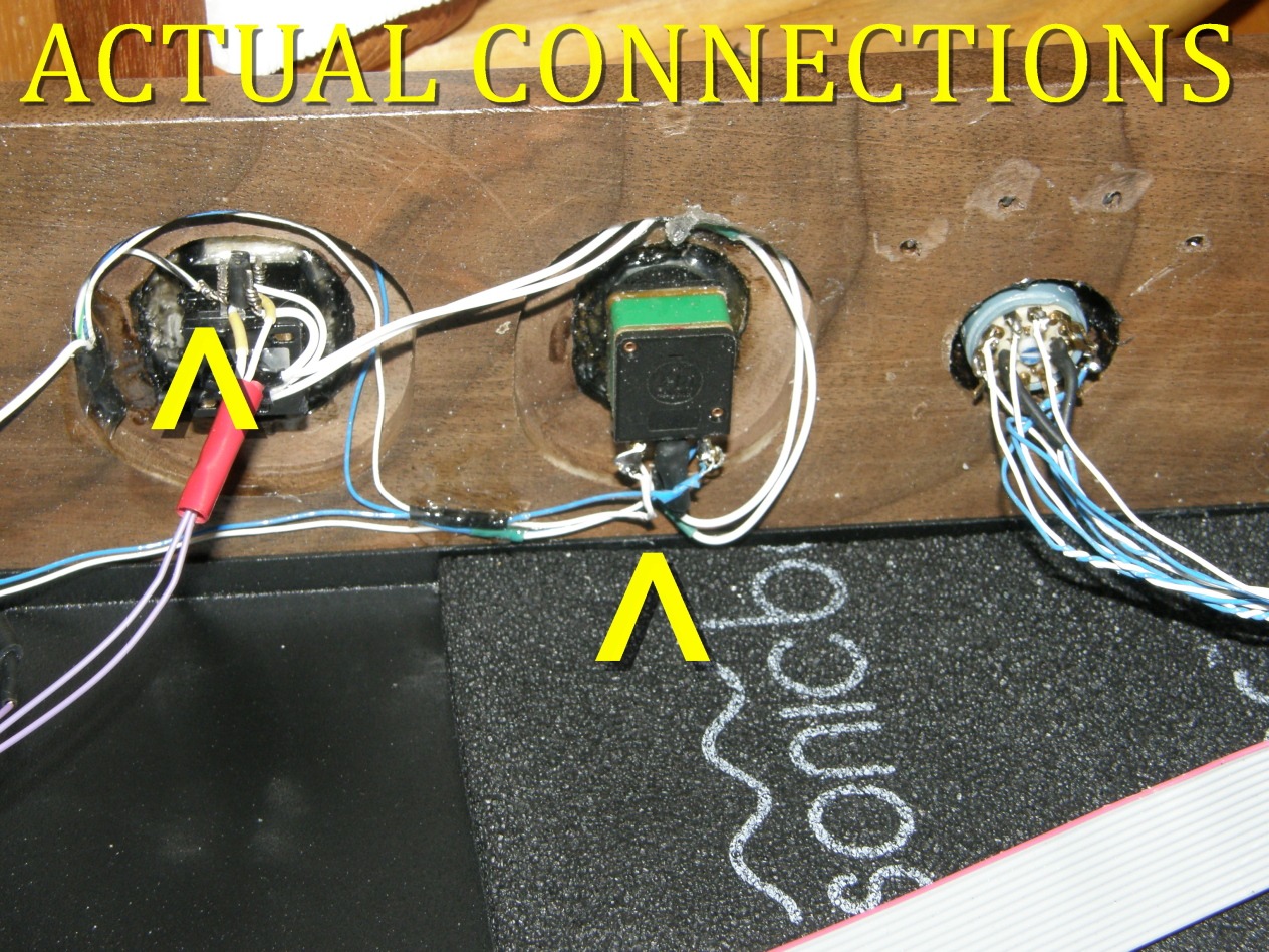

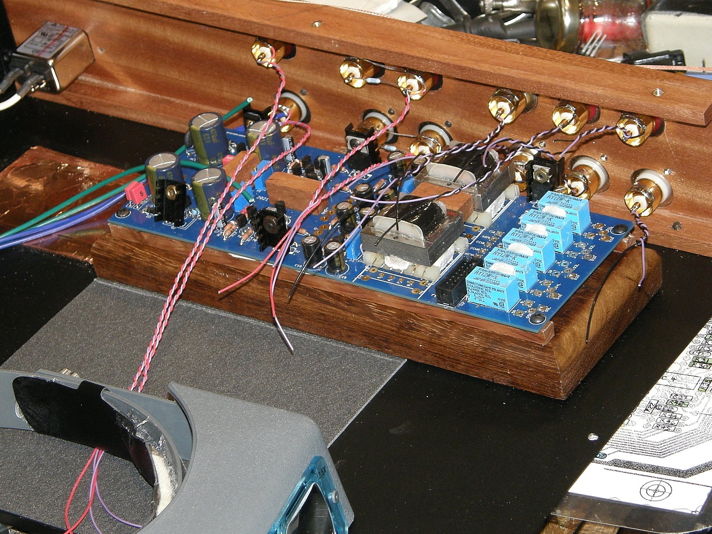

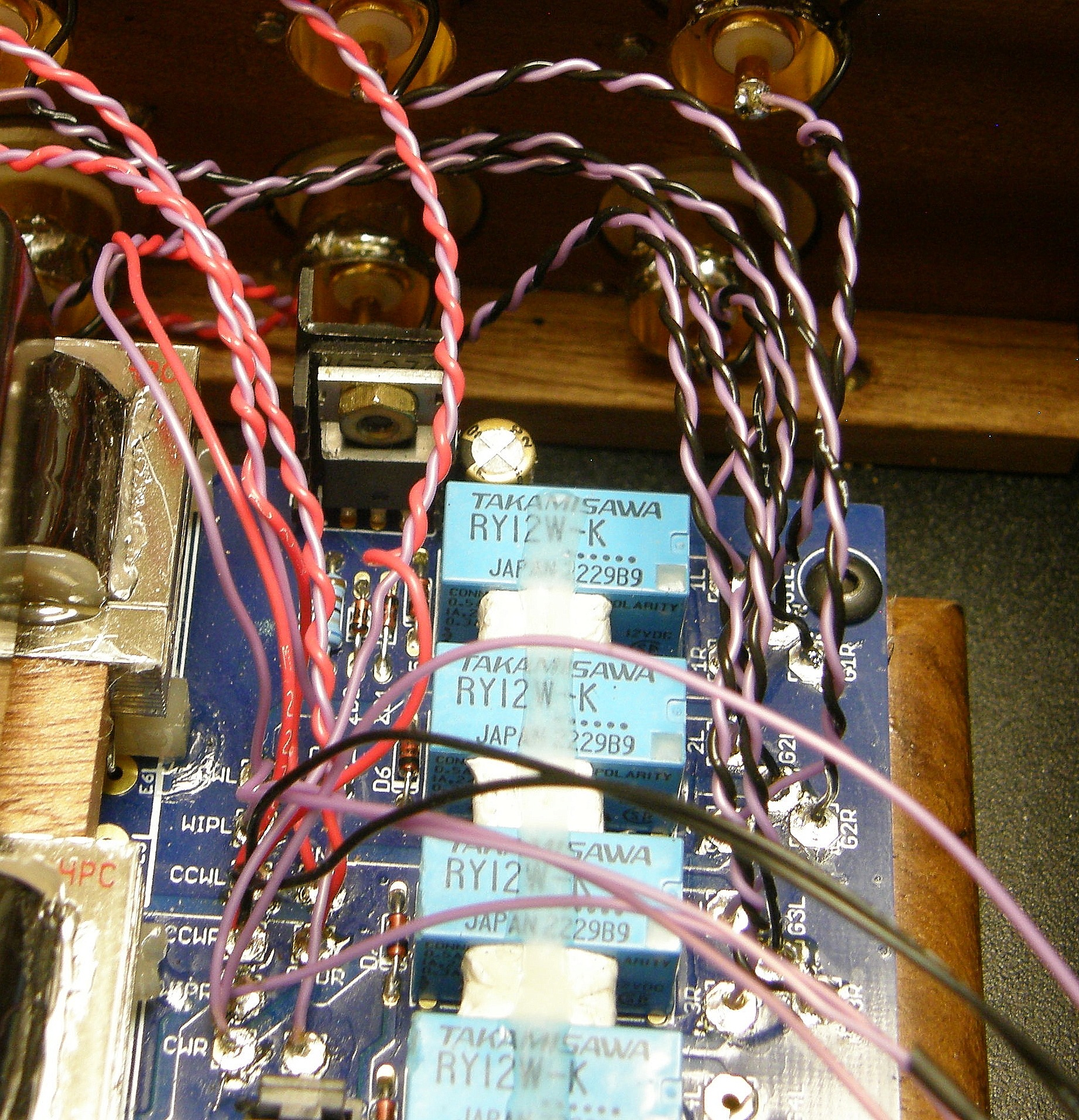

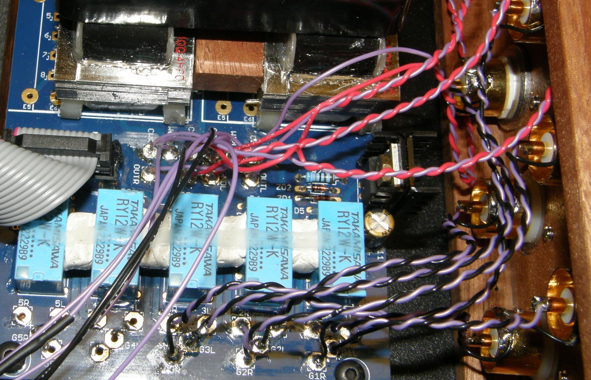

Since it is the Iron Pre that I have built and love, now is a time for me to address one issue. Only when I use the Iron Pre at near or at its highest output, I get a hum but only in the right channel. I suspect a grounding issue, and since it only affects one channel I tend to believe that it may not be an issue concerning transformer placement. Are there other obvious things that might cause this? Yes, the pre is completely built and has been in use for some time. I only noticed this recently when using a phono preamp with it and no, it doesn't matter that I am using a phono pre or other type of input, the hum remains at high levels.
Thanks guys.

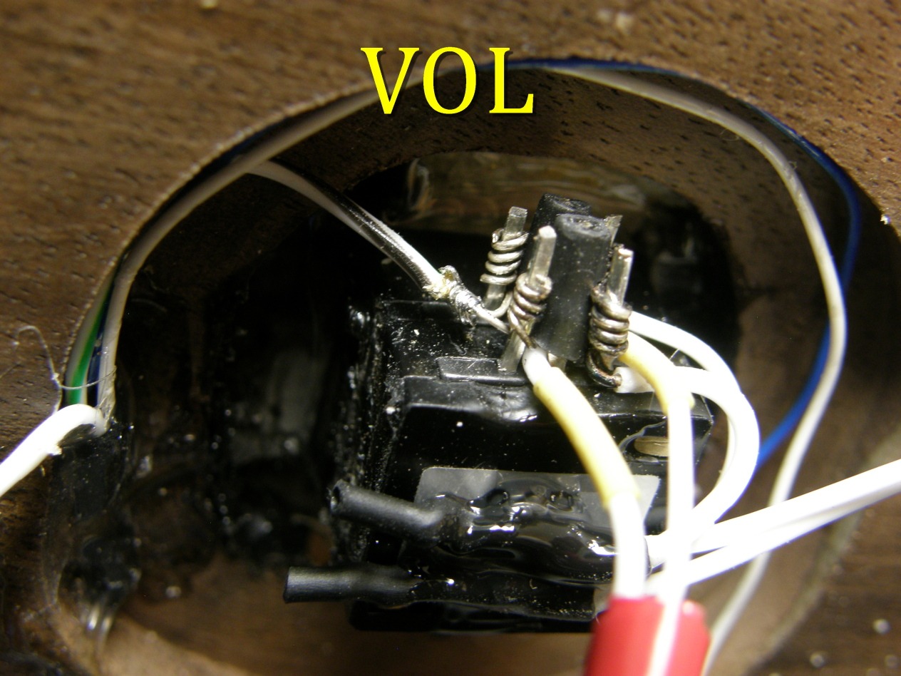

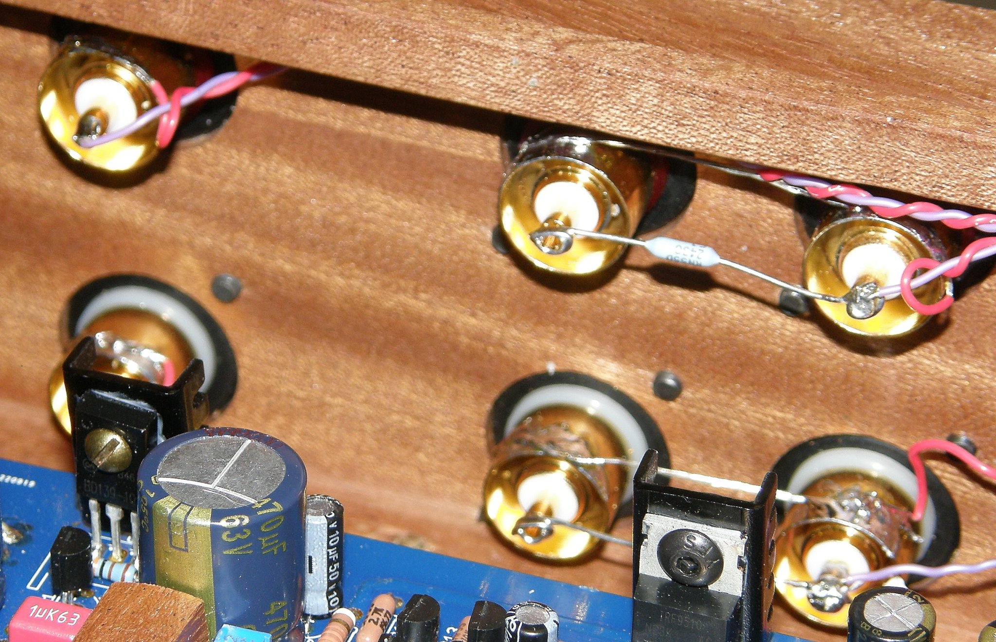

Not my best wiring by a long shot, and incredibly difficult to get a sharp photo since the focus is all over the place. Let me try some more.
can't really see wheretf is pot situated

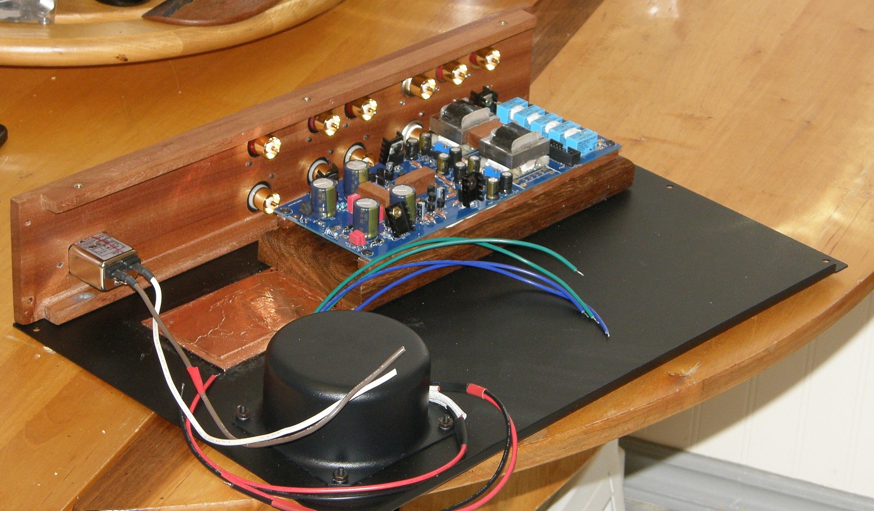

besides position of Donut regarding signal iron, that's single remaining critical factor
The more that I look at this wiring, whether good or bad, the more that I just want to redo it all. The way that I went about mounting these pots will make it difficult though. This is a TKD pot, and so I will order a new one anyway, and go from there. The balance control looks equally bad. Truth be told, for whatever reason this was one of the most difficult wiring jobs that I ever did due to poor planning, so take note. At this point it will be one thing at a time and done correctly.
now's just one picture missing , so I can see it all, how it's arranged
why balance?
make your efforts to move pot all the way to pcb, extending shaft is easy, once when you try it
as connecting element, you can use even 5mm inner Dia hose, for car or mcycle gas lines
work as charm, allows you to even be clumsy with centering of things
as shaft, even threaded bar can be used, easy to get in nearest tech. store
why balance?
