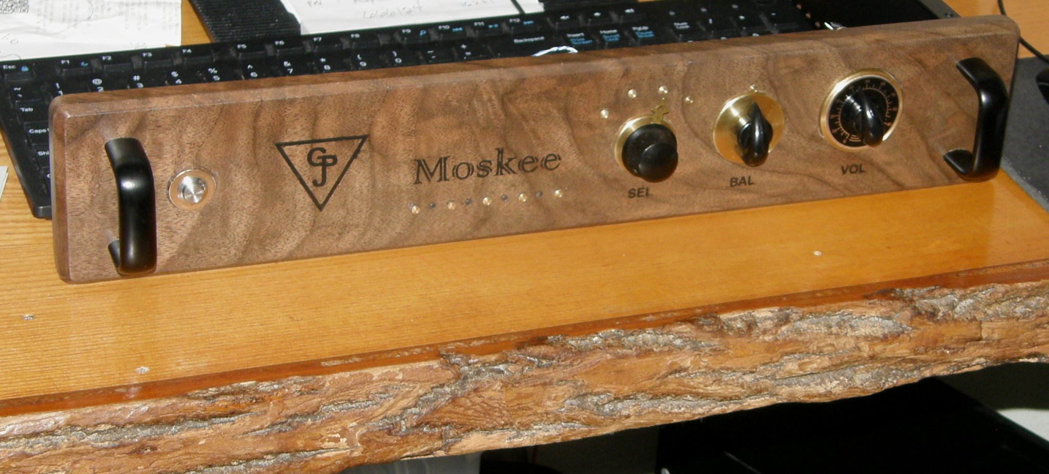

I am almost there. Yah, it really takes a long time to build some of this stuff, and then I get stuck on a simple point! I actually had to go to the build guide and find that simple answer. Man, I miss a LOT of info sometimes by me 'DIY' without guidance. Yah, yah, I can do this myself. It just takes 3 times longer that's all.
Anyway, here is the front finished panel, and I might even be done by tonight!
