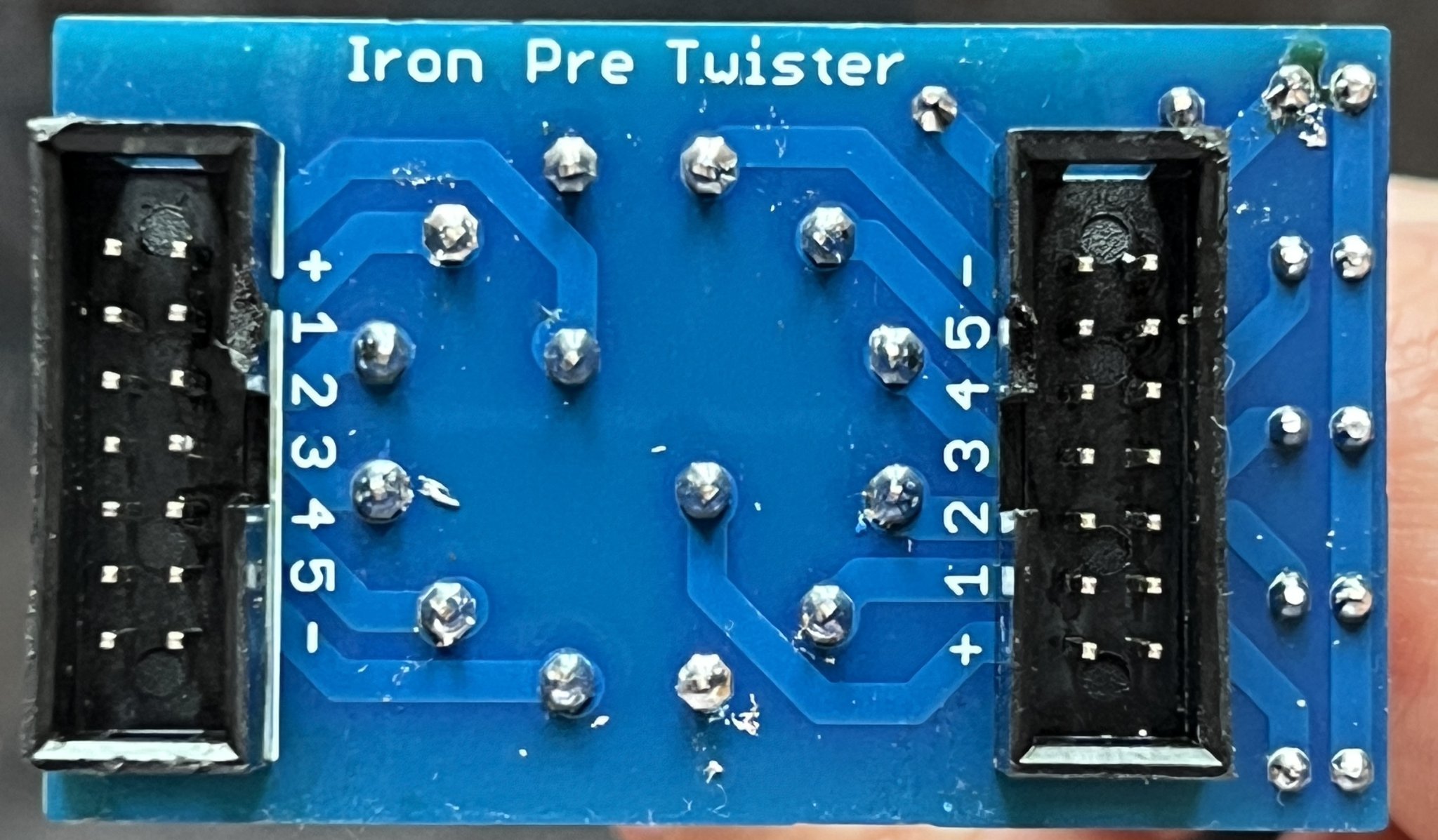

Insert the cable into the box header on the board(s) - NOTE CAREFULLY the female ends that respond to + - and 1 2 3 4 5.
Repeat the exercise from before by shorting between + and the 1-5 on the opposite end of the cable. If no relays click... then it's the cable / bad connection / interface.
If the relays click, then it's the twister board / switch.
In the event that we also have an issue with the wiring / pot, can you take a series of photos and label the wires in the photos (so I / we don't have to visually trace them) of one input to the boards; and the pot wiring. Sketch it on a piece of paper too, please.

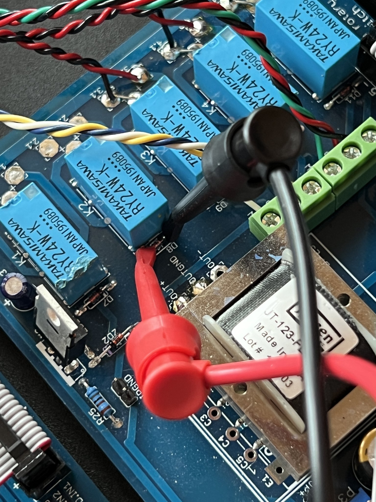

put DVM set to Vdc across diode in parallel to relay 1 (input 1) and if thee is juice, DVM should measure something as 24Vdc (nominal voltage, exact is not important, depends of exact zener voltage and Ugs of series mosfet)
if there is no voltage, try next switch positions, measuring at corresponding relays/diodes

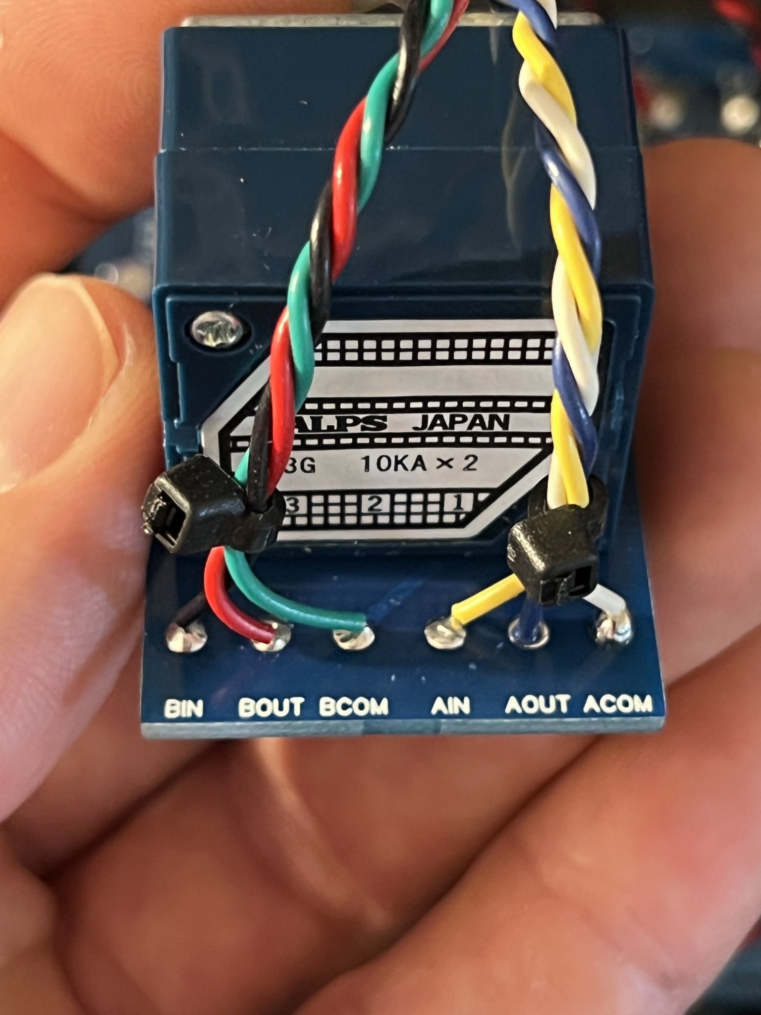

now, for clarity sake, post just 2 pictures here :

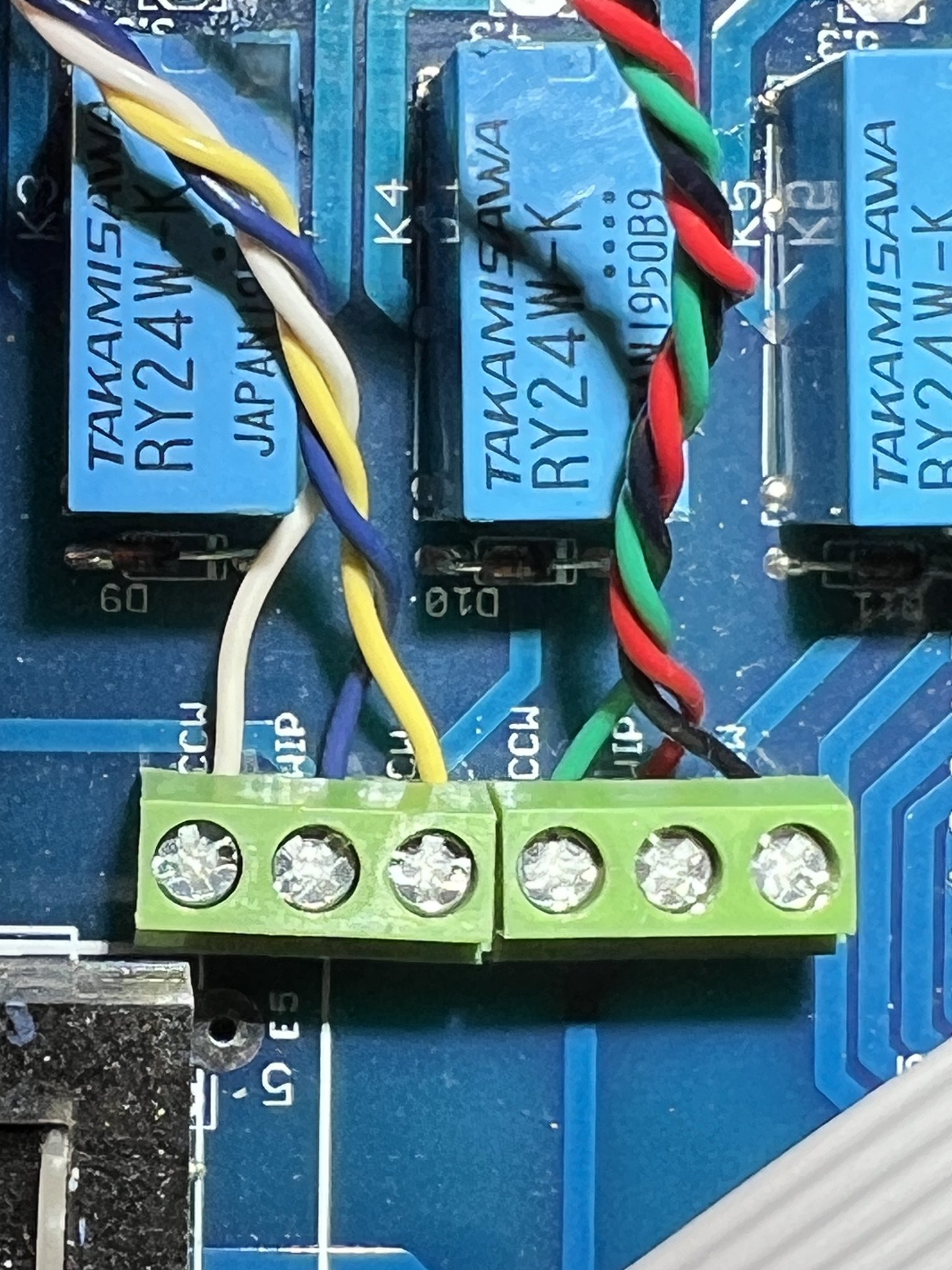

first - showing wires to pot, clear enough that we can see colors
second - showing wires to pot pads at main pcb, clear enough that we can see colors
anyhow, if you rotate pots at- say - 2 O'Clock, you'll have enough resistance from wiper (mid pin) to each end, so you can check with DMM buzzer (buzzing when R<30R) pot pins to main pcb pot pins
wiper pin on pot must buzz to "wip" pad on main pcb
CCW pin on pot (that's bloody GND) must buzz to "CCW" pad on main pcb and - practically any GND point on main pcb
CW pin on pot must buzz to "CW" pad on main pcb
if that is not the case or you have some different buzzing, remove wires and do it again, properly
now, hair spppppplittttttttttting - using screw terminals for pot wiring connections is same wise as using nylon screws on your car wheels
convenient if/while doing some prototype work, but no go for good

Translation please, you are referring to the Euro Blocks?using screw terminals for pot wiring connections is same wise as using nylon screws
^ Logically I agree, have people done comparisons with and without? I was taught that mechanical connections are better than solder, do you solder speaker binding posts? Not being a wise guy asking seriously.

2. I tried testing the Vdc across the diodes according to ZM's instructions, using the selector switch. Attaching a pic here just to make sure I'm testing correctly. Assuming I have the multimeter hooked up properly on the diodes, I'm not getting anywhere near 24Vdc. A handful of mV at best. Would that point to the selector switch/twister board being at least one culprit?

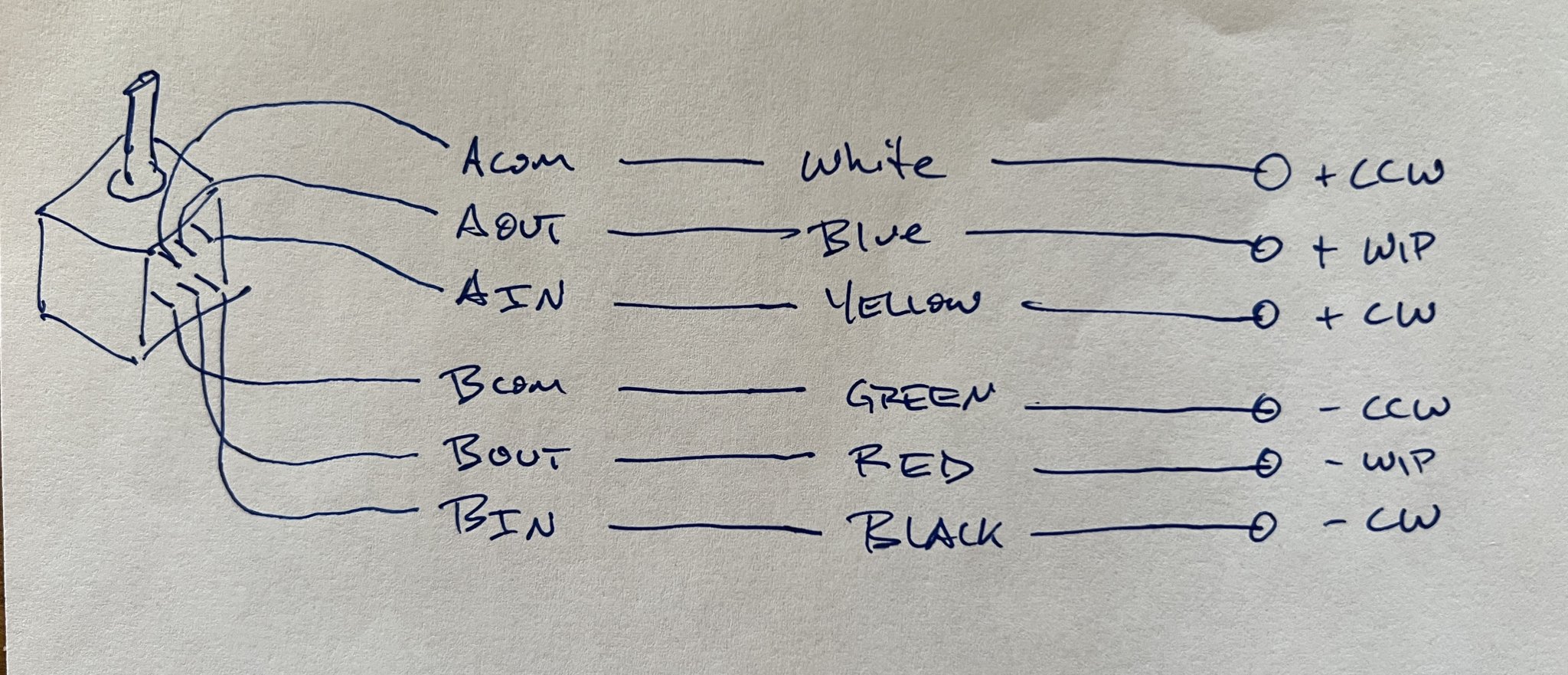

3. And here are pics and a drawing of how I have the volume pot wired. I had a sneaking feeling when I installed the terminal blocks that I was cutting a corner. I agree that they don't inspire confident, even if they do seem to be making good contact. I will properly solder the wires once I get the issue figured out.

step 1.
considering that volpot is wired properly (judging by pics) .....
disconnect flat cable from pcb, arm input 1 shorting pins numbered "1" to "+" pins with wire bridge
confirm that you have 24Vdc across relay 1 dode

while you're listening, post pics of twister and flat cable, so we can see is there anything wrong
take care that we can see twister pcb from both sides

Pot is wired fine (best we can tell).
Can you please take a few secs to: set the pot to roughly mid point and do a quick resistance check between ...
However... if you'll indulge me... if you do not get music.
You're confirming to make sure proper relay actuates to pass input signal, which we need to confirm.
Out+ and JP+ Pin 2 inside/middle pin. Put jumper cap back on firmly and check to wiper of P3 (middle pin on back of board if you can get to it)
Out - and JP- Pin 2 inside/middle pin Put jumper cap back on firmly and check to wiper of P4 (middle pin on back of board if you can get to it)
On your pot boards... to the main boards
CW+ / AIN and R28
CW- / BIN and R29
+WIP / AOUT and R28
- WIP / BOUT and R29
+ CCW / ACOM to GND
- CCW / BCOM to GND

I need to get back to work but below are pics of the twister board.

checking switch itself is easy; remove flat cable from twister and attack it with buzz test:
in position all CCW (mute) , no buzz between "+" and any of pins
in position "1", buzz in-between "+" and "1" pins
in position "2", buzz in-between "+" and "2" pins
etc.
if that is pass, follow Patrick's - leave flat cable connected to main pcb and try measuring on free end of cable, following same logic as measuring IDC on pcb itself
or just fiddle shorting ''+" hole with appropriate holes 1, 2, 3, 4 ,5
