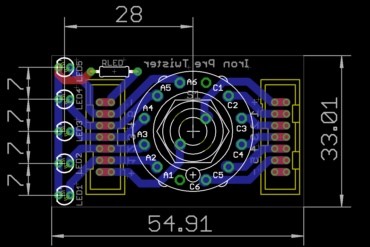

The switch passed the buzz test following ZM's above instructions, and the cables passed the test, too (relays clicked just fine when shorting female ends). I'm stumped. Granted, I've been stumped the whole time, haha! @aljordan is kindly sending me another twister board, so I'll try swapping that in when it arrives.

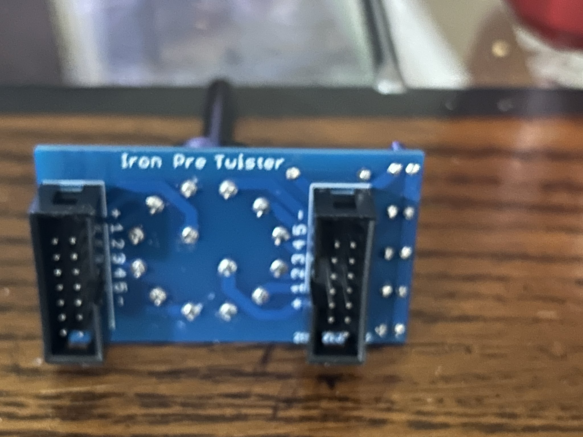

Well... it's 99.9% something with the switch itself. There's not much that can go wrong with the twister board.
Again... only if you're willing...
First (re)confirm that you have 5 clicks (6 positions) set on your switch. You may have confirmed, and I missed it.
Plug in the cables on both ends.
Do same exercise with shorting + to 1-5 using the pads on twister board. 99% should get full clicks... which leads to it 100% being switch.
Remove cables.
DMM set to continuity -
Put one probe on A side center pad. Turn switch full CCW.
Put other probe to A1. Does it beep? If not, which one pad makes it beep?
Turn one click CW - Move probe to A2. Does it beep? If not, which makes it beep?
One more click A3... then one more A4, then one more A5, then one more... A6.
Same for C side.

The switch checks out on the continuity test. It beeps appropriately for each of the click positions testing from the pads. (And yes, confirming that I did get the switch properly set up for 6 positions).
But the relays don't click when shorting from the twister board pads.
Then... yep it's odd... but then the cable isn't making continuity through the pins on the header through to the PCB.
Never woulda thunk it... but we had to check it to be thorough. There's the 1%
Those headers are a pain to de-solder / re-solder. Since you have a new twister on the way...
Enjoy the tunes and wait...

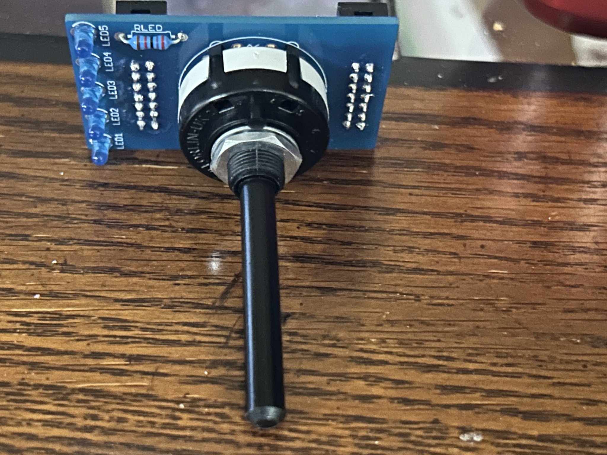

Compared to the working ones I've soldered, you have your rotary switch upside down. Don't know if it makes a difference.
Only if you're using the little 'nubbin' for alignment on a chassis with a pre-drilled hole... and you accidentally install it the other way... and there are LED holes in the chassis... so you can't really just flip the board over.Compared to the working ones I've soldered, you have your rotary switch upside down. Don't know if it makes a difference.

^ Any time. I admit to still being puzzled by this one...
I thought I'd ruled it out when I asked if all the LEDs then lit and in the proper sequence. That shows definitively proper contact from main board through cable to header to twister PCB through circuit from "+" to "-" and back to main board ...
I'm out of ideas except to try a new one.
Maybe someone more creative/smarter can think of something.
If it works... lovely. If it behaves the same way...

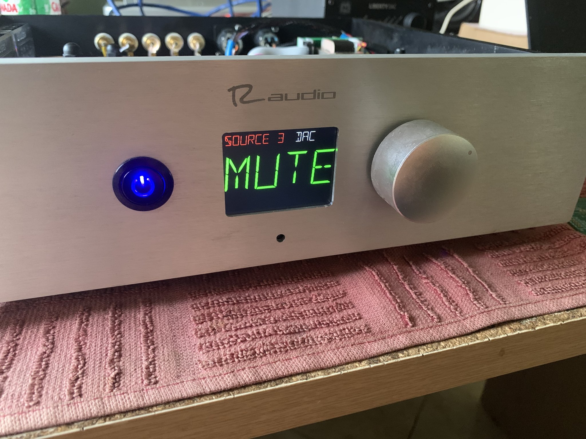

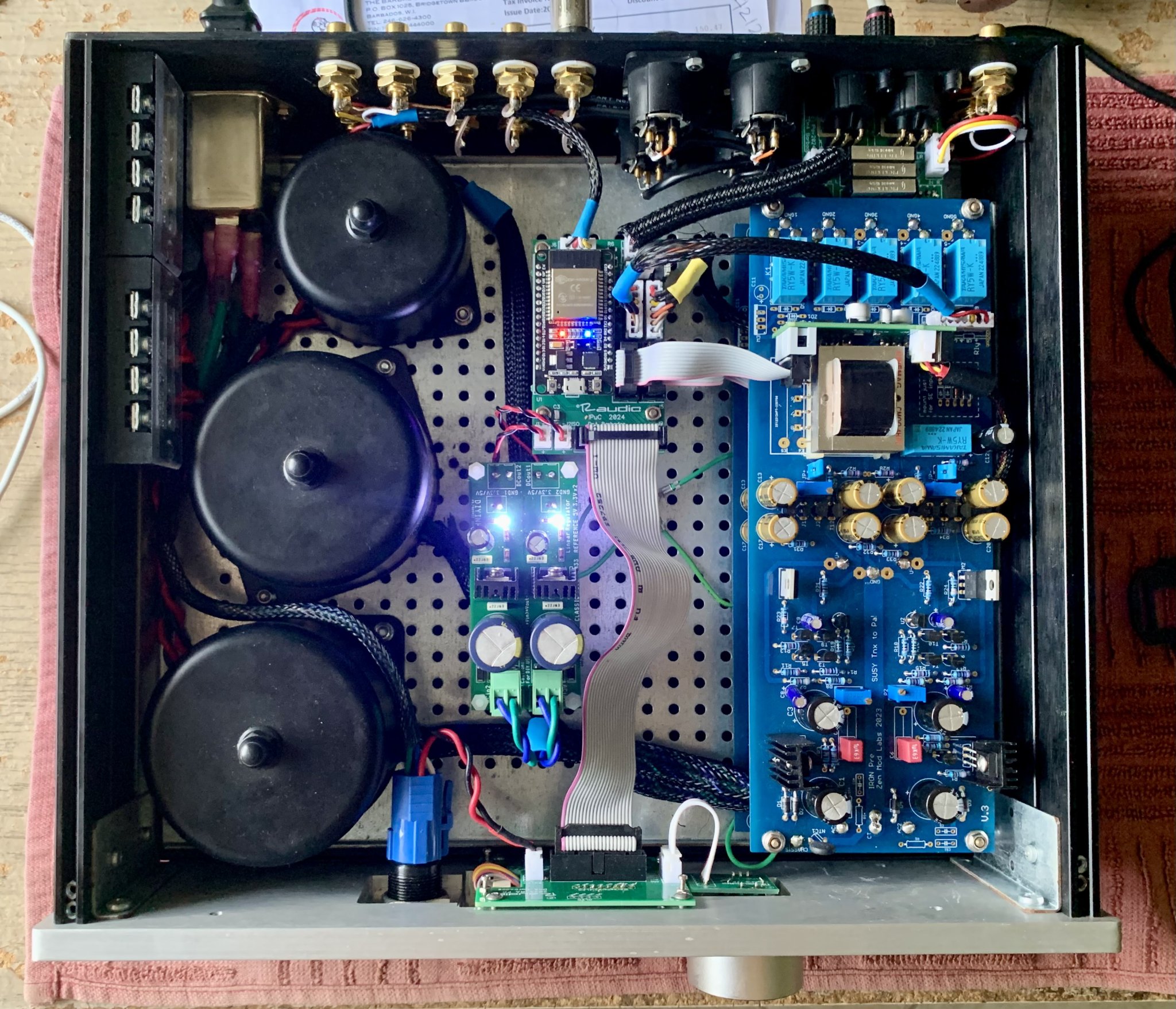

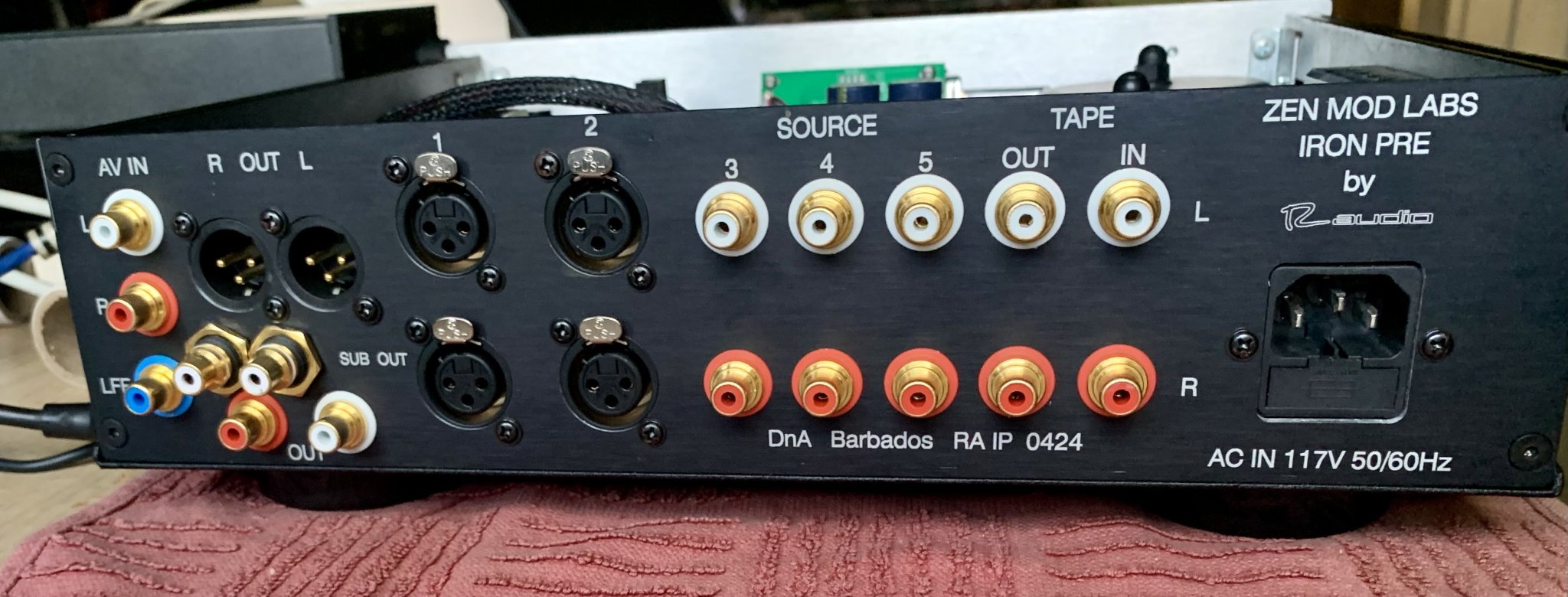

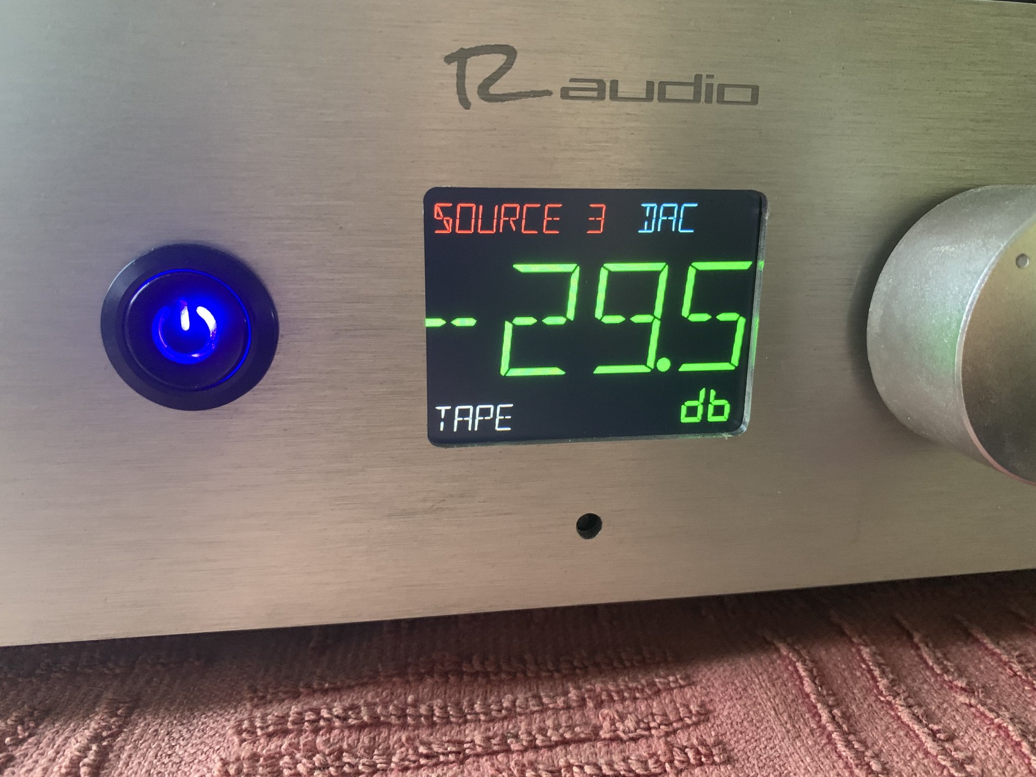

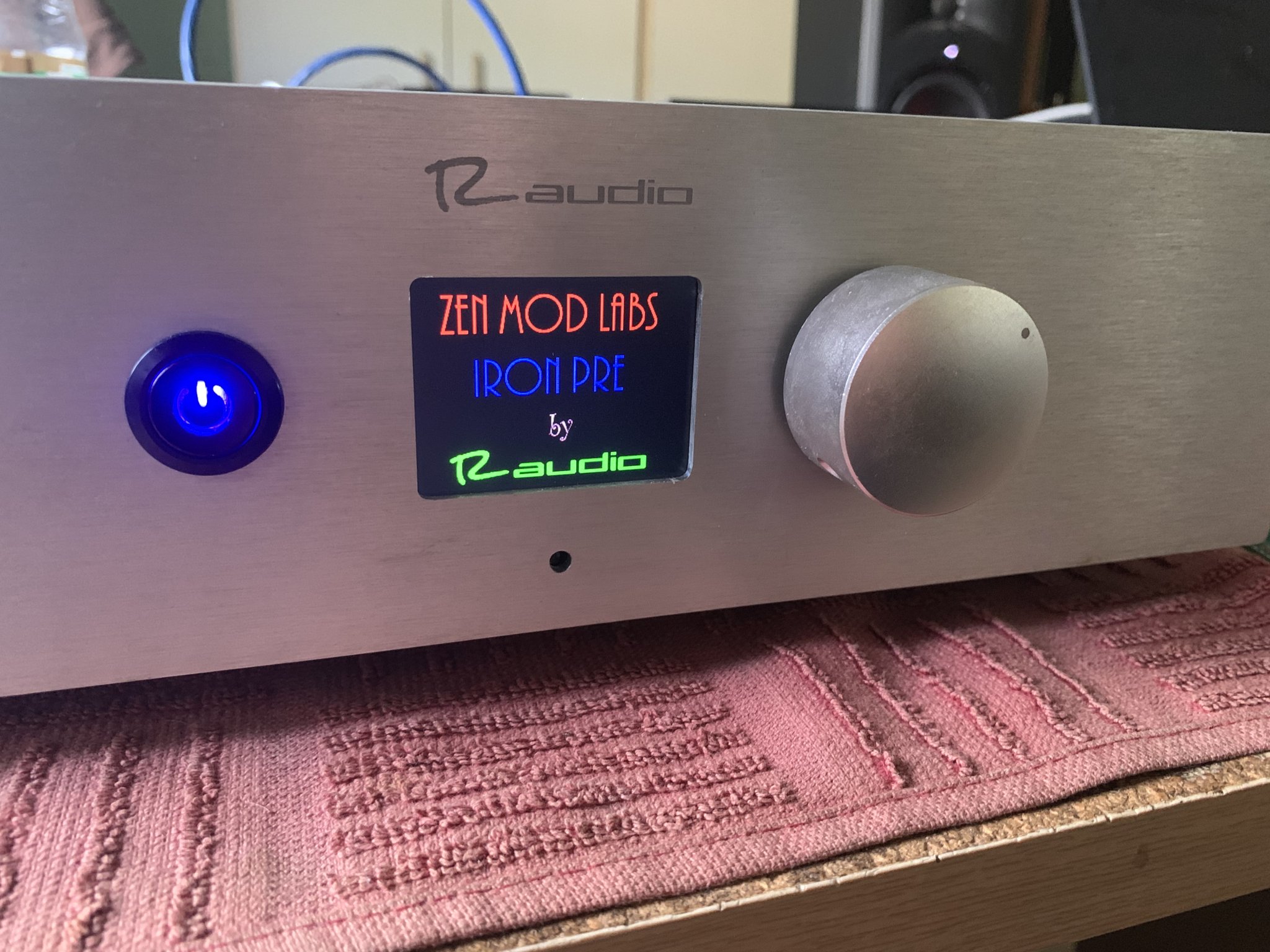

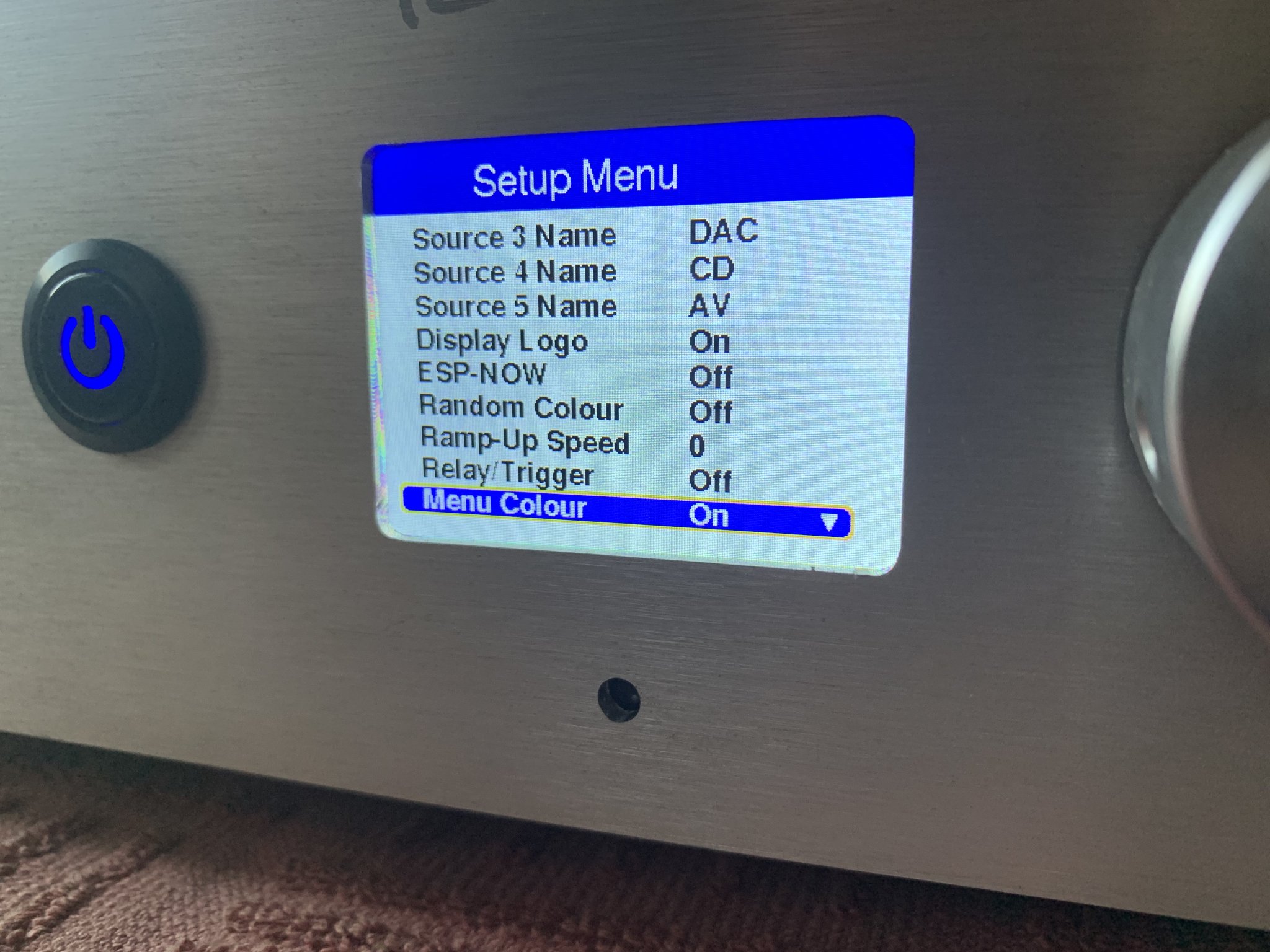

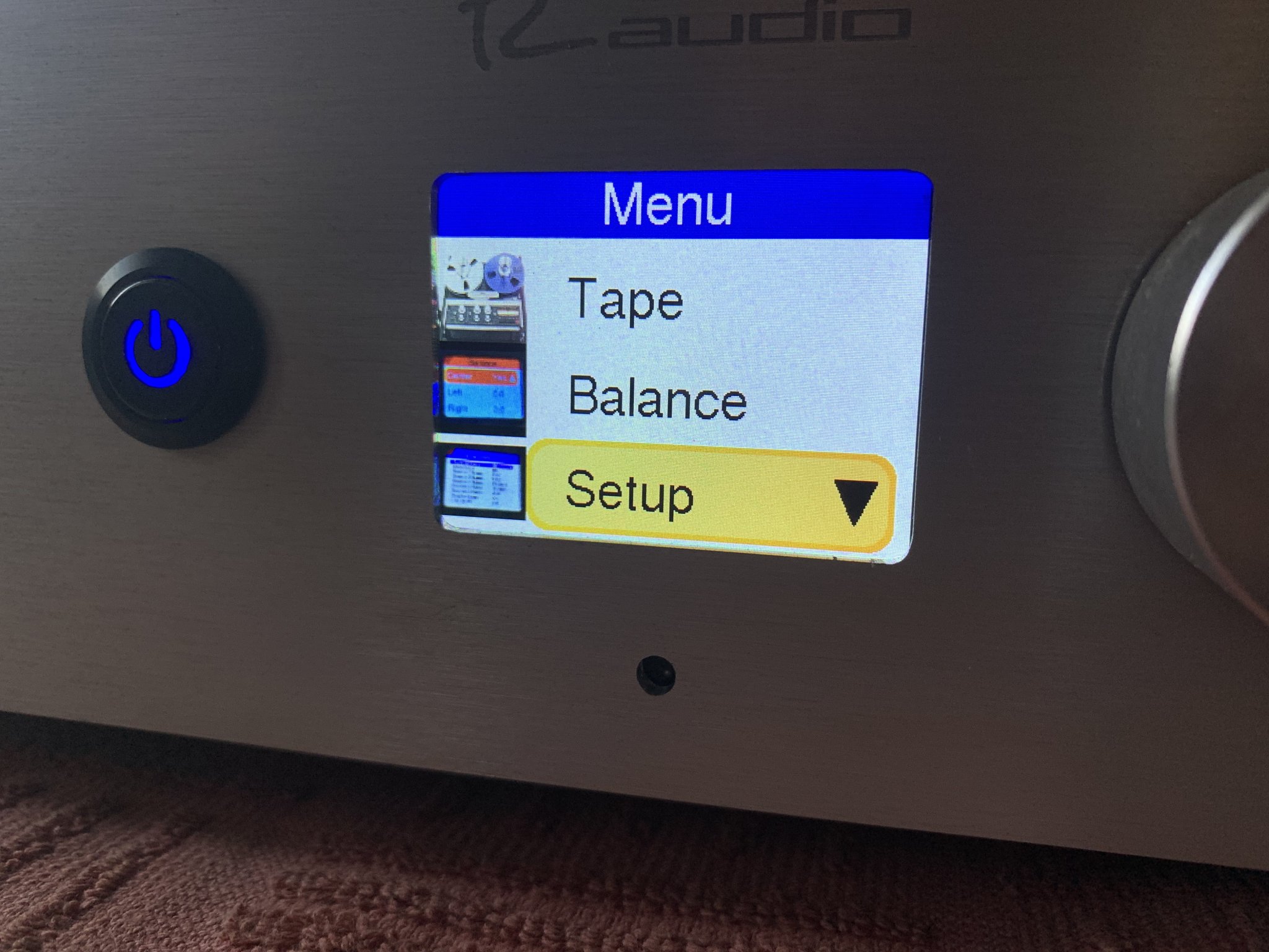

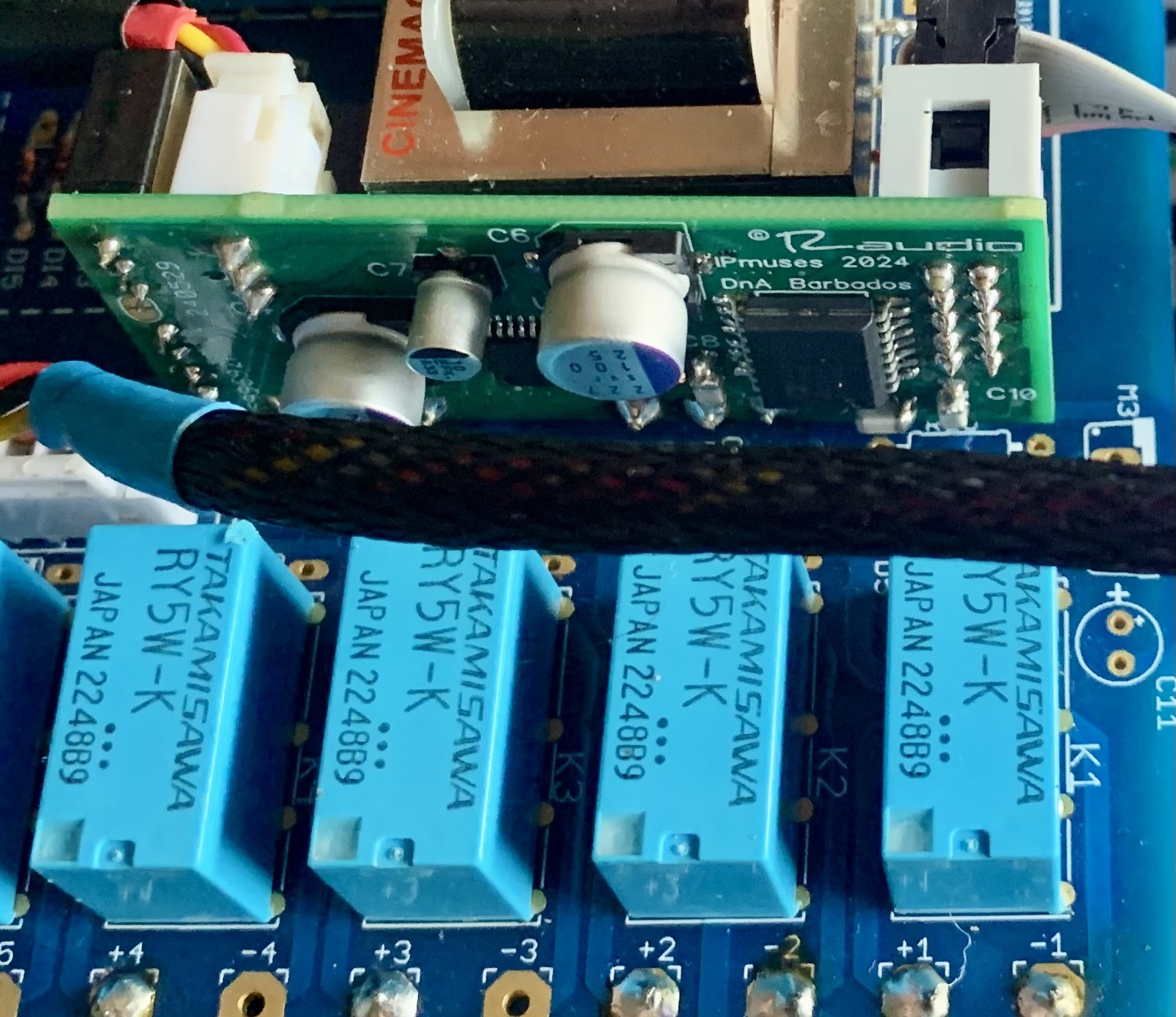

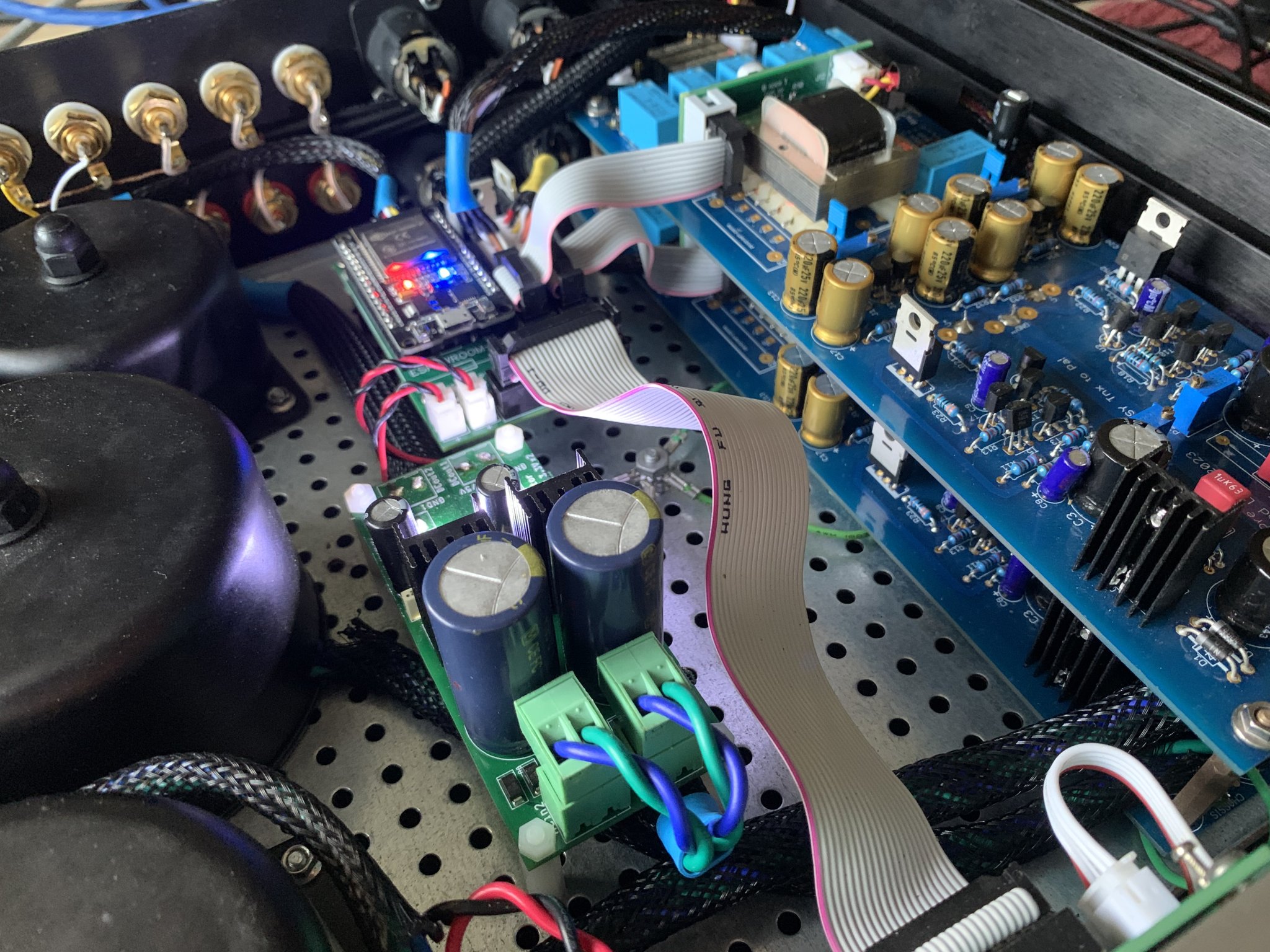

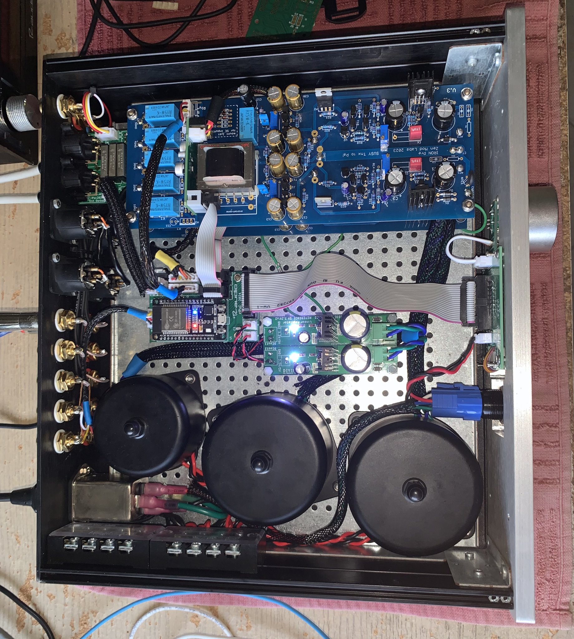

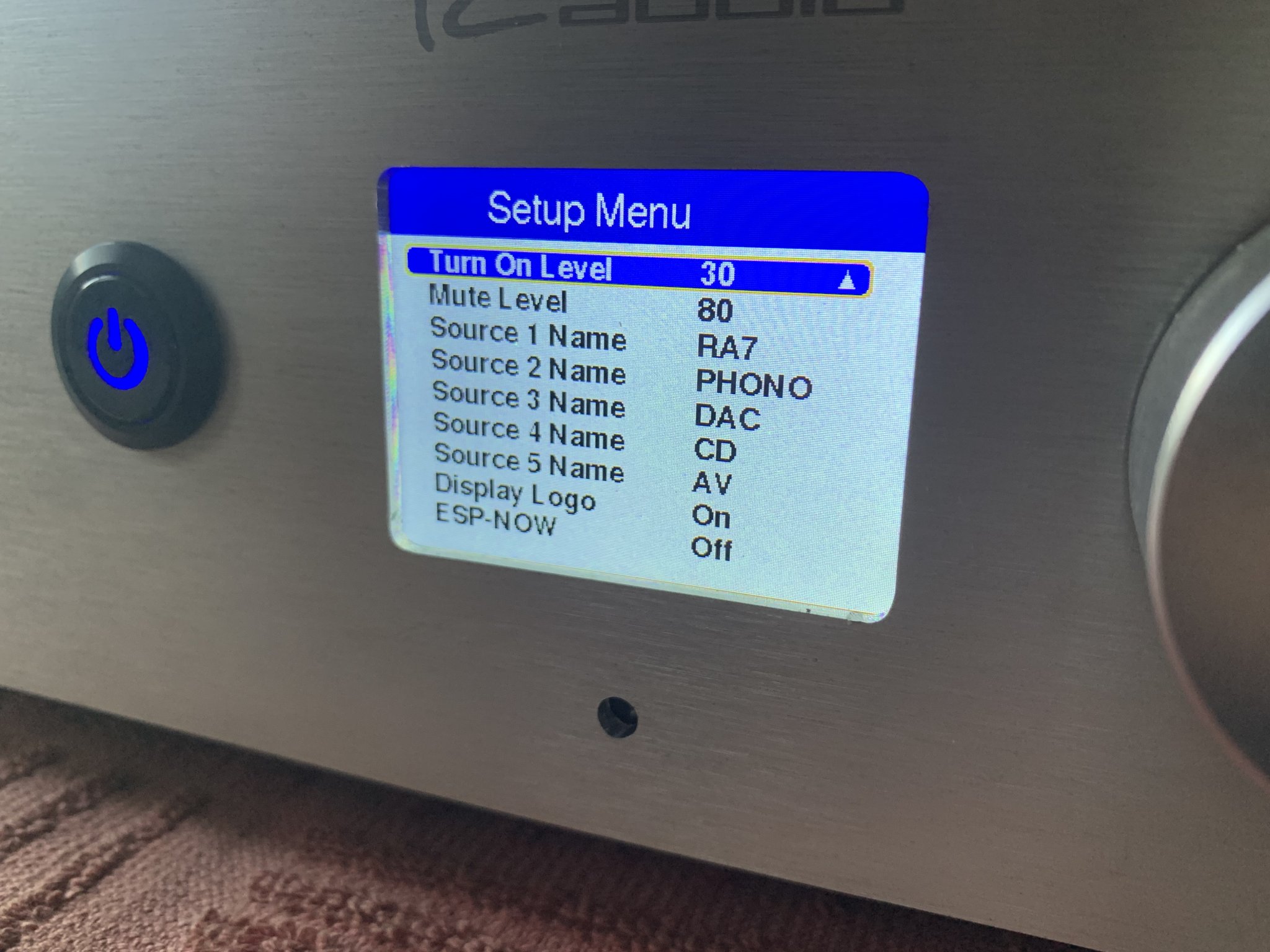

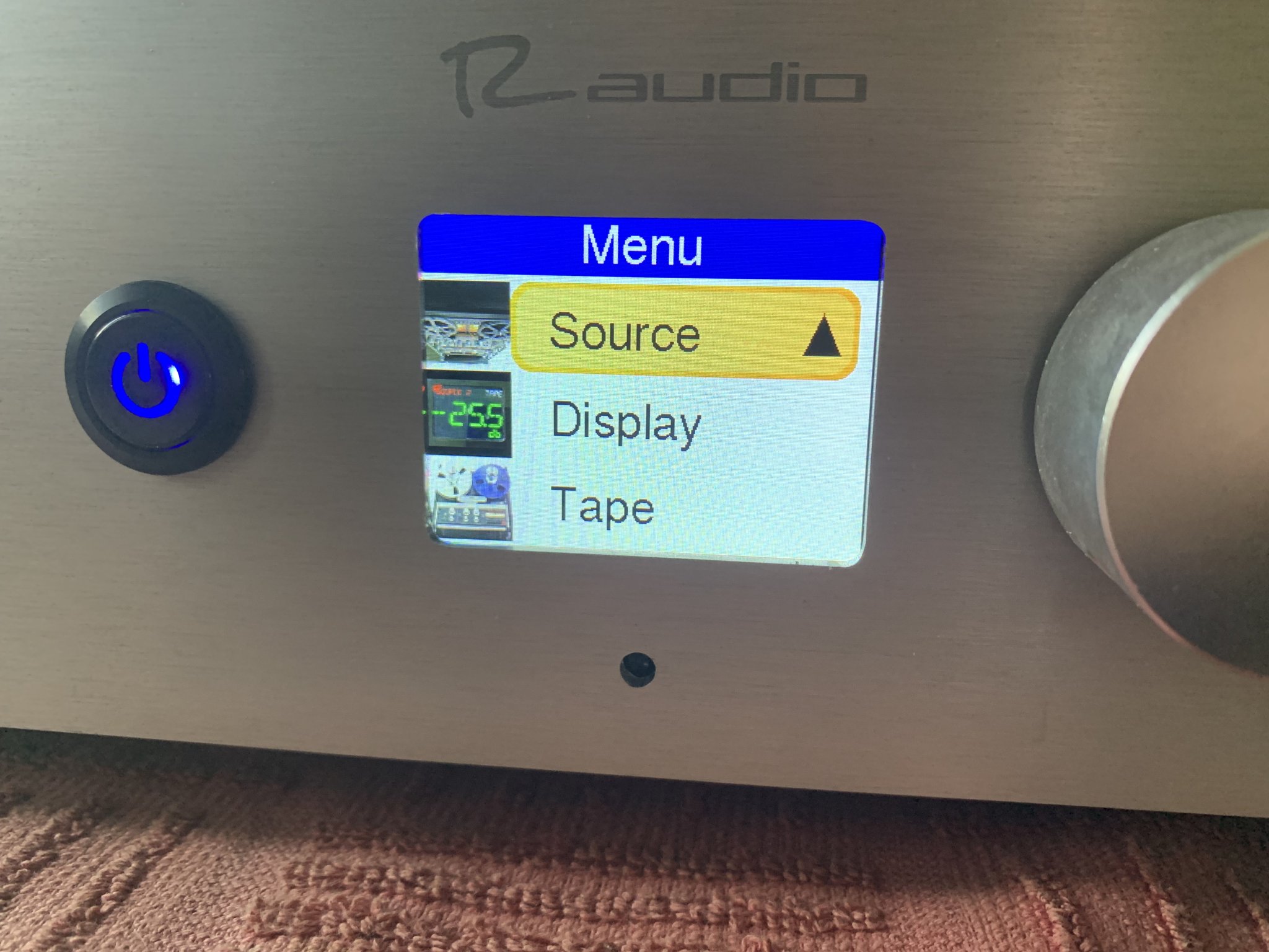

Back in Nov ‘23 I snagged one of the last balanced essentials kit. And, after @Skylar88’s enthusiastic endorsement of the ESP32, decided I’d use the IP as a platform to learn this new-to-me uC.
Here’s the result, a tape monitor, AV bypass, two balanced inputs and Muses 72323 volume control . Thanks to Frank Wilker for the great idea of mounting the Muses chip millimeters from the IP connection points (although I baulked at using solder as the sole support and used right-angle pins), thanks to @jpk73 for the debounce library and the refining of the Muses library. Thanks again to @Skylar88 for the ESP32 tips n’ tricks and, in case he’s beginning to feel left out - big thanks to ZM for the great-sounding Iron Pre! Lots of porn…
