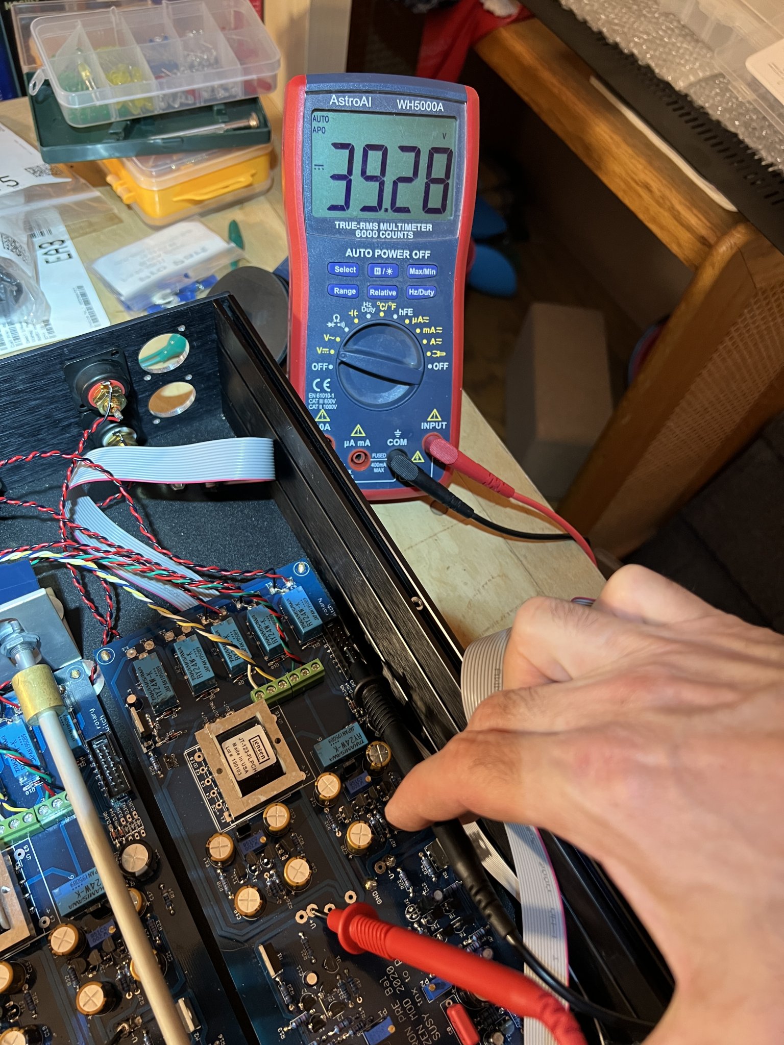

I checked voltage at the IDC. When I have one probe on GND, I get ~24v. With the probe on (-) I get ~9v. And with the probe on (+) I get ~39v. See attached pics.

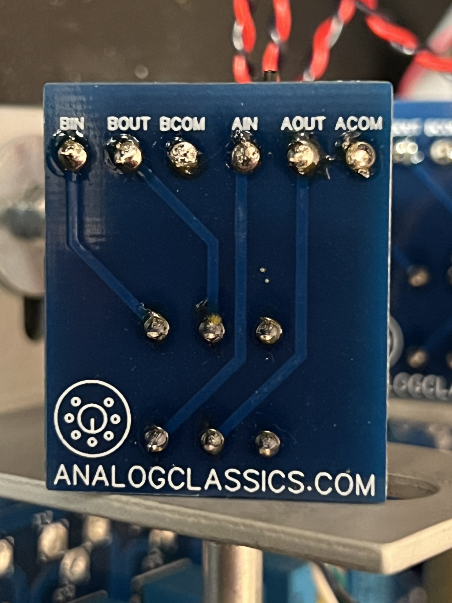

I double checked the volume pot wiring. I have COM > CCW, OUTPUT > WIP, and IN > CW. I'll go check again, though, since this seems like one possible place where I'm missing something.

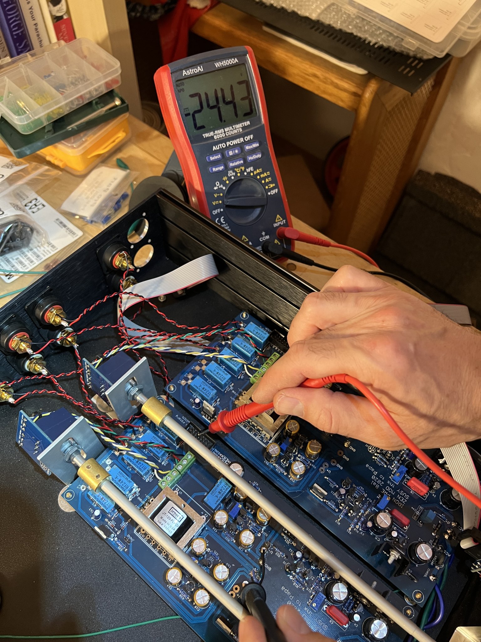

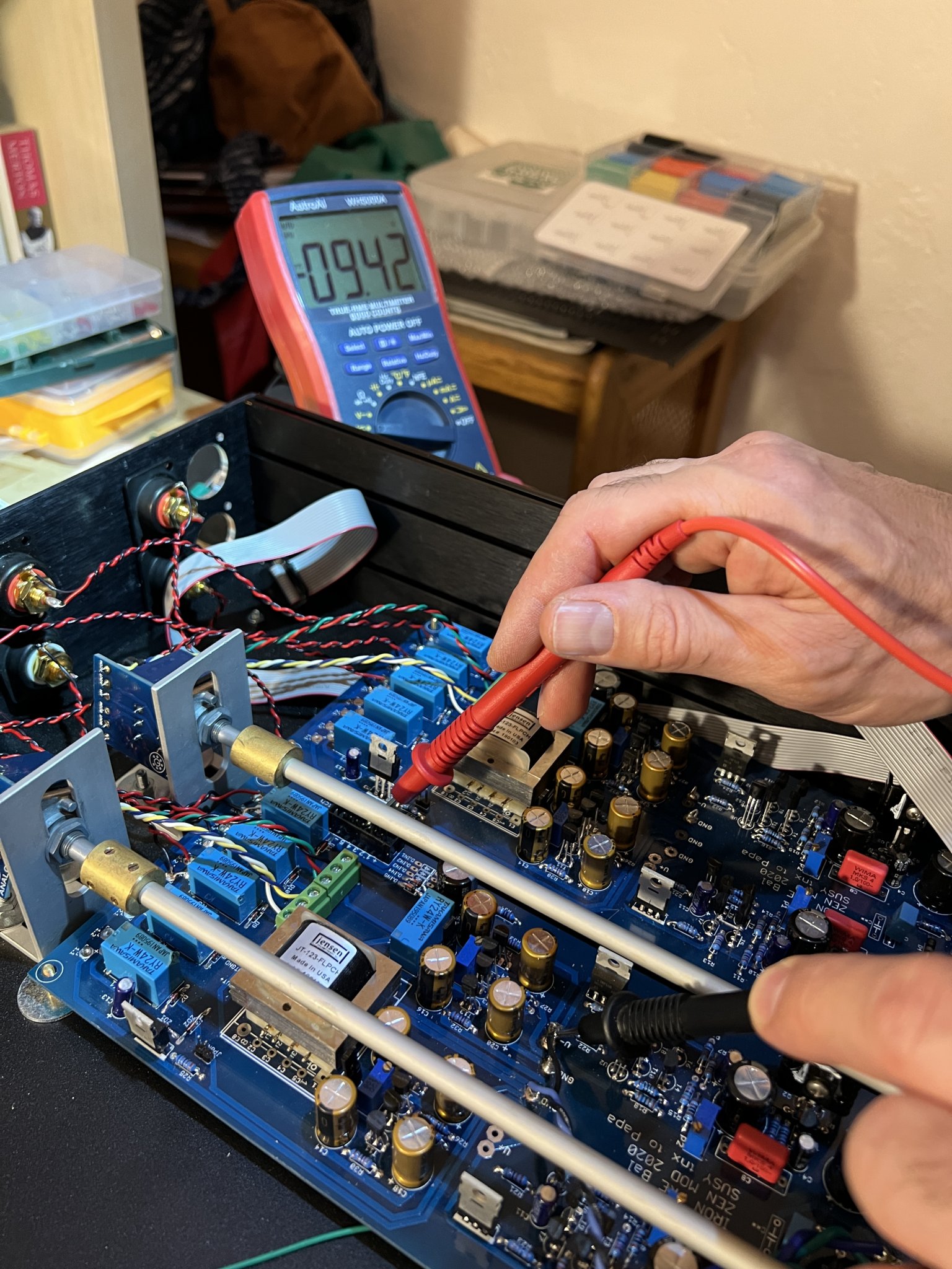

The great news there is that now you know you have power to the twister board. So... since that board is very simple... we can trace it back a bit to see what's up with your relays.
I am not sure why you're measuring from where you're measuring in the pics above. That's on me.
First, can you explain below in a little more depth, please. I want to understand when the relays clicked. Please don't replicate, but please explain. I should have been more clear... DON'T measure continuity / resistance with the unit powered, please. We could have some not-so-great outcomes. The only time I'd have the unit powered is to check a voltage, and clearly you have better manual dexterity than I to hold the probe on that header pin... 😱 🙂

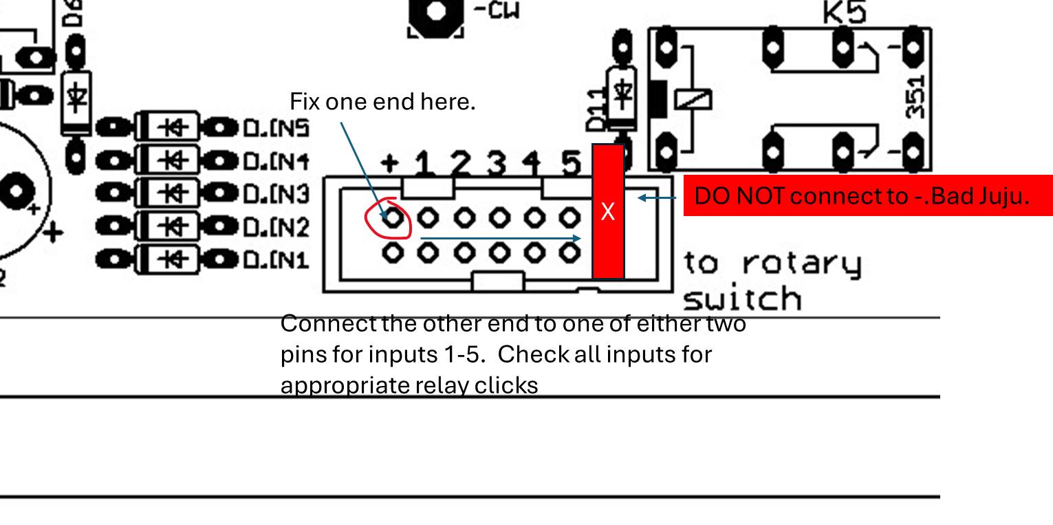

With the cables removed on the main PCBs using the box header - Short the + to the either of the pins marked 4, or 5. Both the input signal relay and K6 should click. Then do the same for 1-3. The input signal relays should click. Be careful. DO NOT short - to +. You can use anything, but a single female to female breadboard jumper like in the group below works well. (Don't forget to put in your diodes for input 3)
After you check that. Let us know.

My fault. Terrible at using words to describe something a diagram could do much more quickly and clearly.
On hearing the relays, it is very quiet, and the thunk of the switch positions can hide it. Turn the selector VERY slowly, and you can hear it, if it's there.Hello all, an update on the troubleshooting endeavor:

1. I'm getting 25vdc between the + and - pins on both IDCs. Thanks for the very explicit instructions on how to measure, ZM. I am a horse who needs to be lead right down to the water 😉

3. I tested the relays using Patrick's proposed method and I'm getting nice distinct clicks for 1-5 on both boards. (I added the diode for the third SE input)

5. I was re-checking my volume pot wiring against ZM's wiring diagram in post 1 and noticed that the order of connections on the PCB is different on the 2020 boards than the current version. I have it wired correctly based on the markings on the PCB (COM > CCW, OUTPUT > WIP, and IN > CW), but figured I should confirm.
