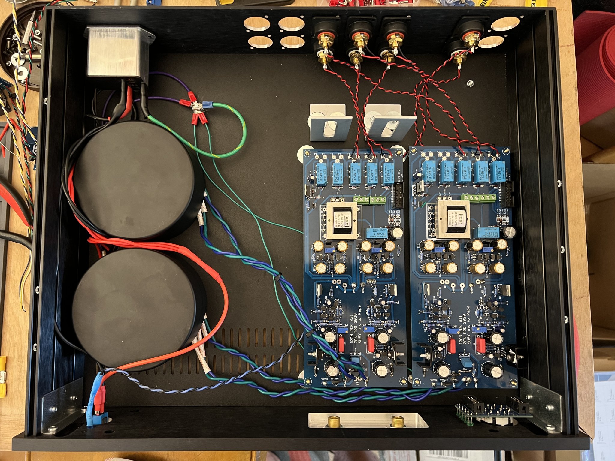

Whoops, wrong thread! My ZenMod Iron Pre is finished, only waiting to put knobs on. I just ordered chassis set for Pearl 3....Chassis on way. Now for those tiny bits.

Still puzzles on sound diff from my other iron pre. Old one has Alps blue pot, Jenson transformers. New one has the cinemag transformers and TKD pot. Only other differences are the 370 parts and the front panel switch hole.
as I'm also member from 2003, I'm aware of fact reading repeatedly Pa's explanation that 370 is 170, just less ceramic thus wimpier dissipation figure
which I cleverly checked, staring at goats and datasheets and pretending that I've seen something
so, that's excluding difference between 170 and 370
now, both Jensens and Cinemags are good; but they're different; that difference leading to possible subjective evaluation and logical result being subjective preference for one of them
same applies to Alps and TKD, but question is - did you use same value of pots and are they from same quality range; my limited experience with TKD is just with their highest quality range, all of them having conductive plastic and Voodoo metal brushes ...... btw. - I have general impression that TKD is having lesser percentage of cheaper series than Alps

I think it's the outputs. Or the switch hole. Ok, I'm now over to XA252 thread to ask about F5 and likely hood of driving F4.
