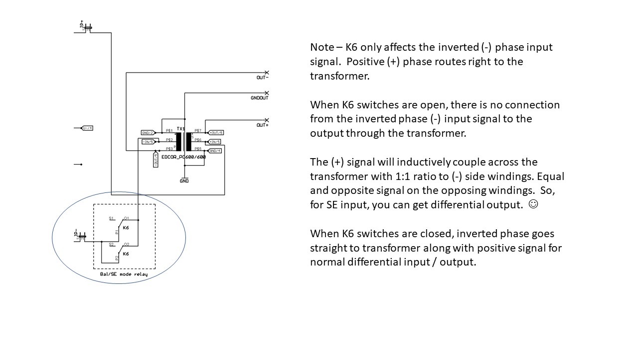

From earlier... or another thread...

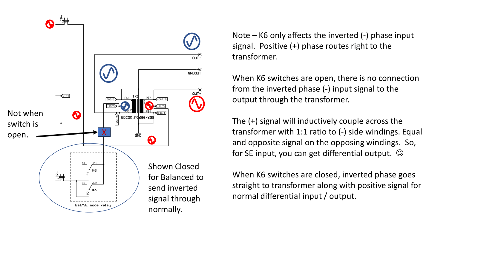

See previous posts... ;)
Balanced Iron Pre can do...
SE in SE out
SE in Bal out
Bal in Bal out
Bal in SE out
Neatest trick is SE in to TRUE balanced / differential out.
See schematic and K6 => neat routing of signal through signal transformer for SE.
