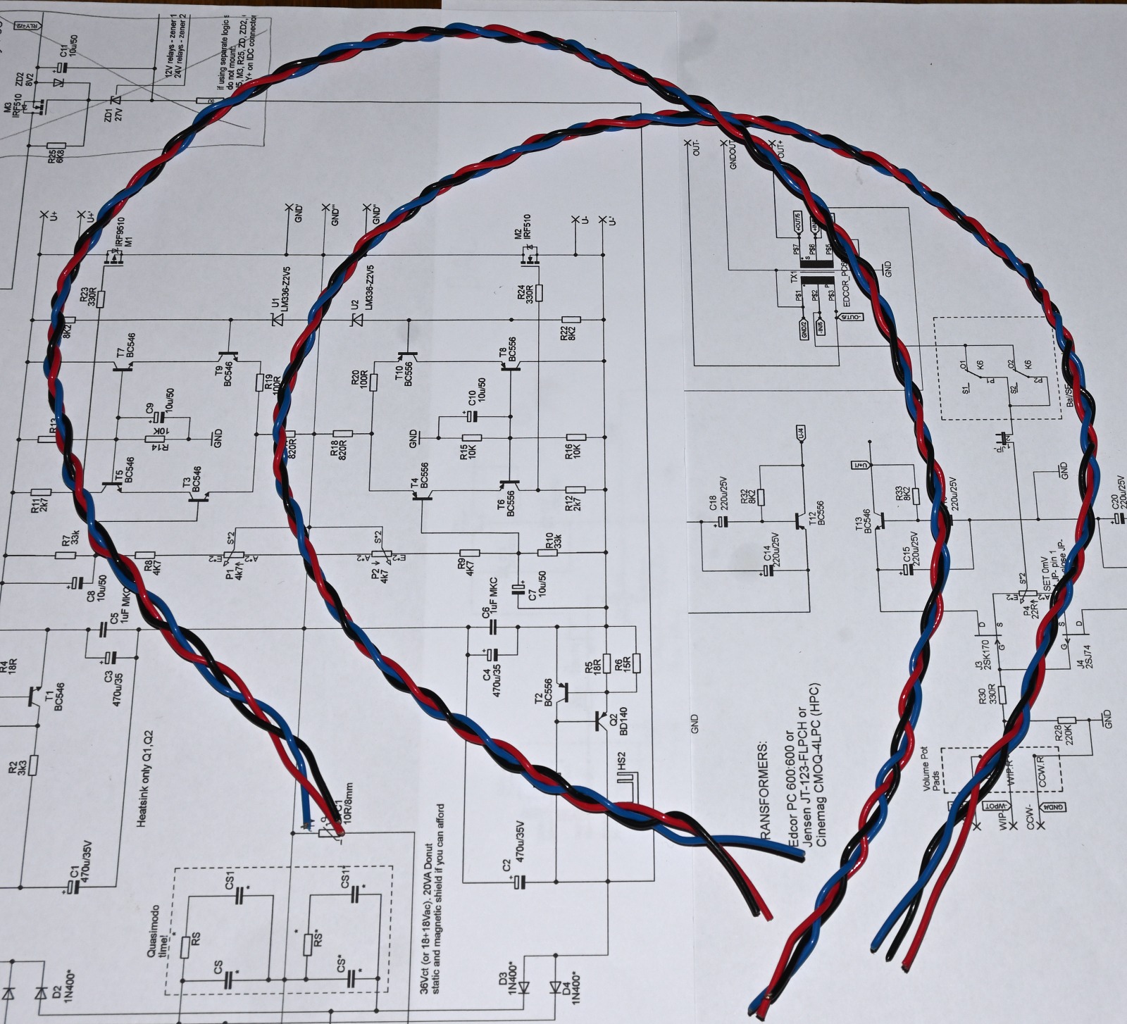

One more thing:
I have some AWG30 wire wrap cable on the way for the input wiring (silvered 🙂 ).
I was thinking about the technical reason for using very thin wires for input.
Is it primarily to have theoretical same impedans for all frequencies (e.g. 20 - 100 Khz):
https://www.powerstream.com/Wire_Size.htm
I was also thinking about when those thin wires are twisted then the coupling is very close and then maybe less chance for e.g. magnetic noise to couple to the "cable"?
One more thing:
there are many technical explanations why thin conductor should/is sounding better for small signal
though, you can hear/read them all, then you're in same situation as plain Believer - if you need to ask, then certainly you don't have knowledge and/or necessary apparatus to actually test and confirm/deny said claims
so, I'm stuck on tasting and not testing - thin signal wires are best to my ears, in my system setup logic
and I believe that Buddha is everywhere
Ok,
I have an unfinished experiment using twisted PTFE silvered wire cables as RCA cable. I never got them terminated.
It was to make a very cheap DIY RCA cable that has low capacitance and immune to magnetic fields. For RCA I would connect black and blue to Gnd and red to hot (could be used for XLR also I assume).
Now with AWG30 I could try the same and it should work very well? ......better then XXX $ cables? 🙂
Apart from a maybe little problem with physical strength.......it could be fun to try.
Maybe a little bit off topic......but as you can see.......IP-schematic is included.......
