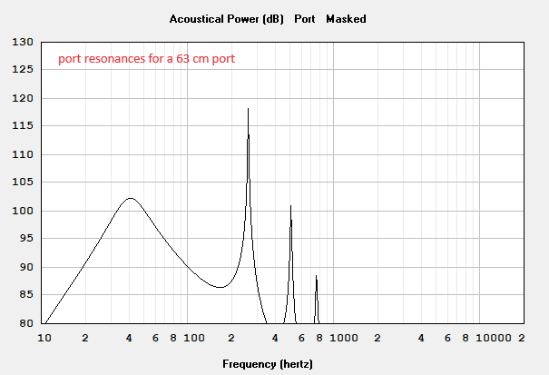

if the port is around 63 cm long that would correspond to a 270 Hz wavelength:
speed of sound / (2 * tube length) = resonance frequency
340 m/s / (2 * 0,63 m) = 340 / 1,26 s = 270 1/s = 270 Hz
depending on the distance between port exit and driver that will result in a deep notch, similar to the one you measured.
a deep notch in frequency response always translates into a sudden phase shift. the two are inherently connected (considering a minimum phase system).
even a very deep notch is usually not very audible and most importantly, this notch will not be there (or not as trong) in a real listening situation, including reflected sound. There might however be a problem if there is a narrow peak of total sound energy at 270 Hz.

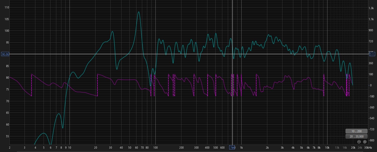

you could measure that with the microphone at your listening spot and with no or long gating times.
It's not really that important to provide both graphs - in other words you can look at either graph and know what's going on - but response graphs are easier to interpret for me 🙂
you can see the effect of a port resonance for the total response in my measurements here.
Hi, this was mighty useful, thank you!!
Indeed I have port straight behind the driver, as in your linked post, later I will sketch speaker internals just to be easy to see.
In room, both speakers on and in listening position (or about it, we walk a lot 🙂, the 270Hz distortion is pretty much gone as you suggested it would probably. Tons of other room elements come in to mess the graph up completely, but that 270 Hz thing is not that visible any more, if at all, just like you said....
This is in room, stereo driven in the roughly listening place:

Calculations above show first resonance, but it has also harmonics at 2x, 3x etc. frequencies. Can the math tell the relative strength of harmonics? Overload turbulence is more like noise, but is it mostly at resonance F?
As we know and have seen in measurements, port resonance and noise can be problematic with 2-way speakers. If port is wide and/or on the front baffle, typical problems can be seen in even at low spl in frontal frequency response, and best in 360deg spinorama.
only if there are sharp edges and/or for very long ports with low flare rate.
usually the resonance strength is reduced with higher harmonic number. you can simulate the port resonances (but not the resonance chuffing or turbulent noise) with hornresp. so I guess there is a mathematic formula behind it!
EDIT: if you activate enclosure resonance masking and only show the port output you can see the isolated port resonances, here with a 63 cm port (disregard helmholtz tuning):

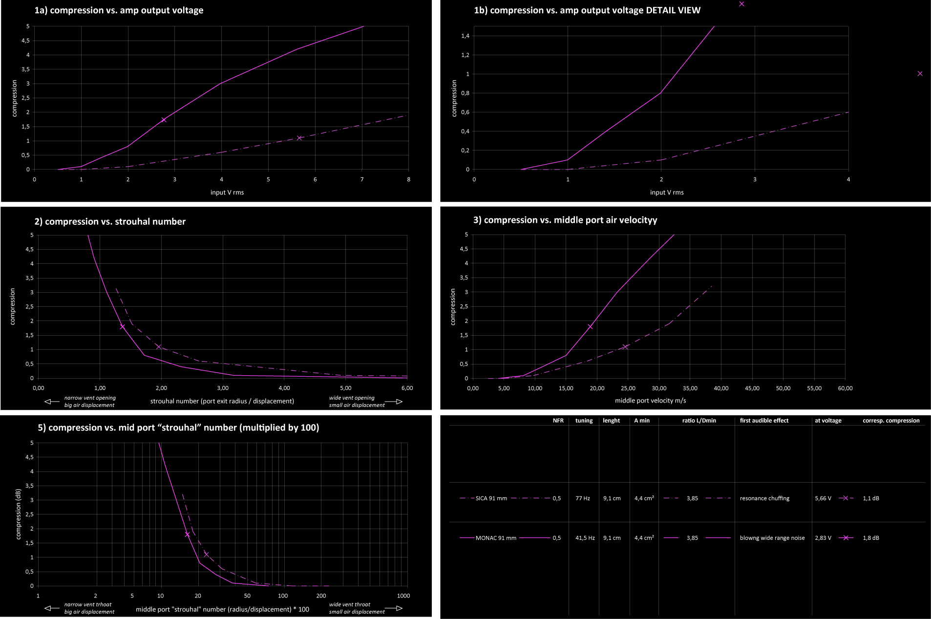

1)
the "91 mm" port using the small SICA box (tuned to 77 Hz) and the bigger MONACOR box (tuned to 41,5 Hz).
Both the graphs for SN and MPSN are very similar. The MONACOR speaker is slightly better, as far as I have observed because of lower tuning.
There is probably something wrong with my calculations.
At the 2.83V measurement point, in the 41.5 Hz tuned box with the 91mm long port, the chart reads strouhal ~1.3.
When i try to calculate the same value, I get:
Air displacement: (19/(41,5*2*pi)) = 0,075 m or 7.5cm
Port exit area: (from drawing) 4,4*2,46^2 = 27 cm²
port exit radius: sqrt(27/pi) = 2,9 cm
2,9/7,5 = 0,4
So I think I'm doing something wrong...
you cannot use the air velocity of the middle port section.
you would need to relate it to the mouth surface first:
velocity at mouth = mid-velocity * Amin / Amouth
in my case this is 4,57 m/s translating into 1,75 cm displacement and a corresponding strouhal number of 1,3.
that's the interesting thing: the port diameter is proportional to the radius, but the velocity will decrease by the square of diameter (or radius), because the velocity is inverse to the surface area.
so changing the port diameter just slightly will massively change the strouhal number (and the MPSN).
there is something wrong with your calculation... or my drawing is misleading.
the effective port mouth diameter is 48 mm, radius is 2,4 cm.
Sound is a linear perturbation about mean fluid conditions. Linear means there are no harmonics. To predict sound harmonics we need to consider more than just the linear wave equation which can be done in a number of ways. Unfortunately what we consider has to be nonlinear and to include motions involving at least vorticity as well as sound which means CAA/CFD rather than linear acoustic BEM/FEM.
The most cost effective appraoch for fluid speeds before the onset of turbulence (i.e. only discrete tonal frequencies) is likely to be aeroacoustic harmonic balance. This effectively requires a steady state CAA/CFD simulation to be performed for the fundamental frequency and repeated with slightly different terms for the first few harmonics. It also requires the use of a nonlinear model for the driver which, as Tenson pointed out earlier, much of the data for which is starting to become available for some drivers like those from Dayton. If the software can be sorted out a reasonable set of frequencies is likely to be doable with a good desktop though it might take a few overnight runs.
When turbulence and chuffing starts it is very unlikely at such low Reynolds numbers a steady state turbulence model will be able to represent the stresses in a meaningful way and so the full unsteady Navier-Stokes equations will need to be solved through time. This not only becomes computationally large but there will be numerical problems to do with scale at such low Mach numbers. Performing a frequency sweep (i..e. like an experiment) is likely to require a fair few overnight runs on a good desktop machine and will be pushing what is viable at home. Of course one can hire time on a remote High Performance Cluster (HPC) easily these days but the cost will likely be pushing that of a good desktop after one or two runs.
The velocity of the flow needs to be high for turbulence to begin and the highest velocities occurs at or near the resonant frequency. There seems to be some confusion in this thread about what is turbulent flow and what is unsteady laminar flow.
Thank you! I have corrected all my calculations. Again!

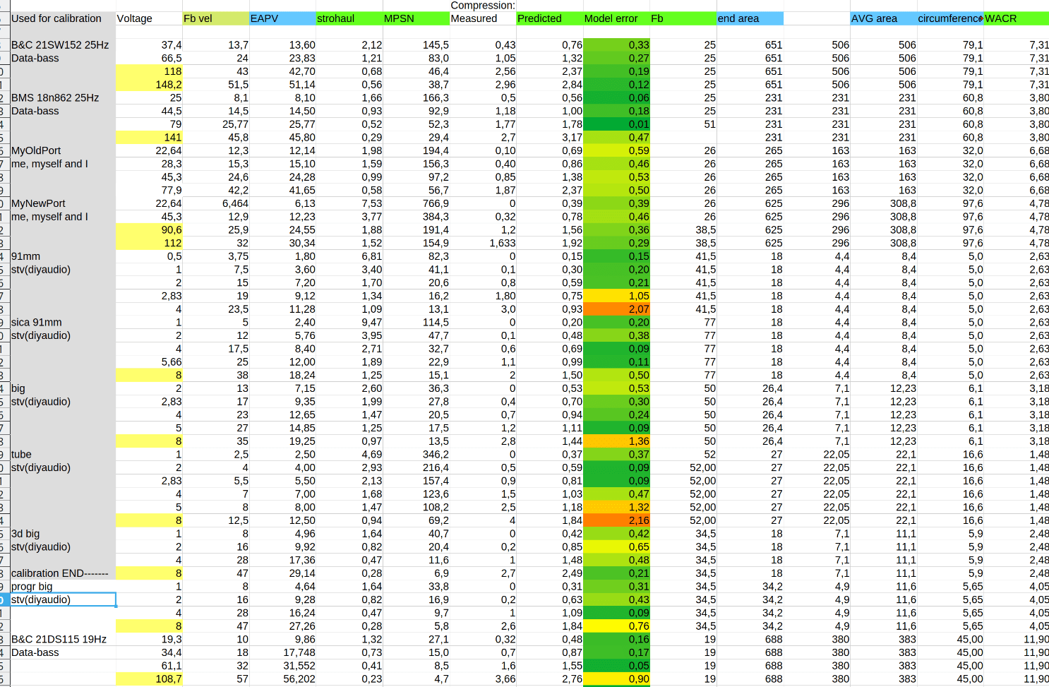

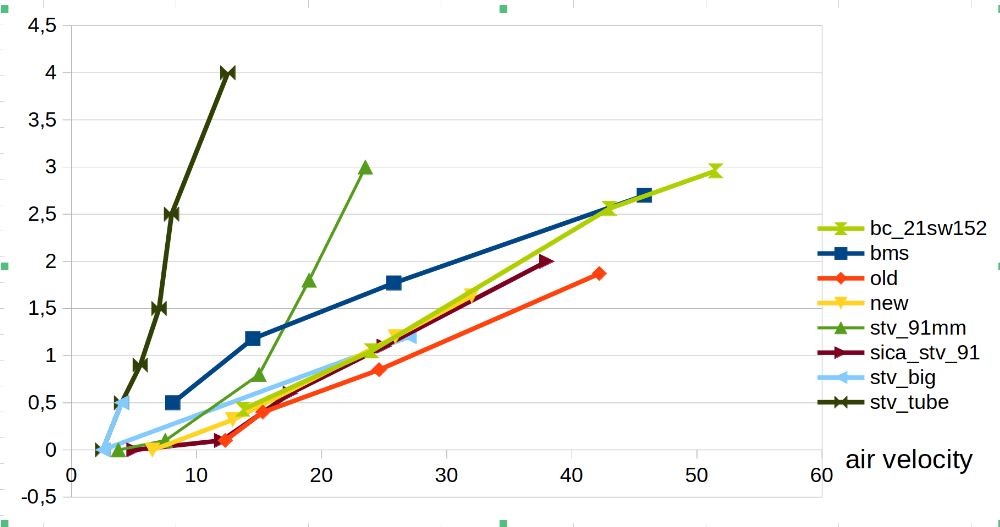

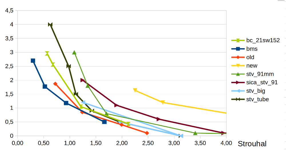

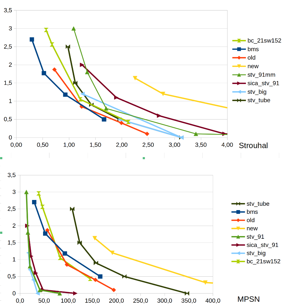

I've added some of your ports, and two subwoofers from data-bass to my spreadsheet, 21SW152 25Hz and BMS 18n862 compact.
I wanted to compare port velocity and strouhal number, as a predictor of port compression.
Note that I have not attempted to remove thermal compression from these graphs.
As you can see, in the >1 strouhal range, it is a good predictor for port compression if my new port and stv:s 91mm port in both enclosures are excluded
Here is mid port air velocity. Good predictor for compression if we exclude your tube port, the 91mm port in 41,5Hz tuned enclosure and bms18n862 port from data-bass.
So what about the exclusions?
For the strouhal number chart, I think that my new port and the 91mm port in the sica enclosure simply reach too high mid port air velocity to benefit from the large vent opening. The 91mm port in the 41,5Hz enclousure, is probably limited my MPSR.
If we look at the air velocity chart. I think that stv tube port, and the BMS port is limited by strouhal number. stv:s 91mm port is once again limited by MPSR.
I looked through your charts again, and I could not find a port that compressed less than 1 db at 30 m/s, except the SONY woofer that sometimes had backwards compression. So it looks like port velocity does matter, although another explanation is that might just have messed up some formulas again...

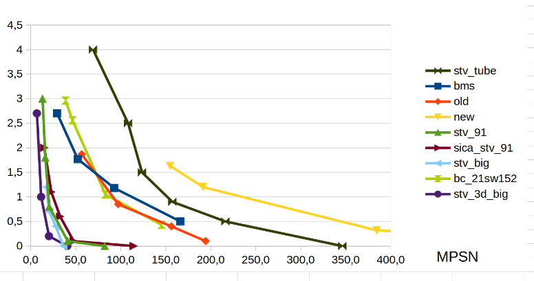

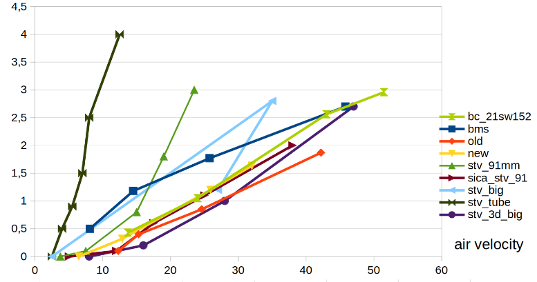

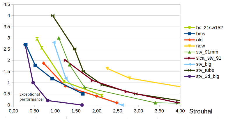

As expected, I made another mistake, the stv tube port was affected by an input error in my previous post. Fortunately, the other ports were unaffected.
I'll re-upload the charts. I have also added your 3d_big port to the charts.
The 3d_big port does very well, compared to the strohal value...
And MPSN...
Also good air velocity performance, but it does not completely outdo the other ports in this regard.

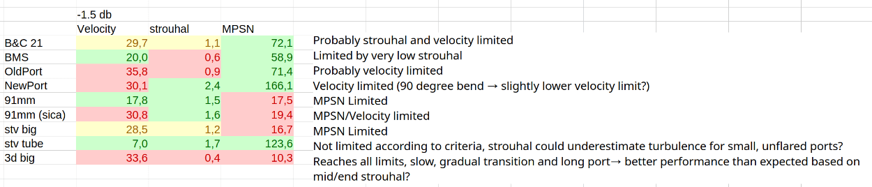

Here is some analysis on the limiting factors for port performance:
The chart displays mid port velocitty, strouhal and MPSN at 1,5 db compression (linear interpolation used to get values at "exactly" 1,5 db) and some speculation on what's causing the compression.
Limits:
Strohal: <1.0 red; <1.4 orange
MSPN: <20 red
Velocity: >30 red; >25 orange

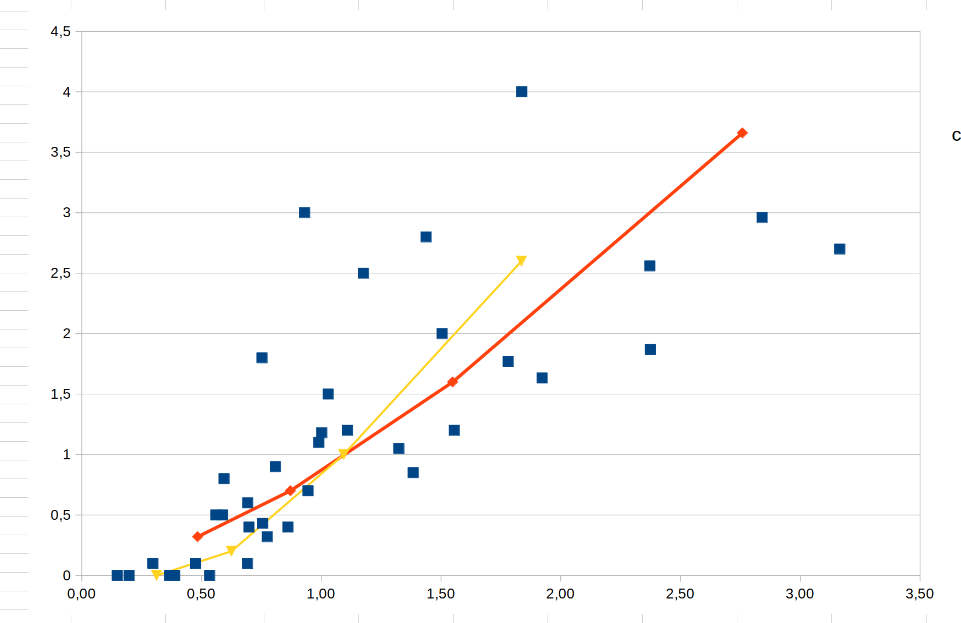

I've been messing around with the port measurement data some more, and attempted to create a model that predicts port compression (or, I did, but I'm not sure it works yet, so I'll go with "attempted").
Y axis: Measured compression in decibels
X axis: Predicted compression in decibels
The blue dots are all the ports included in my previous posts, I used that data to create the model ("calibration").
The progr_big (stv) and B&C 21ds115 X21 was added after the model was created, to see if the model predictions work for ports not included in the calibration data. I should have added a few more, but I was a little tired of entering data, I can say it worked for those ports though.

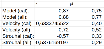

Correlation coefficents for different predictors of compression, and measured compression.
The (cal) coefficents only use calibration data for the model.
As you can see, the correlation for the model actually increased after adding the progr_big and data-bass X21 ports, which is a good sign, but I might just have been lucky.
Yellow voltage = possible thermal compression
I used U^2/Znom > 0,7*AES for the large speakers and U^2/Znom > 0,5*RMS for the monacor driver. (I guessed you had the 4 ohm version, could be wrong)
I intend to upload the spreadsheet here after cleaning it up. 🙂
The model:
EAPV * (10*LOG(10*WACR-10))^-1 = predicted compression in decibels
Basically, the log function estimates the (compression/air velocity) slope based on a weighted area/circumference ratio of the port.

I had apparently calculated the circumference for all the round ports as pi*r instead of pi*d.
I have now fixed that, and recalibrated the model. I did not use the last two ports for calibration, to keep raw data the same.
Correct input data gives you better predictions!
The new, adjusted formula is
(EAPV-4)*(10*LOG(7*WACR-3,5))^-1
Results below zero are set to zero.
I have uploaded the spreadsheet.
I've tweaked the model a bit, and made a desmos link so people can try it.
For "tube" ports with circular flares:https://www.desmos.com/calculator/alrsqx2a36
For NFR ports: https://www.desmos.com/calculator/qv9sjpvff7
x= peak air velocity (m/s)
y= compression (db)
I've found that the model becomes unreliable with the combination high flare rate and high velocity, so it will not make predictions when
(Peak Velocity (m/s) - EAPV (m/s))/ port length (cm) exceeds 0.9.
I'll explain this, and some other stuff in more detail later...

Let me know if my collection of data would be useful for you in excel fomat. I can send it to you, I'll just have to re-organize it, it's quite a mess at the moment.
  • Thank You
Reactions: fufuheo
Thank you and yes, your collection of data would be very useful to check the model.
I'm going to make a post that explains everything in more detail, I need some time, but I can hopefully get it done in a week or so.
Please ask if you have any questions, it would make it easier to choose what parts should be the focus of the explanation post, and most likely, I'll be able to answer them before I'm done with the post.
