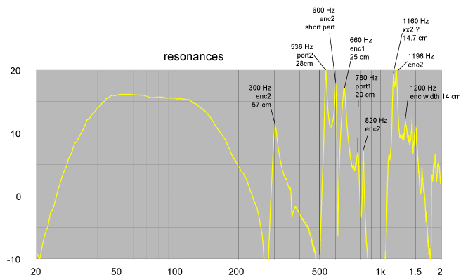

Oscillation node (pressure maximum) is at center of port (or further divisions for multiples).
pressure absorber works best at the respective node.

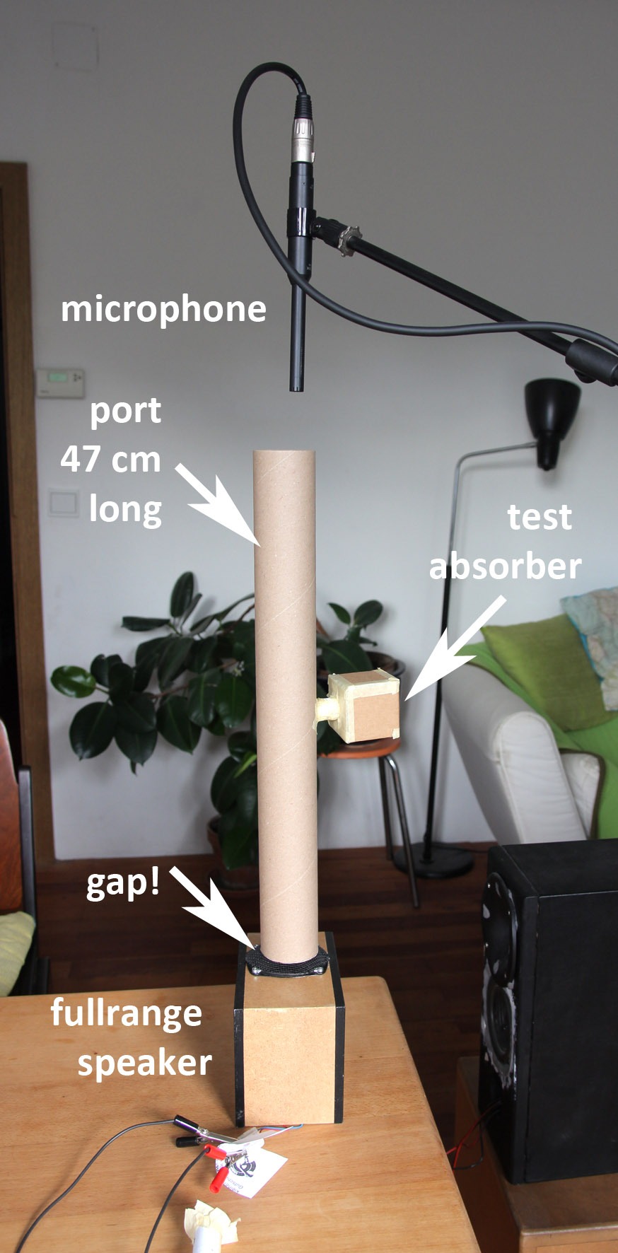

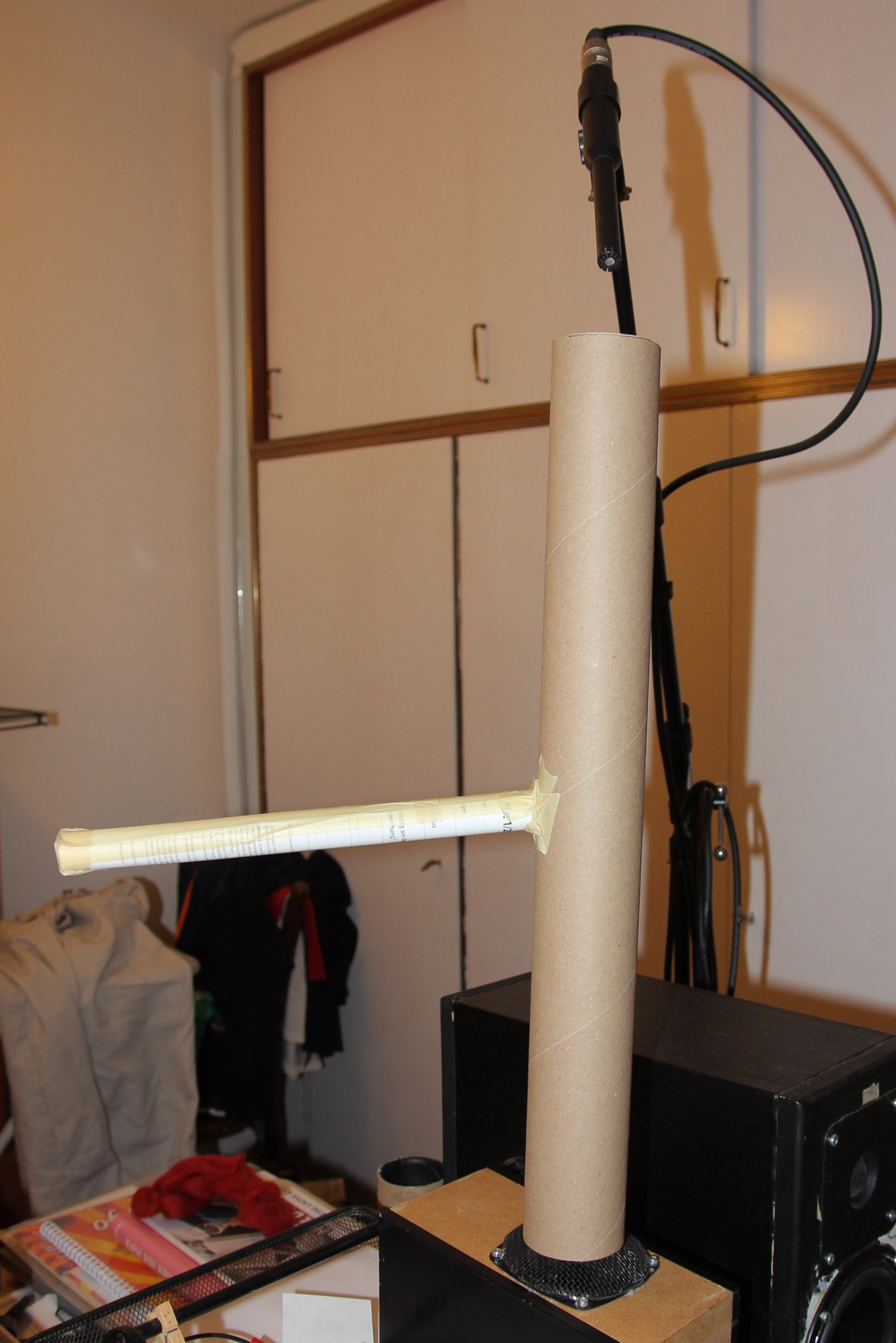

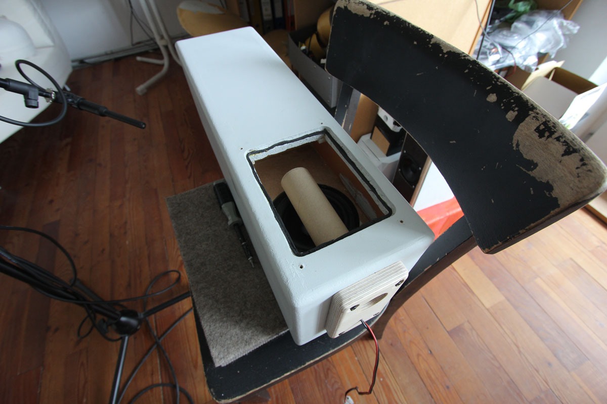

test parameters
test port length: 47 cm long, 5 cm inner diameter plotter paper cardboard tube, no flange for this test, note that usually bass reflex ports will have one or even two flanges.resulting first (fundamental) test port resonance: 332 Hz
I chose a very long port on purpose to amplify resonances!

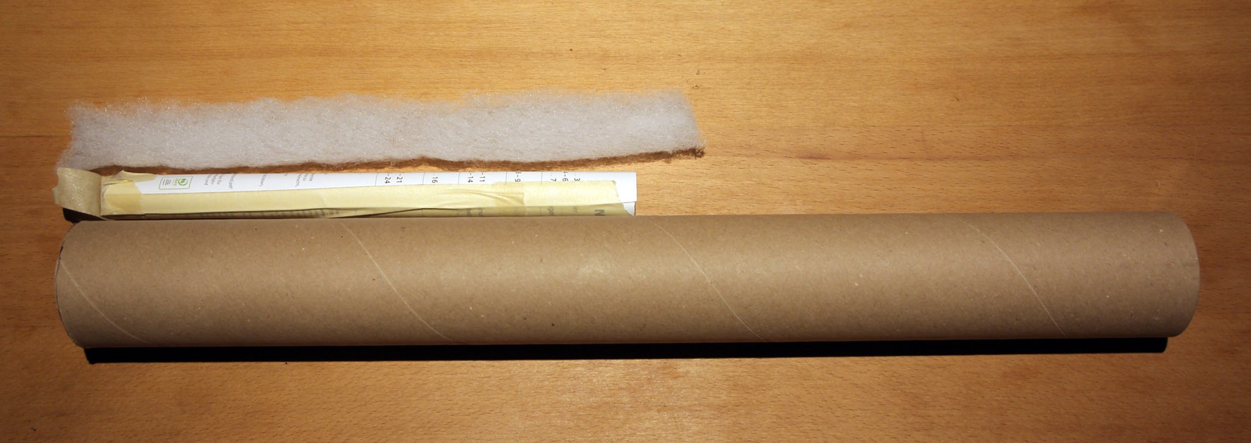

test tube absorber:
2 cm diameter paper tube made of multiple layer rolled strong paper, length as described (half port length).photo with batting strip, test tube absorber and test port:

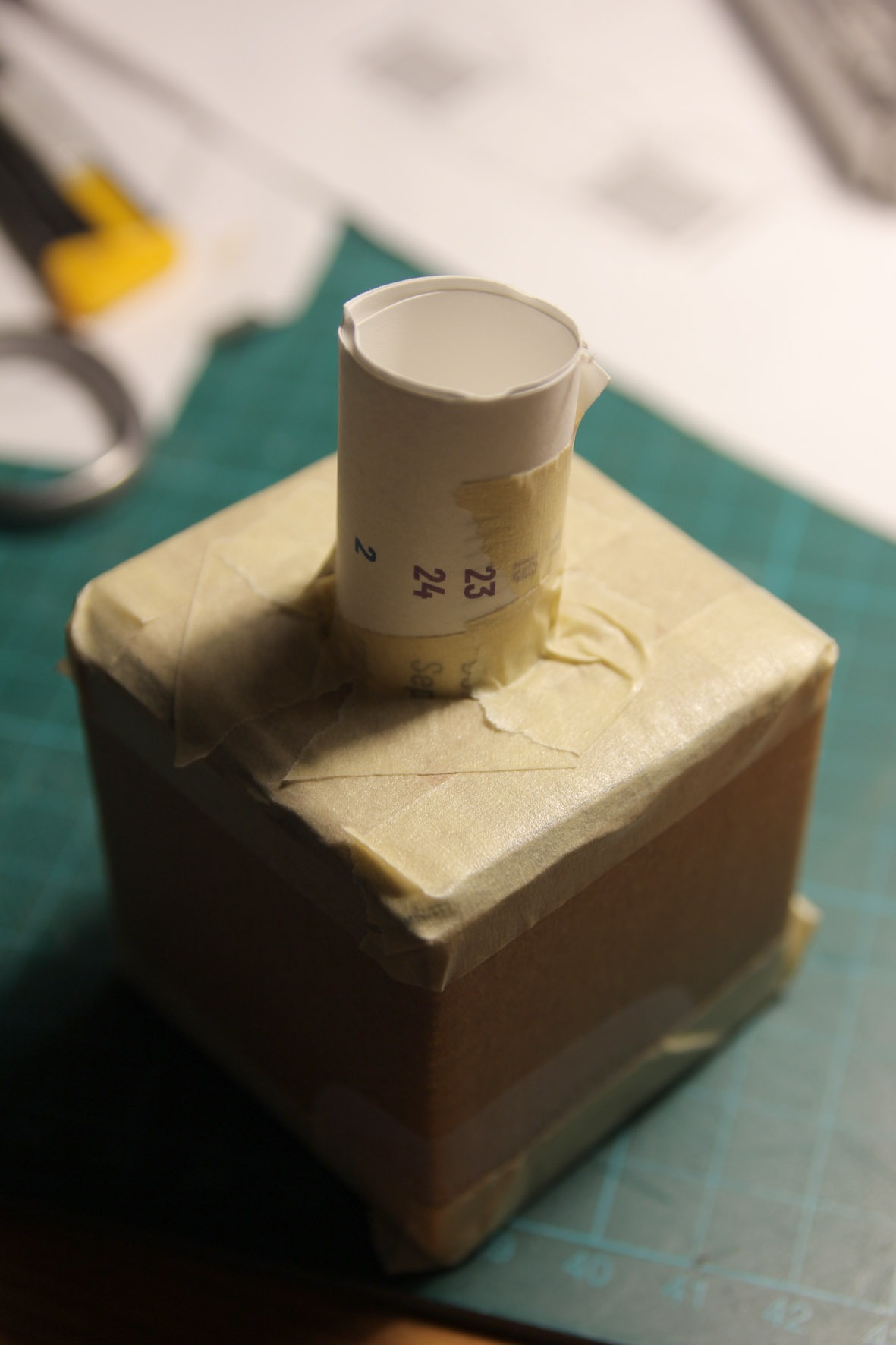

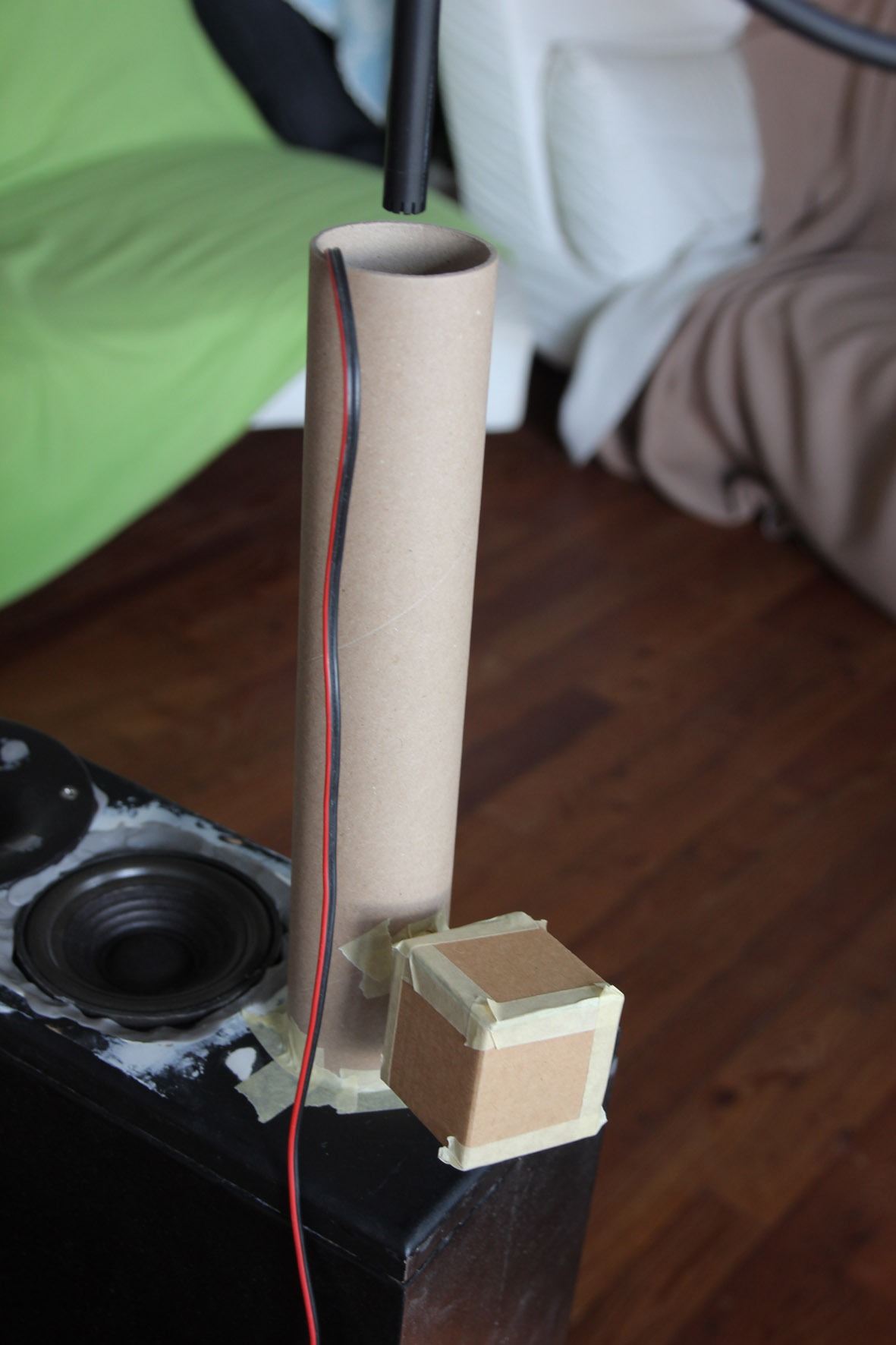

test Helmholtz absorber:
5*5*5 cardboard cube with 5 cm length 2 cm diameter paper tube port (resulting in 334 Hz Helmholtz resonance frequency).

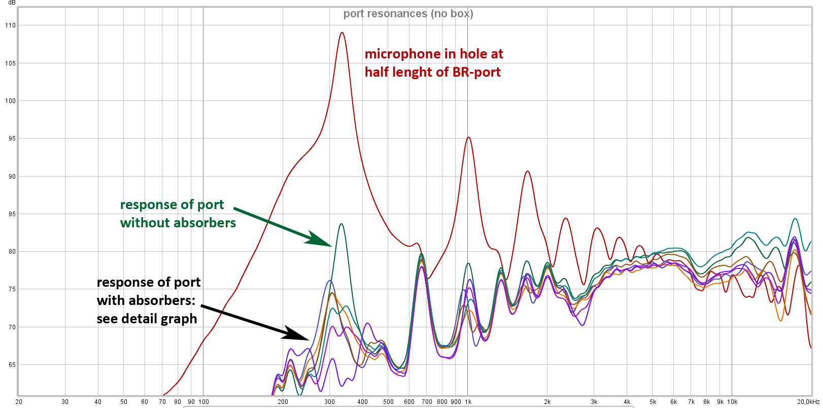

test 1
big port freely positioned in front of a fullrange loundspeaker as oscillator with about 2 cm distance, microphone at the other end of port.Proximity to the fullrange loudspeaker slightly lowers resonance frequencies, in this case.
setup photo with helmholtz absorber.

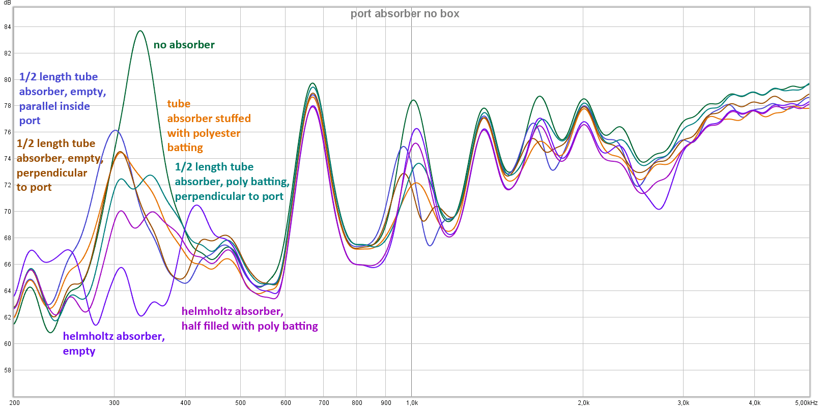

overview of measurements
these include one measurement with the tip of the microphone inside the port at half length through the 2cm hole, selaed with tape!measurement details
the absorbtion of fundamental resonance seem to work just fine! as I expected the second resonance peak is not affected, because as far as I undestand and as the measurement in the port shows, at half length of port there is a velocity max and a pressure minimum.

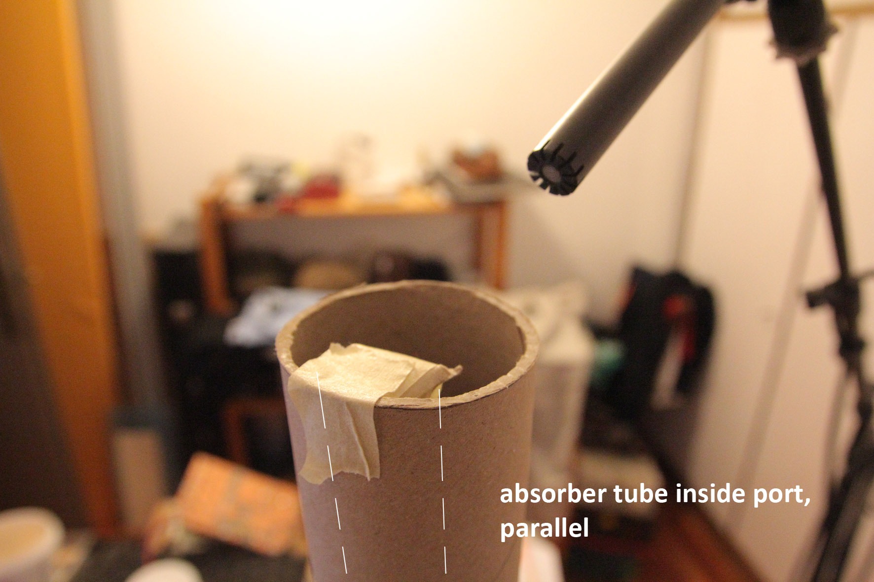

parallel absorber inside port.
open end of absorber tube is down, at half port length.

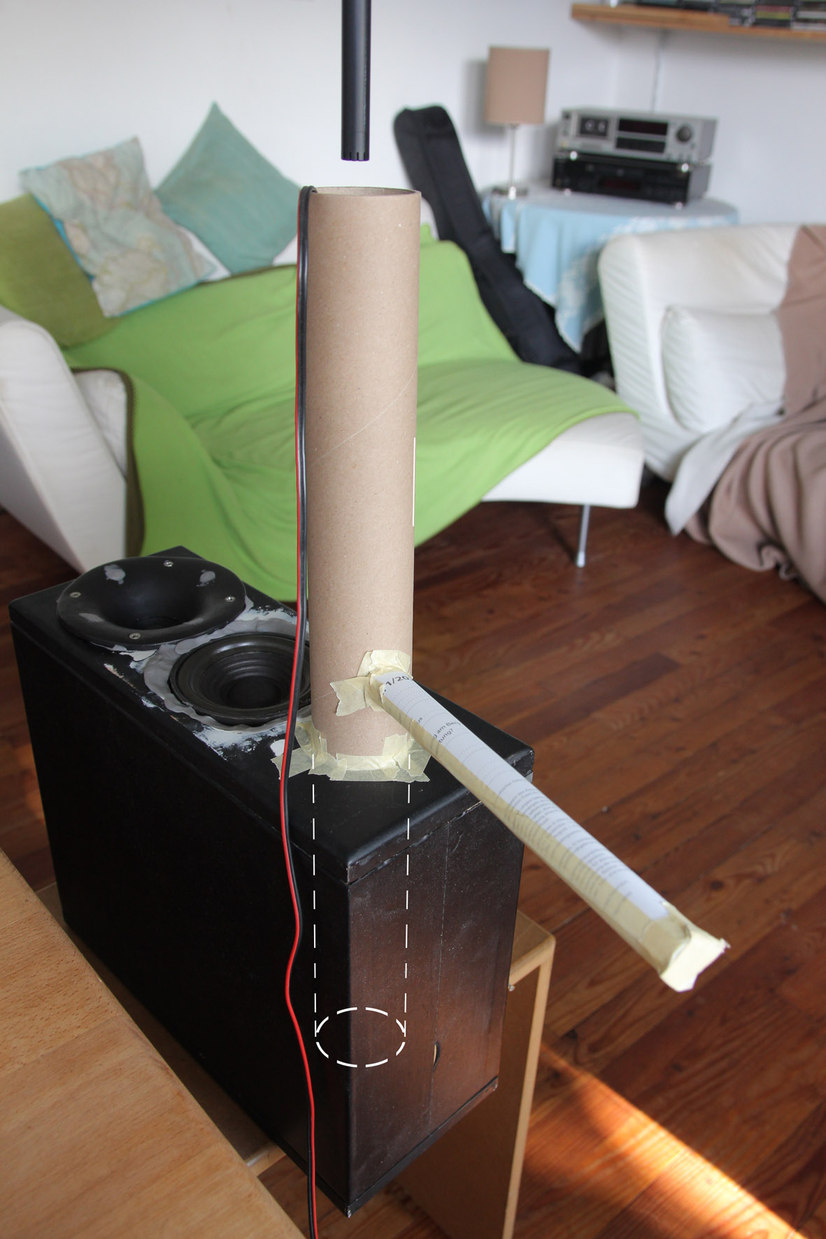

perpendicular tube absorber connected to the port via 2cm hole.

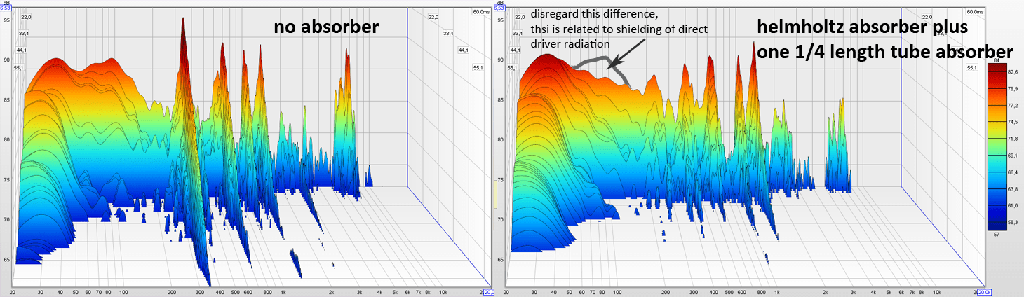

my next update will include measurements of an actual bass reflex box, to see whether the absorber reduces port output.

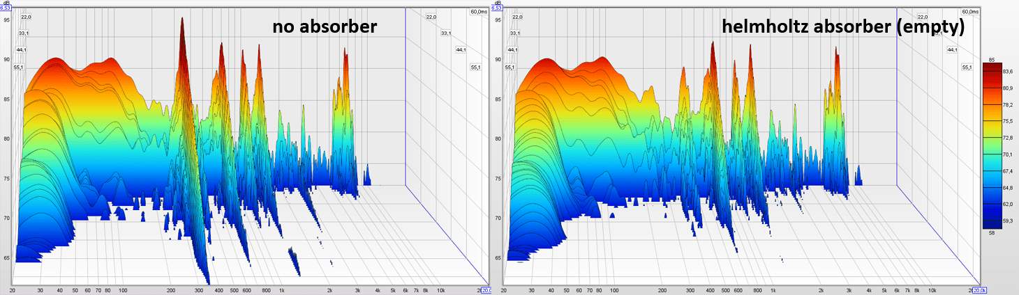

I will also include decay waterfall plots that clearly show the influence of absorbers!
thanks @tmuikku !

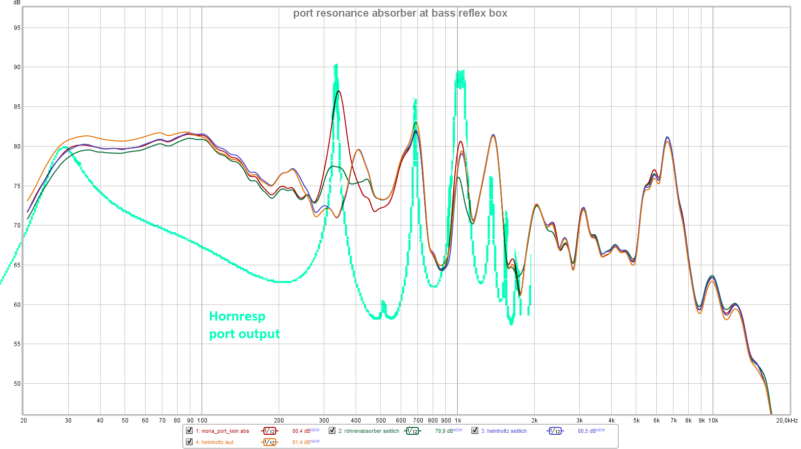

Real bassreflex situation with port mounted to a 9,5 l bass reflex box with existing 18 cm port, 5 cm diameter. For test reasons the existing port is extended on the outside to get a total length of 47 cm, both ends without flange in this case;
bass reflex Fb is thus lowered to about 35 Hz (not important for this investigation, but relevant for comparison of desired bass reflex output)
Microphone in front of outer port end.

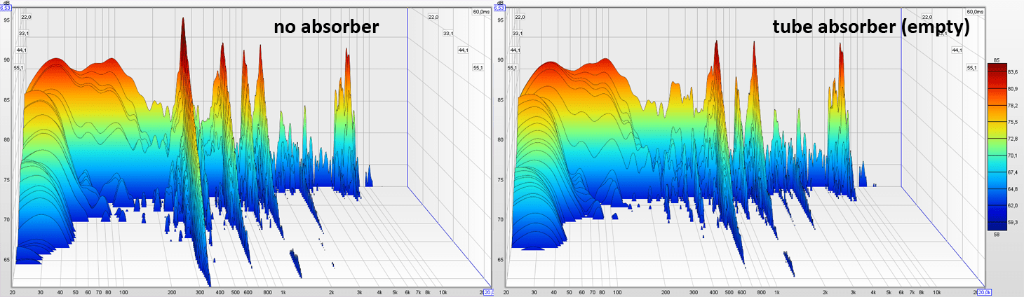

I did not use poly batting for this second test because it did not show better results in test 1.
results in waterfall decay diagrams, the left side of each image shows the result without absorber:
I think the results speak for themselves!
the fundamental resonance is absorbed, but furthermore decay time of higher resonances are also shorter than in the non-absorber-port.
furthermore the bass reflex operation seems to be completely independent (no reduction of bass output).
there may be a higher risk of chuffing for high volumes due to the hole in the port, though.
the 1/4 length absorber has 1/4 length of port and was inserted flush from the outside end.
one thing i would like to investigate further is, how to better tame the second resonance with 1/4 lenght absorbers. probably needs two absorbers on two positions (1/4 and 3/4 length).
test 2

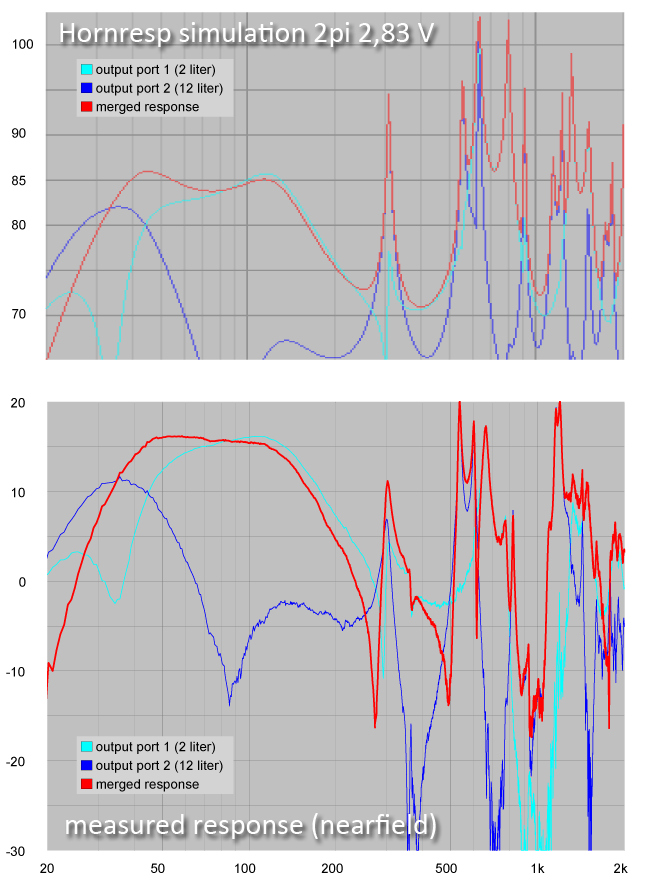

attached the results of "test 2" with overlaid hornresp-simulation of port output.
I appreciate your response, as I have been following your thread with much interest and the port tests in particular!
the FAST-project I intend the port for will have a quite long port (thus a very steep resonance peak) and will not be driven very hard.
therefore i am interested in explicitly taming the first (and eventually 2nd) resonance of the ports.

After a very long break I am back with ssome more port resonance research.
As some people already mentioned – it’s all not so simple, unfortunately.
Good news is: the logitudinal port resonance absorber works, also for shorter ports.
Bad news is: the absorbing resonator interacts with the port and creates a new (lower frequency, unfortunately) resonance. This phenomenon seems to get stronger for shorter ports.
With the very long test port i used in my post #5 the longitudinal resonance was so huge that the absorbers (resonators) did a very good job removing it.
It seemed so simple: to dampen the longitudinal resonance of the open pipe just add a tuned resonator in the center.
I did not even bother to check for eventual other effects with shorter ports.
With the realistic ports the new "combined" resonance (port in combination with absorber) comes close to the level of the longitudinal resonance I tried to eliminate. Filling the resonator with absorbing material can somewhat counteract this. Also the half length resonator apparently helps reducing audible chuffing.
I furthermore did some more investigation regarding chuffing/distorsion of different ports and enclosure resonance handling.
More details in the following posts!

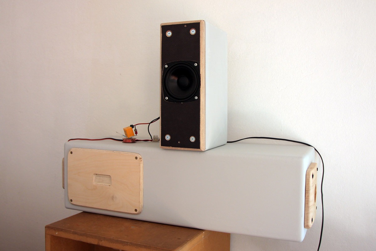

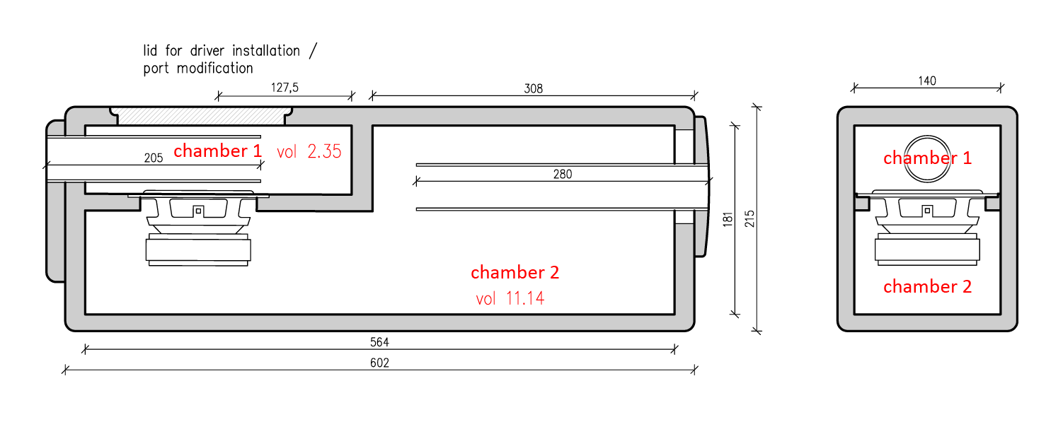

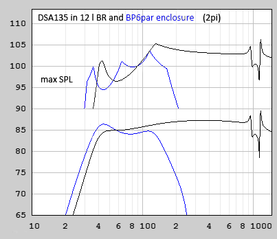

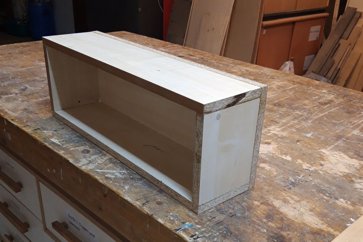

I decided to build a 6th order parallel bandpass “subwoofer” with a small 5” driver as subject for the investigations.
In addition to the port investigations I wanted to know whether a parallel BP6 has advantages compared to a simple bass reflex box.
In short, yes it does – but it’s questionable whether it’s worth it:
Small low-VAS woofers such as my dayton DSA135 usually need very long (and/or very thin) ports that are prone to resonances and chuffing due to their big ratio between length and diameter; having two parallel vents adds even more resonances and provides perfect study material.
As to be expected the simulation with hornresp proves to be very accurate and useful (thank you @David McBean !).
By changing port and chamber lengths in hornresp’s loudspeaker wizard it is easily possible to identify port and chamber resonances.
The hornresp bandpass wizard model does not consider losses of real helmholtz resonators, as far as i know. This explains the slightly reduced helmholtz peaks.
Mind you, this would be a bad example for a subwoofer design:
I did not use T-nuts for mounting the driver, instead i used birch plywood pieces and cut threads. This works great!
The small fullrange box for listening tests uses a sica 3,5H1CS8.
- bandpass reduces distorsion output, but as far as I measured this refers almost exclusively to H2 which may not be of big concern anyway.
- the two resonators of a BP6 bandpass can reduce cone excursion (to almost zero!) at two frequencies. Between them and at lower rolloff the excursion however is bigger than bass reflex.
- the lower resonator can be tuned low and extend usable bandwidth at the lower end. of course this also increases group delay and enclosure size.
- the driver is hidden inside the box. This can be an advantage for design or protection reasons
- using a tiny 5” driver to reach down to 40 Hz or even lower.
- long and narrow ports prone to resonances
- long enclosures with resonances near the usable bandwidth
- enclosure length similar to the port length (for chamber V1)
- ports on opposite ends reduce options for positioning the box and the resonances exiting the ports differ on both sides, creating an artificial and strange “stereo” image at close distances.
