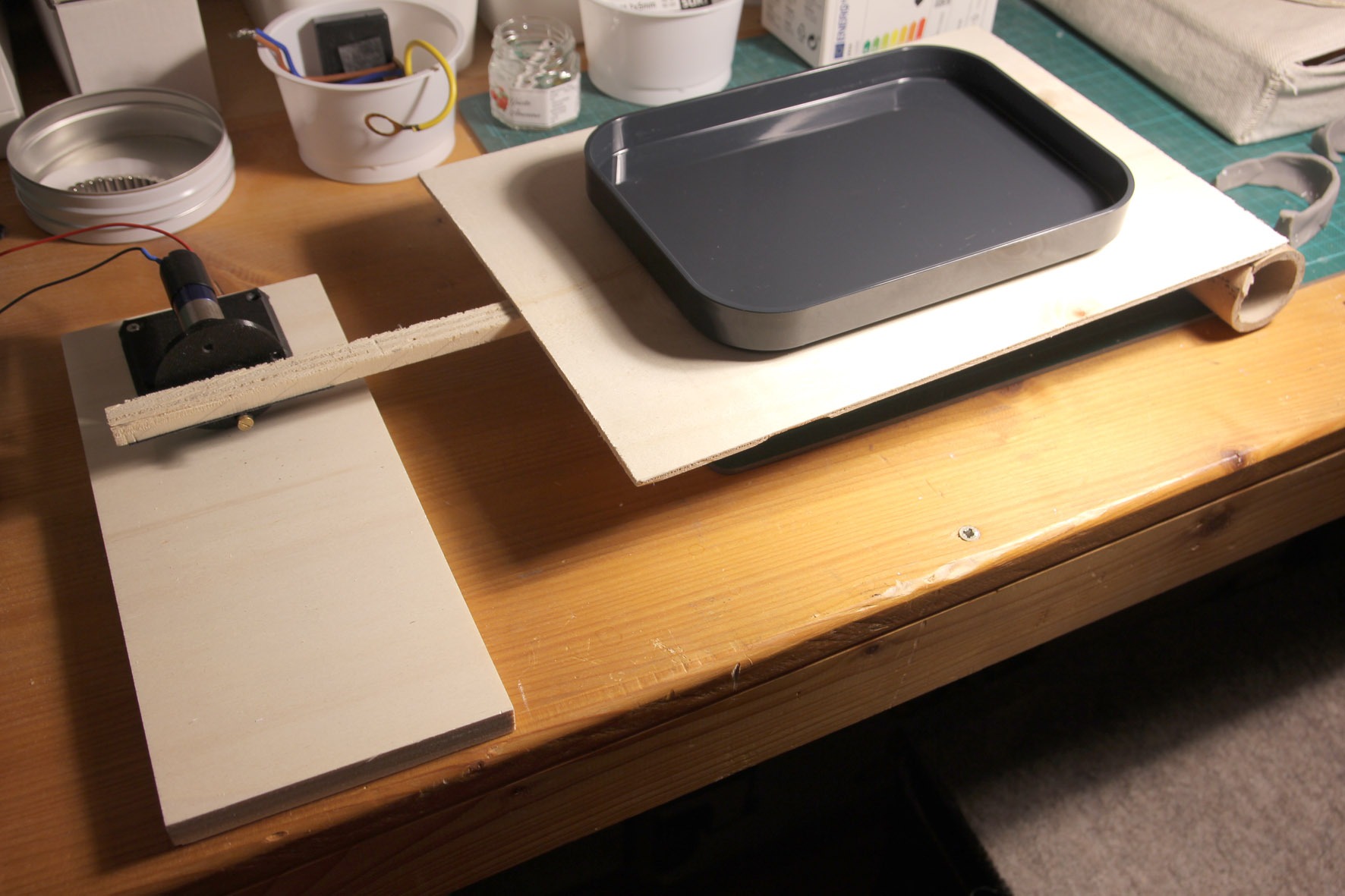

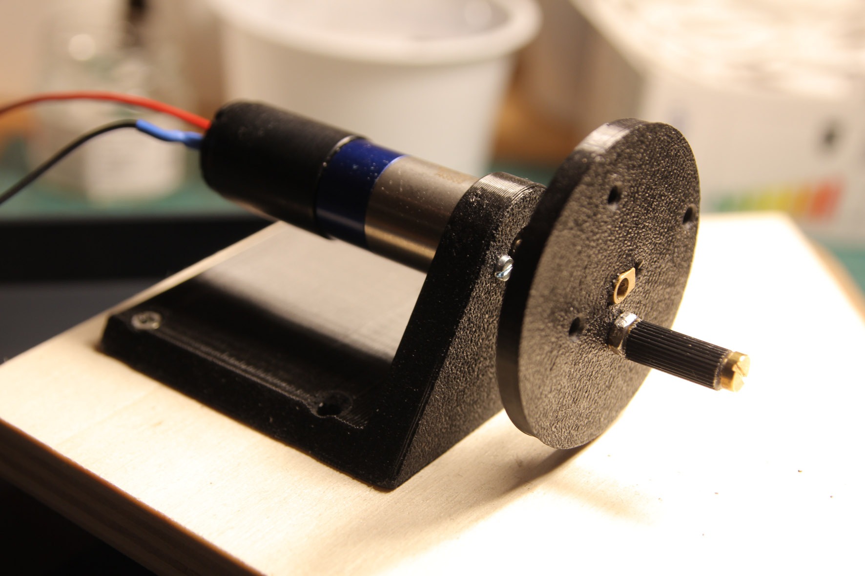

I made a water based simulation setup for studying and visualizing the air movement inside straight and flared ports.
a geared motor slowly rocks a water filled shallow bowl including a port shaped guide for the water and small plastic chips floating for visualisation.
below is a video, showing the effect of flow direction separation of a straigt (flanged) and a flared port.
for a correct operation of a helmholtz port the complete port air weight must be accelerated and decelerated.
if the flow outwards and inwards are separated the effectively ac/decelerated weight of the air in the port is reduced and the system tuning frequency will raise. consequently the low frequency output (at intended tuning) will be reduced quite drastically. this is the main reason for the port "compression" effect.
while some flow direction separation (and consequent turbulent flow) can be seen for both ports, the straight port keeps working as intended, because the separation ("port blowing") happens just outside the port.
with the flared port however this flow direction separation (+turbulence) happens inside the port.
the separated airflow weight is "lost" for the helmholtz resonator and the tuning frequency raises. this is the reason for the high compression factors of flared ports at high diplacement.
so the goal is to keep all the air in the port in a mostly coherent movement.

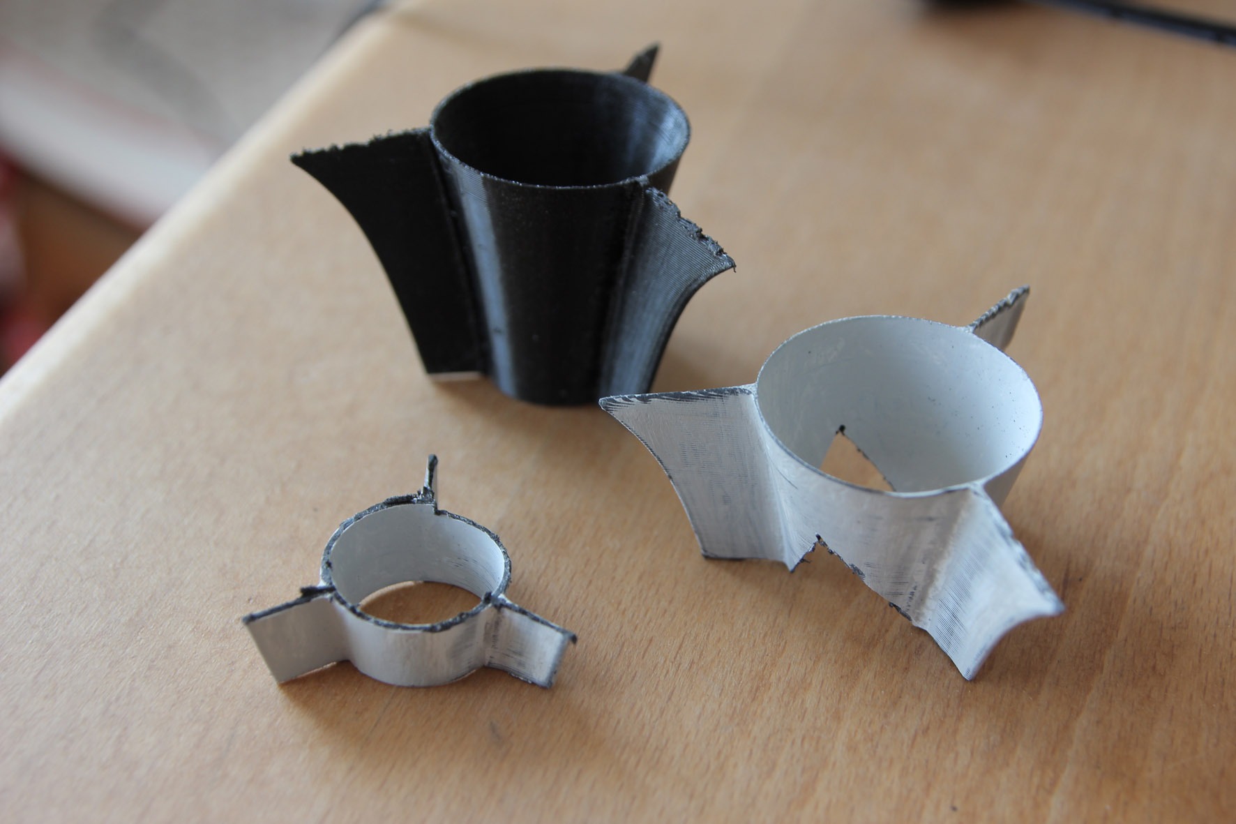

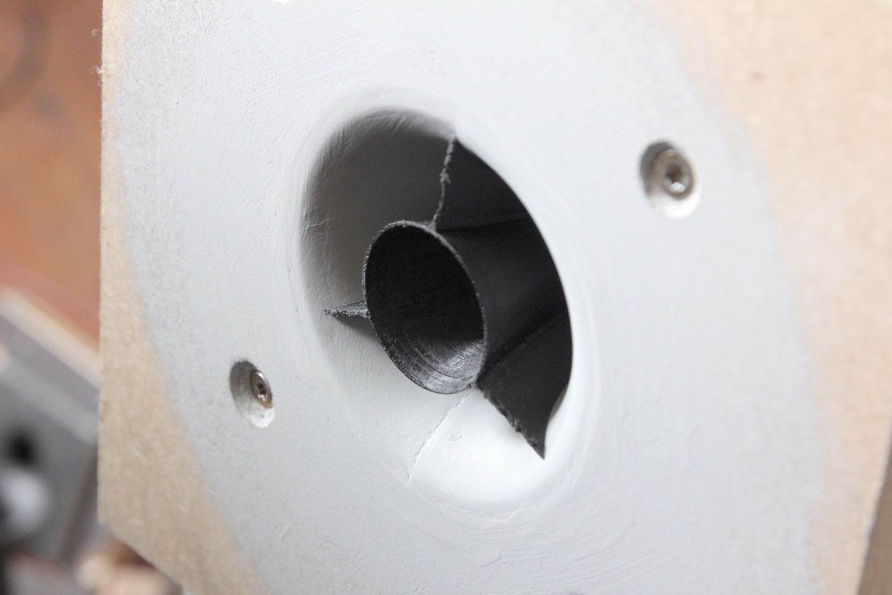

I guess for the sake of science and documentation it makes sense to also post some very bad ideas I had.
one was the following.
I wanted to make an air guide to avoid the turbulent (flow direction separating) air flow at the exit of the port.
this was my first try:
the results were bad, very bad. the small tube turned into a whistle making funny noises at low volumes.
I tried to smooth the surface, shorten the guiding ring, but no success.
It's not good to have any sharp edges in the port!
so no success by itself, but still some useful findings!
