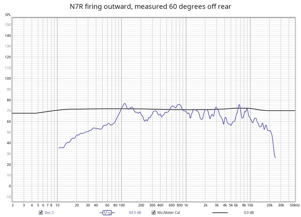

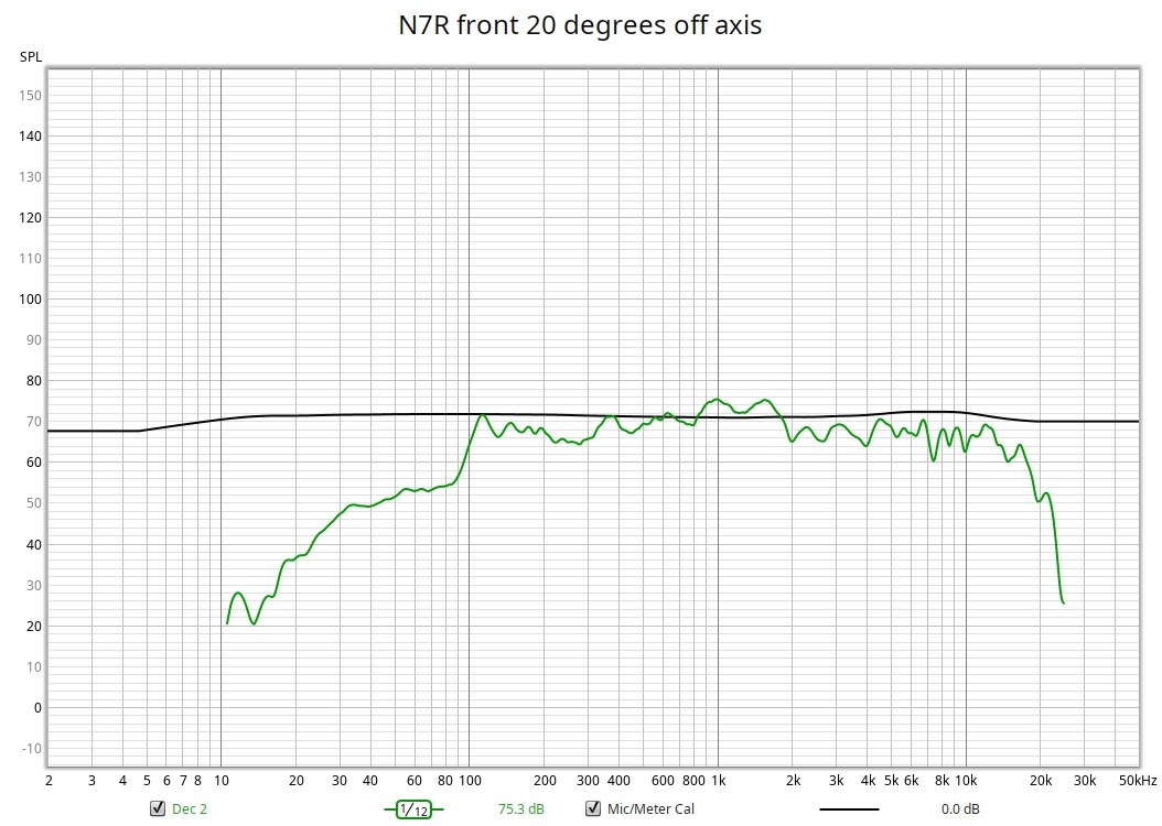

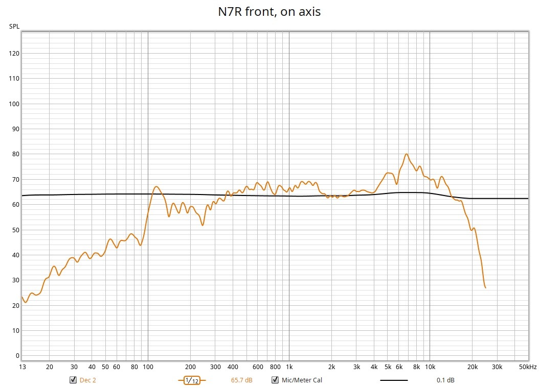

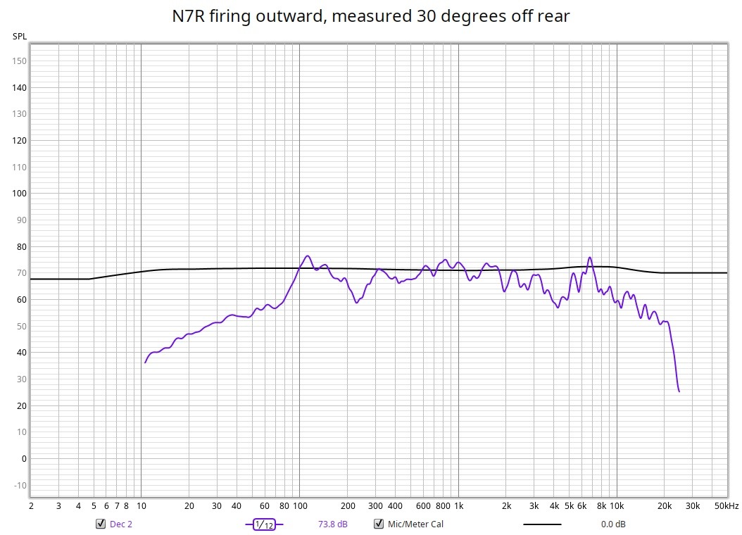

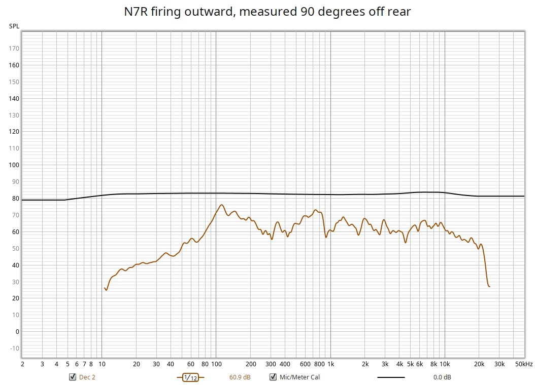

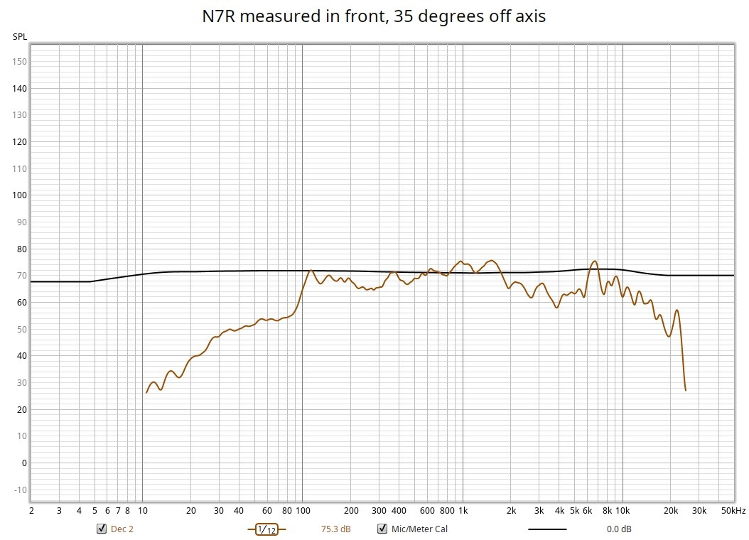

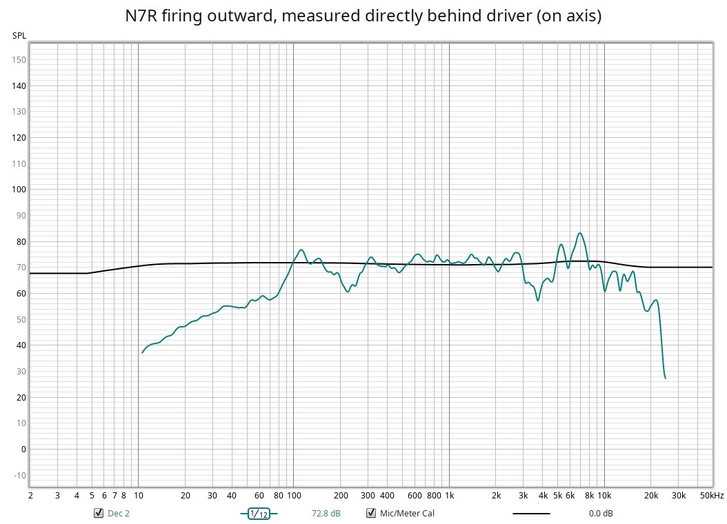

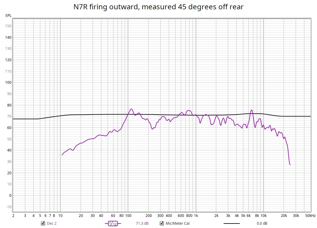

I hope the graph names are descriptive enough. The front firing are obvious, the "firing outward is the driver facing up, out of the cabinet. The front I measured on axis, 20 and 35 degrees off axis. The remaining are on axis - directly behind the driver, 30, 45, 60 and 90 degrees off axis. Feel free to toss me questions, I'll do my best to get back quickly. All measurements are in an approximately 0.5 cu foot semi-dipole – damped open back cabinet.
dcgold, thank you, for producing the many above plots which, essentially, appear to indicate significant high-frequency response does exist horizontally (at 90 degrees off-axis) around the back-side of an inverted-mounted driver. Interesting.

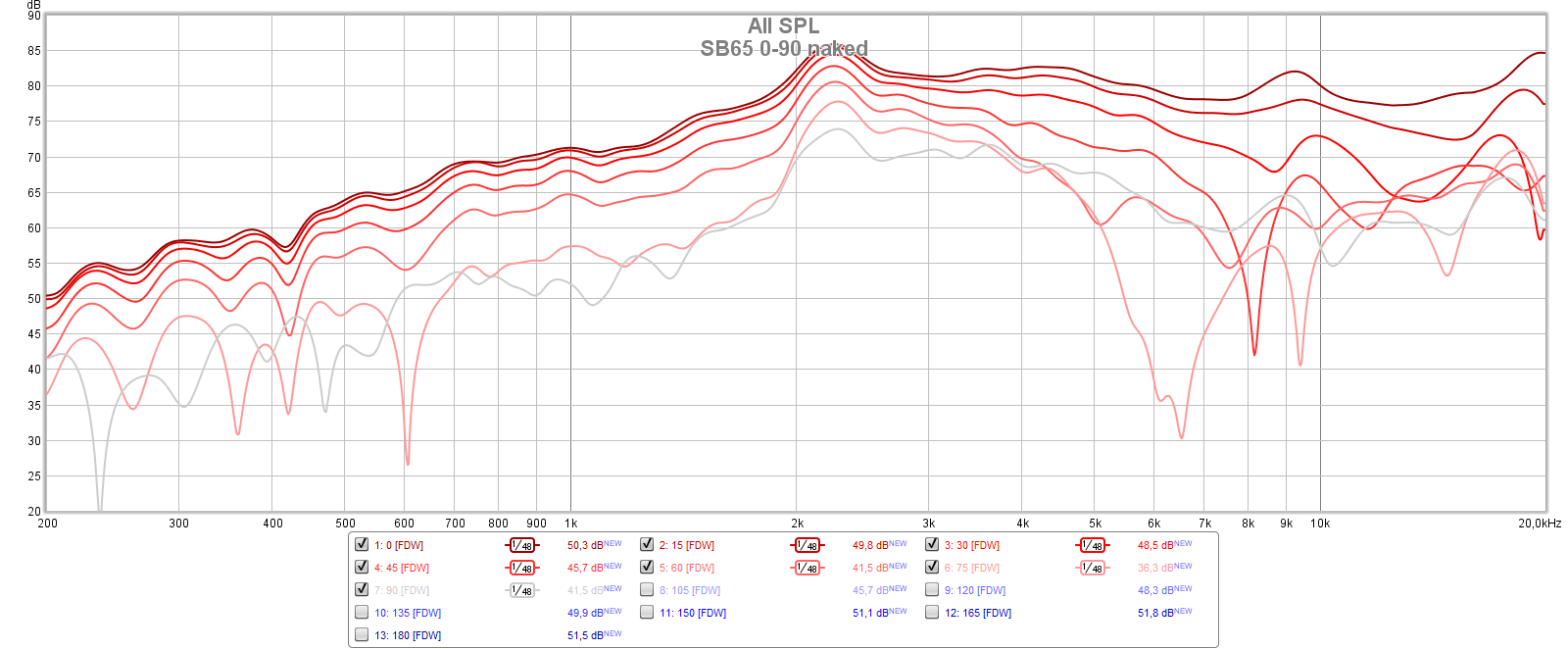

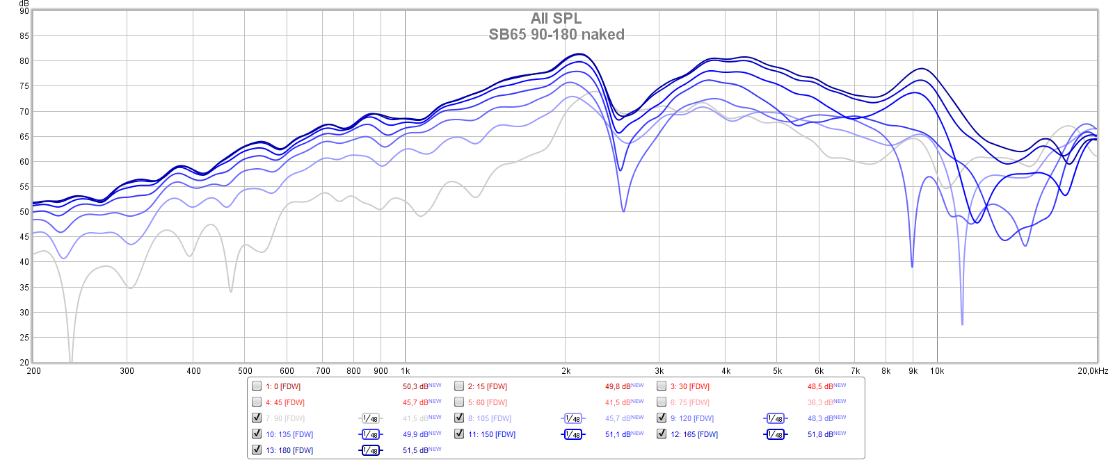

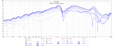

First SB12PAC
Then SB65WBAC25

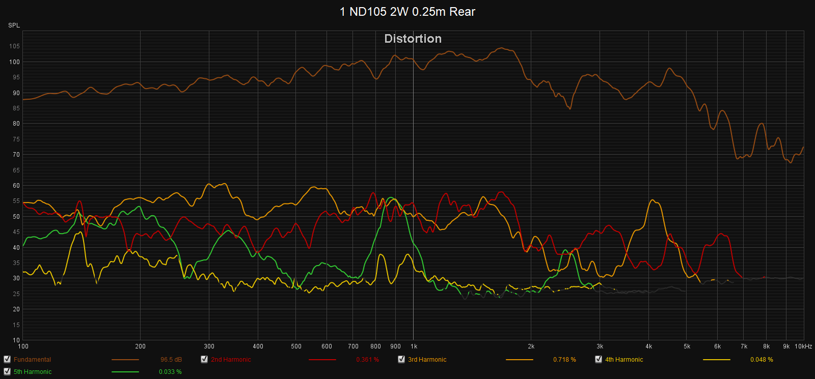

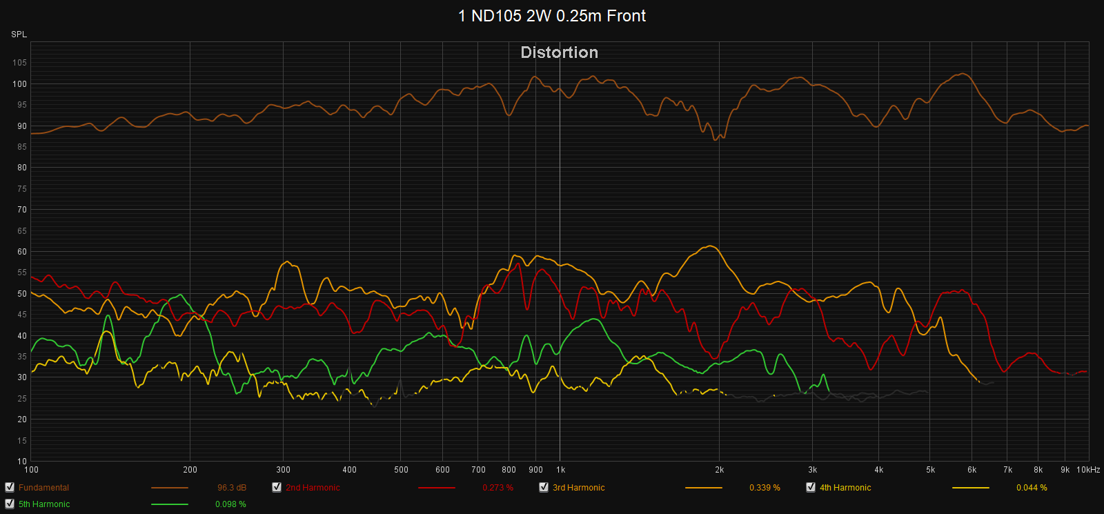

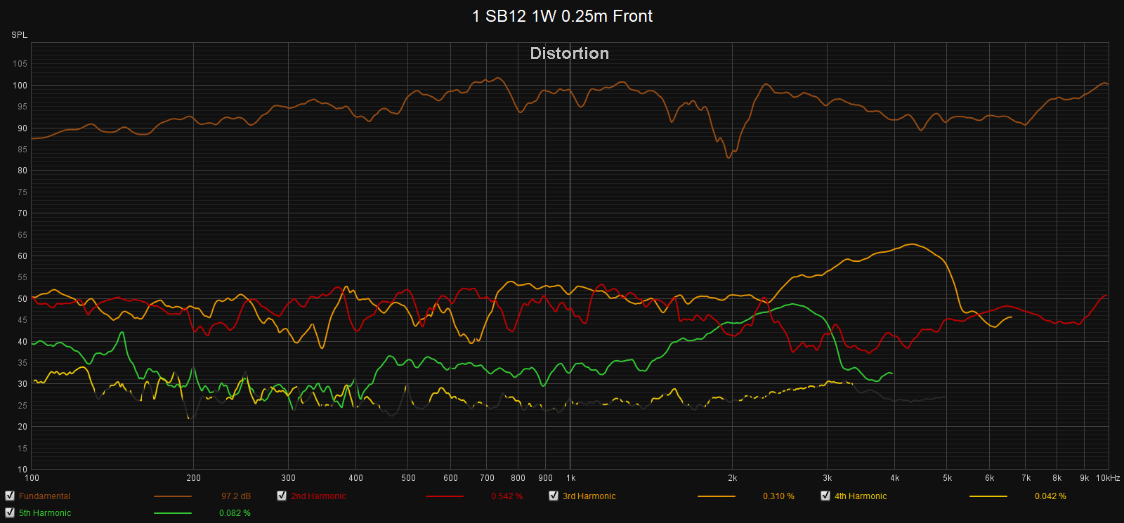

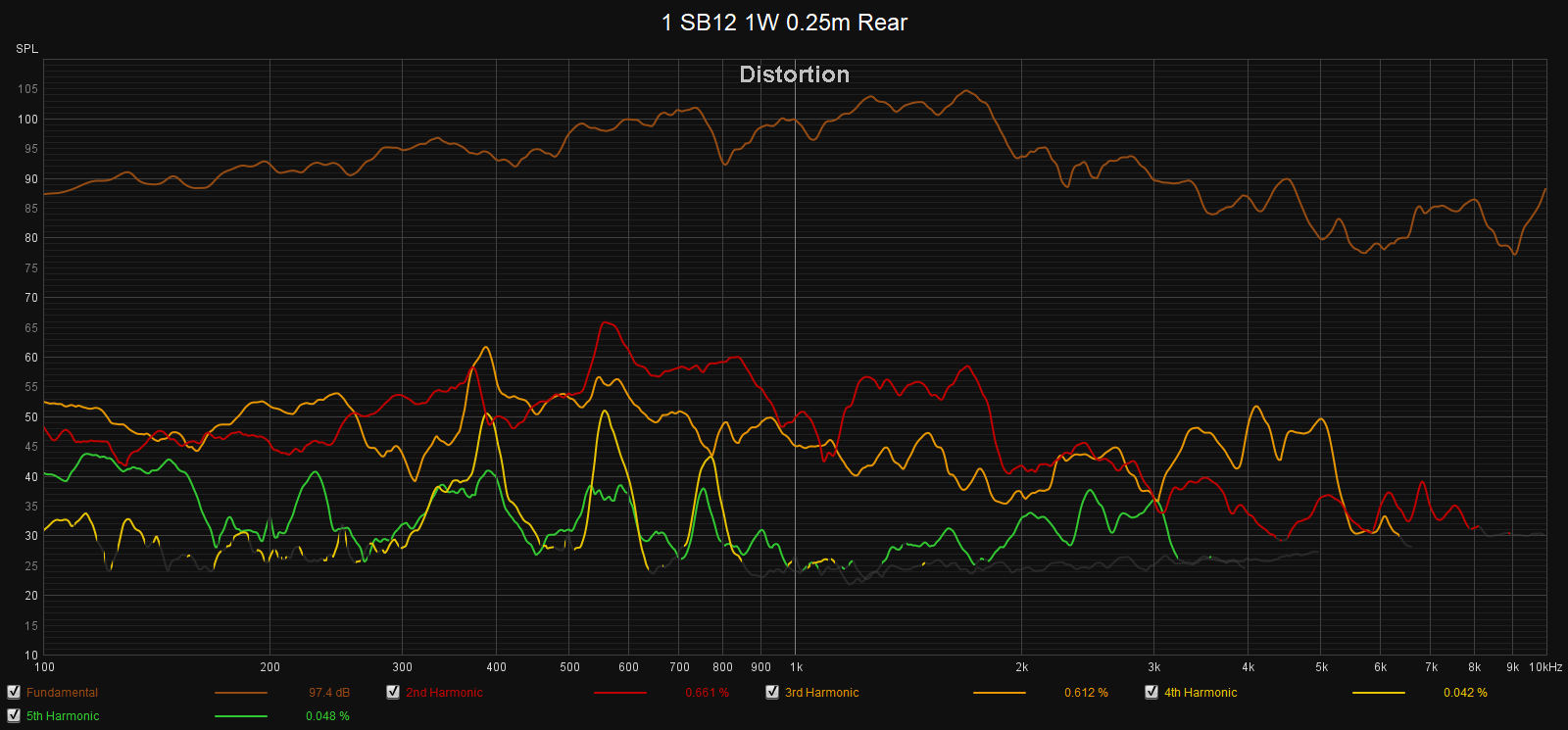

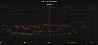

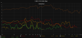

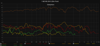

I would caution against using the rear of the driver as the main radiator. When I've measured it the rear response is not as clean as the front response, there is significantly higher distortion.

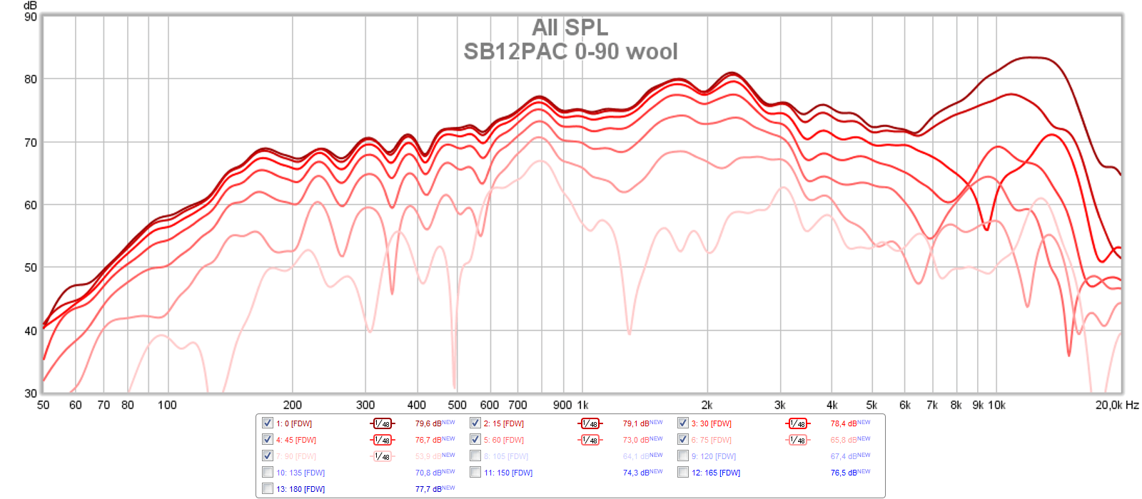

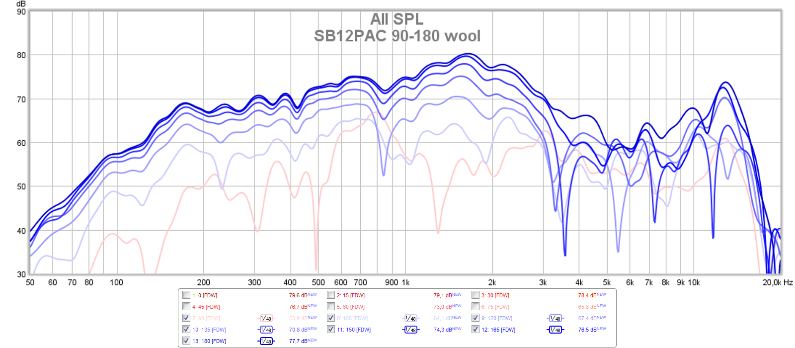

Here is front vs back of the SB12PAC.
Then ND105.
Then SB65WBAC25
Then ND105.

That’s true, as your plots, and CharlieLaub’s plot in comment #2, indicate.I would caution against using the rear of the driver as the main radiator. When I've measured it the rear response is not as clean as the front response, there is significantly higher distortion.
The reason we were exploring the response at the rear of drivers was in an attempt verify, or falsify, the presumption of Ohm Acoustics, and of many onmi diy builders that a normal woofer mounted-vertically and inverted, will, indeed, radiate horizontally 360 degrees across the full bandwidth of the driver. In other words, as a Walsh driver does.
Sorry to sy, but IMO OhmWalsh description of how they work is makebelieve bulls#t . Seems like they have no idea or measurements of how soundwaves of different wavelength radiate. The rearside of a cone driver has spider and motor too making major interferences, adding distortion by that way.

In that Ohm patent, they specify crossing over the inverted woofer to a super-tweeter @ 8KHz. While the plots made by the contributors in our thread do appear to indicate significant radial output at that frequency, as you correctly allude, that output is very jagged in response. Indicating reflections, cavity resonances and diffraction effects from the basket, spider and motor.

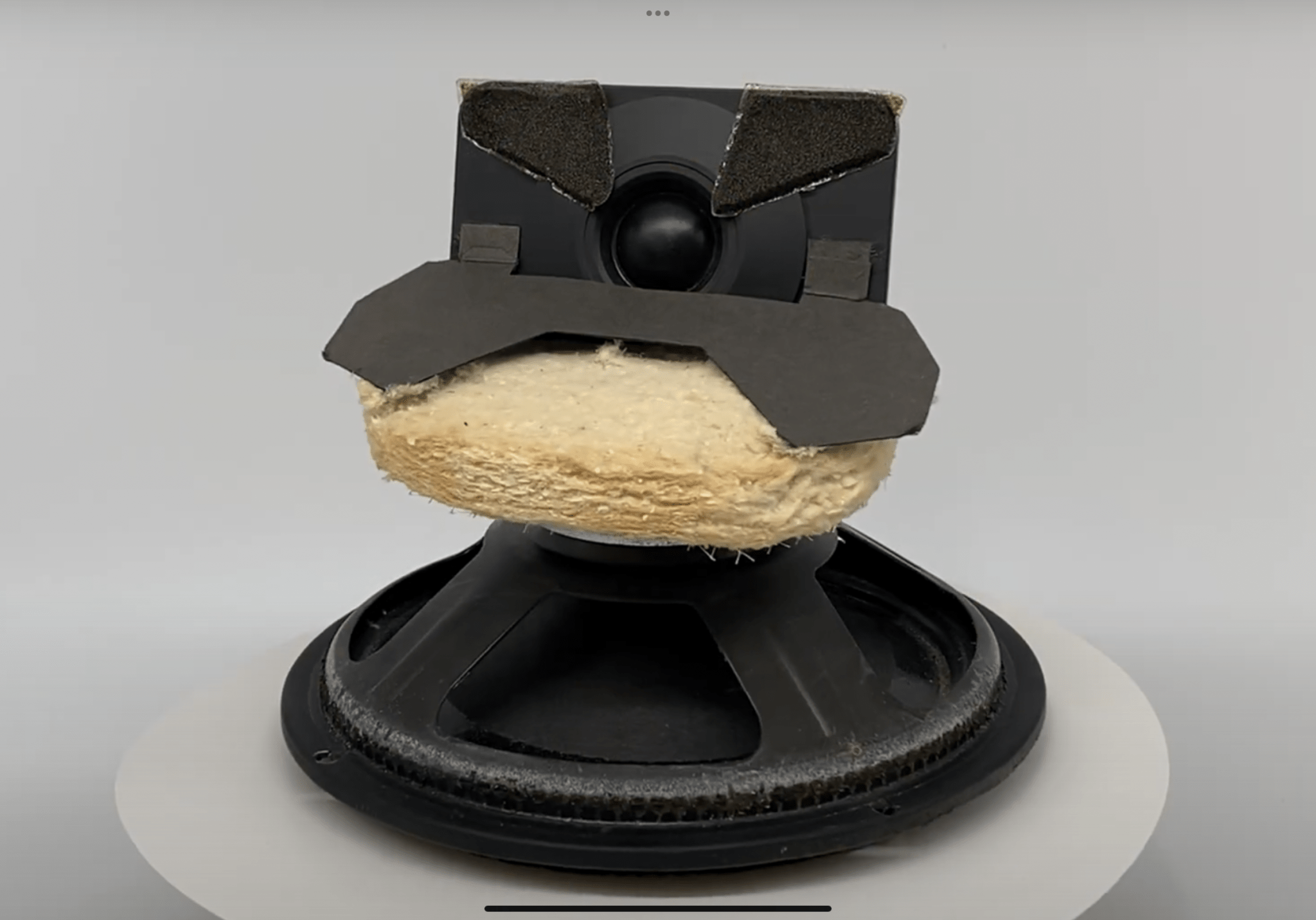

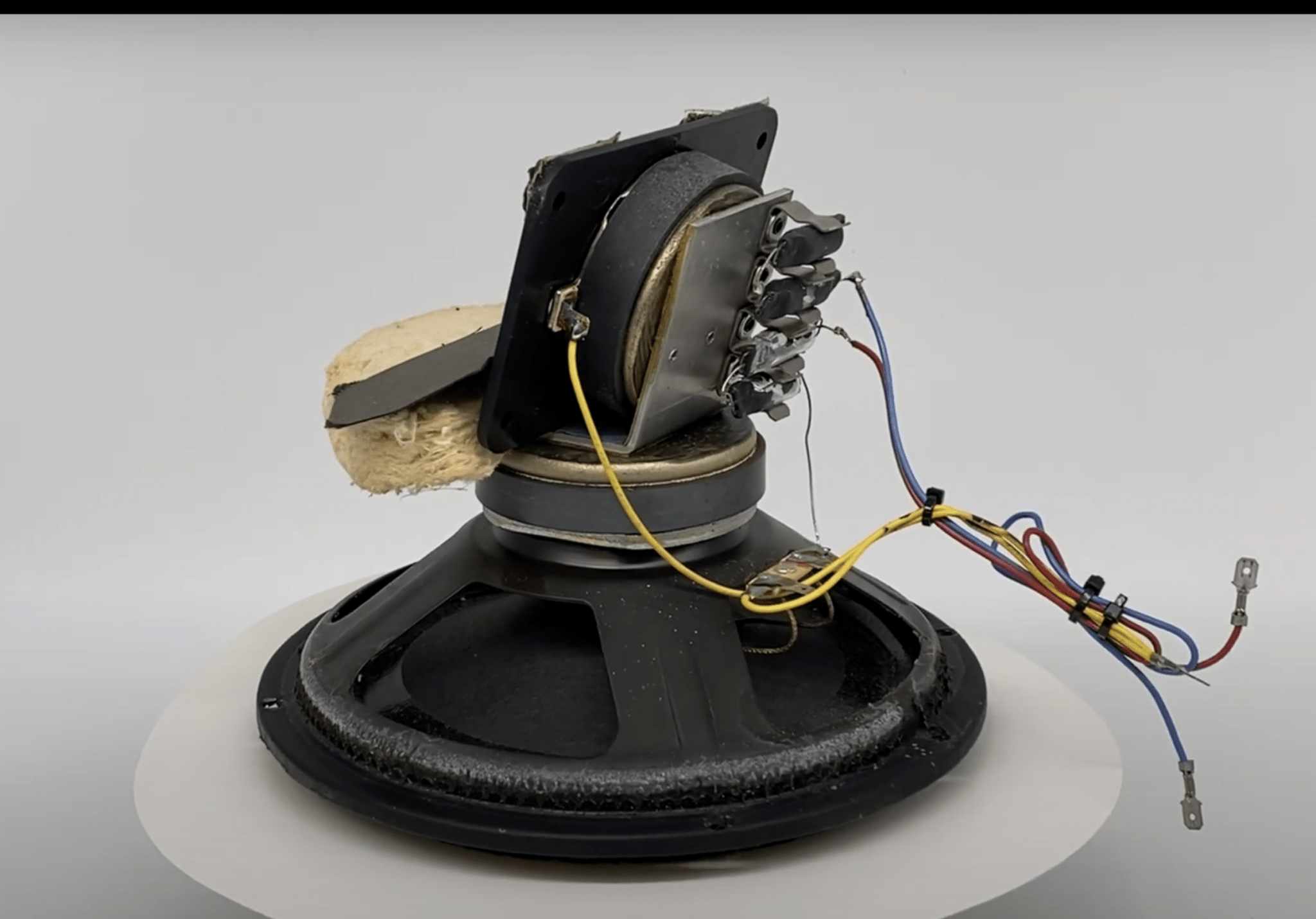

If anyone has been curious, here are front and rear photos of the inverted woofer mounting - with a dome tweeter perched on top of the magnet - used in Ohm’s affordable non-Walsh driver speakers. It definitely appears to be a typical, inexpensive cone woofer, and not a costly Walsh driver.
