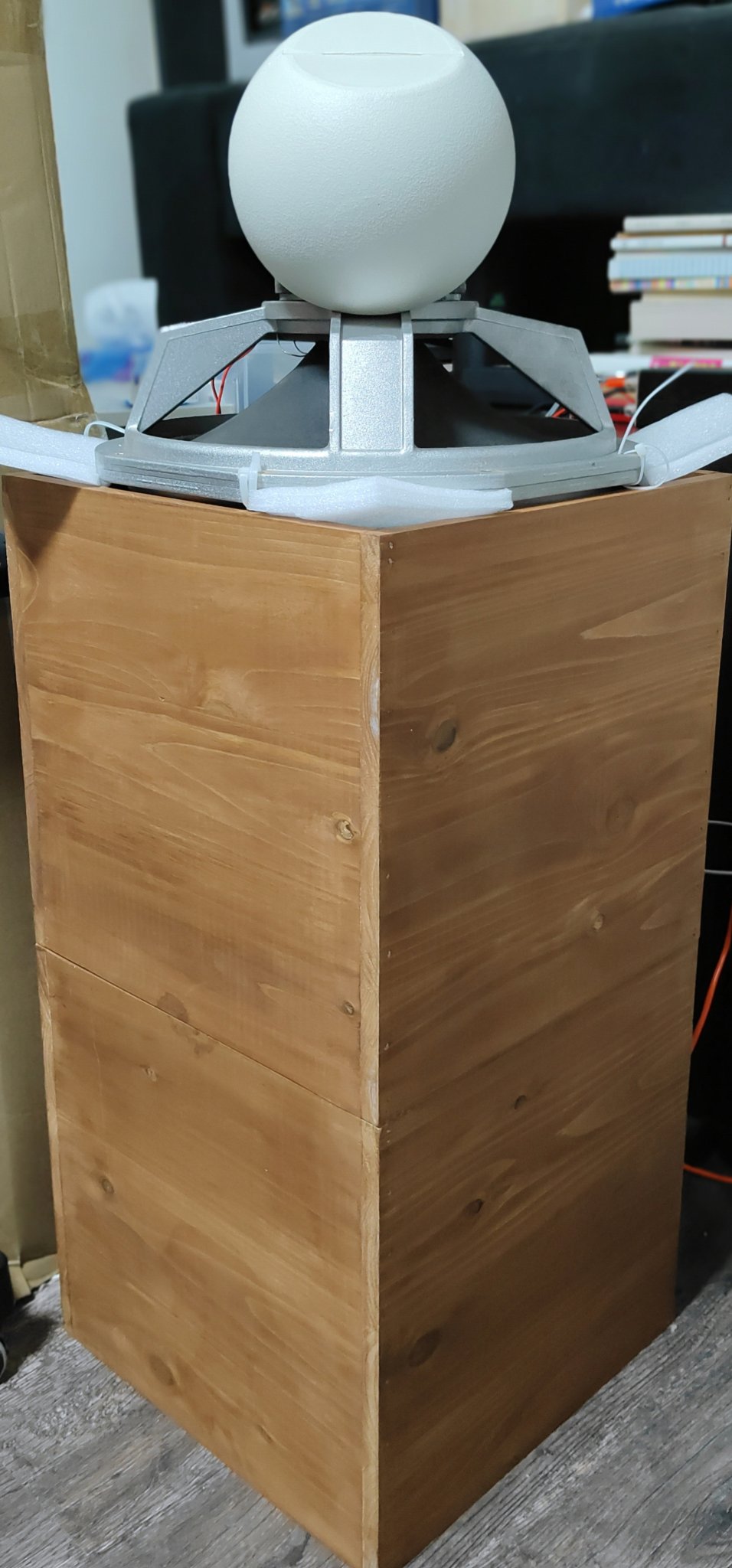

A driver with a small magnet and cast basket with narrow spokes would be better suited but also be a strange, rare beast. Even if one could be found, dispersion would be limited to midrange along the horizontal axis dictating the need for a tweeter. Old school is to use a reflector with a normally configured driver. My own experiments along these lines lead me to conclude that vertical dispersion is just as desirable in an omni, at least for a stage height that matches the width and depth.
ripblade,
I’m curious about the details of that Nerf football reflector you’re cleverly using. I can see how the ovoid shape could be advantageous for dispersing the sound horizontally, and vertically throughout the listening room. Since Nerf footballs are, however, made of a foam-rubber like material doesn’t that greatly reduce its effectiveness as a sound reflector? it looks in the photos that you may have coated the surface of one side with some substance, possibly to harden that surface?
No coating, the two sides are different colours but the same texture. The foam is closed cell and the surface ia actually quite smooth, I suppose for cleaning purposes as these are children's toys and need to be washable. The foam was a bit of a concern initially, but now I think the soft, low density is an advantage as it prevents the possibility of the reflector developing sympathetic resonances (ringing) that could colour the sound as the walls of a horn might do. Overall, I think it's pretty benign in that aspect. I just wish it looked better lol.
Is it safe to assume that you don’t find the football’s foam material to substantially absorb, or otherwise roll-off the treble of the reflected energy to an unsatisfactory degree? I have been presuming that a hard surfaced reflector would be required.
It's not like acoustic foam, porous and all that, but I suppose a polished metal reflector would be more efficient.

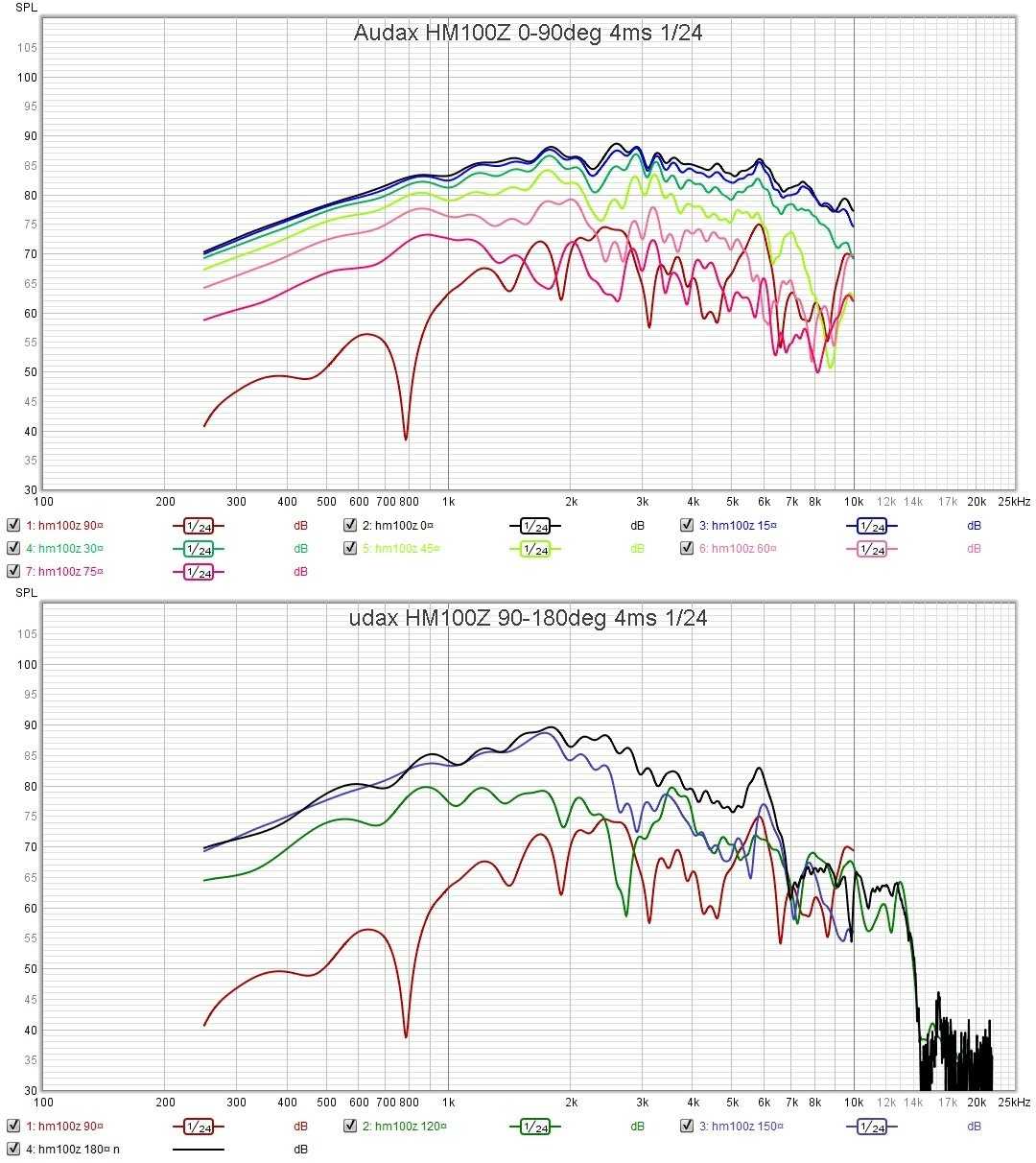

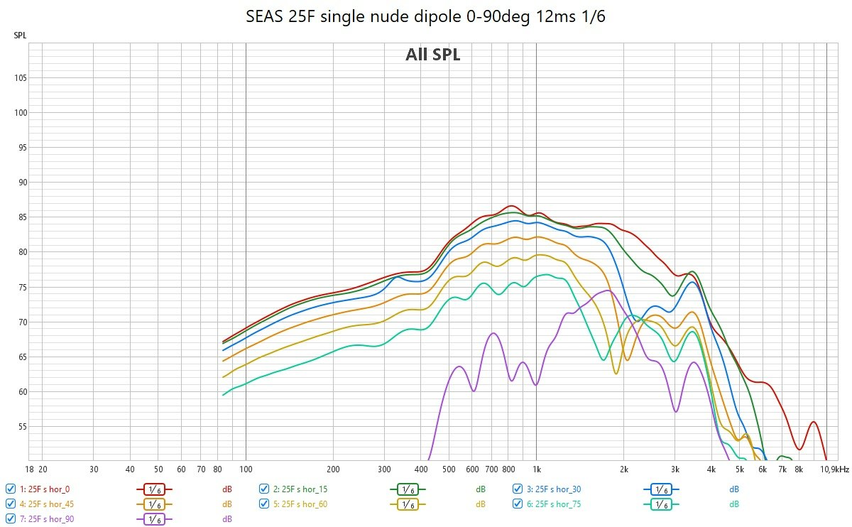

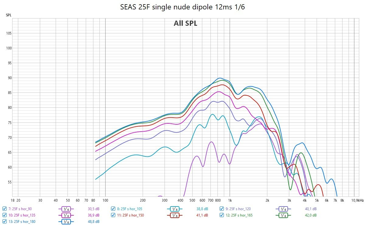

I have measured many drivers' rearside, but only few are saved. I have been interested in dipoles, so these are "nude" with no or minimal frame. Dipole has very smooth of-axis radiation below axial "dip". The baffle size of a monopole driver modifies radiation from lower freq than the dipole. Monopole has flat response below baffle step effect.
4" Audax poly cone has more interferences from the "motor" than the 8". Rearside response is staggered above 2kHz

8" SEAS paper cone rearside shows smooth response only up to 1kHz

Perhaps ideally only to 400Hz, above that directivity and irregularities increase rapidly. Max 1000Hz I'd say. The smaller the box/pole is, the better.
Actually it doesn't matter much if magnet is up or down in this band.
With horizontally positioned driver, we are listening at 80-110deg off-axis!

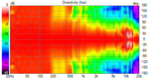

Here horizontal directivity of a small sealed box 6" coaxial (motor in the box) measured outdoors. LR4 around 2kHz. 90deg smooth to 600Hz
