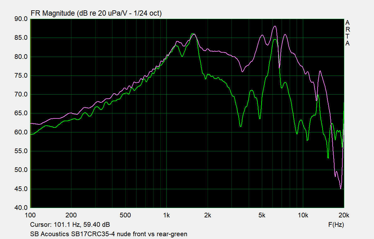

My particular DIY interest lies with dipole loudspeakers. To that end I have sought out drivers that have symmetrical radiation to the front and rear when the driver is suspended "nude" e.g. by wires in free space. When I was searching for candidates for a midrange type driver used in this way I measured many drivers from 5" to 8" or 10" from the front, and then the rear, for a variety of angles in a horizontal plane centered on the driver. The rear measurement data is similar to what you are asking about for a driver mounted facing down on to a closed box. What I found was that above 1k-2k Hz the basket and magnet started to make the rear radiation pattern much different than the front. This happened more with small drivers where the magnet is almost as wide as the cone and the basket was small and not open. The rear-side pattern breakdown means that most cone type drivers are not going to be very useful above a few kHz, and whatever response you do get will be a mess. If you think about it, to the front the pattern is narrowing, meaning that off-axis responses are falling off due to interference between sound emanating from different points on the surface of the cone. Only the central on-axis position remains (mostly) unaffected by the interference. But to the rear, the magnet and basket are in the way of the on-axis position, and that would be pointing up to the ceiling anyway. It is the angles greater than 60 degrees that will be "towards" the listening space.
If you recall, the Ohm Walsh driver had a very long/deep cone profile and this kept the sides open and the magnet assembly far away from most of the cone. That will provide much better HF output in the "sidways" direction compared to your normal cone driver, which is not very deep and the side of the cone not very exposed.
For example, here is a plot of the front and rear ON-AXIS responses for the SB Acoustics SB17CRC35-4 driver. The rear response is in green. The magnet structure decreases the rear output by being directly in the way. This is really not all that bad in terms of pattern differences, just the SPL is very different. Off axis things tend not to get better because the driver is not really designed to radiate in that way.

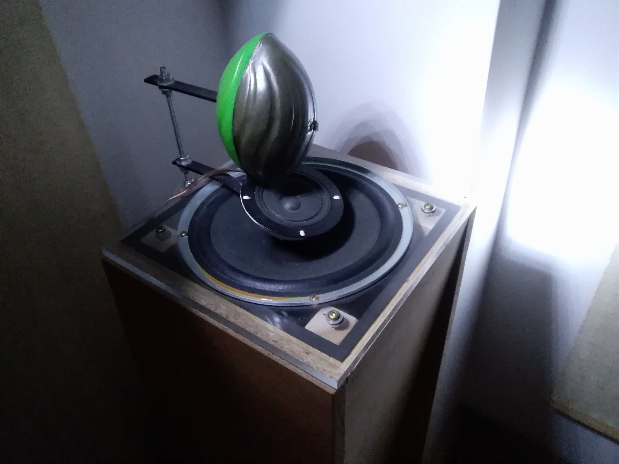

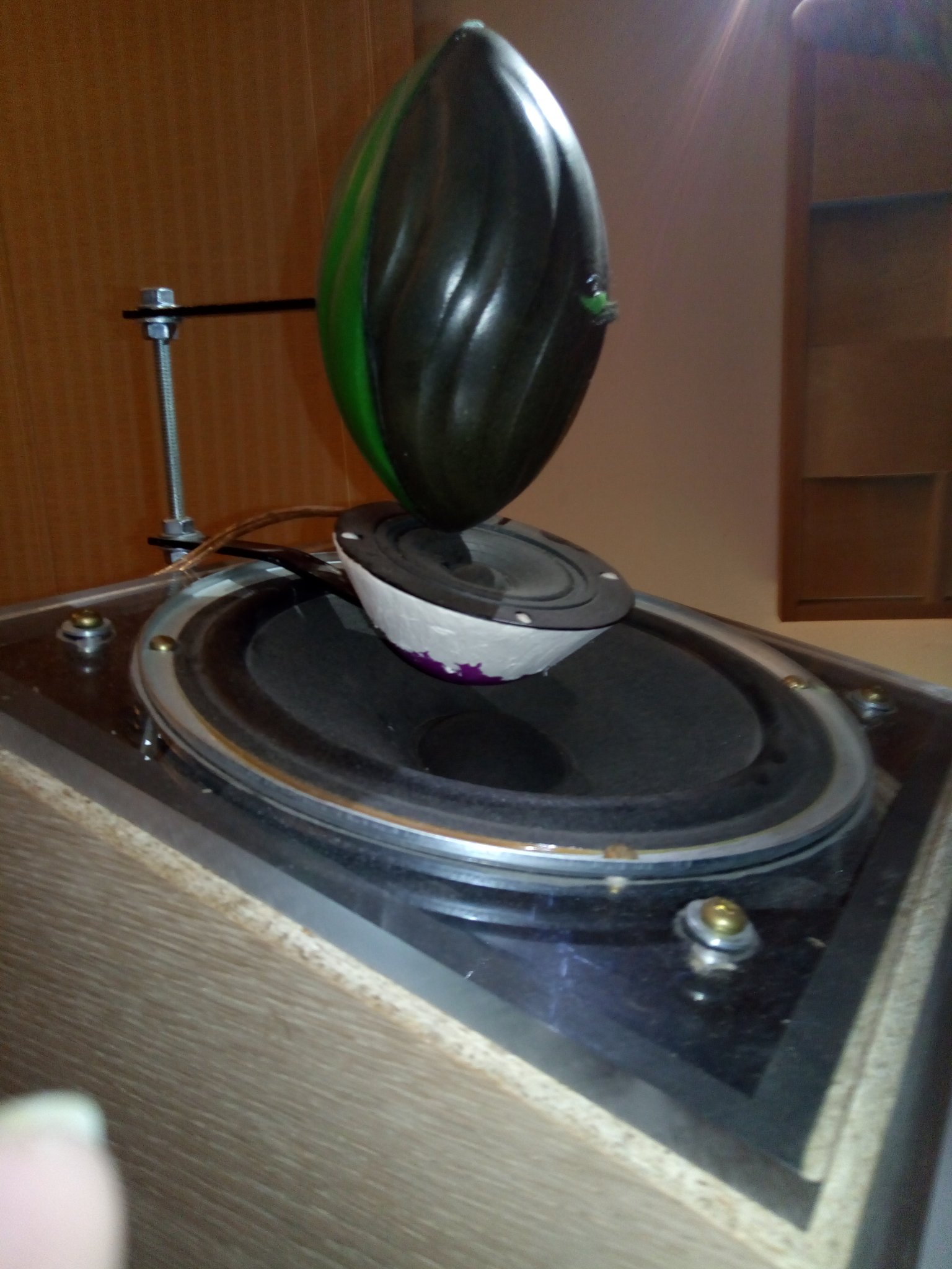

A driver with a small magnet and cast basket with narrow spokes would be better suited but also be a strange, rare beast. Even if one could be found, dispersion would be limited to midrange along the horizontal axis dictating the need for a tweeter. Old school is to use a reflector with a normally configured driver. My own experiments along these lines lead me to conclude that vertical dispersion is just as desirable in an omni, at least for a stage height that matches the width and depth.
Creative use of a Nerf football as a reflector for the midrange driver. How effective do you find it? What’s that you are using for the midrange enclosure/woofer reflector? Also, please share with the thread your assessment of the subjective result.
I tried a few different reflectors for the tweeter, from a 2" hockey practice ball to 6" styrofoam hemispheres. The woofer midrange reflector is scavenged from a children's snowball maker, with hard setting modelling clay to smooth the curvature to the tweeter flange. The acrylic baffle along with the drivers and diffusers form a modular unit that can be installed on different enclosures for experimentation. The woofer is connected full range to a Pass ACA with a single cap for the tweeter. The arrangement sounds better than it looks at this point, needing only cosmetic enhancements IMO.

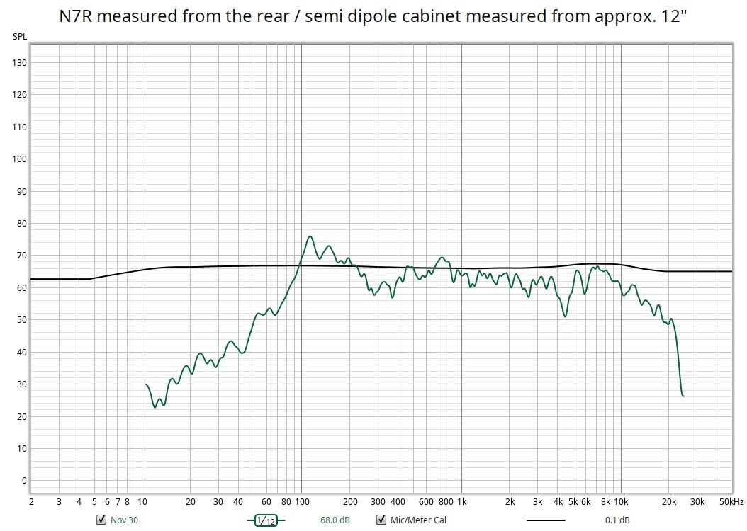

Yes, please do. To be clear, the desired measurement is not simply off the rear of the driver cone, but at 90 degrees to the cone’s driven axis. Thanks.I can try & get a measurement off the back side of our N7 & post it. Most of our measurements are near field & open baffel, so this will be different.

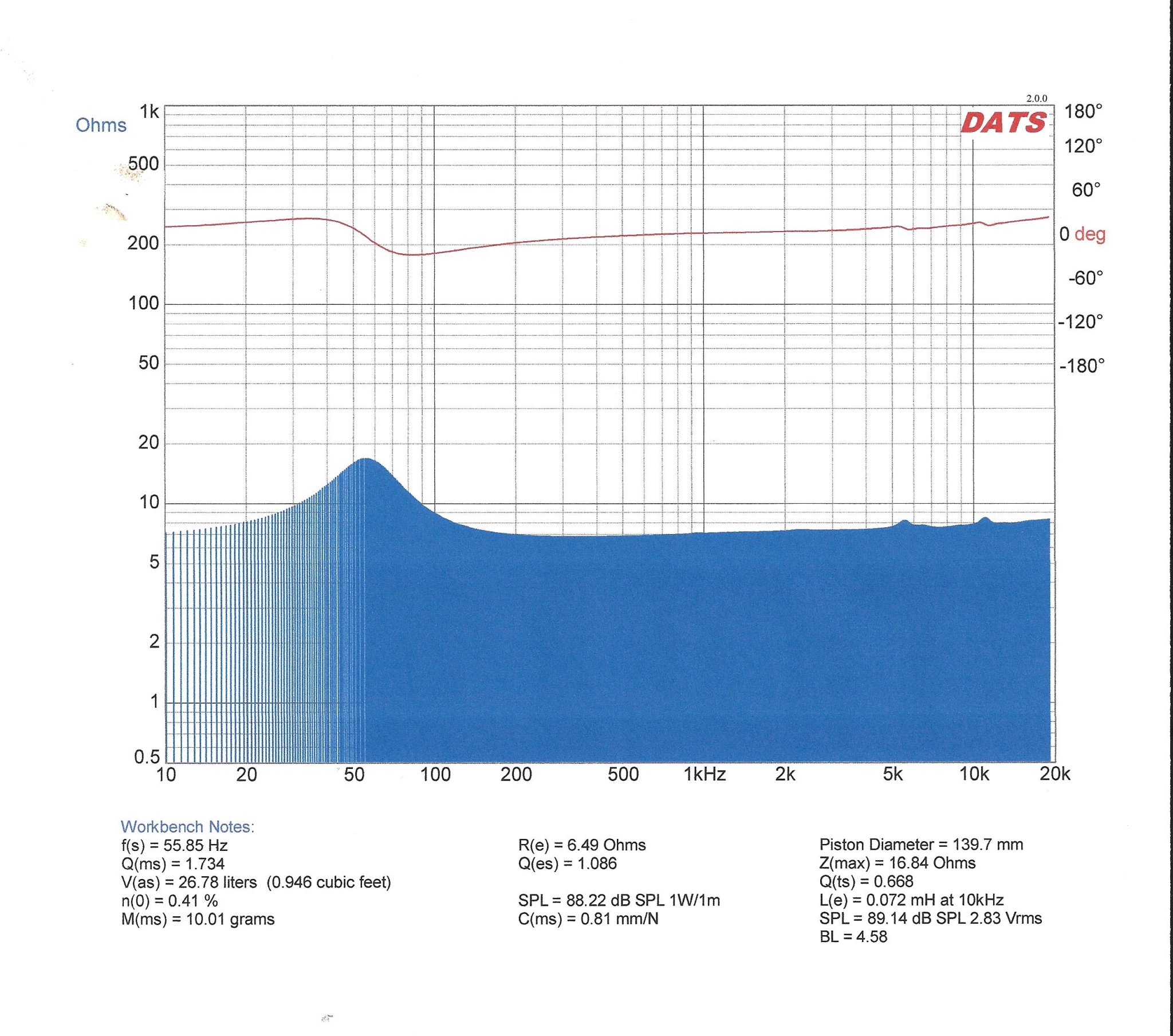

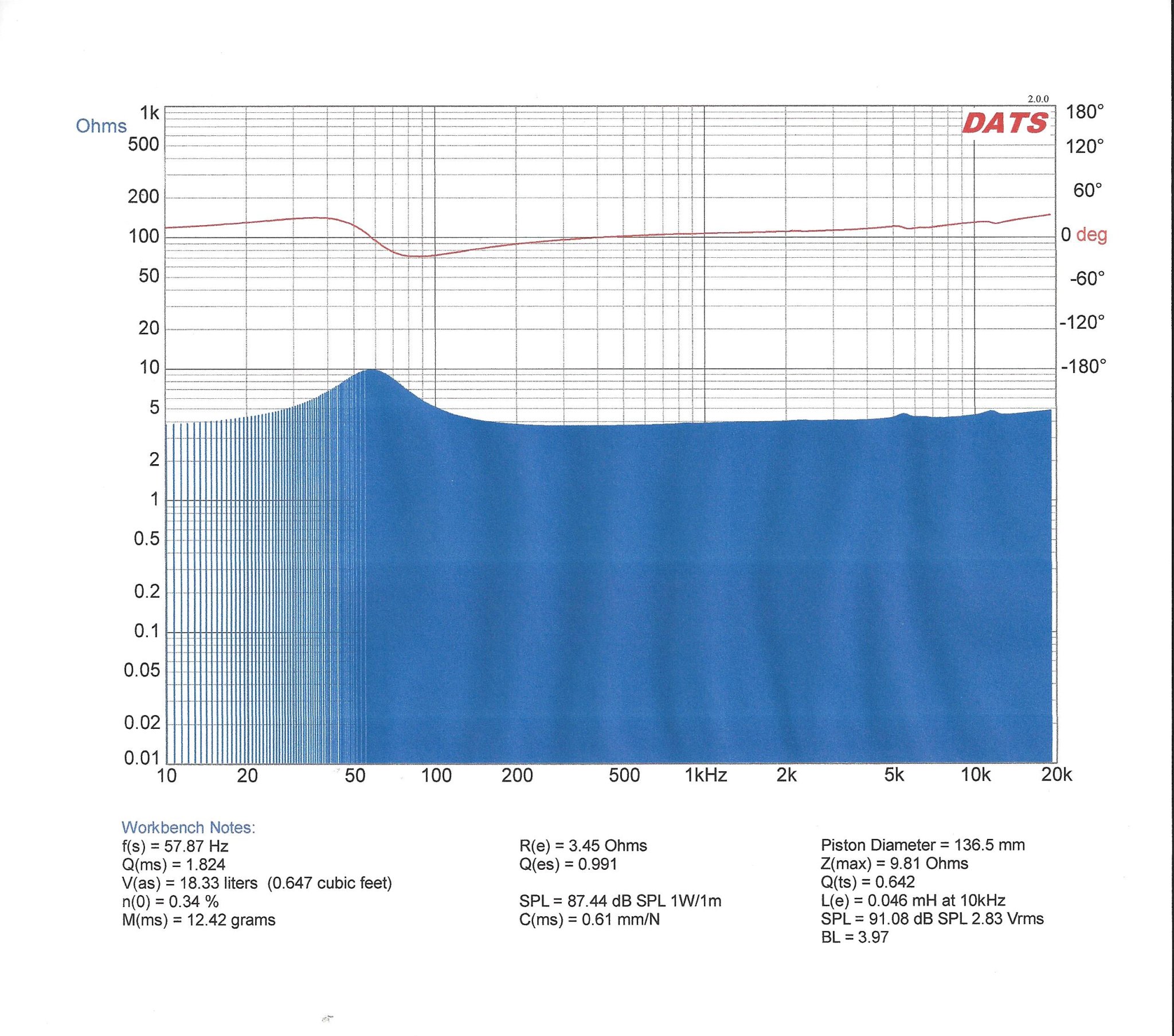

Interesting drivers. On a quick review of your website, I did notice that both the Reference 7 and 9.5 appear to feature identical T/S parameters. Some kind of unintended duplication I presume.
Yep - I will measure based on how the driver would be listened to....90 degrees with driver facing down. I have attached the T/S for the N7 & N9.5. The website needs updating. A never ending battle.🙄. I have a driver I can use, but my cabinets are on loan to a friend, so will see what I can do soon.
