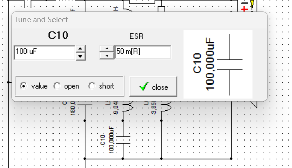

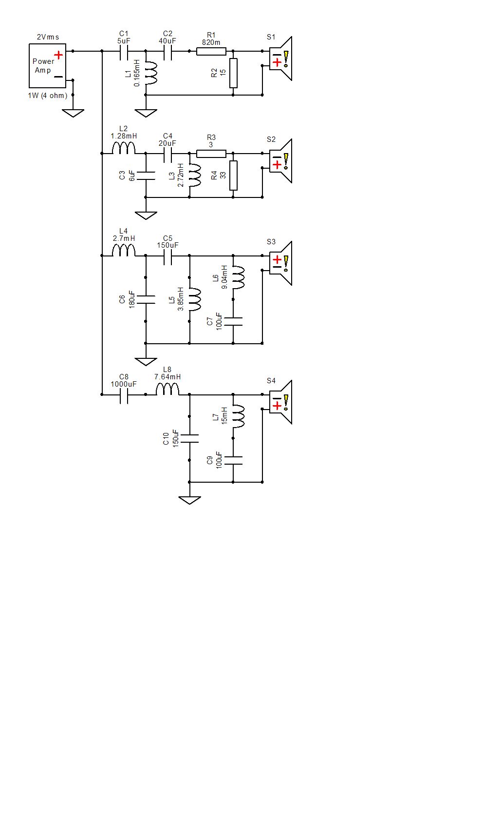

@wkloppen Thanks for sharing your .DXO file. However, I wasn't able to read it because of the localization of the numbers: ',' used to represent '.'. I got a divide by zero error, or suchlike, when I tried to read in your file. Anyway, I just recreated your circuit diagram and its component values, and the filter function frequency responses results matched yours very well. So that side of things is working here at my end.
I do have a question. I noticed that the labels of the capacitor and resistor components in your spreadsheet component list do not seem to match up with the components in the XSIM circuit diagram. Is there an updated spreadsheet available that better corresponds to the circuit used in XSIM?
Hi witald...thats correct. The labels in the spreadsheet are the actual labels of the PCB. The labels in XSIm are automatically generate while creatting the schematic and hence do not matchup with the excel🙂....i haven't had a closer look at the dxo file. I probably will be able to edit the text file and match them up.labels of the capacitor and resistor components in your spreadsheet
Note: I found out the file I posted was somehow corrupted. Maybe caused by the fact I editted the file on 2 different laptops while saving the dxo on google drive. need to draw it up myself again as well but thats done in 15 minutes.
sorry for the confusion. I will post the repaired file. Btw...you can edit the notepad file and change the labels.

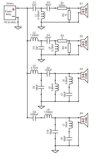

Those are some big layout changes! Do you happen to have the original circuit diagram published by KEF by any chance?
unfortunatly not.....the schematic was reverse engineered by someone on this forum a couple years back. I've checked the schematic with the pcb traces and components when I refurbished the speakers and replaced the caps. Provided I did not make a mistake...this should it.🙂original circuit diagram
I decided to give it go and start to rework the oem XO's of my Kef Reference Model Three's built in 1996. i've read a lot including the mathemematics on ESP pages of Rod Elliot. https://sound-au.com/index.html The first challenge is flattening the impedance of each driver. I will be using the DATS V3 as main tool in order to aquire the T/S parameters. My question is this. I first need the free air impedance curve. Is it enough to just loosen each driver making sure there is free air behind them or do I need to mount them on/in a seperate open board or something like that. After that i will use the added mass method.
In the original scheme I see inductors with capacitors in series parallel of the lower mid and sub drivers which would be indication of some resonating compensation I guess. It'll probably work a bit as zobelling circuit to correct the rising impedance with frequency....not sure though

You don't need the T/S parameters to work a crossover. You don't need the free air impedance. You only need to measure the impedances of the drivers in the box.to aquire the T/S parameters. My question is this. I first need the free air impedance curve. Is it enough to just loosen each driver
If you can measure the filter responses (at the driver terminals) for the original crossover then you can use those as comparison curves when you simulate.determining the xo frequencies
