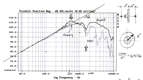

I need help to make a crossover for 2x eminence beta 15, connected in parallel in a H-frame, 125hz, second order.
thanks in advance
thanks in advance
If all goes well with your dipole you may end up with a region of falling response with a flat response above this. I've attached a random dipole response plot from S. Linkwitz's site.
You might want to use the speaker in the sloping region (otherwise why make a dipole 😉) and one way to compensate for this is to begin your crossover in this region. This can bring it back to flat... then where the response is already flat higher up, it will pull it down and roll it off. This way, the crossover is set by the baffle dimensions.
If this is a woofer, then the lower you begin this low-pass crossover, the more low bass you'll get. On the other hand sensitivity will be lower and so will power handling.
Thanks for the quick response.
I am following this article http://www.quarter-wave.com/OBs/U_and_H_Frames.pdf. At the bottom of page 8 is the graph of a woofer eminence alpha15 but the graph of beta 15a is very similar, but with more 4Dbs. Taking the advice on using the crossover at 125hz, by my calculations the reel will be 5mh am I right?
I'm thinking 18mH and 90uF. This is based on Martin suggesting 125Hz 2nd order Linkwitz/Riley (ie Q=0.5), and around 7 ohms at the woofer... Since this determination has already been made, a crossover calculator script (app) can give these values.
this values work with 2 woofers 8ohms beta 15 in paralel ?
