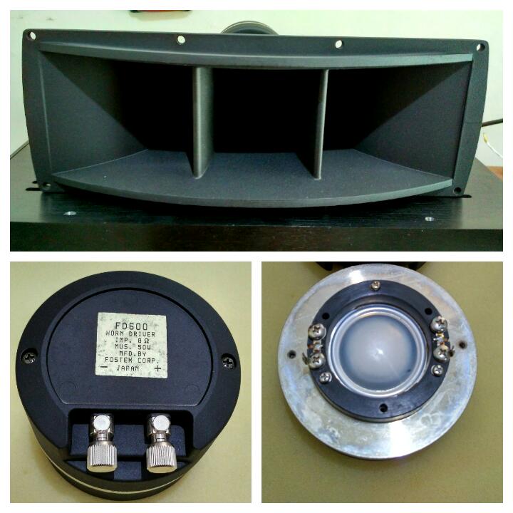

I'm playing with my first XO trial, tested on my horn tweeter fostex fd600. I have some inductors value : 0.22, 0.39, 0.82 mH and many capacitor value. I have tried caps filter only up to 5.6uf and i find that the vocal is very dominant. tried 2nd order which is currently use 6.8uf & 0.82mH but i hear annoying resonance.
with tweeter Fs around 500Hz, i tried to make notch filter and use 0.39mH - 220uf (bipolar cap) - 7ohm
now it's more enjoyable, but i'm thinking to play with notch filter LC value. what if i increase L value and reduce C value to get same 500Hz target? is there any variable like Q in notch filter? which one is better from my attach 2 combination, 60uF & 1.5mH or 220uF & 0.39mH where R is the same 7R.

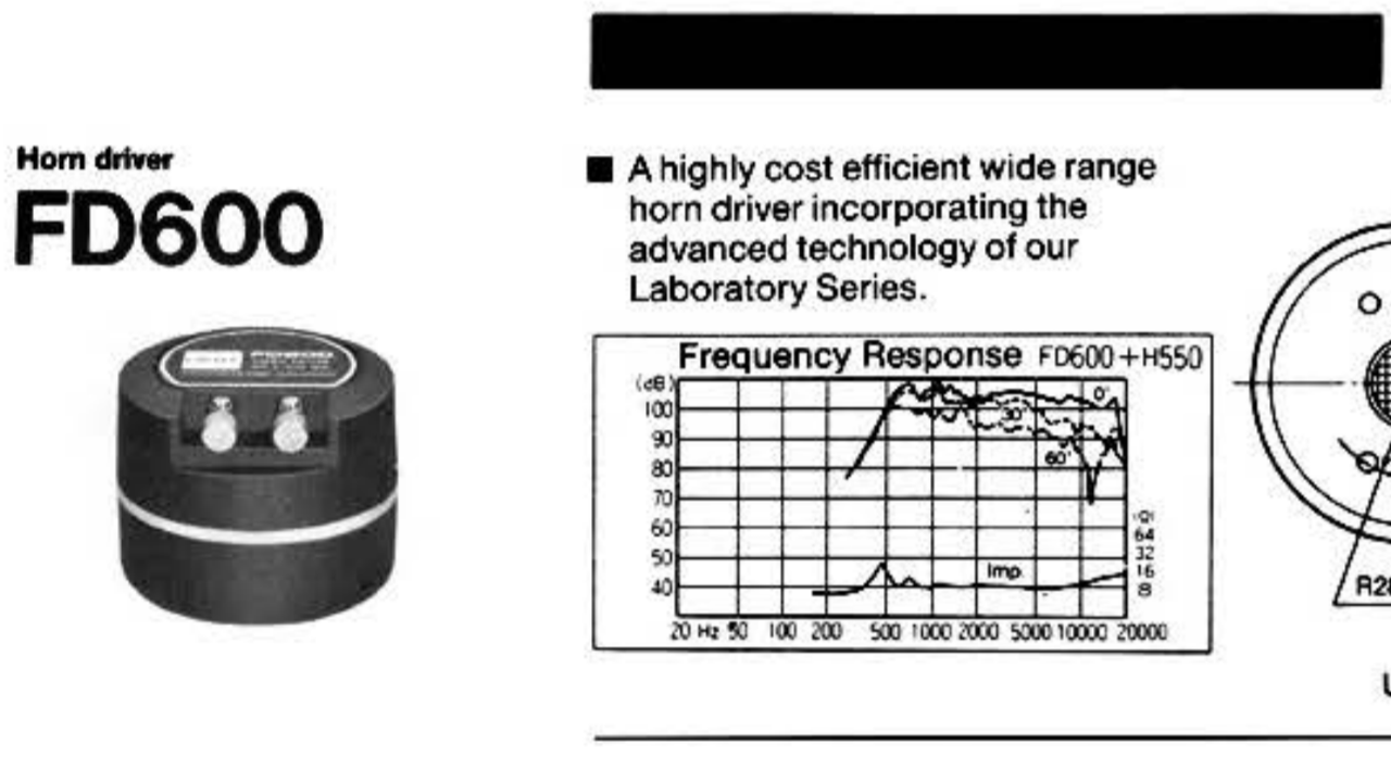

the impedance plot shows a peak @ ~500Hz indicating a resonance.
But there is also a peak in the response plot @ ~ 700Hz.
I think you should be crossing well above that response peak, or taking steps to EQ the response to nearer flat till you get down to your chosen crossover frequency.
I wonder if a 2kHz cross might be better, if the mid can extend cleanly to fill the new gap.

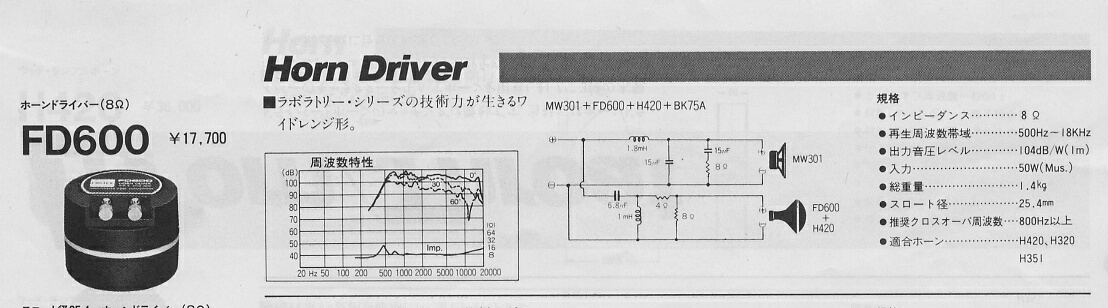

yes the target is 2kHz based on fostex recommended xo with 12" woofer, but i have no EQ available.
