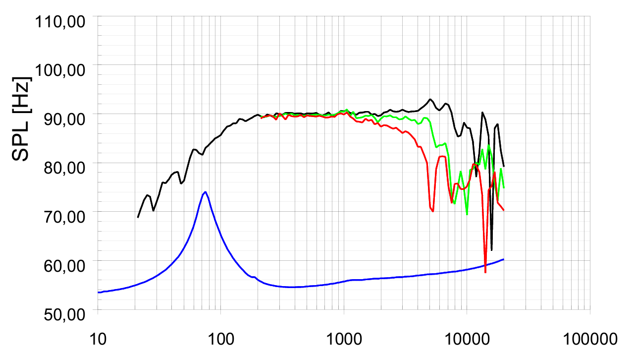

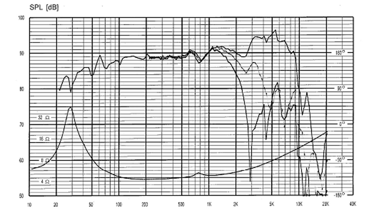

About mid and woofer cross frequency. Could they crossed lower? Maybe 350hz
It would be very helpful if you would give an illustration pictures to show what's going on.
The mid would be SS 12MU illuminator, and woofer SS 22W revelator.
Based on the SS spec graph, mid driver seems capable to go pretty low in an ideal box condition. But seems like my enclosure is not ideal.
So I need to know how low it could go to compensate a potential baffle step issue in my designed enclosure.
Here I attach 12MU official SS graph at the first pic. And the second picture is the 22W.

I think the 12MU could cross lower than 350Hz but I have no experience with it.

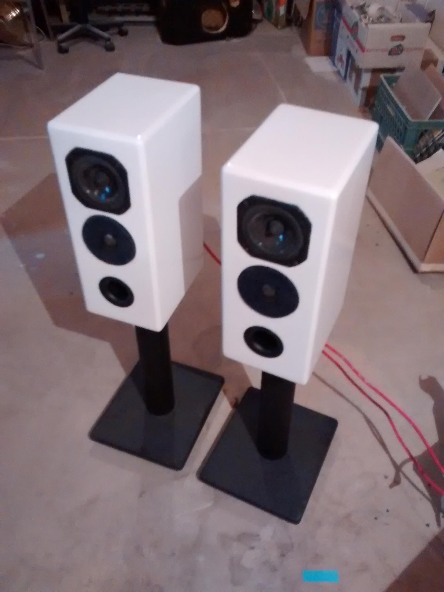

Second question: I am using a 4 inch bass driver @ 8 ohms. Audax AM100Z0. I have chosen to use a second order 12db/8ve for the tweeter @ 2500hz per manufacturer's spec (Linkwitz). I have chosen a 2mh coil @6db/8ve for the bass driver. Therefore the x-over is at 625hz (Butterworth), resulting in 2500 down 12db@ 2500hz. (625, 1250, 2500).
I have built a 4.75 liter box for this set-up. Seems ok so far.
Any yeas or nays?

As an experiment (and also because the AM100Z0 is no longer built), I have elected to place the bass driver at the top, the port at the bottom in an effort to give me a pseudo MTM affect. It seems to work pretty well at this point.
