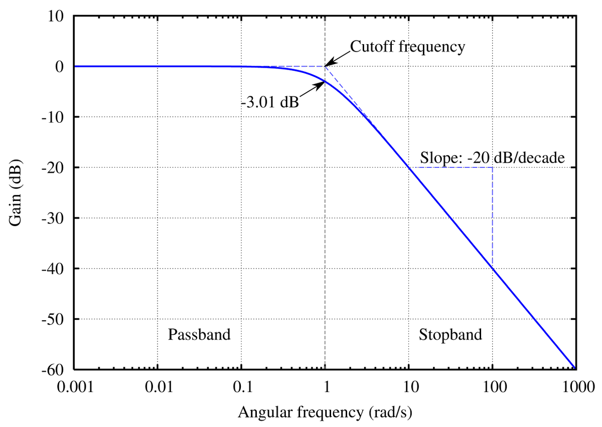

4 ohms divided by 6.3, divided by 2k is close to 330μH (this is also written as 330uH, 0m33H or 0.33mH). (6.3 is just 2 x pi.)
You could start counting the attenuation at zero at the crossover frequency and advance by -6dB per octave, but the response dips a little at the 'knee', being -3dB at said crossover frequency. This image (from Wikipedia - low-pass filter) shows what I mean.
This will be the case only if the driver impedance looks like a resistor (is compensated) or you find an alternative way to extract this response.
You are mixing up your m (milli = 10^-3) with u (µ = micro = 10^-6)..............................The tweeter is crossed at ~4k via a 4.7 mF capacitor. (8 ohm) The coil of the larger driver is at 4 ohm impedance. I figure an inductor of ~30-35 mH in series with the coil of the larger driver and the source, (without any capacitor involved) should start attenuating ~2k. At 4k, signal should drop ~12db.

For a Butterworth filtered crossover (-3dB relative to passband), the two drivers would be outputting half power @ the crossover frequency. The total power from the two halves would be equal to the passband power of the two individual drivers.
For a Linkwitz Riley filtered crossover (-6dB relative to passband) the phase at crossover is adjusted such that the two quarter power halves add up to an apparent equal SPL as we hear the signal move through the crossover region.
For a single pole crossover, The F-3dB (half power) is given by the traditional F-3dB = 1/2PiRC for the capacitor and F-3dB = R/2PiL for the inductor

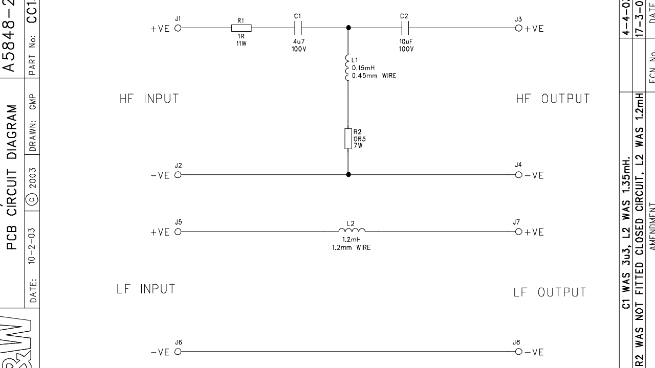

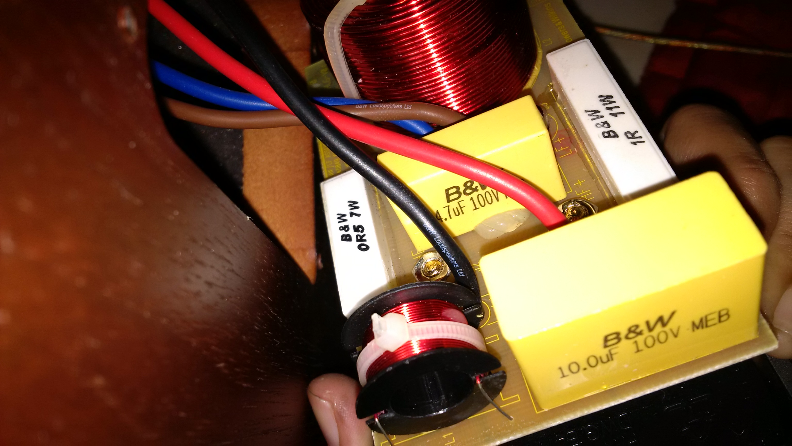

Last night I opened my 2 way b&w 705. And didnt find an additional circuit for bsc. Here I upload the crossover picture. (Crossover point 3,7 khz).

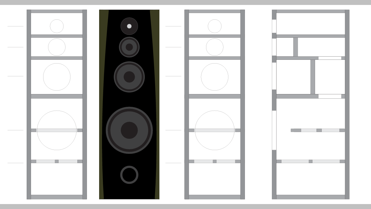

First pic is the baffle plan that I sketch.
Second pic is the b&w 705 detailed circuit. So simple

The front baffle would be somewhere between 35 - 37cm width with rounded edges.
At this particular width, aproximatelly, at which frequency the 12MU mid should be crossed with the 22W woofer?
I know it's kinda hard to know an exact point without a measurement. But at least you could give me some estimation numbers or pictures.
If I use all 4 ohm drivers for a 4 way design, would it be problem with the impedance?
I planned to buy the 4rth driver after I collect the money. So, the first project would be a 3 way design. Then add the 10" sub later.
Does it work this way? I mean, could I just add a low pass and high pass circuit in order to make it 4 way without changing the whole circuit?
Say that the response levels out above say, 500Hz to 1kHz. To take advantage of this you could put the crossover here so you can treat the high pass driver using a normal high pass filter. You then use a woofer with a slightly higher sensitivity, maybe not the full 6dB (the rest can be made up with attenuation of the mid as required).I know it's kinda hard to know an exact point without a measurement.
The woofer will have a rising axial response that is dealt with using a larger inductor.
I was going to do this once but the frequency involved conflicted with the needs of the speaker I was building so I passed on it. I could have added an extra 'way' but I don't agree with doing this without a good reason.
My point is that it should be a part of the main design, if this is to be used.
