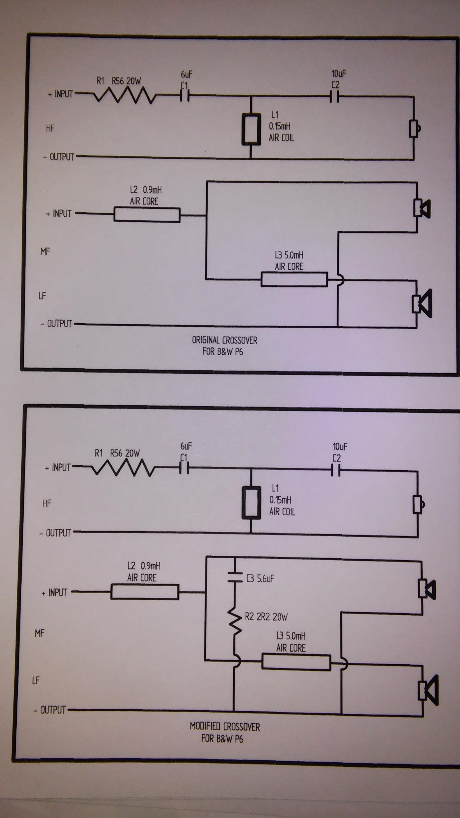

Hi AllenB,
The following observations are related to B&W and Sound Dynamics products because that is all I have owned.
I studied the Sound Dynamics 300Ti xovers and found most of the components were low quality and coil spacing was not good. I built outboard xovers using all air core coils, Mundorf Supreme caps and high quality non-inductive resistors. This resulted in a dramatic improvement.
I also have B&W P6s and N803s and checked out their xover design, on the B&W site. I found low quality components, and xover designs, such as electrolytic caps, iron core inductors, low quality resistors and poor coil spacing, in these and many of their other speakers lines. I must say they really stepped up to the plate with the $$$$ 800 Diamond series.
However, the P6 really stood out, as a B&W effort to meet a price point and, as an opportunity for improvement.
I thought the P6 could be improved with an outboard xover with better quality components, coil layout and midrange design changes. My latest design is attached. I would appreciate any and all feedback.

It is difficult to say anything about the result of your addition of R and C, anything would be a guess.
Direct impedance compensation is one design method but it remains an option, in fact in a measured design the impedance would usually be dealt with in a different way.. So adding it retrospectively is only going to make a change, but better or worse is not assured.
However I could guess that with some speakers what you have done here would reduce the upper (midrange) being produced by the lower drivers which could be an improvement, especially where their crossover comes close to their upper limits.
AllenB,
I really appreciate your input. What are you referring to as "the lowers drivers"? I am only expecting that the upper range of the kevlar mid range will be reduced. I don't expect there would be any change to the woofer response. Also, since these will be outboard xovers in wooden enclosures, I plan to use alligator clips to connect the components comprising the mod. This will make it easy to experiment.
....................I am only expecting that the upper range of the kevlar mid range will be reduced. I don't expect there would be any change to the woofer response. ...............
There will be a change in the signal fed to the lower bass driver.
One inductor feeds two routes.
The output into those two routes depends on the drop across that first inductor.
If you change the impedance of one of the two routes, by adding in that lower impedance RC, then you change the signal fed into the other route.
Only if the first inductor is split into two parallel sections, one dedicated to each driver can the changes to the upper bass NOT affect the lower bass.
