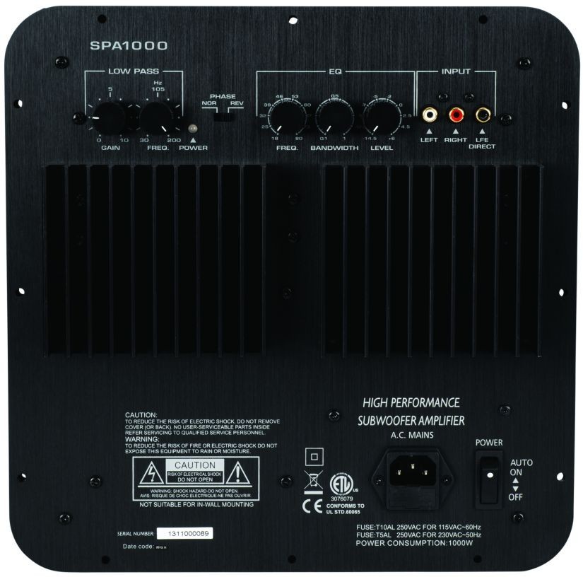

Ok, ok.. you're off course rightwith the Amp. It's Christmas, I'll stretch the budget with Santa's help and I'll go for the plate amps. 2 options here:
- Dayton Audio SPA500 500W Subwoofer Plate Amplifier
- Dayton Audio SPA1000 1000W Subwoofer Plate Amplifier
I'll take probable the cheaper one 500W (what do you think?), can't see other difference than the power.. but 500 is plenty. One per each speaker for subwoofer and the normal amp for the other drivers. # amps in total.. uau, you pushed me to a demonic crazy power 🙂) I like it!

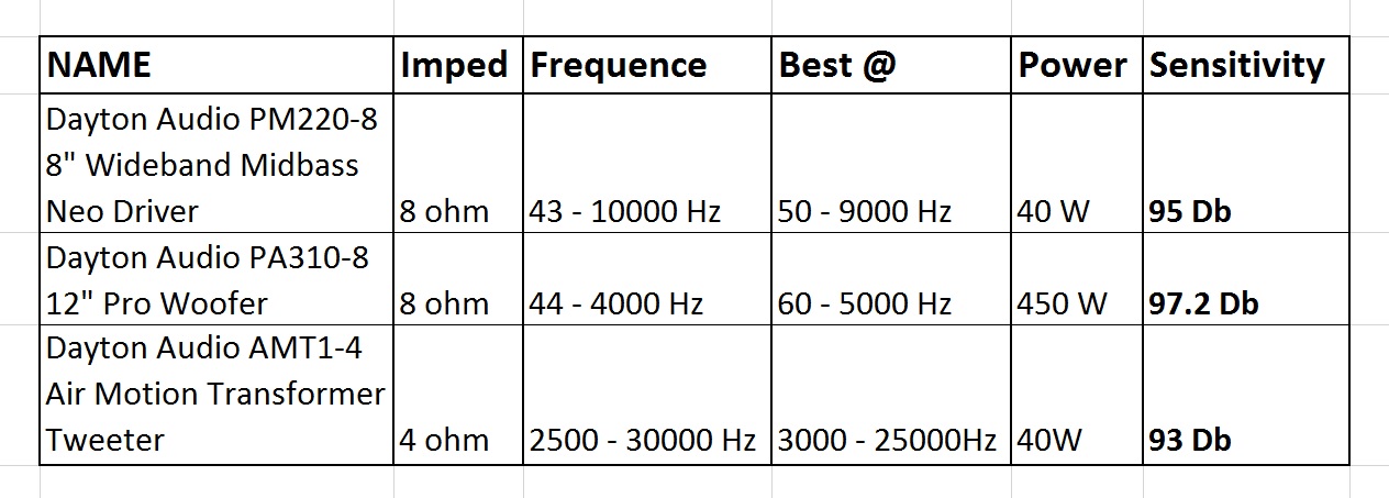

Speakers:

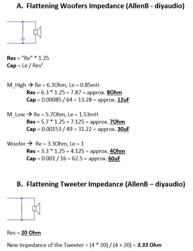

Flattening impedance according with AllenB lessons:

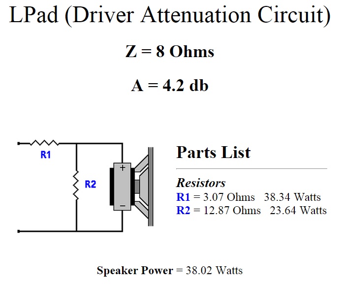

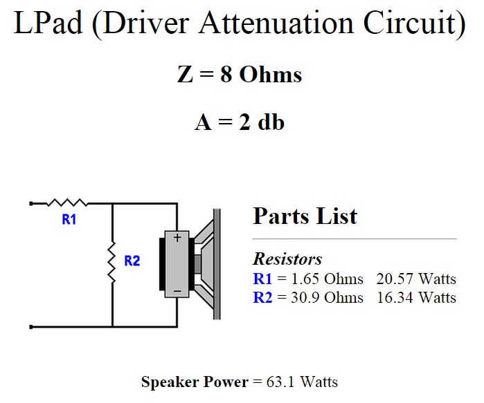

Bringing everything to 93Db Sensitivity:

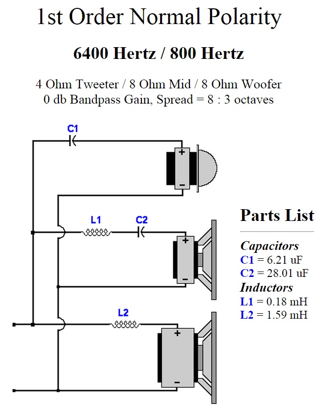

And finally the crossover for the MedL, MedH and Tweeter:
As for the lower frequencies I just both 2 of those, one per each box:
They have an lowpass filter and will amplify the 4th speaker in the box which is the subwoofer
May I have your bless for this? Please?? 🙂)
More or less
I let alone the Subwoofer which will be on a separate circuit with its own Amp.
So instead of the four "Tw, MidHigh, MidLow, Woofer", I have now only the first three. I might have changed the names of the drivers because now it makes more sense this "arrangement": "Tweeter, Mid, Woofer, Subwoofer".
So the subwoofer is separate with an active filter as lowpass. The rest of the drivers are in a 3 way crossover system. Logical I can see that as a 2 separate systems but physical they live under the same house.. the box. Which will be BIG :-0

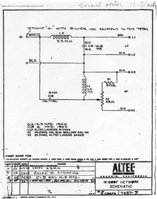

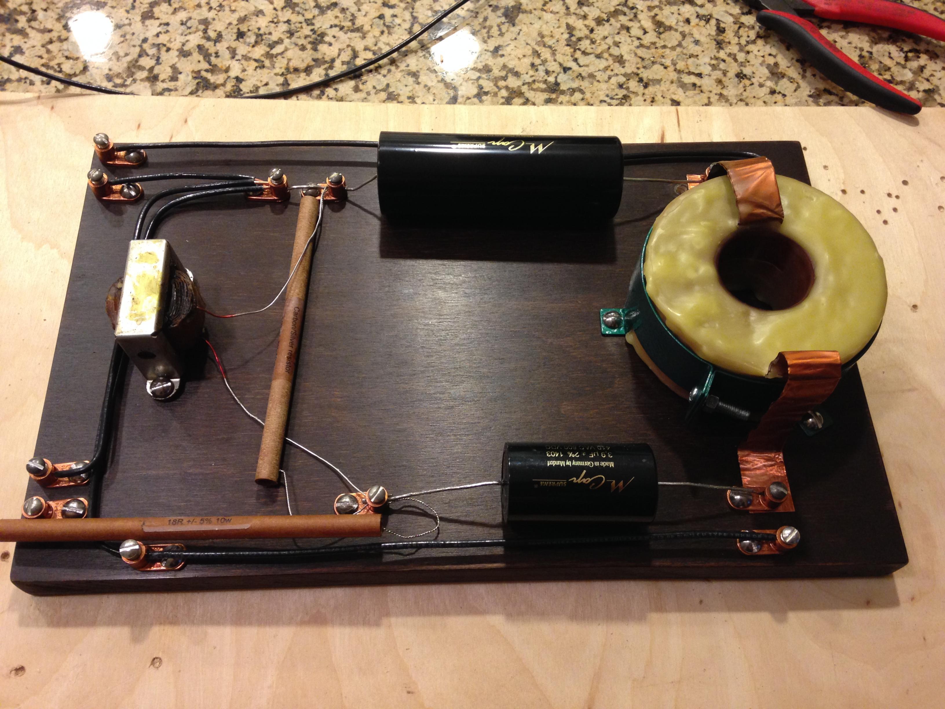

I've gone through several iterations of upgrading the 2-way crossovers in my Vintage Altecs which had a number of compromised design issues including: 1) both inductors next to each other; 2) 50 yo electrolytic capacitors; 3) an inductive wire wound resistor; and 4) old L-Pad.
Originally, I replaced the caps and resistors using a Mundorf Supreme for the HF and electrolytic for the LF, as well as Mills MRA12 resistors (bypassed the L-Pad with a fixed value).
Then, I decided to pull everything out on a board to make adjusting the R easier, to separate the inductors, and to upgrade the LF cap to a Mundorf Supreme now that I had the space. I then went back and replaced the resistors with Duelund using an 18 ohm value on the tweeter (original L-Pad went up to 25 ohms).
The progress to this point was incredible! My neighbor has the same speakers, source, and a similar amp and the differences are well worth it we both agree.
So now on the last revision (V3? V4?) I replaced the LF inductor with a 14 gauge waxed paper in oil 3.5mH inductor, dipped it in bees wax, and mounted it in a 90mm steel capacitor bracket. So far, it's sounded a little bright and bass thin over the past several days. Everytime I've messed with the Mutdorfs they've seemed to go through the same brutal break-in period (this is why I now believe in this effect) and this could very well be the same thing this time but I'm worrying about the effect of this air-core inductor...
The stock 3.5mH VDC value was ~0.5 ohm, and this one is supposed to be .45 Ohm but I didn't actually test it... And also the use of this bracket has me a bit worried. Do foil inductors burn-in? Is it possible that is has a higher DCR and this is shifting more current toward the HF? Could this bracket be reducing the L value on the new inductor adding more upper midrange? Thanks for any ideas or suggestions!

You said the coil is mounted in a steel capacitor bracket? That will almost certainly be interfering with the value of the coil. I would get rid of the steel bracket and just mount it to the board with some nylon cable ties and see how it sounds.
Tony.
Hey Allen,
I upped the HF serial R from 12-15 ohms on the L-Pad to 18 ohms when I when with the HF electrolytic cap and liked the HF balance prior to just adding the LF inductor. Would that be the same as compensating for the lower R when I replaced the electrolytic?
This might be a good idea to do with the LF 10uF cap... I have a 2 x 0.22uF Supremes that that I'm not using...maybe that would be okay?
Tony, I might try zip-ties for a wood dowel tomorrow. Thanks!
I'm going off the top of my head here, but I'd assume that increasing the series resistance as you already did, would reduce the damping seen between the larger capacitor and the inductor next to the tweeter, and adding some resistance in series with the capacitor might mitigate this somewhat.
You would also have altered the woofer response a little as this is a series crossover.
Some other thoughts about the new inductor revolve around inter-turn capacitance and the dielectric effect of the beeswax (not that it is a bad thing necessarily and is probably a good thing). The poly capacitor however might interact with it and adding a small series resistance somewhere there might indicate this higher frequency behaviour if it is present, by damping it somewhat.
Yeah, I was really happy with the crossover until I just added the LF inductor - that was the only change with this iteration.
I'll start tomorrow but pulling out the brackets on the inductors and she how she sounds. Then from there I can look at padding the 18ohm resistor a bit more on the horn and/or adding a small R to the large LF cap. The 18 ohm HF serial resistor is just a fixed value in lieu the original HF L-Pad that ranged 0-25 Ohm at full attenuation. Right now it's where the knob would be turned down about 3/4 of the way. With the original crossover (electrolytic) I had the L-Pad at ~12-15 ohms.
I'm still learning a lot with this project but from what I understand ugly original HF parallel inductor is part of the 2nd order HF cross over and the parallel 20 ohm fixed R is some sort of compensation, or to smooth the effective HF impedance seen by the amp? Maybe next step will be to replace that HF ferrite inductor... 😉
About the new LF inductor... it's a 14 gauge waxed paper in oil and was already coated with something probably like paraffin. I'm not worried to much about this just on the outside turn and at the top/bottom of the 40mm foil. If anything I'd hope it would help with microphony and also reduce long-term oxidation. Poor man's Duelund CAST. =)
Thanks for the help mate. I'll keep ya'll updated... ;-)

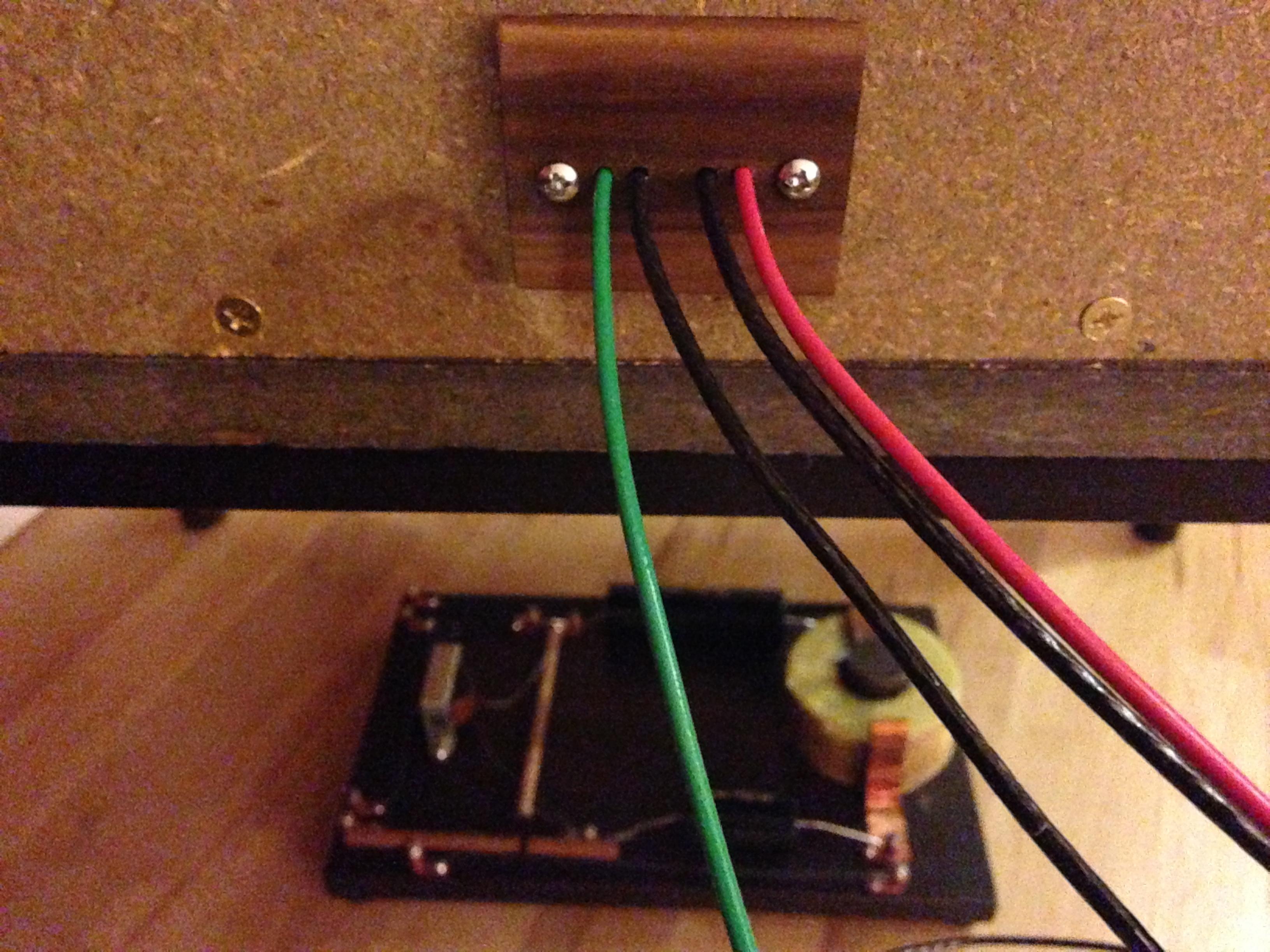

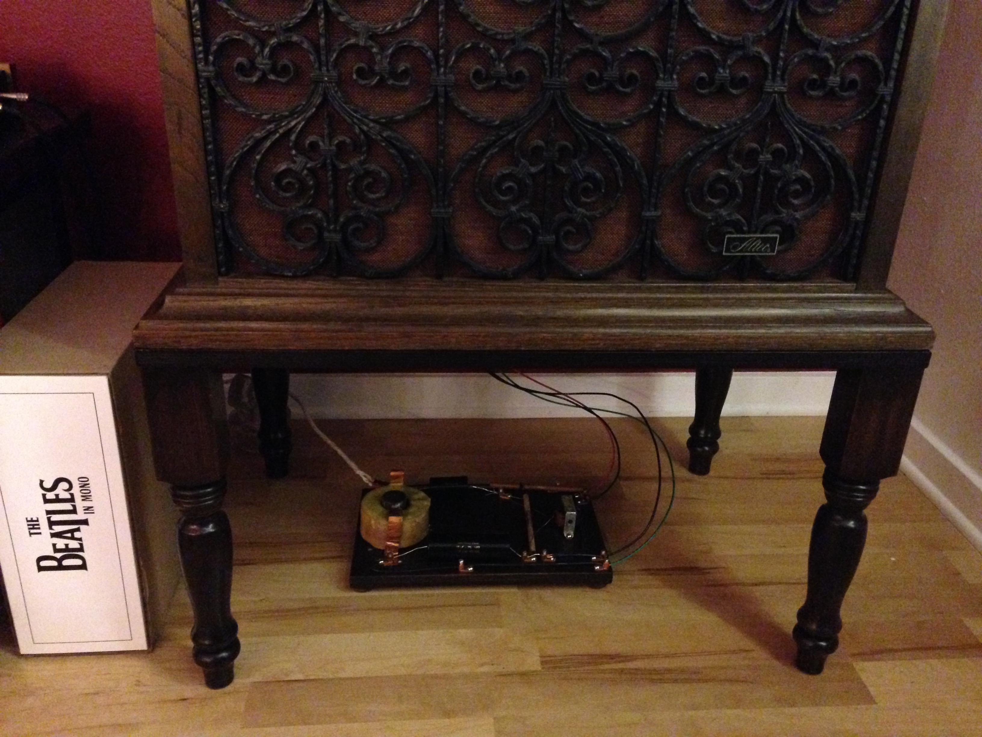

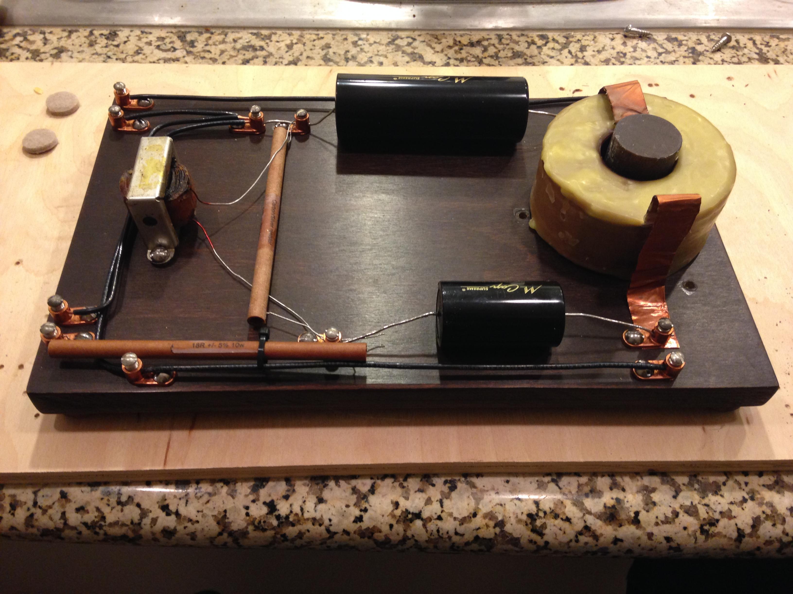

Okay so taking out the steel cap bracket was definitely a good idea... I added a dowel with a brass #10 screw to secure the inductor and used this as an opportunity to make the crossovers external. To do this I had to construct a new connector plate with 4 individual small holes to route the wires into the cabinet. By doing it this way I was able to eliminate the old screw connectors, its solder, and about 2-3 feet of wire to the crossover. Now I can just attach my speaker wire directly to the crossover input. The results at this point are spectacular. I can only guess that the bracket was reducing the inductance on the coil and adding too much upper midrange and it's now sounding really quite nice. 😉
So my next question is it it worth replacing the HF parallel ferrite inductor with another foil air core?

:up: I suspect yes the steel was reducing the inductance of the coil. Steel in the center will increase the inductance, but steel around the outside I think will be similar to mounting on a steel plate, which will reduce the inductance.
Tony.

The subwoofer will be amplified separate (from a plate amp). Will it need an impedance flattening component or the amp will do that.. somehow?
Most amps will deal with this but it shouldn't hurt. Some, such as some DIY amps will require it. I've noticed small inprovements with some commercial amps, especially in the lower treble region. Something for a rainy day 😉

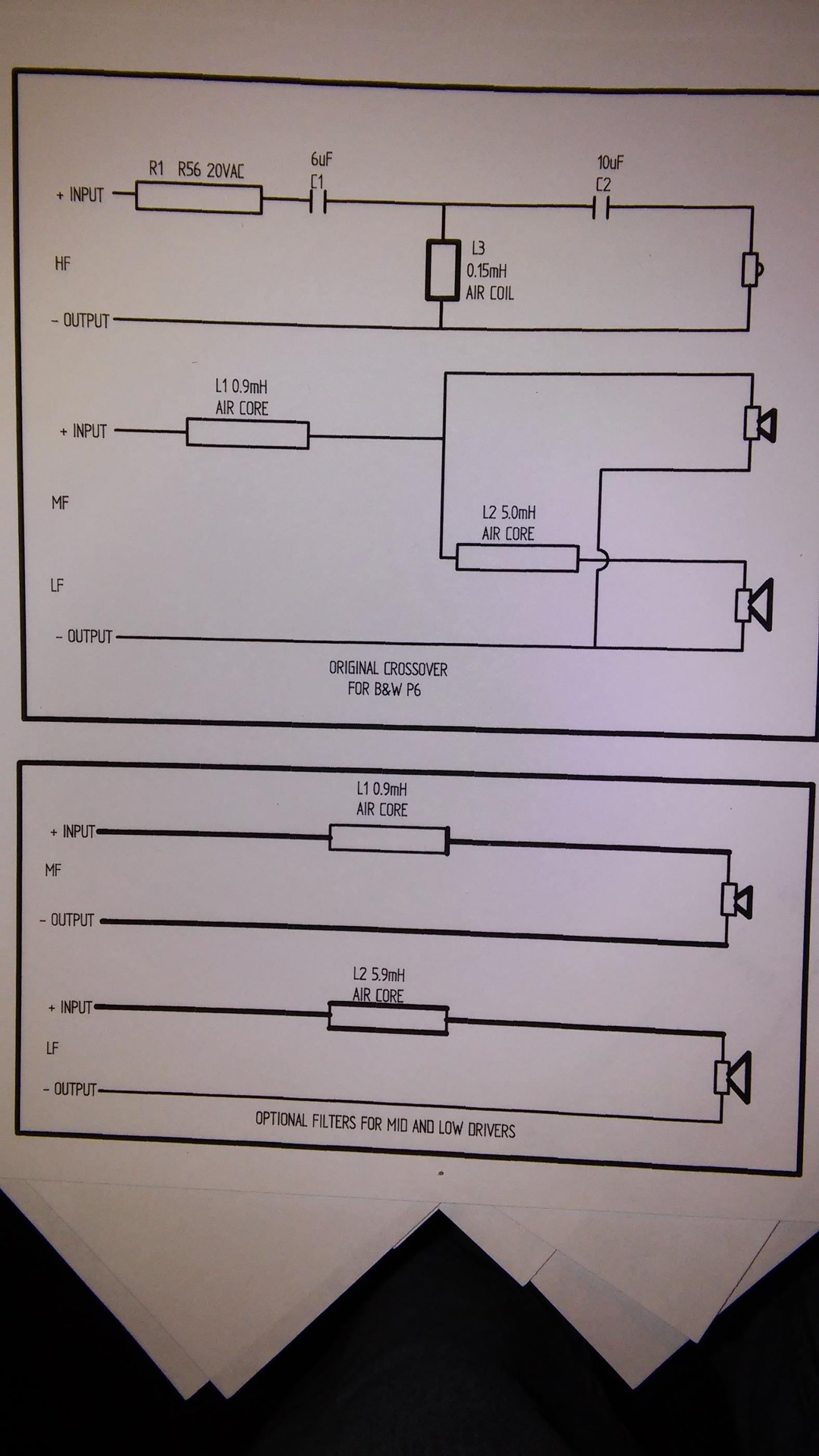

Hi AllenB,
Very impressive and clearly written tutorial. I would really appreciate your input on the attached xover schematics and proposed modifications. I thought it might be helpful to add the speaker description from B&W site.
3-way 4th order vented box system
1 x 25mm metal dome - high
1 x 165mm Kevlar® - bass/midrange
1 x 165mm Cobex® - bass
40Hz – 20Hz ±2dB on reference axis
90dB spl(2.83V 1m)
8 ohms (minimum 3.5 ohms)
