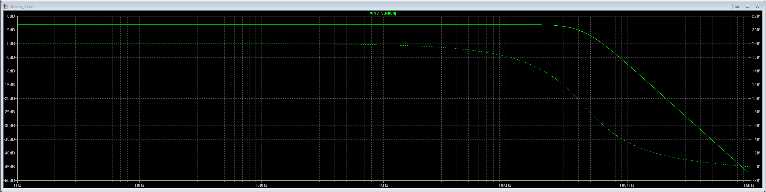

Would you be willing to talk a bit about the details of the analog filter circuit? Is it accomplished by just the two 1nF film caps in association with the present resistance of the circuit, or is there more to it? In the first post you mentioned filter corners of 20 K or 30 K, is that correct (seems very low?), and what is the corner frequency with the included parts (1nF)

Ah yes - that should actually read 20 or 40Khz
But wow - no - even 20Khz corner is not low - it's near the corner freq of the DAC itself 🙂
You can adjust it by adjusting CF1, CF2A/B where CF1 is double CF2.
CF1 4.7nf and CF2 2.2nf gets a corner just above 20Khz
CF1 2.2nf and CF1 1nf get a corner around 40khz
I think you can extrapolate other values on your own - it is important to retain the symmetry to the degree possible with standard values.
I can't think why you would want a corner above 40Khz - but you can do it if you like. 🙂
Here is what the 40khz version ac characteristics are:

Glad to help - it should be fairly simple to get any corner frequency you want.
If you want to get into the 80-90Khz range I would suggest 1nf and 470pf
Just keep in mind - the further out you go - the less effective the filter becomes at eliminating normal HF DAC artifacts which you really don't want further down the chain.
