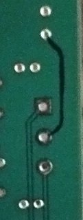

This is a picture of the jumper that needs to be added for the right-channel balanced output (about 12mm long):
Instead of adding a jumper (which is a totally valid solution as well IMHO..) you could just scrape the green solder mask over the ground plane next to the ground pin and use a blob of solder to make the connection.
Indeed you could! We just thought the jumper method was easier for most folks to execute. Either method is fine. 🙂

I'm worried that adding a 12mm jumper at the right-channel balanced ground will cause unbalance between the left and right channels, affecting sound quality. If jumpers are added to both left and right channels, the problem is smaller.
No - the jumper absolutely wouldn't effect quality🙂 Balanced signals don't work like that. GND is not really part of the signal for a balanced output - all that really matters is that the shield has a single path back to GND.
In any case - 1.1 boards are ordered but it will probably be a couple of weeks before they are ready - in the meantime I would not let the jumper stop you. 🙂

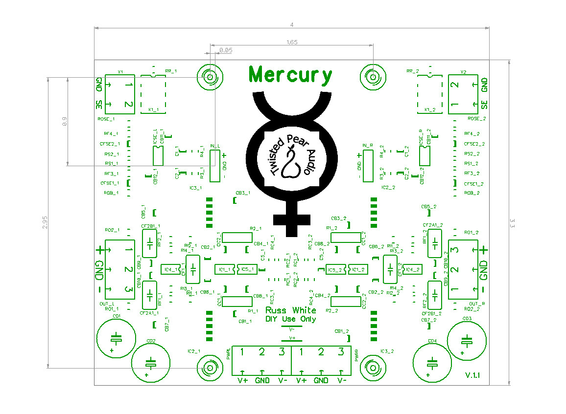

Can you tell me the length of BUFFALO-IIISE PRO and Mercury IV individually? I need to arrange a drill hole in the housing.

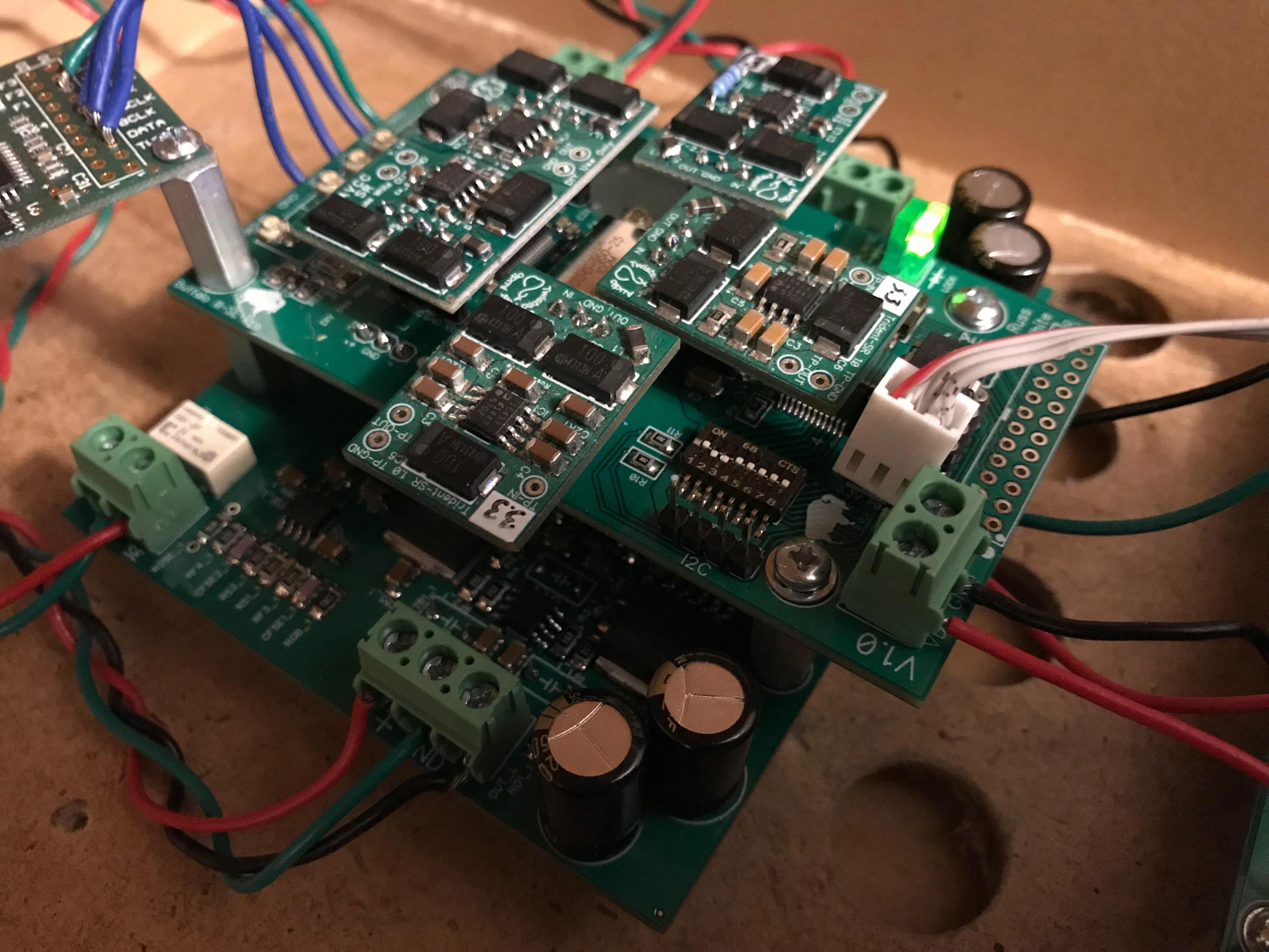

How can I connect BUFFALO-IIISE PRO with Mercury IV?
This should get you going.
You simply solder the female 3 pin headers to bottom of the b3se-pro and the male headers to the top of the Mercury. Then you simply mount the B3SE-Pro on top of the mercury.
It will look like the attached pic (this is a mercury during initial testing in my test rig).
