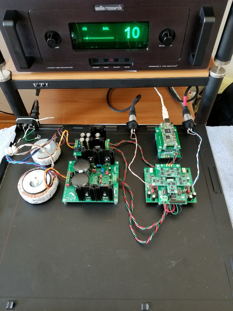

Yes! Got it assembled and ready to go and had two days to listen to it. Basic build here. BIII 9028 Pro, LCDP HO for DAC/USB input, Placid HD BP 2.1 for I/V board, Amanero/Cronus. Still waiting for 4.3" tft to see if my recently assembled DimDim shield works so running on onboard controller/dipswitch. Went with Apodizing Fast Linear Phase filter.
I started out with my old faithful Legato. I run balanced out with ground lifted on Legato so no common mode DC between ground/pos and ground neg. No coupling caps needed. Sounded better than the 9018 so I slipped Mercury in. Due to higher output of Mercury, I used Radio Shack to keep listening level the same. Wow, it's like a different DAC. More detail and separation IMO. I'll be retiring the 9018 with Legato and investing in a new HiFi 2000 chassis for my new DAC! High marks Russ!
Like Russ said, extremely low DC between balanced pos/neg and between ground pos/ground neg. I was able to connect the balanced ground again. It helps eliminate spikes when switching to/from digital source.
This DAC won't be as extreme as my first BIII...
Man that's going to be a fantastic DAC! Nice work! Thanks for the report.
