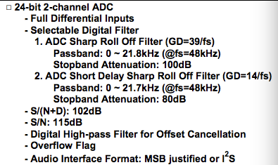

Note #4: The ADC used for measurement uses very good but not perfect JRC 4580 opamps. Also there is AK4621EF ADC that is limiting factor too...

Nice work Miero! That is awesome! There is no getting around that pesky ADC limitation (-112db is not actually that bad for that ADC if you look at he datasheet) - but it is so nice to see such an impressive result! Thanks for sharing!
One thing that is super cool is - with the ES9028/38 you can set a register that will completely null out any H2 and H3 (it applies correction) - leaving you with virtually no harmonic distortion. The problem is - the ADC will always tell you small lies. 🙂
If you use that register - you need to trust your test gear a lot. 🙂
So ES9028/38 with Mercury could be made to measure as close to perfectly as is probably possible.

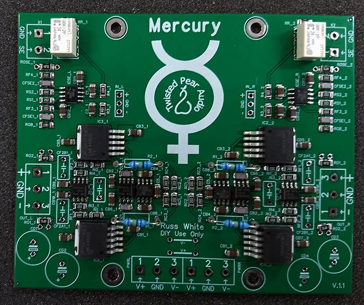

What are the pitfalls of the common mode offset at the dac output that the differential servo tries to correct? Is the only downside excess dissipation via a DC current offset or are there other factors involved?
Also I'm curious, you said there's "good reason" for the board being 4 layers. Since the board is analog, what are these reasons?
I am curious... do you think only digital circuits benefit from 4 layer PCBs? 🙂
That fact is that just about any high speed circuit can benefit from dedicated power/gnd planes. Sometimes you can do that with 2 layers - sometimes you need a dozen.
The key purpose of the CMS is to make the zero point of the I/V truly zero - that is to say - the amount of current sourced and sunk from the DAC is identical. This has positive effects not only on the DAC (because it is now operating truly symmetrically) but on the AVCC supply. It is a critical part of the design - and it's design is not trivial (like simply taking the midpoint of AVCC) - it accounts for offset errors by design. Even on a DAC the quality of ESS - resistors on silicon aren't perfect.
Mercury is the product of a lot of critical design and most importantly - listening.
