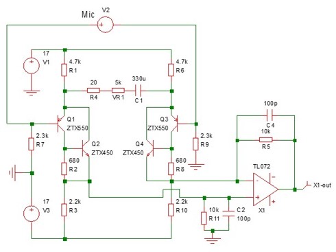

Basically looks good. You missed the 3k3 input resistor (R46 or R45?), Q2/4 are likely to be a waste of some perfectly good ZTX450s, there is no reason not to leave R7/9 at 4k7 (or is that supposed to be the combination of 3k9+470 || 4k7?), and you could go down to 1k-1k5 for R3/10 to get the common-mode swing down at this point, but other than that...
I noticed that on the input board, IC2 would be very much worth swapping out for something with more oomph as well... the poor TL072 has to be driving 3 10k pots in parallel plus a bit, that's not going to go down too well if you are trying to run the input amp hot.

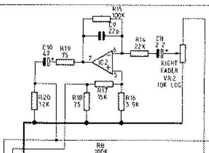

I've been going through the rest of the mixer, and while I can't puzzle together a typical signal routing just yet (I should probably just RTFM thoroughly), I noticed a whole bunch of ground-compensated output amps like this:
100k/22k after a 10k pot (Rout = 2k5 max)? Maybe they didn't want to bend the pot curve too much or something, or the circuit had originally intended to be used with a TL072 rather than the 5532 they ended up using. In any case they're wasting several dBs of noise there. And unless I missed something, the divider ratio of 16k/3k9 in the ground compensation does not match 100k/22k too well either... why didn't they go with e.g. 10k/2k2 instead?
Oh crap. With the pot in front, the divider ratio in one leg is slightly variable. At the worst-case 2k5 source R (6 dB down from max), the divider ratios are an almost perfect match. Elsewhere they're slightly off, so cancellation of ground loop noise when going into an unbalanced input would be reduced but still partially effective.

He said OPA213x had become rather too expensive for his tastes. Also, with those 100ps I reckon a unity-gain stable part would be good, so OPA2227 instead of 2228.Why using smd componets? Go with opa2132 or opa2228 there, but i doubt you'll hear a difference !
