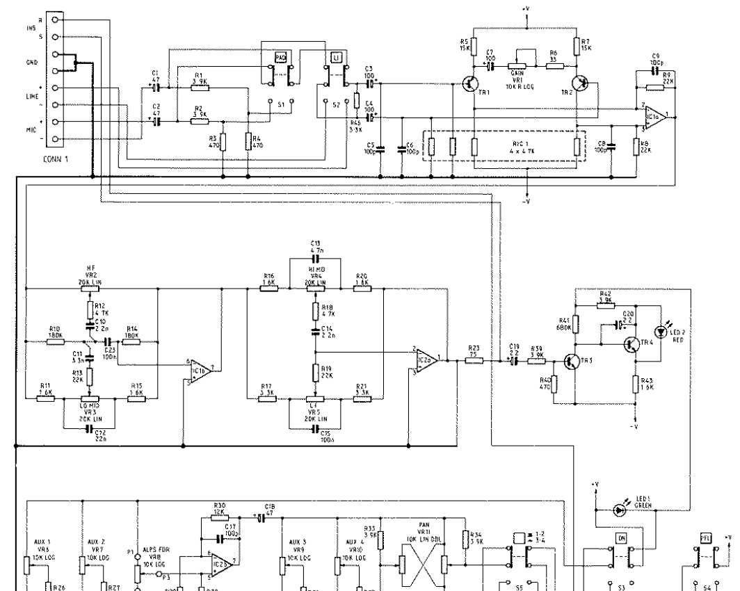

Whew! I'm not sure that I dig what you're rappin', here, brudda....Hmmmm.....What I am trying to do is improve my Soundcraft 200 mixing console---its microphone input is a differential pair of PN4355s feeding a TL072 opamp, and it's NOISY! I will replace the TL072s with John Curl's new OPA1656; but I'd like to improve the transistors as well. So your suggestion is to try the 2N4403, a MPS8599, or a ZTX718----Is that correct?

Are all the mic inputs equally noisy? Can the noise be influenced with the input EQ controls? Does it vary with gain setting? What is the microphone used for testing? With the same sound source, level and mic position, how much noisier than others is the input at near maximum gain?
I would suggest making sure that:
1. all the small electrolytics in the power supply section have been replaced (also see previous notes on C10 and ZD1 - btw, there is a drafting error in the schematic, the connection between the two is accidentally omitted)
2. at least one channel input board has been recapped (note: best upgrade C7 to 220-330µ - also rec'd for C6 in the 1600)
3. Pad and Line input switches as well as gain pot on said input board are squeaky clean (same also recommended for EQ pots)
Proceed from there.
I don't know much about PN4355s, but they would have to be badly degraded for excessive noise to be a problem. Still, trying 2N4403s would be worth a shot, along with reducing R5/7 to 7k5 like they are in later models. I wouldn't be too surprised if it's not stable though. PN4355 Cob is around 20 pF, so quite a bit slower. ZTX718 might be a better candidate.
In a composite amplifier like this, replacing the opamp with a faster one can backfire badly, so be warned. Unlike in later models, the 200 does not (crudely) drain open-loop gain via a capacitor across the inputs. Not sure why they don't have any decent compensation for the input LTP.
I did find that the original 200 is reputed to be somewhat noisy.
I also found a star grounding mod which may be worth pursuing; it is supposed to bring down hum by as much as 12 dB.
