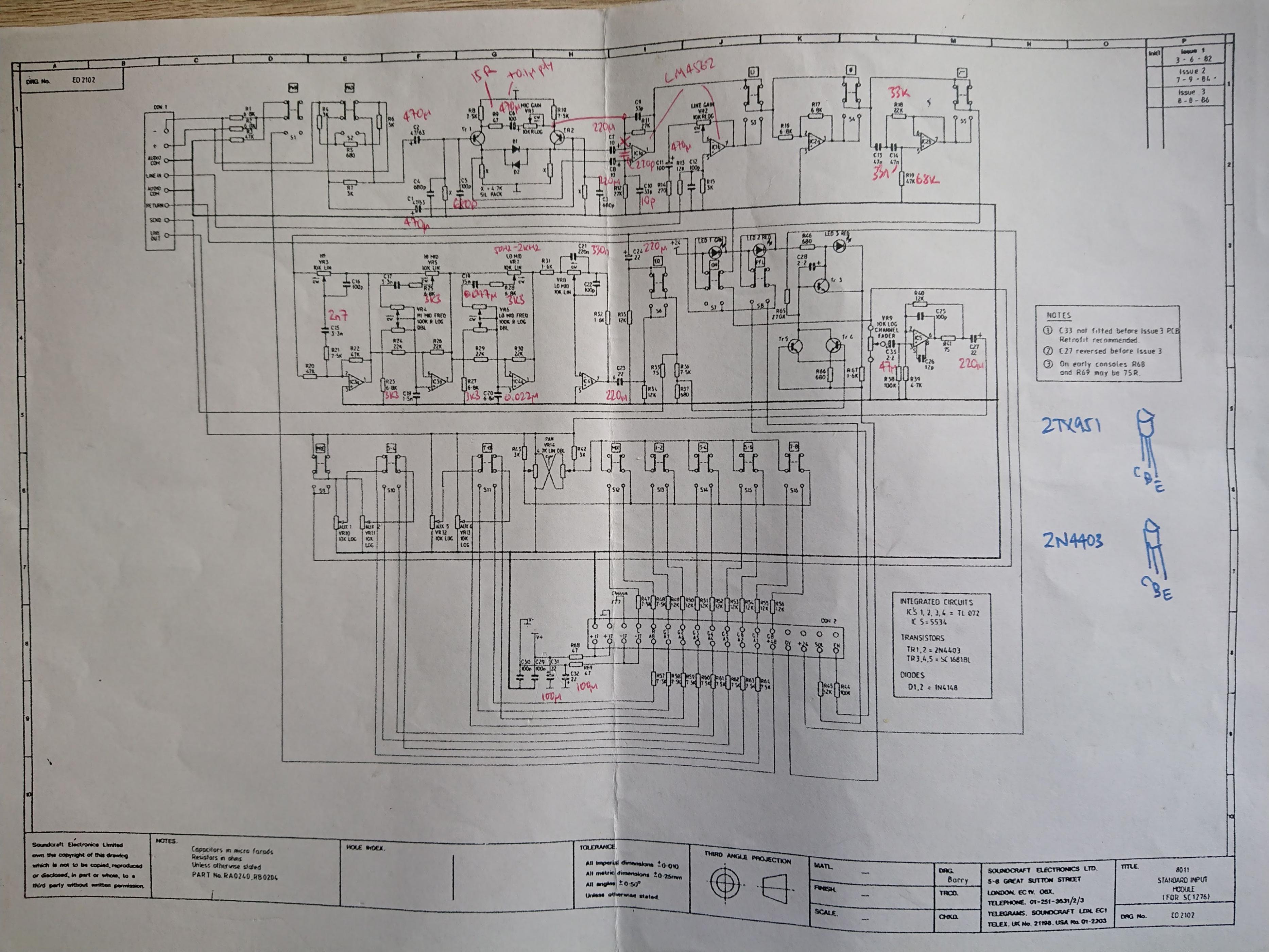

Funny you should mention the grounding.
As they get recapped, each strip has been getting an 18ga ground wire to a copper bus bar, with those automotive spade connectors in the middle for disconnecting each strip.
I have some "before" noise measurements from before doing any mods.
Since I still have the original grounding intact (via the ribbon cable) I'll be able to get some actual measurements of what others can expect from doing the ground mod, recapping the desk and power supply, and doing both, which will be interesting.
