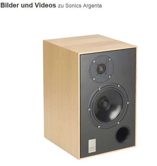

Ceramic tiles on the panels. Joachim Gerhard did this in his Sonics Argenta Speaker. Anybody else get it? I know where he was heading on this. I'm not saying Joachim Gerhard would argue this is the best way to do things, but what was the guiding principle? That is the right question from which you will learn something. 😎

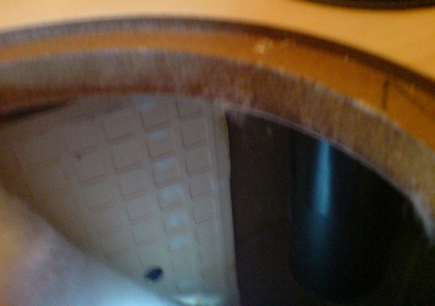

I used ceramic tiles on the outside back panel to get it more stable. Worked rather well I think.
