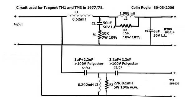

Tangent TM1 from your description, the more upscale mode substitutued an Audax 8" (RS4), Quite a good loudspeaker in its day.
Tangent Speakers TM-1
dave
In my opinion the Tangent TM1 and TM3 were about the only decent-sounding speakers ever made with the KEF B200 SP1014. That woofer has a "quack" in its upper range that's hard to get rid of. Linn never managed that with their Sara, but Tangent got it.
